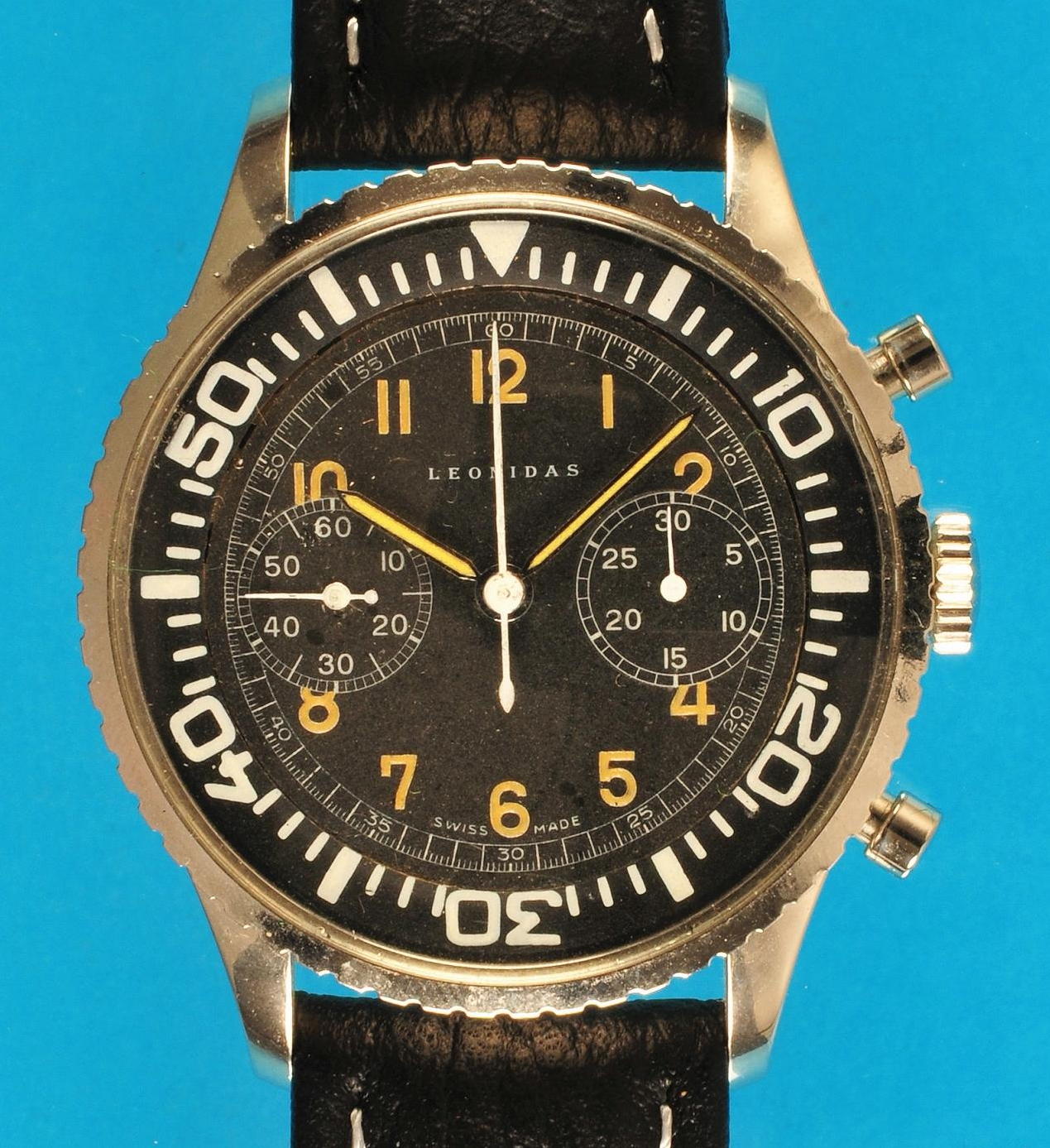

I would love to get some input from anyone into early Leonidas Military watches.
Generally focussed on early Omega chronographs, I recently came across this Leonidas Chrono (Val 22, dm. 42mm) but my knowledge about them is extremely limited...
While I can't help liking it, there seem to be various details that irritate my eye... these points come to my mind:
- while the dial reminds me of the CP 1+2, case and bezel are different in various ways.
- bezel possibly a later replacement?
- also the crown seems not to be original...
Grateful for any thoughts / comments!
Have a good Sunday,
Johannes

I'm no military expert, but would say that there is no possibility that the bezel is original. As in 0%.

I think so too. You don't have to be a seasoned military watch expert to clearly see that a few things don't match here... styling, patina, etc.

If you asking opinions about a potential military watch a picture of the case back is a must.

Just asked for it, but with the various inconsistencies being confirmed, this will not likely change my mind.

Shouldn’t it be a
15-30-45 bezel
Not that I would know, but from looking at the related early Leonidas: good point. At least if it is supposed to be in any way related to the CP1/2. After digging a little deeper: it seems to me that only the (admittedly lovely) dial is from any other early Leonidas (also the Swiss Made at 6 should not be there if a CP), while both case + bezel are from a totally different brand. Too far fetched?

Big gap between the inner dial and the outer minute scale, which has a totally different font. What a mess.

..it looks like a multiple decade of age type span in the dial to bezel

Thanks to all confirming what my intuition had told me right away and sorry for wasting your time with this.
