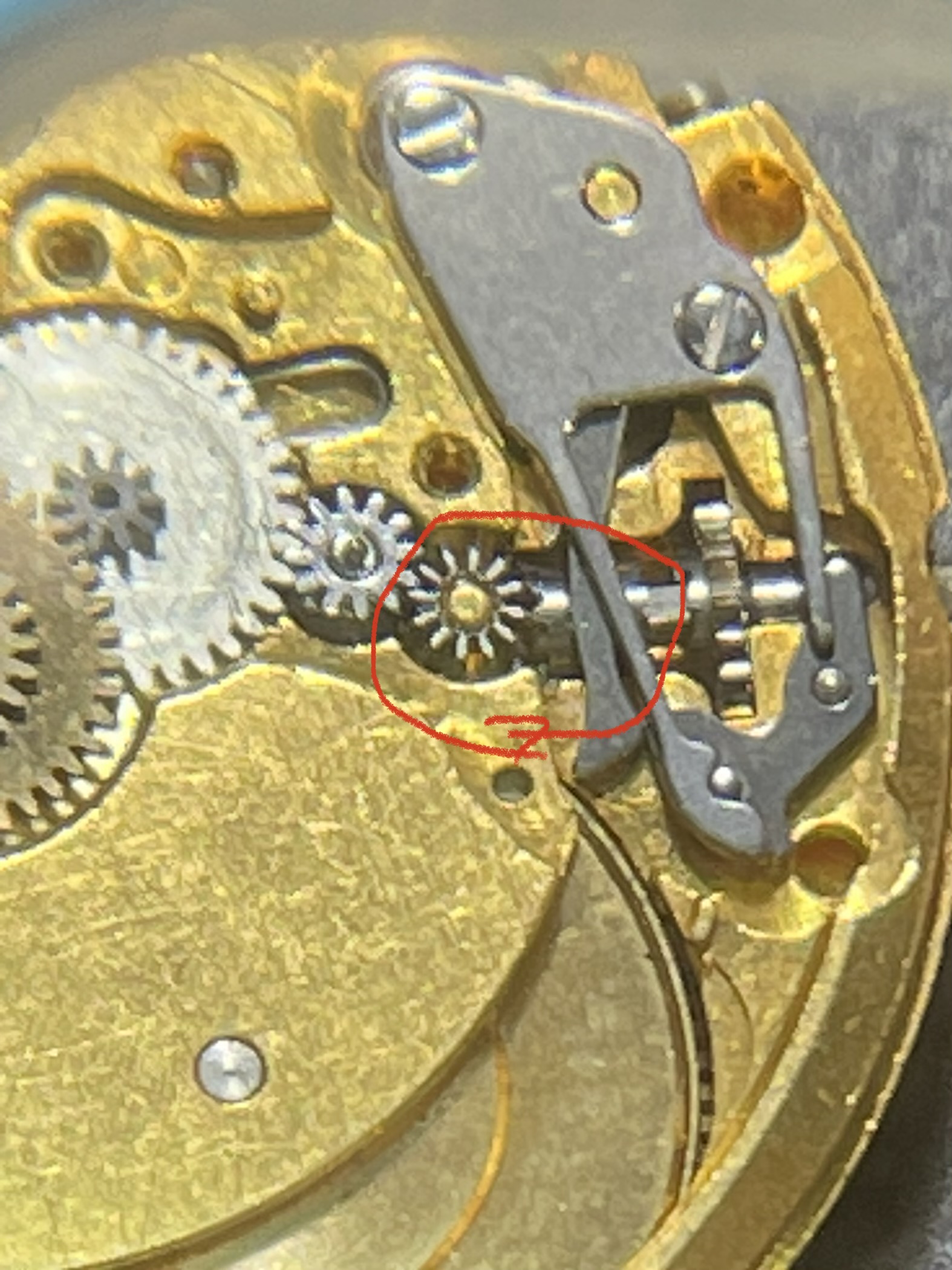

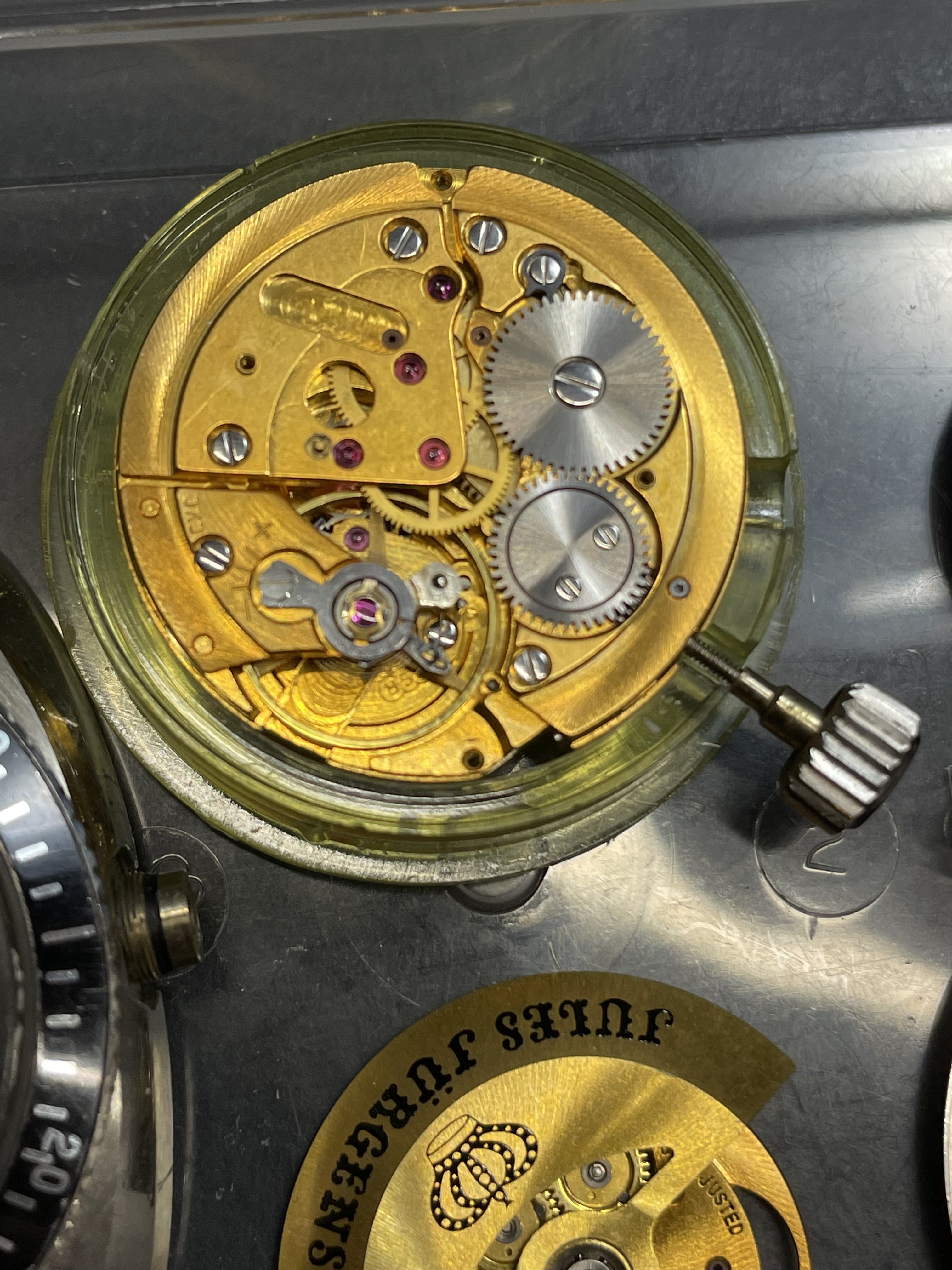

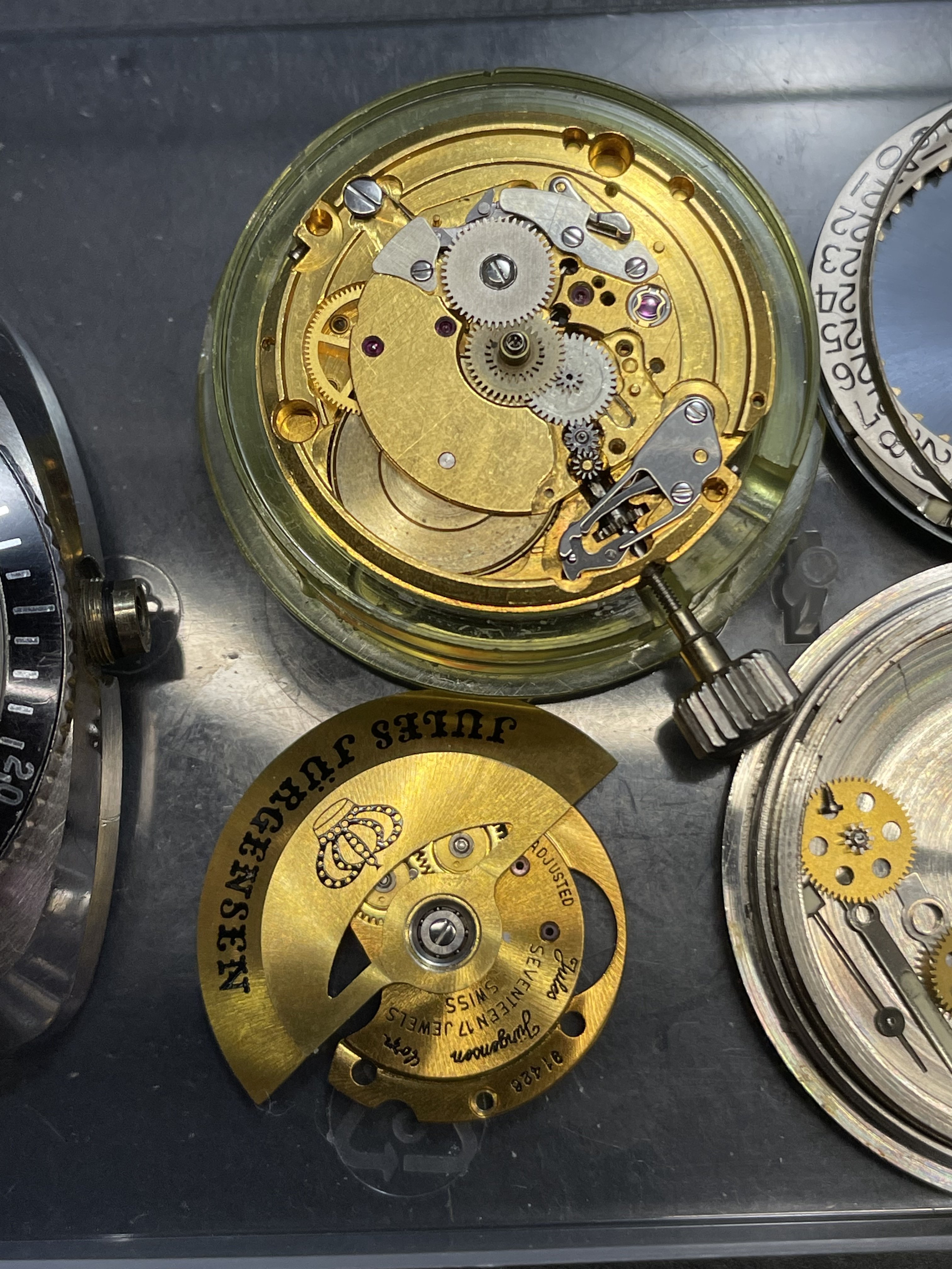

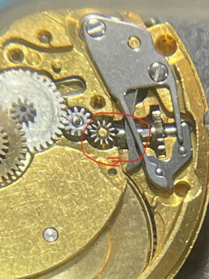

Greetings all,
Need the collective brains to find out what base caliber this may be. It comes out of a lovely mid-60’s JJ diver with blue dial similar to this one (the one I have is date only)
It was running when I got it, but wouldn’t set (you could feel it trying to catch but would slightly move the hands then skip).
There are no markings under the balance or anywhere else I can see other than “?SR “.
And here is where the problem lies
Other variants of this exact watch with day/date (like the one pictured above) have an ETA 2638, so I assumed it was in the same family (2637 or 2622) but comparing against this one, it doesn’t appear to be an eta.
Anyone recognize it?
7,799
14,399

So found an article on MSR. It appears they supplied movements to Revue And Vulcain as well. They rolled out their ball bearing rotor in ‘67 which gels with the time period of this- probably around ‘70
