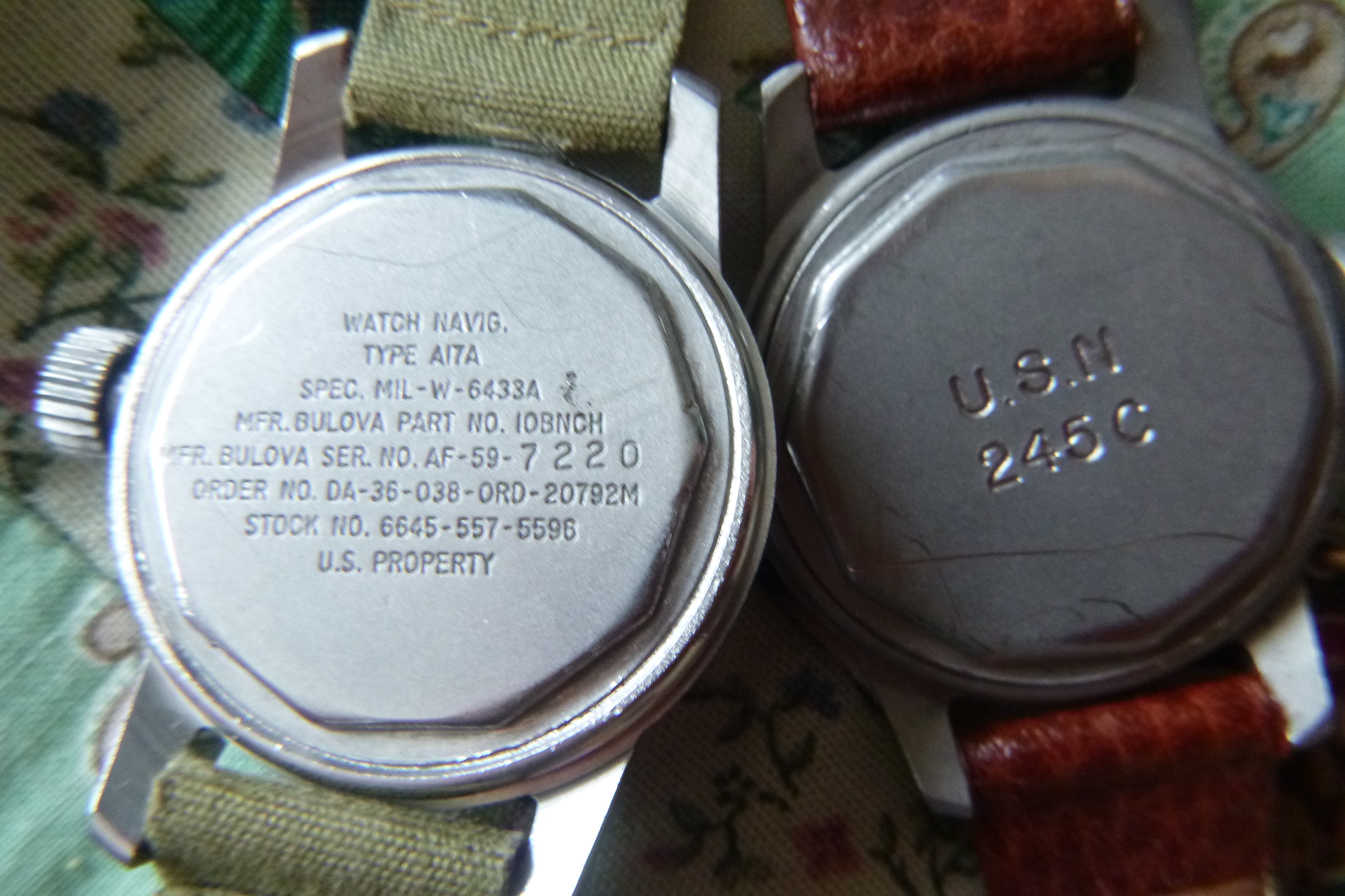

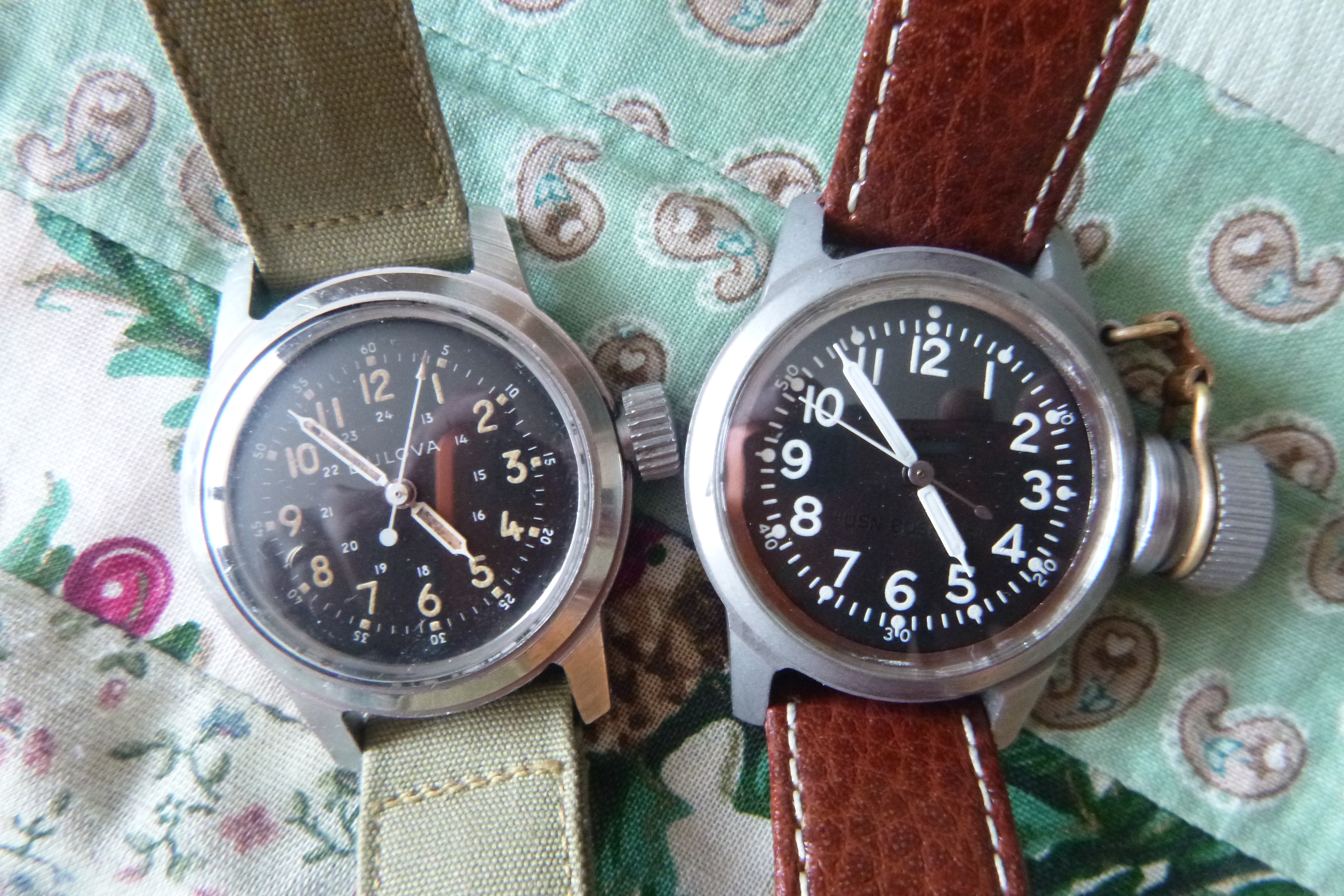

A17A military Bulovas were cased in Star brand cases, as were a lot of the American military stuff from 1940ish through to the early 60s.
Damn I should know that, had completely forgotten, thanks for reminding me.
Really like those parkerized cases.
