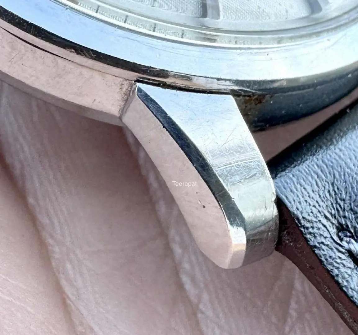

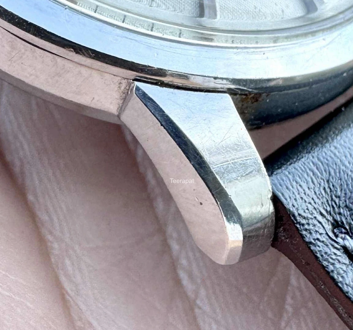

At first glance, when seeing the beef lugs, one would probably think of a Seamaster from the 1950’s.

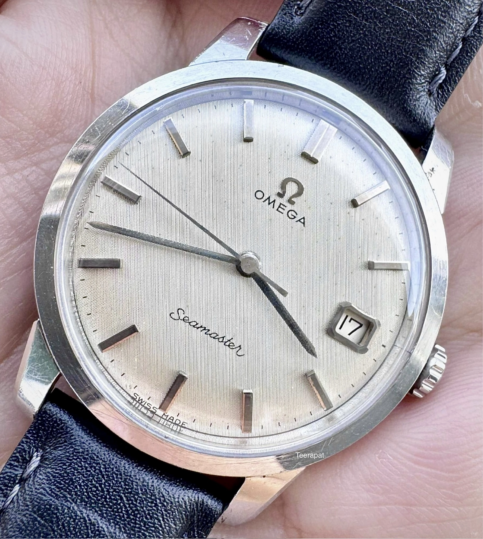

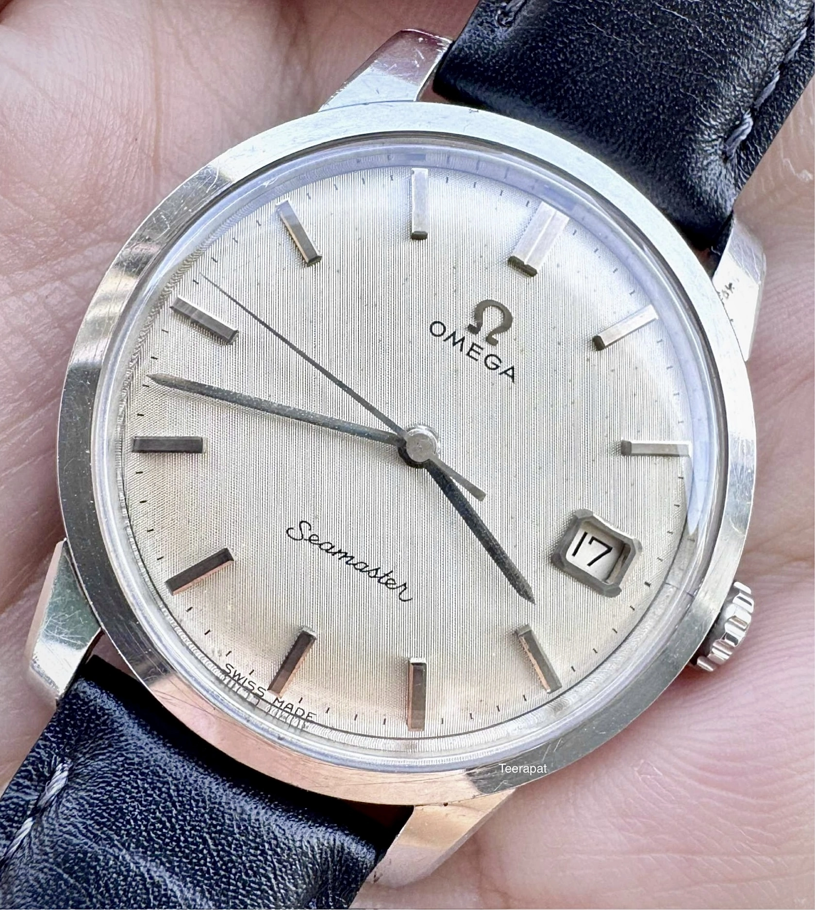

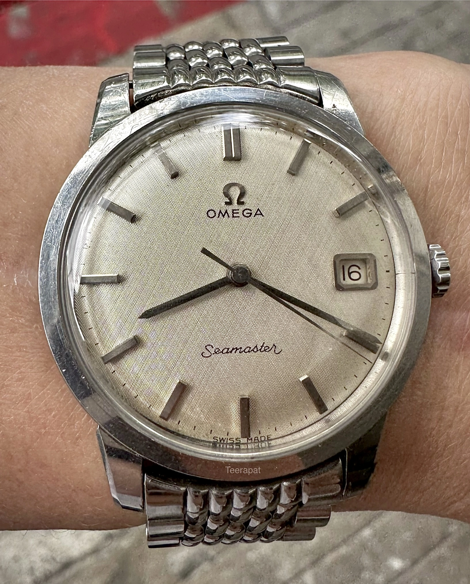

The watch itself

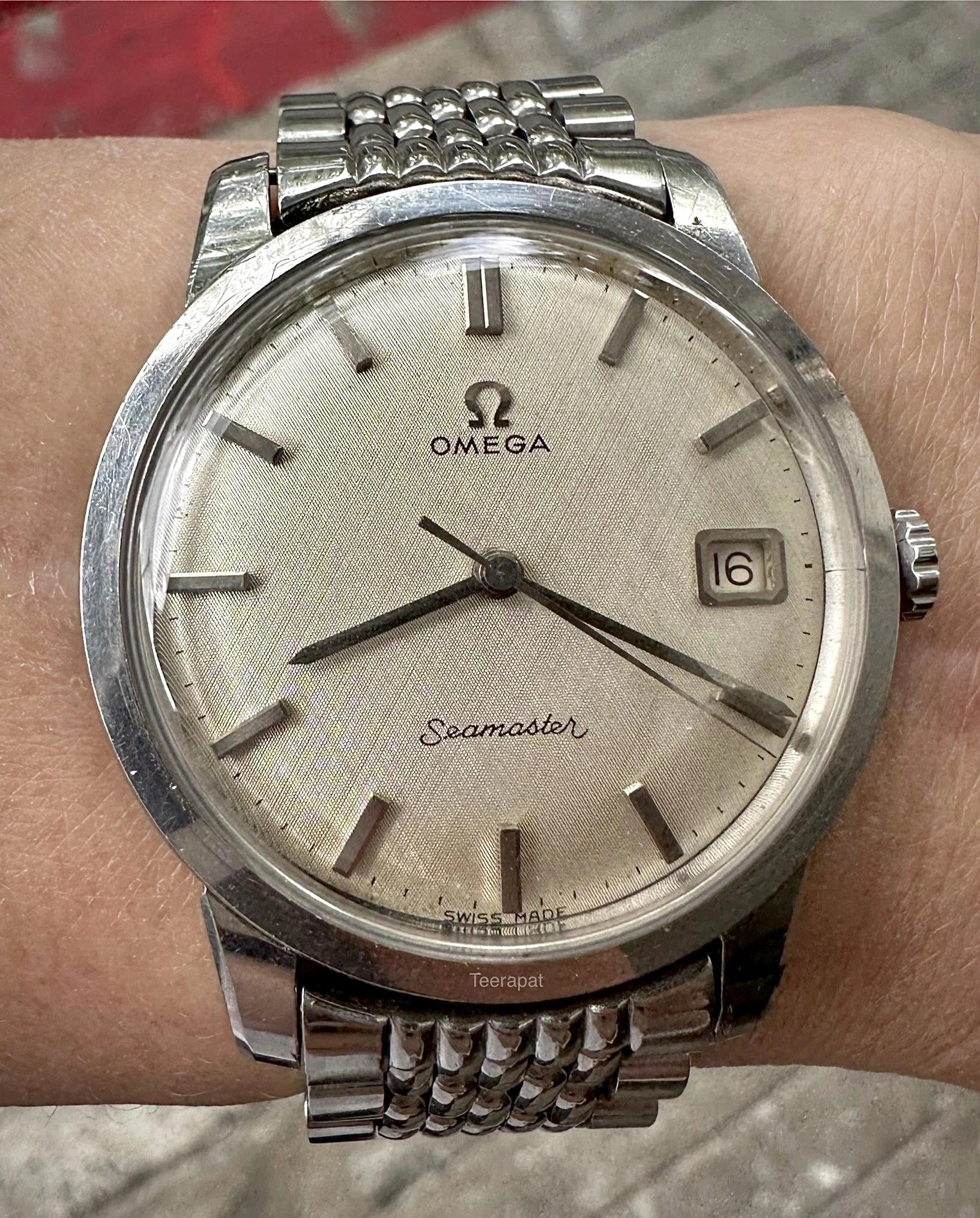

This is an Omega ref. 136.001-62 SC, cal. 610.
The case is unusually large compared to typical models—36.5 mm excluding the crown.

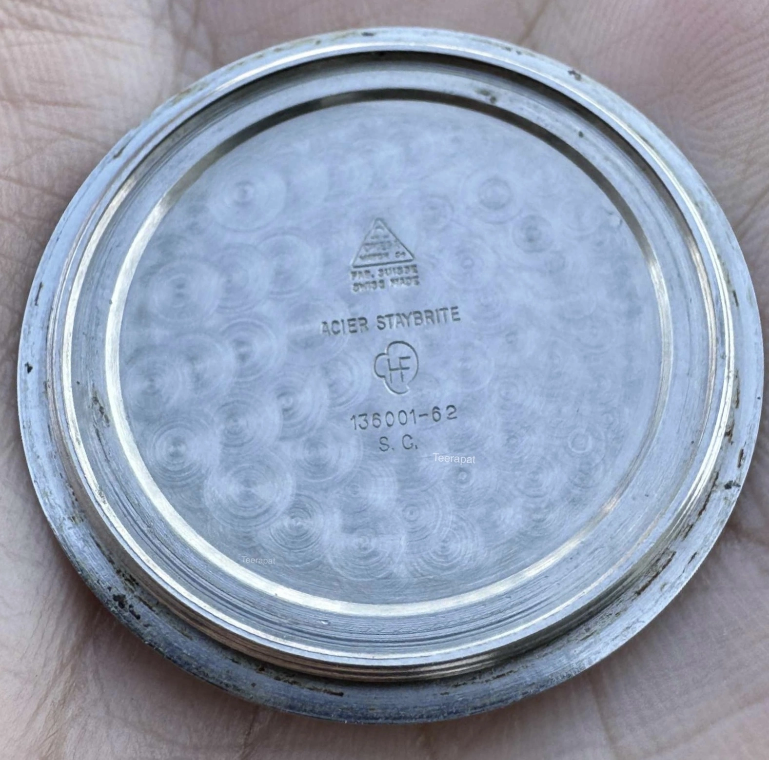

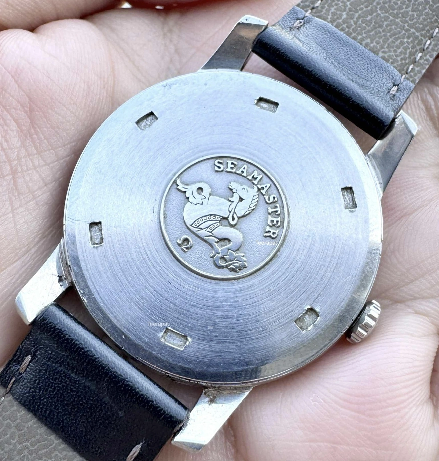

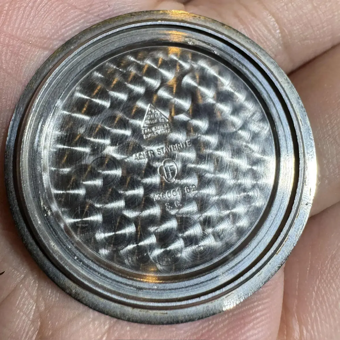

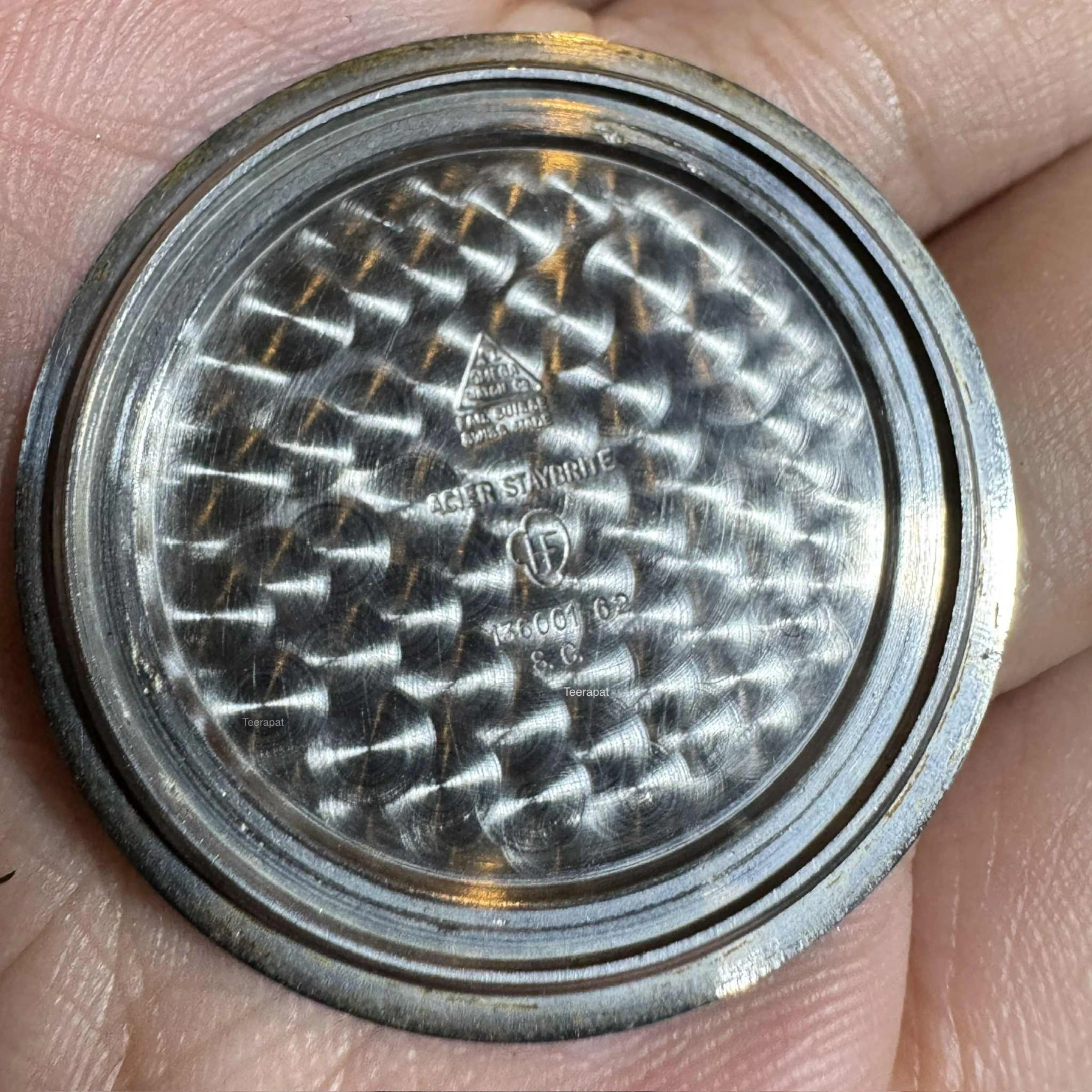

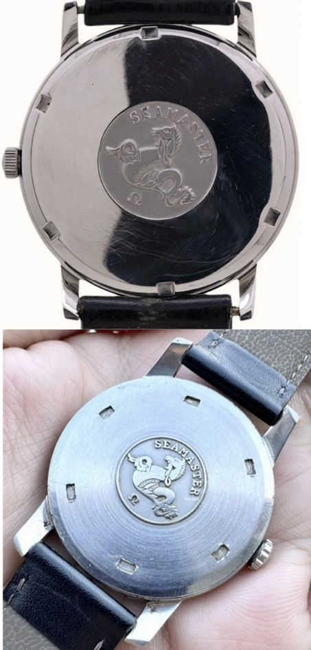

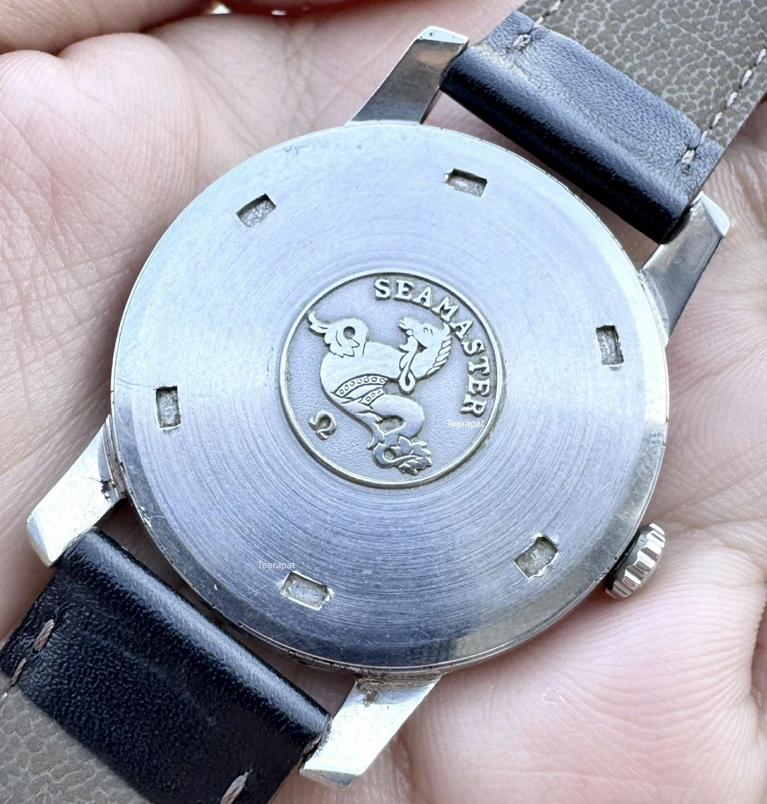

In my opinion, the case is unpolished, with the original circular brushed patterns on the caseback still clearly visible.

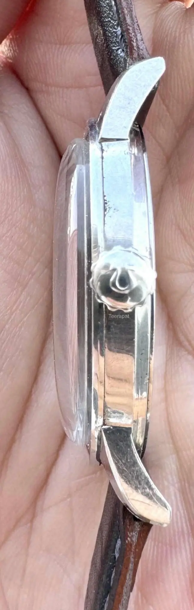

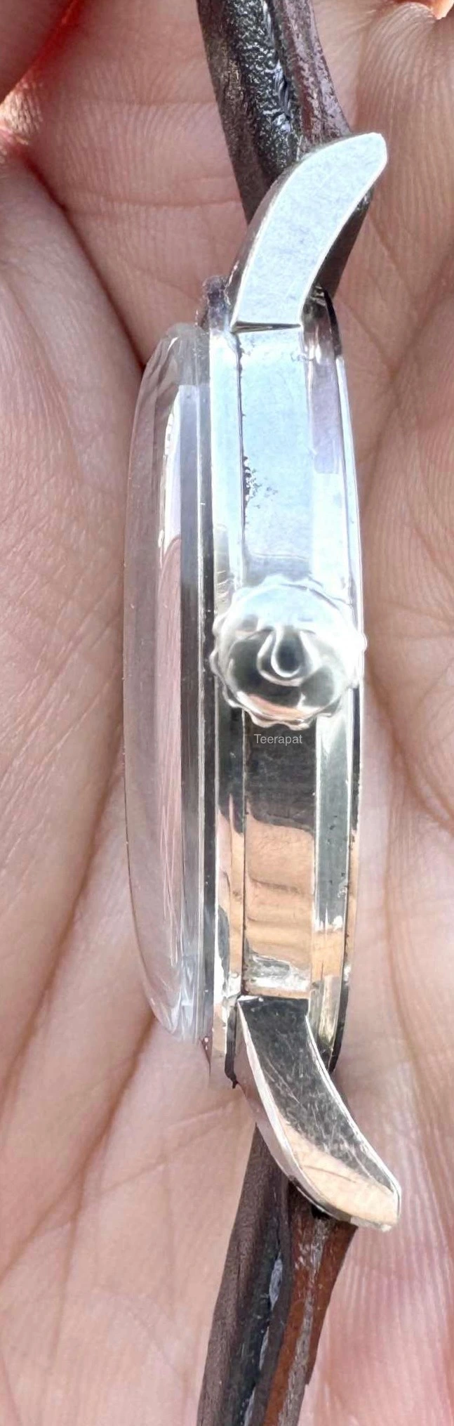

The crown is a thin scalloped type, consistent with Seamaster / Constellation models of this period.

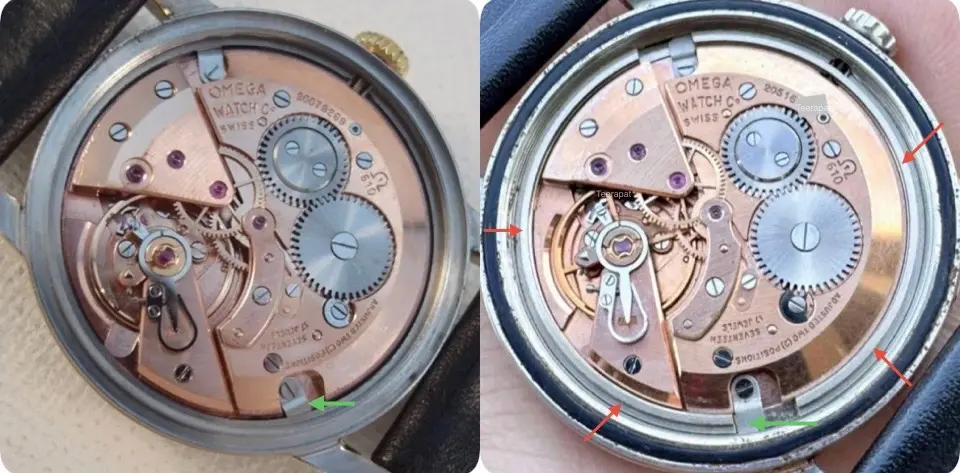

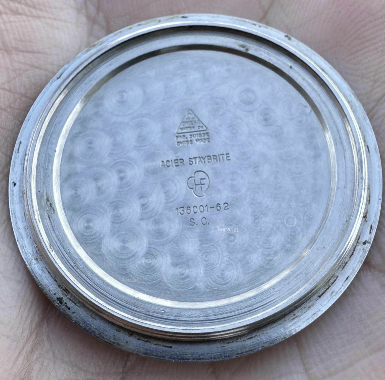

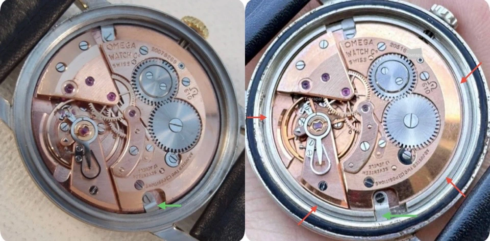

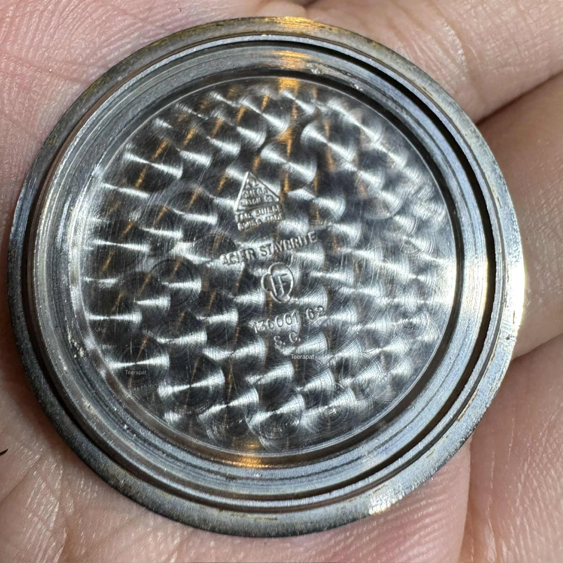

The inner caseback also shows a uniform circular-brushed finish.
One point of interest is the six caseback notches on the outside (used for opening the case). On regular-sized cases these notches are closer to the edge, but on this larger case (my watch), the notches sit further away from the edge.

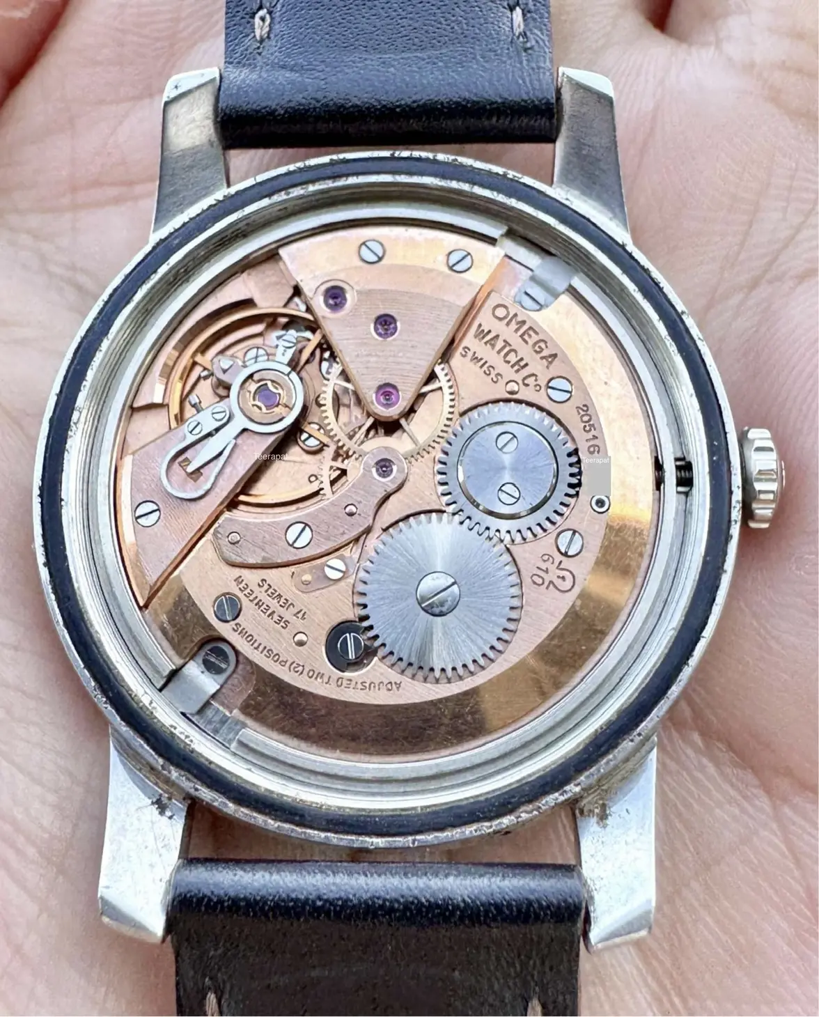

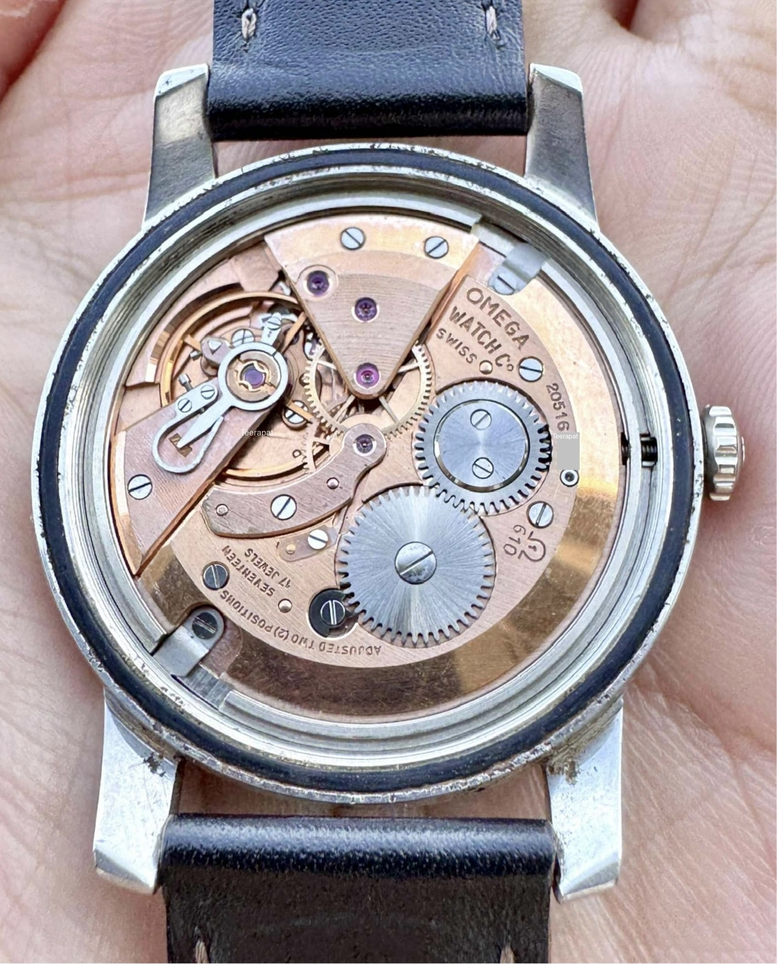

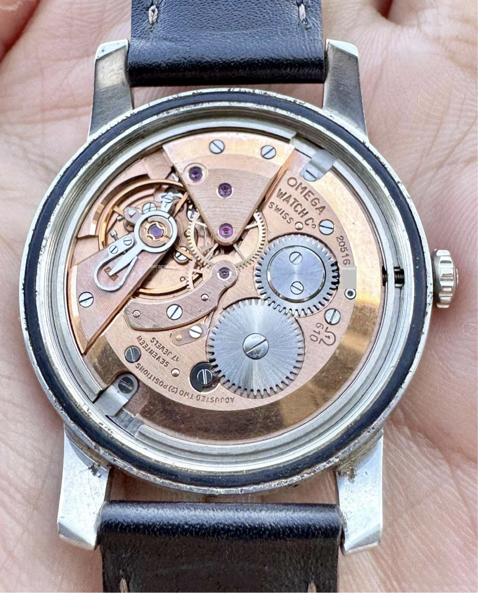

The movement number is 20,516,xxx, which dates it to around 1962–1963.
Please also note: when a caliber is housed in a larger case like this, a movement ring is required to lock it in place (as marked by the red arrows). Moreover, the larger case also requires a longer securing tab (as marked by the green arrow).

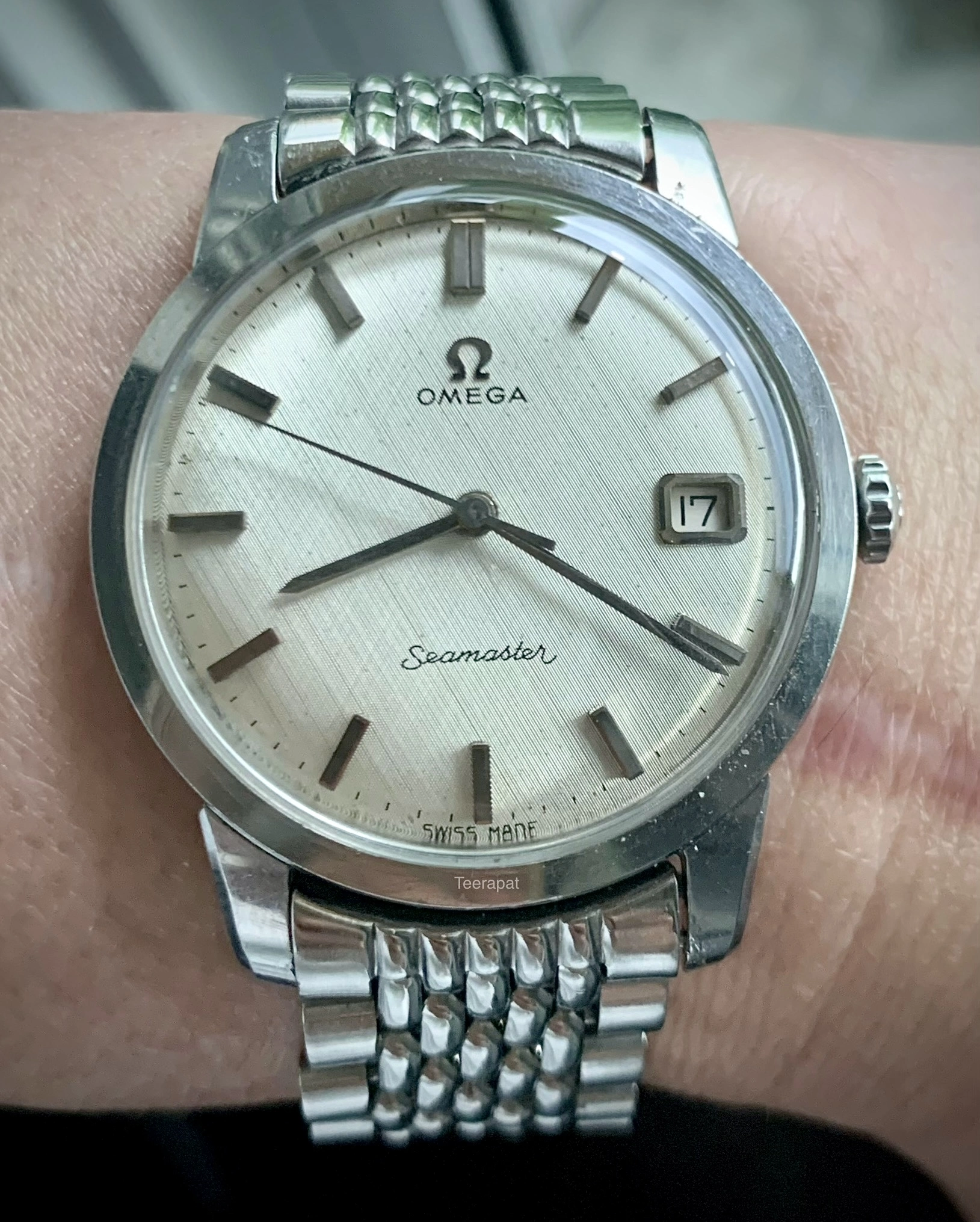

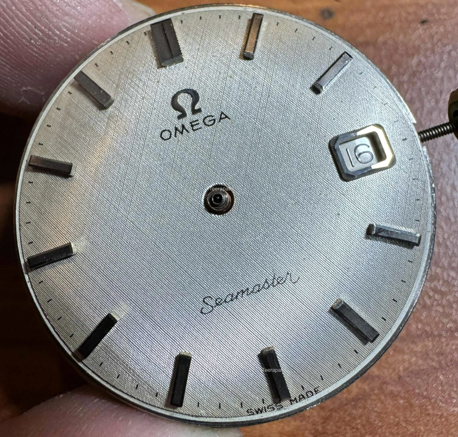

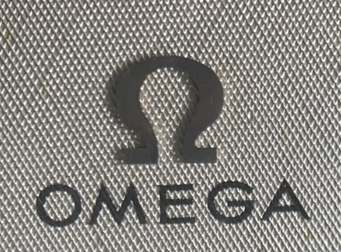

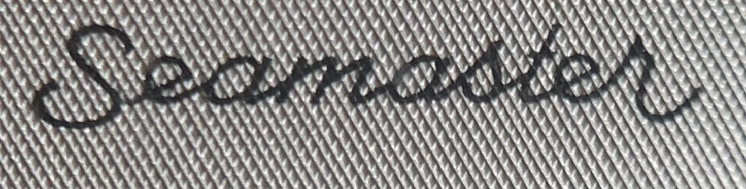

The dial

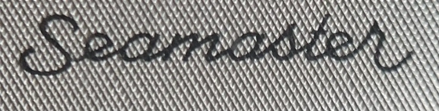

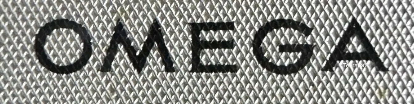

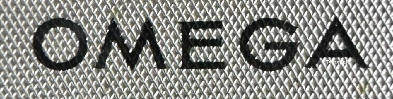

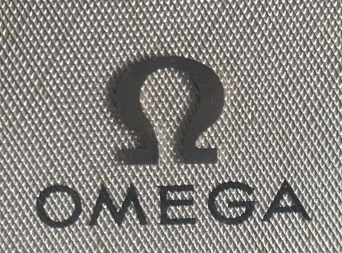

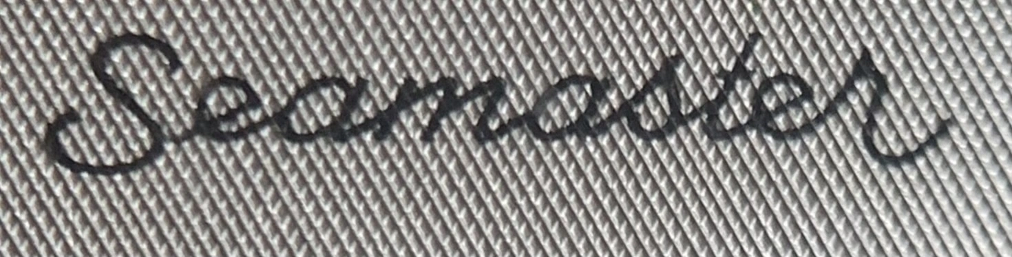

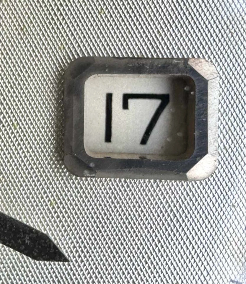

• Features an uncommon ‘waffle’ pattern.
• Clear close-up of the fonts.

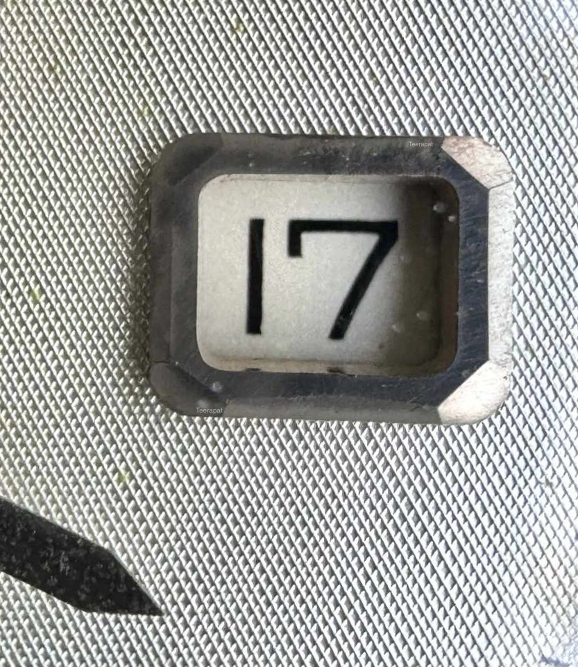

• Close-up of the date window.

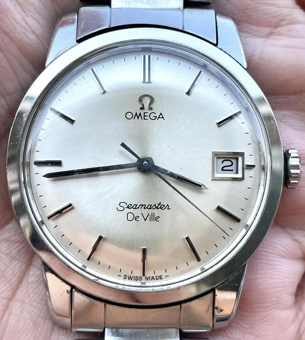

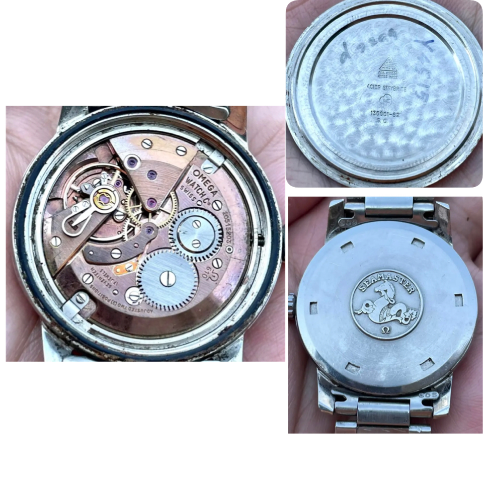

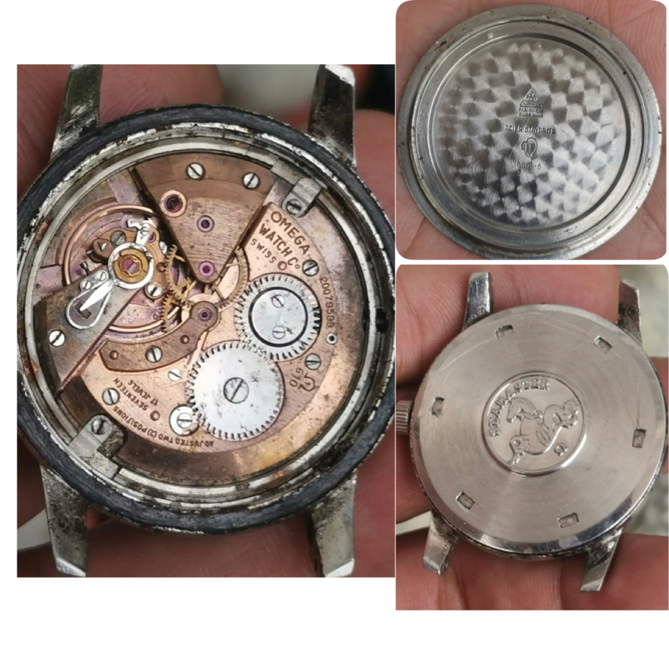

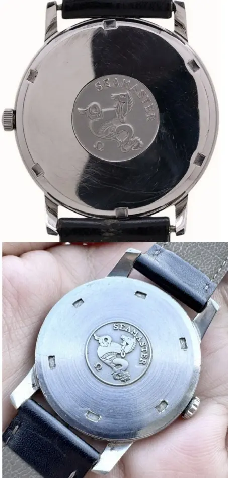

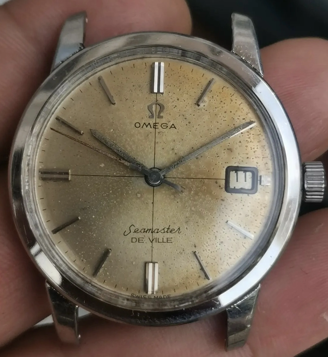

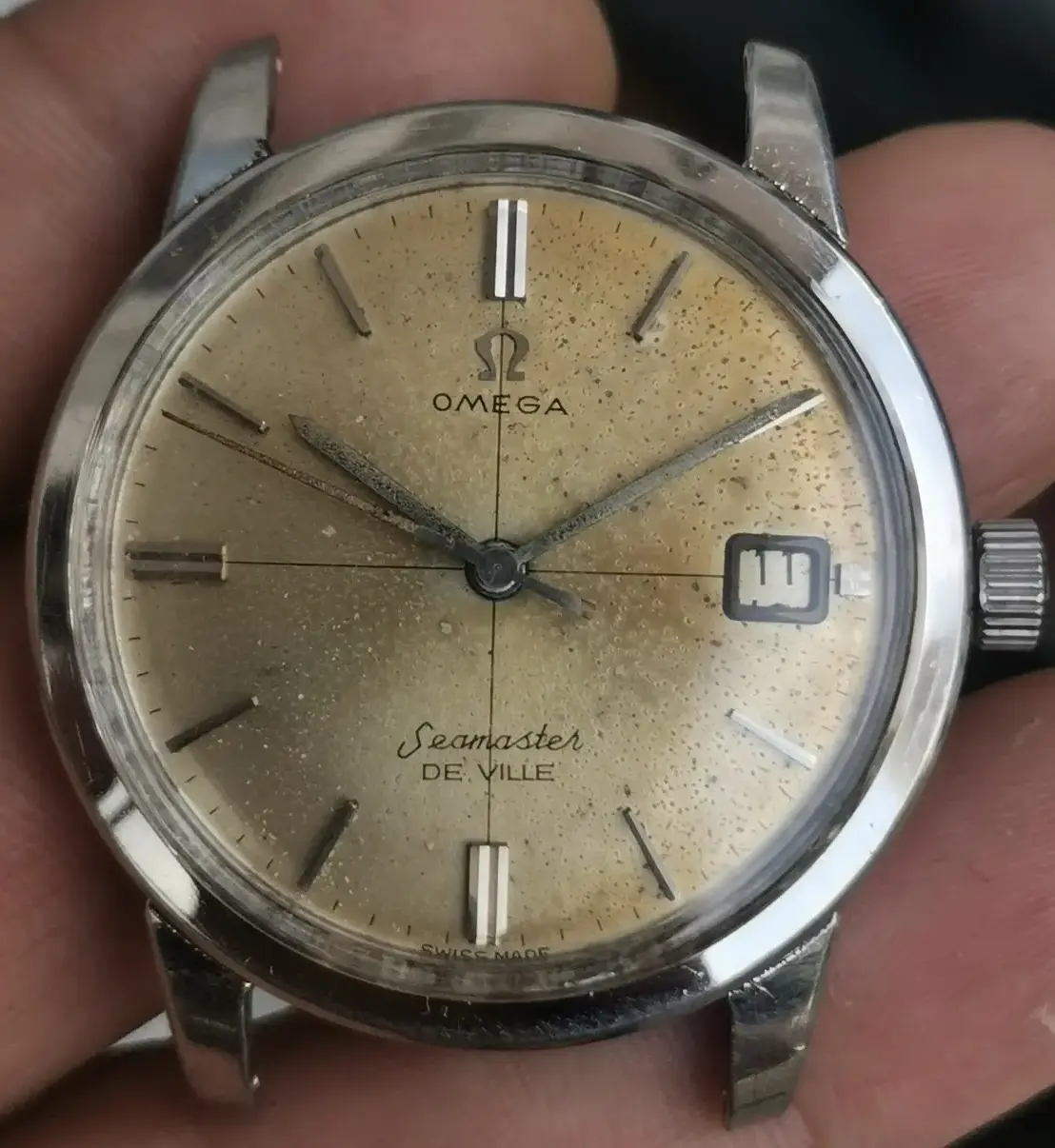

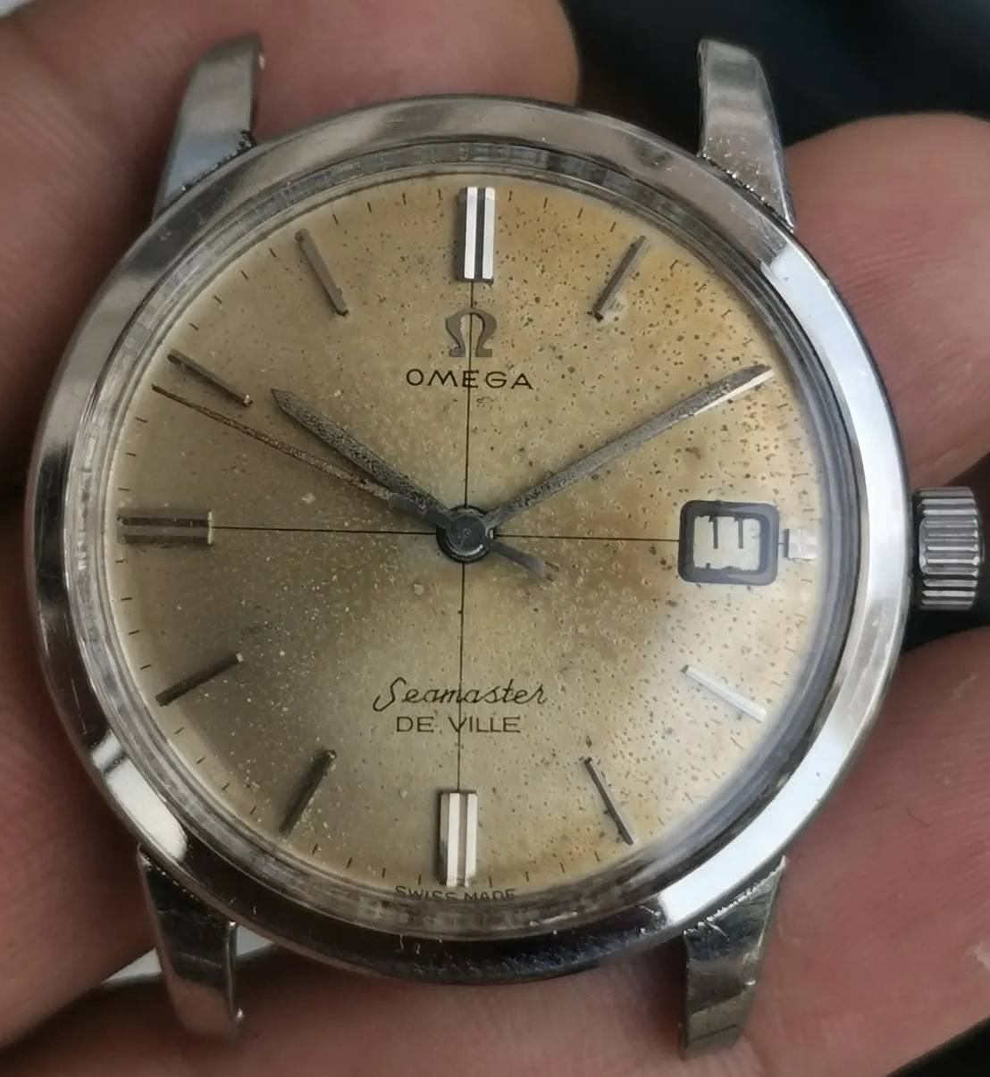

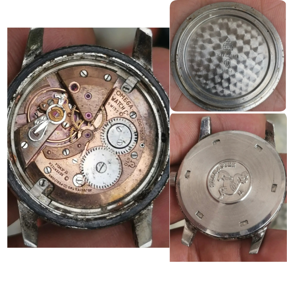

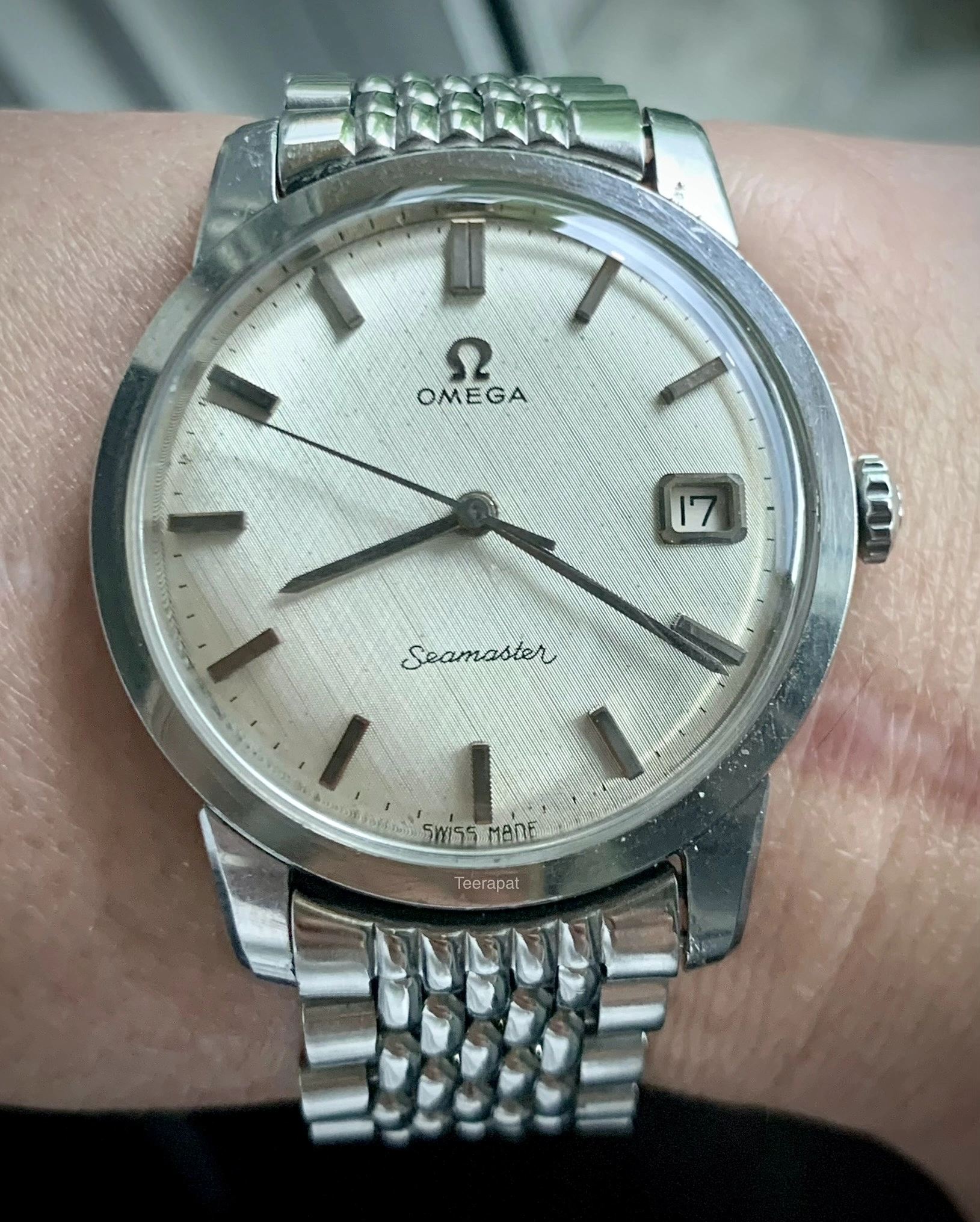

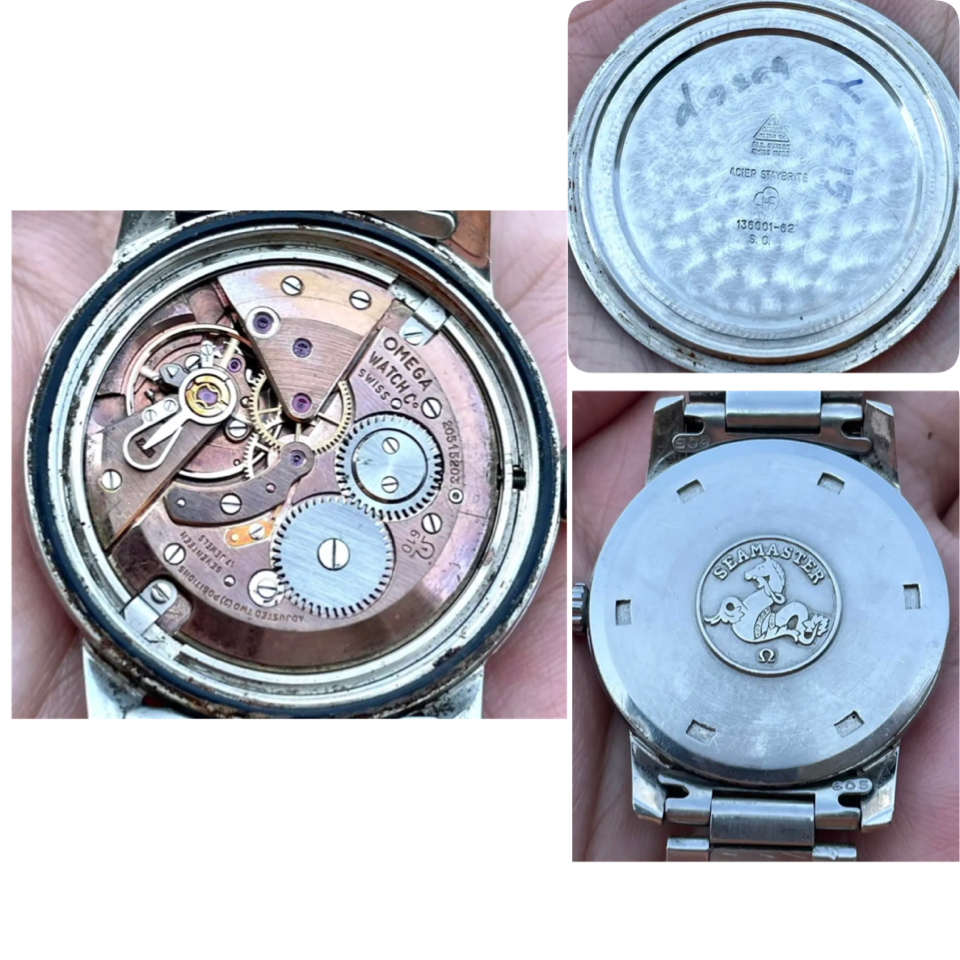

From my research, I could not find any examples of this reference online internationally. I have only seen two other pieces shared on Facebook. I will not comment on the originality of the dials on those two.
Example 1:
Example 2:
However, looking at the similarities in the caseback notch spacing (same as mine), the movement numbers (in the 20 million range), and the same reference (136.001-62 SC) across all three watches, so I believe this reference truly exists in this unusual jumbo case and was produced only for a short period.

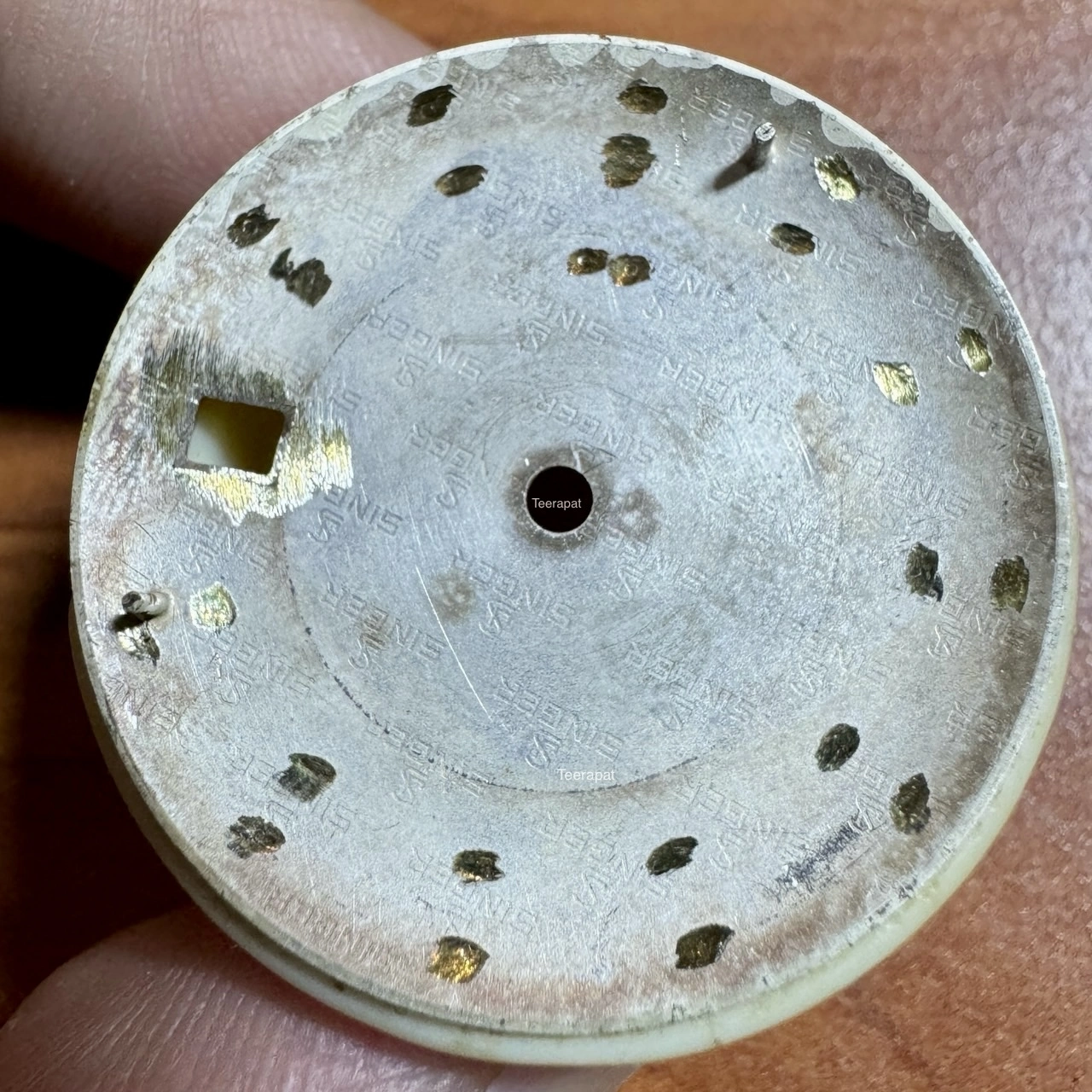

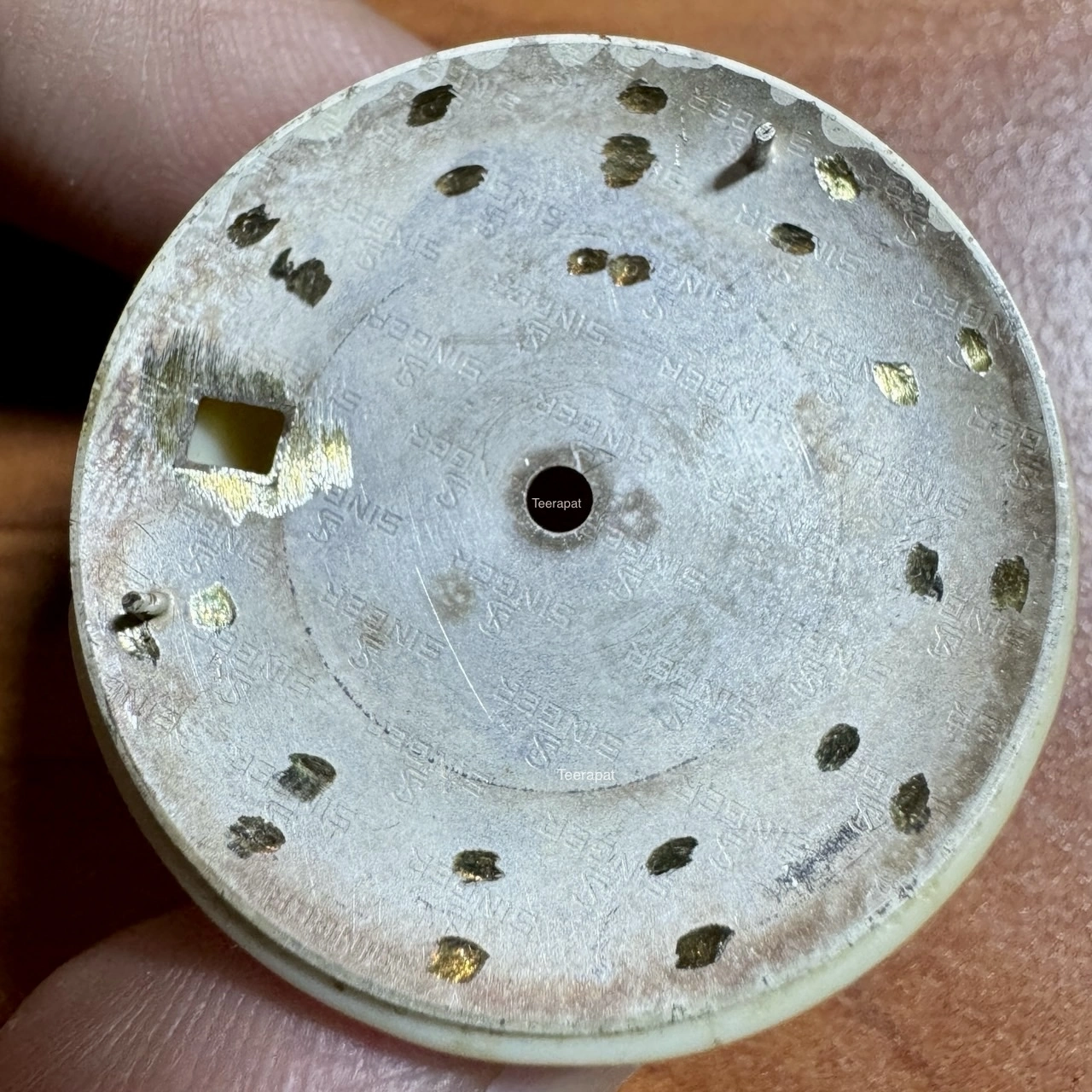

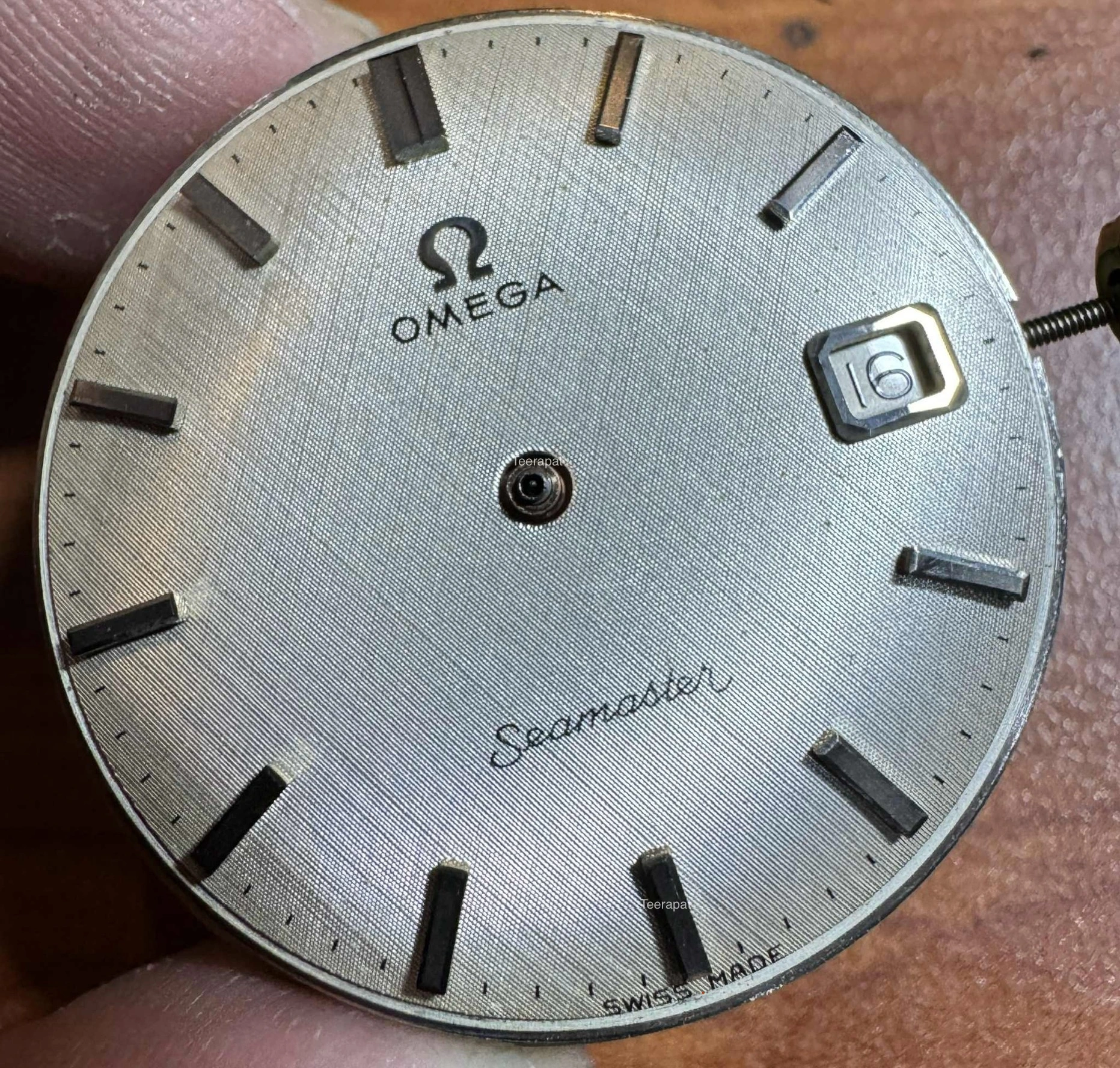

• The full dial, removed from the case.
• The reverse side of the dial, showing original machining marks and both intact dial feet.
Finally, here’s a wrist shot.

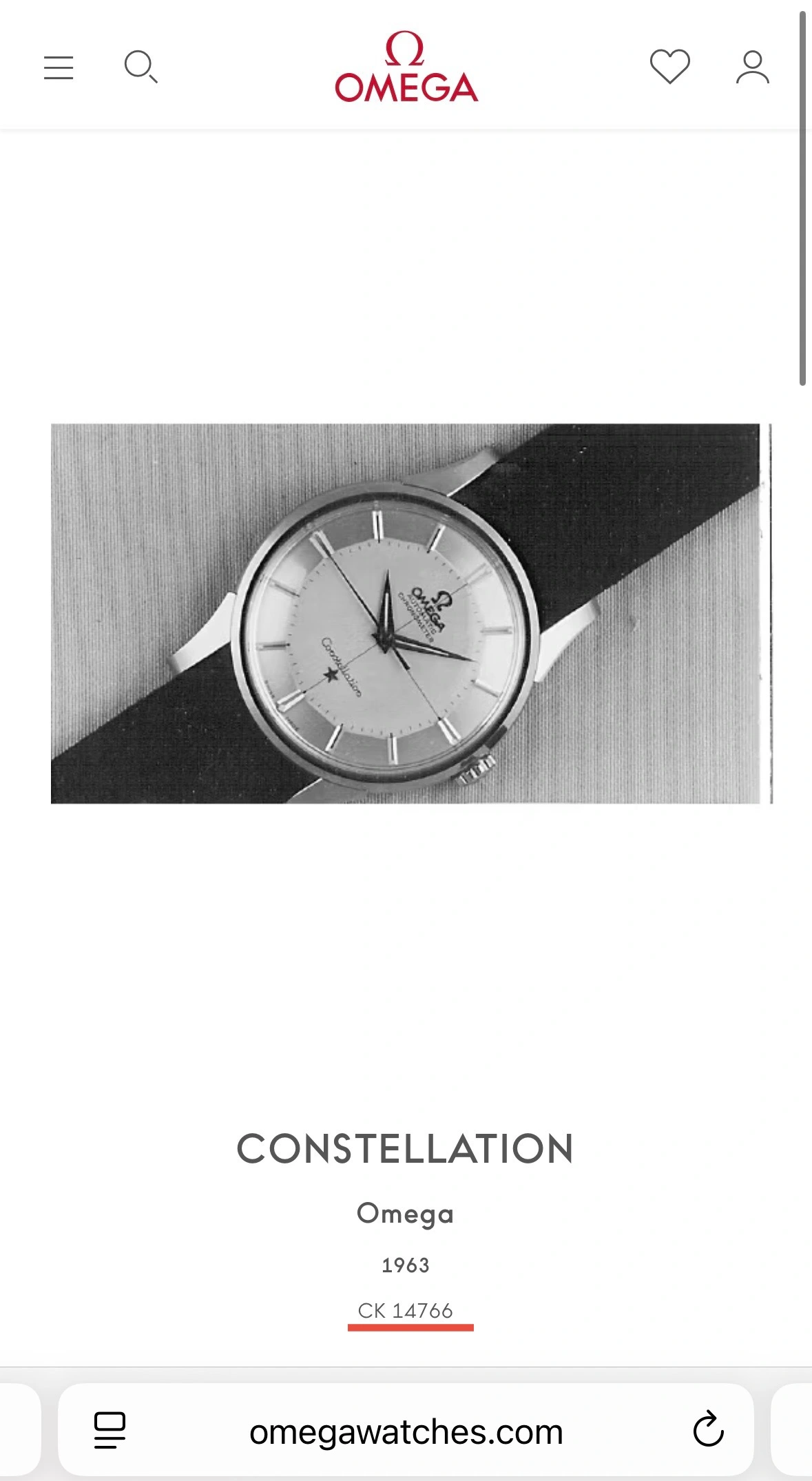

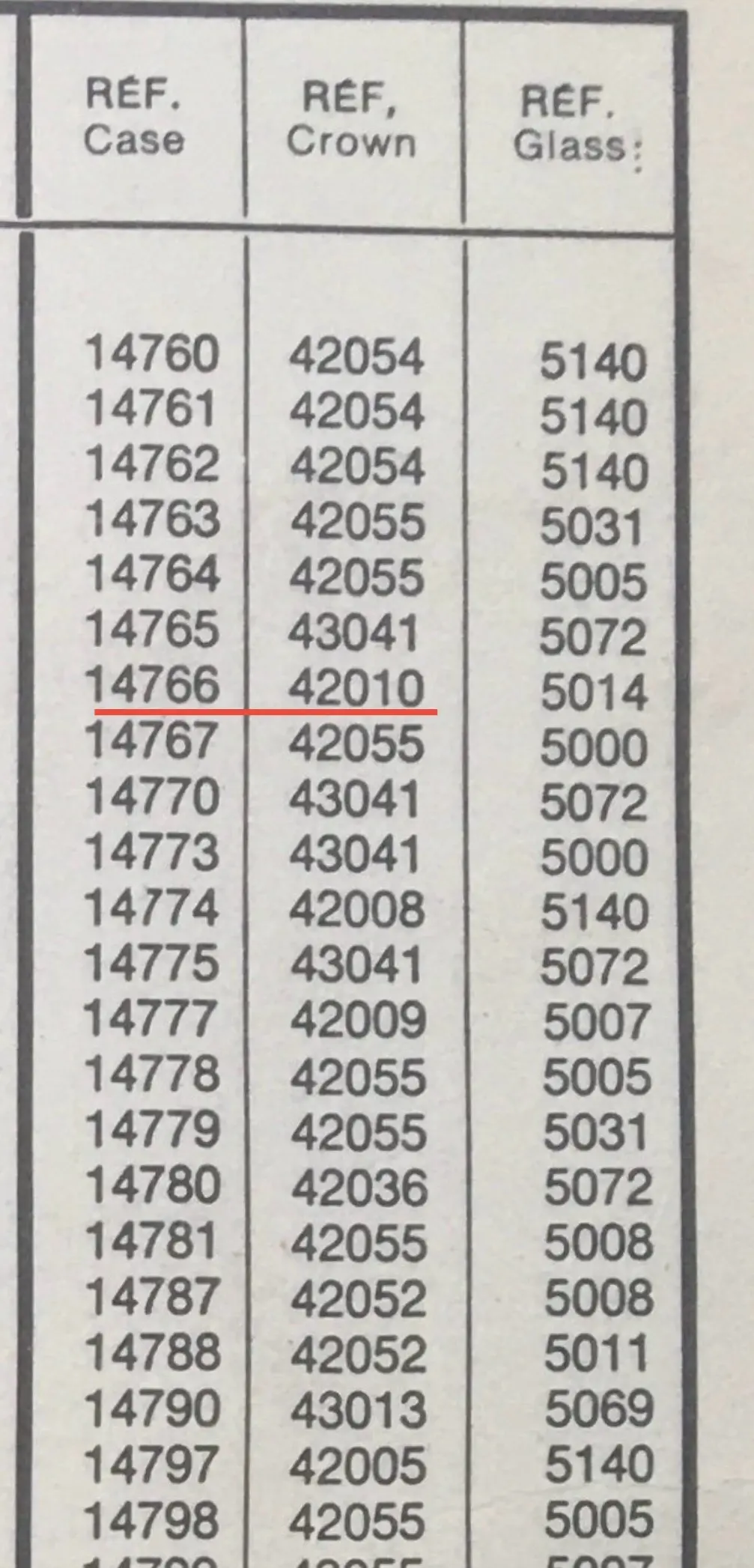

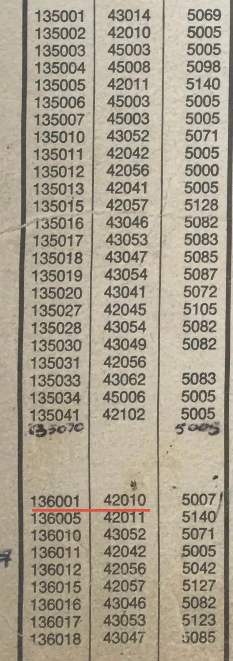

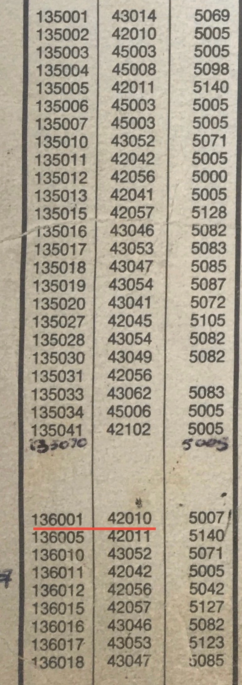

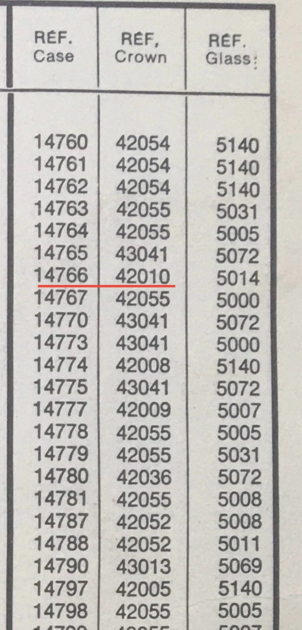

As for the correct crown for reference 136.001, based on the database shared in this forum, it should be reference 42010.

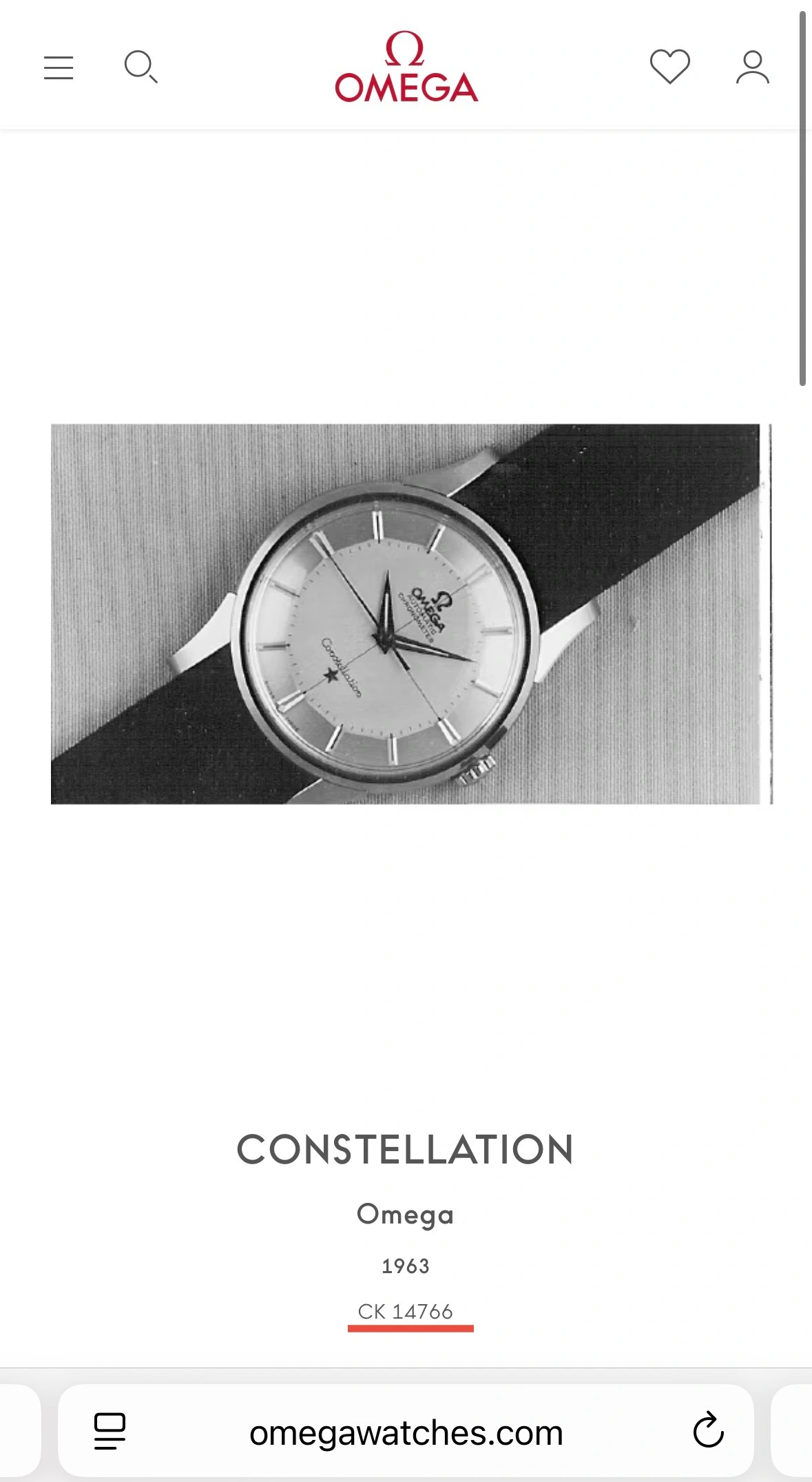

This same crown was also used on reference 14766.
According to omegawatches.com, the picture shows the same style of ‘thin scalloped crown’.

Great write up as usual Teerapat and an unusual find.
Only comments that I would make are:
A 20,5xx serial is likely to be a little later, say, 63/64 rather than 62/63
'Waffle dial' doesn't do the intricacy of the dial justice - it is more like woven cloth.

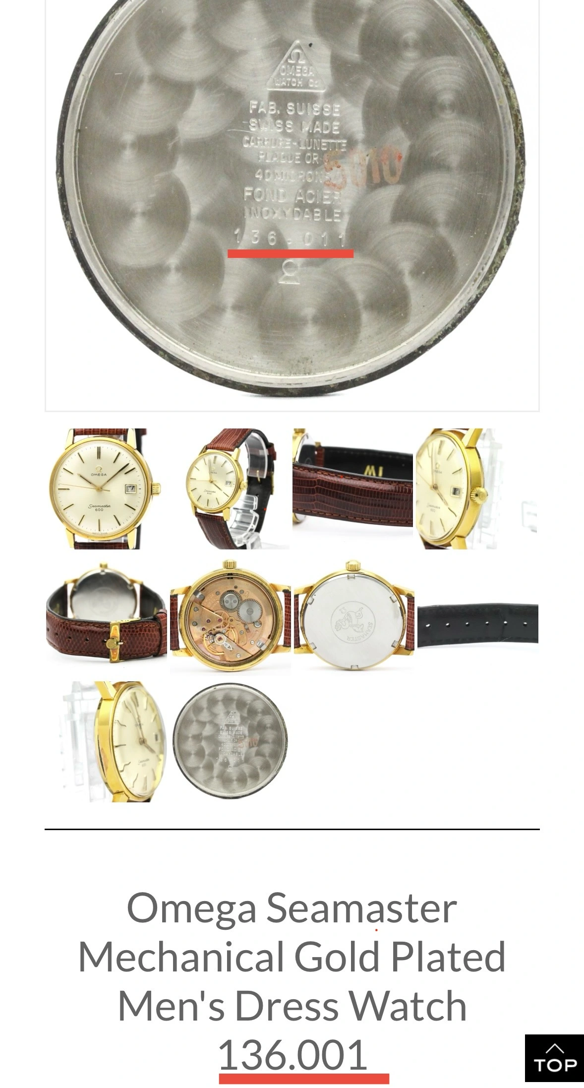

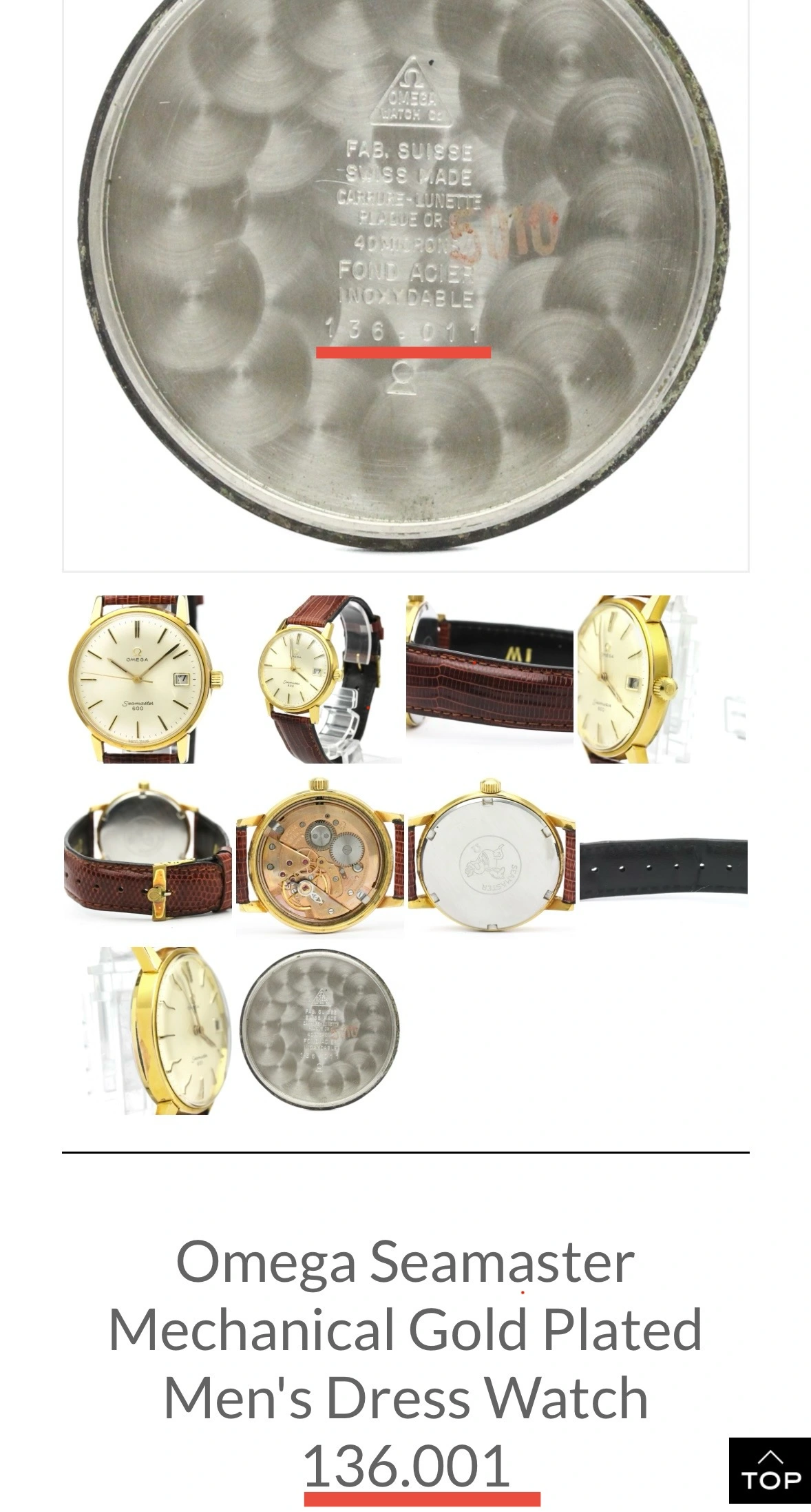

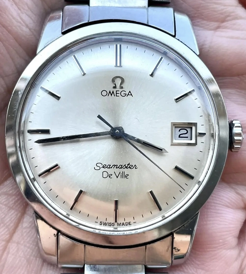

Another important point is that when you Google information about the watch, please click through and verify the details.
I found at least five examples that mentioned reference 136.001, which actually turned out to be 136.011, as shown.

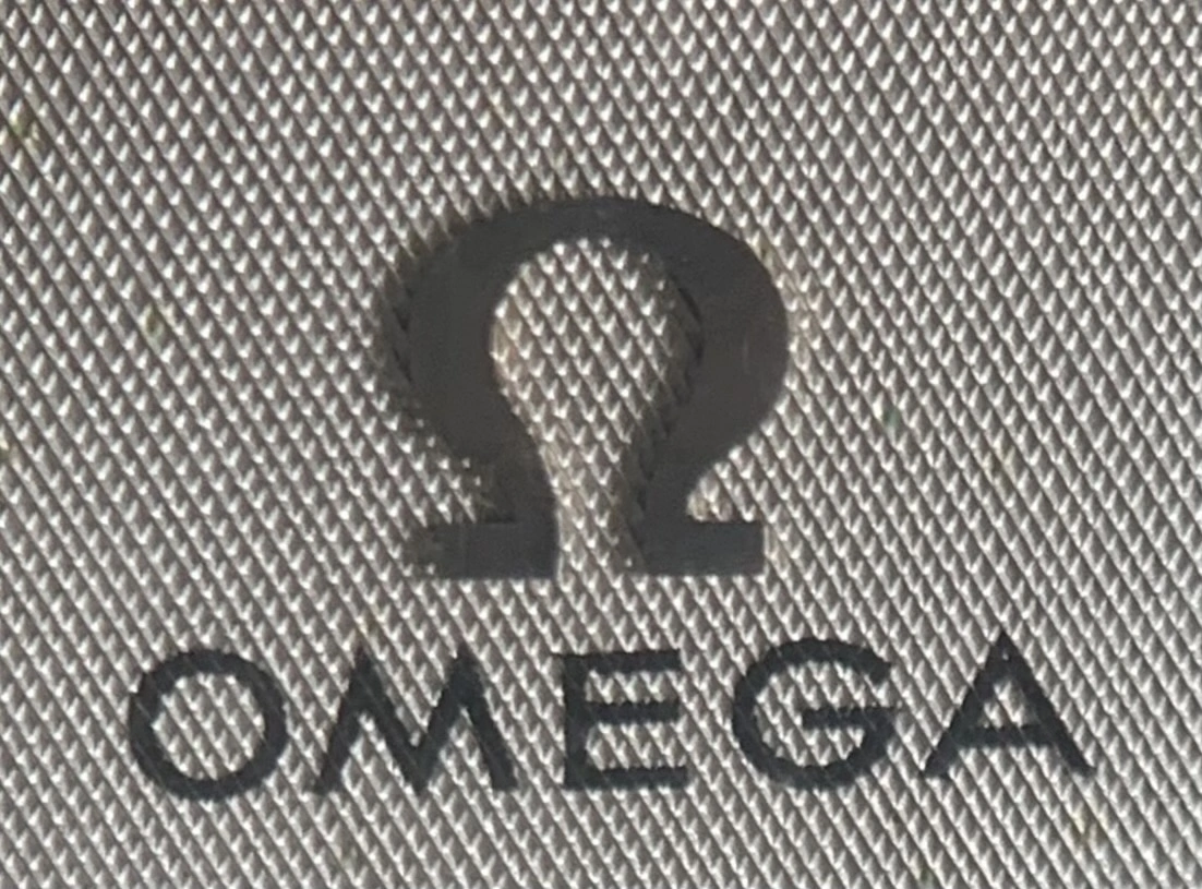

Wow nice acquisition, Amazing to see these dials in such pristine condition.
Great macro photography on the logo and omega text as well - super crisp.
