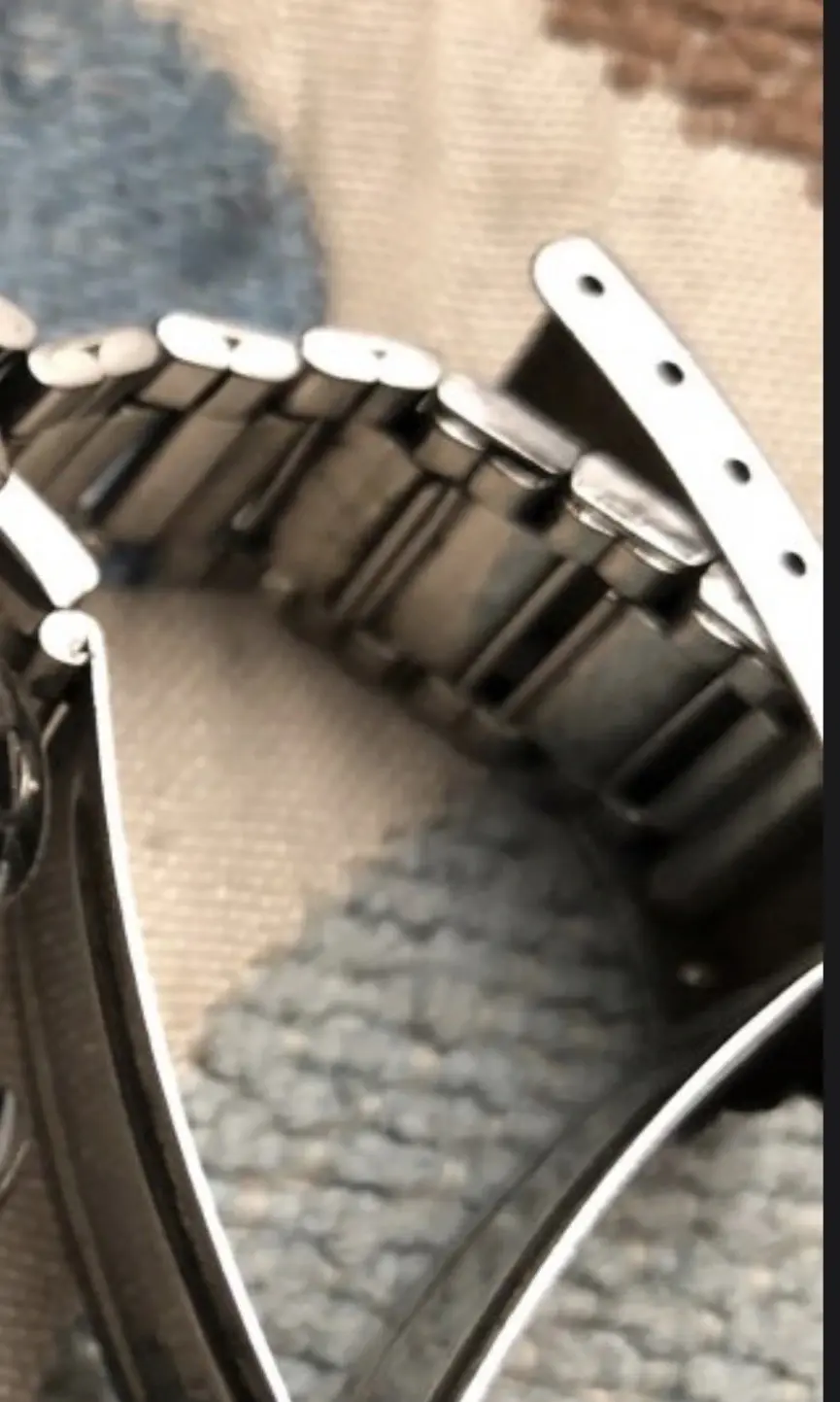

3) what are my bracelet options? The existing one had a lot of stretch and isn’t big enough for my wrists. I would consider a modern one that looks similar or well, anything really!
If you like to keep the original bracelet you can replace the damaged stretch links and add stretch links.
Normal configuration of the 1039 bracelet is: 8 fixed links on eatch side, 4 strech links on one side and 6 on the other.
Most likely you won't need 10 stretch links, maybe 6 will do the job

Ref bracelet size, there are spare links tucked under the clasp, have you tried resizing it using these links?

Re: bracelet options-If you want to keep the same look but with a new interpretation of the flat link 1506, Forstner makes this bracelet.
Let me know if you like. A friend has one in almost new condition he would probably sell at considerably lower price. (See description in link regarding size. Supposed to fit up to 8” wrist or up to 180mm.)
https://forstnerbands.com/products/contemporary-flat-link-bracelet-for-omega-speedmaster
If you want to keep watch as original as possible extra links will not be impossible to source, but will be considerably more expensive. 60 euros each for links would be my guess. (Make certain that the springs in links are not shot or you will be dealing with another problem to fix.) You would have to determine how many links are needed then install or have installed.
There is a dyi post on this forum that includes great instructions and pictures. If you go this route and cannot find post let me know…I can probably find post for you.
It’s going to a watchmaker anyways. I’ve had mine replace spring links regularly and according to him it’s a pretty simple procedure. Wasn’t particularly expensive either.

Changing spring links on a flat link bracelet can seem daunting but it’s actually really simple.
Do a search in this forum as there is a thread somewhere for how to do it yourself. Spare links are occasionally for sale in the parts for sale sub forum.
Personally, I don’t see a watch with this history on a modern replacement bracelet.
I’m not sure, but you may be confusing spring bars (the parts that connect/secure a bracelet to the lugs of the watch case versus springs inside the links which allow the bracelet to have a little stretch between each link. I hope that I have not insulted you, but that’s what I inferred from the comment you made about having watchmaker “replace spring links regularly”.
You have not insulted me.
But I am not confusing spring bars with the springs inside the stretch links. „Spring links“ might have been misleading though.
I stabbed my own thumb with the pointy end of a Burgeon 6767 trying to adjust my 1039 a while back, but that might just be me being an idiot
I didn’t use anything sharp. I used a small watchmakers hammer and a small block of plastic with sharp sides to gently remove the back plate on several links which allows them to be removed without damage.
There’s a thread somewhere in OF with pictures. I’ll try and dig it out.
This??
http://www.old-omegas.com/bracadd.html
