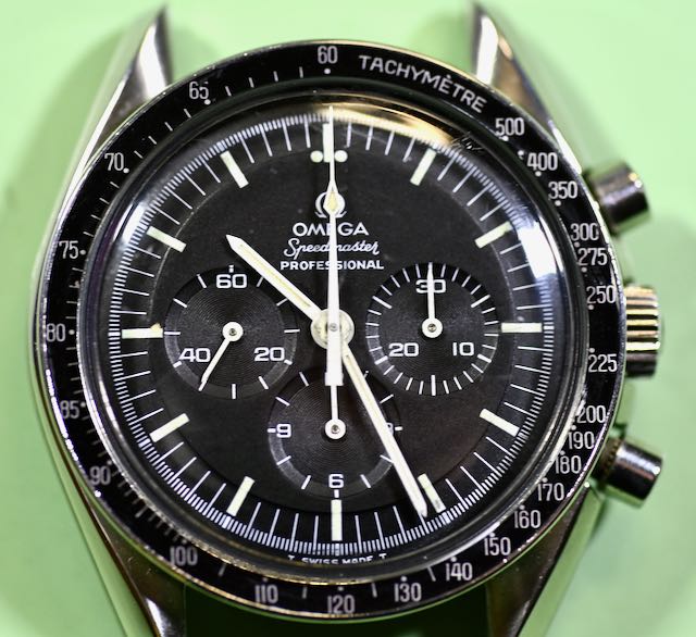

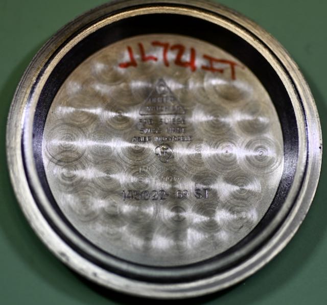

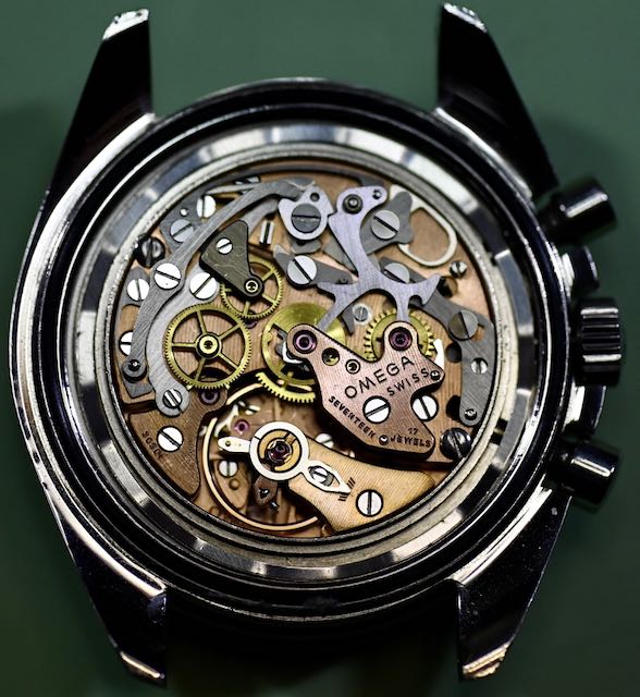

Here are some pictures of the new to me Speedy and even though I know it is probably not all original I’m very happy with my acquisition. One question, when I removed the back to get the serial number, I noticed there was no dust cover, I’m guessing it should have one correct?

I am sorry to hear that your watches were stolen. Myself, and others on this board have had that happen and know what it feels like. Looking at the date of your deployment (68/69) and the date on the inside of your new Speedy case (69), I would say you now have a pretty close cousin to your original watch. I am no Speedy expert...the dot over 90 bezel and the stepped dial look nice. It looks at first glance you have done well, but I will let the experts weigh in. Happy New Year
24,819
55,191
Looks pretty much original to me at first glance, certainly everything important is there, except for the missing antimagnetic dust cover. Congrats!

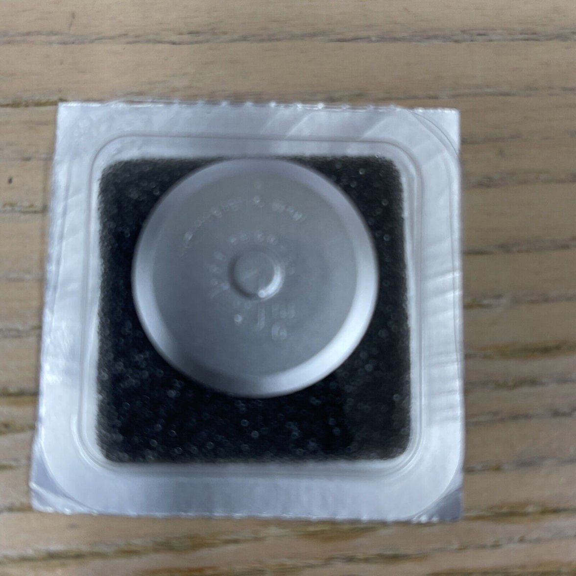

Found this for sale, sorry about the poor picture but, does this look like the anti-mag cover I need?

That appears to be a compatible dust cover, although it's obviously hard to see much in that photo. Without the cover, the movement can potentially flop around inside the case as it is moved, especially from dial-down to dial-up positions. You might get away with it, but the most conservative thing would be to leave the watch resting dial down.

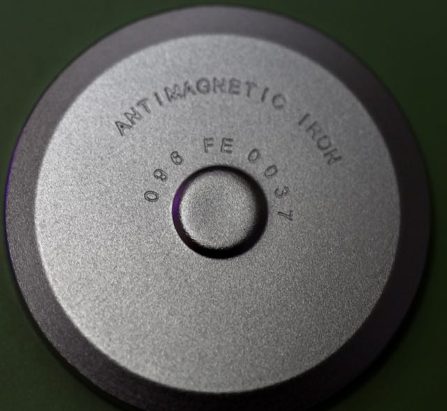

This is the anti-mag cover I acquired for my Speedy. Does it look like the correct one and what should I watch out for during installation?
30,231
78,057
Yes, that’s the right one for a Speedmaster...there are several different ones for all the watches Omega made with these. Should just fit snugly on the enlargement ring. Apply some silicone grease to the case back gasket before installing the case back again...

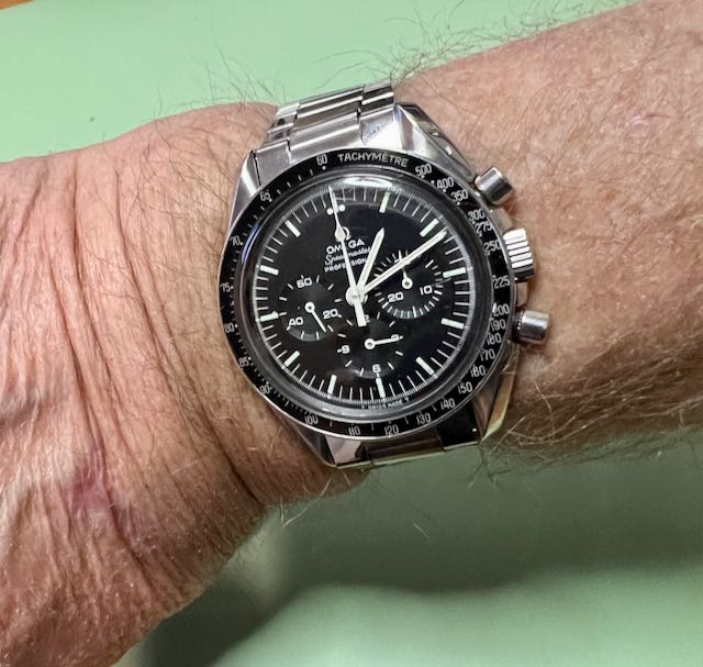

All back together and on my wrist where it belongs. Many thanks to all who helped me get this back together. 😀

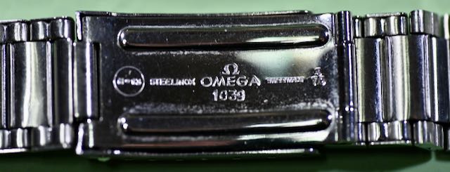

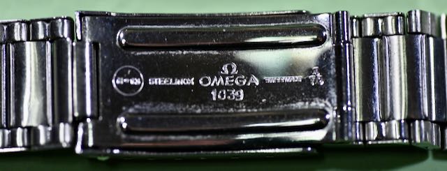

Another question if I may? When I purchased this Speedy the dealer told me the original 1039 bracelet with 516 end pieces were fragile and very expensive to replace. He gave me an 1175 with 640 end pieces. The watch looks good on the 1175 but, I really like the 1039 much better. Is the 1039 really that fragile and if I had an issue with it is it really that expensive to replace or repair? I know, a real first world problem. Thank you in advance for any suggestions.
495
1,209
Gorgeous watch and great story--nice conclusion, too.
The 1039 isn't what I'd consider fragile. It's old, and it's less substantial than modern stuff, but I personally have never broken an old bracelet, particularly not a 1039. In terms of replacing it: yeah, it's expensive to replace ($1500 or so, last I checked). Regardless: just enjoy it, and wear it in good health. A whole lot of Speedmasters (and Seamasters, etc) were worn *very* hard, for years, on 1039s.

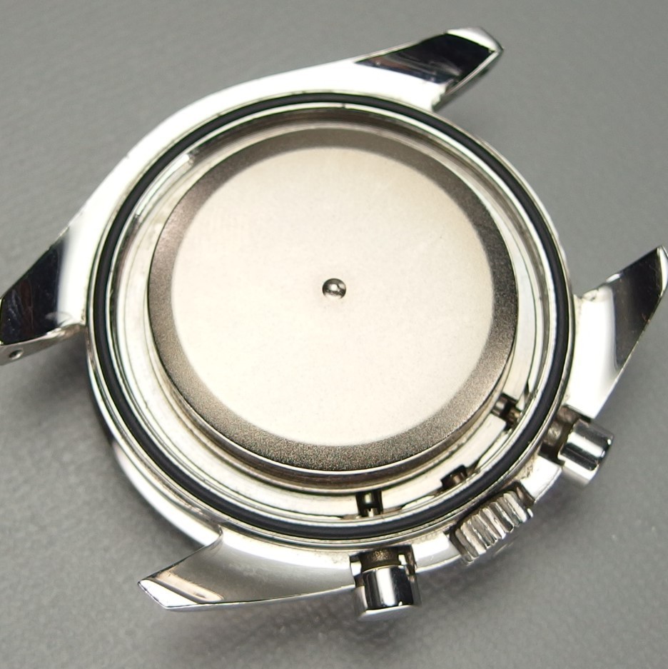

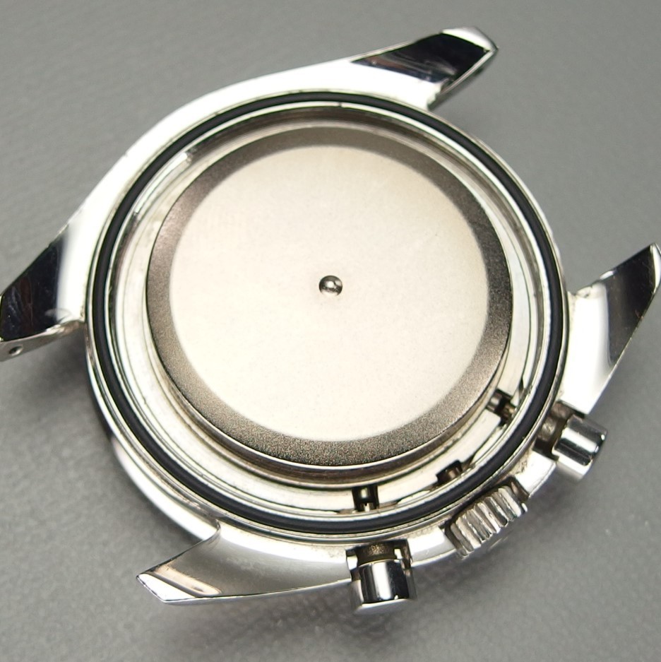

Very nice 69 speedmaster! Congrats! But I think the dust cover should be a small nipple one. See picture.
Thank you for your input, I chose the one I got based on this site.
https://omegaforums.net/threads/speedmaster-dust-cover-evolution.13504/
Your thoughts on this please. I'll gladly look for the correct one once I understand which of all the possibilities would be the correct one. Again, thank you for your knowledge sharing.
OOps, my bad. I went back and re-read the page and you are correct. I'll start my search for the correct cover and keep this thread updated on my progress. Many thanks.
