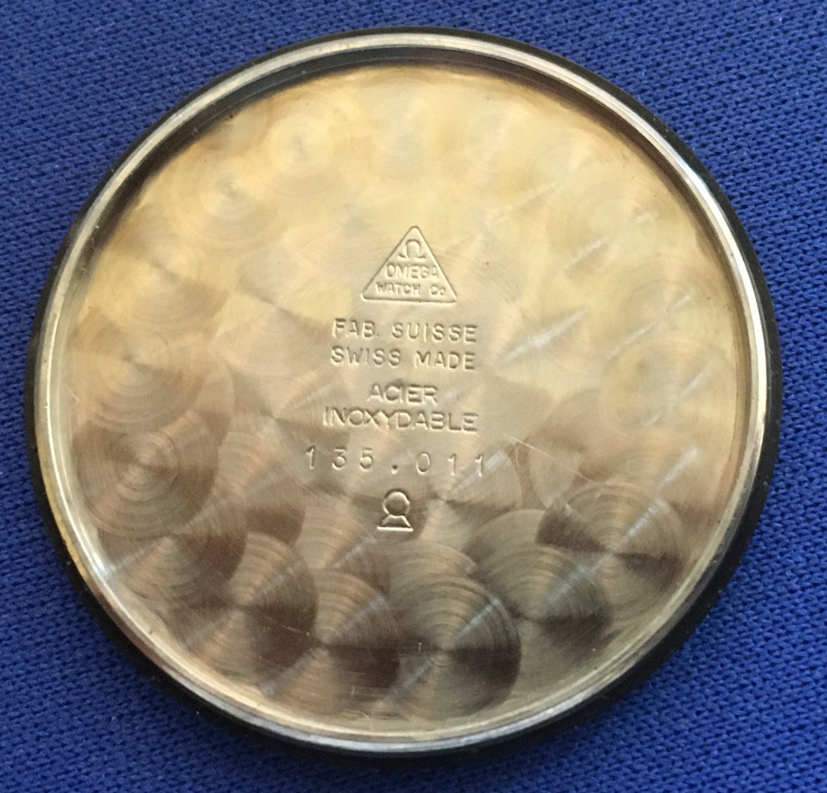

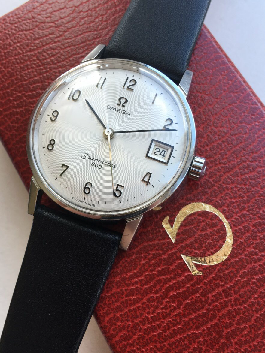

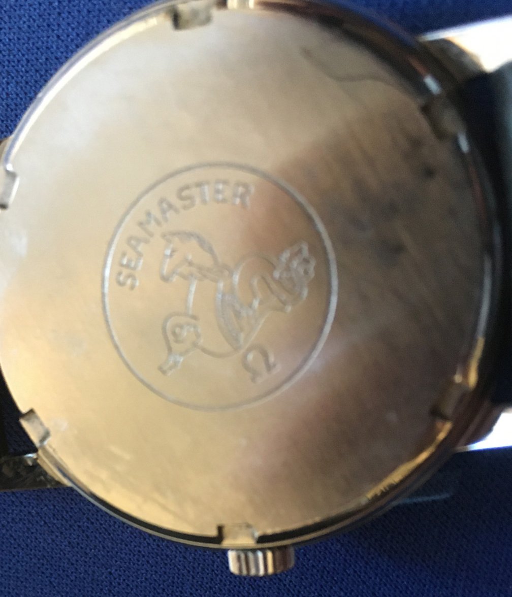

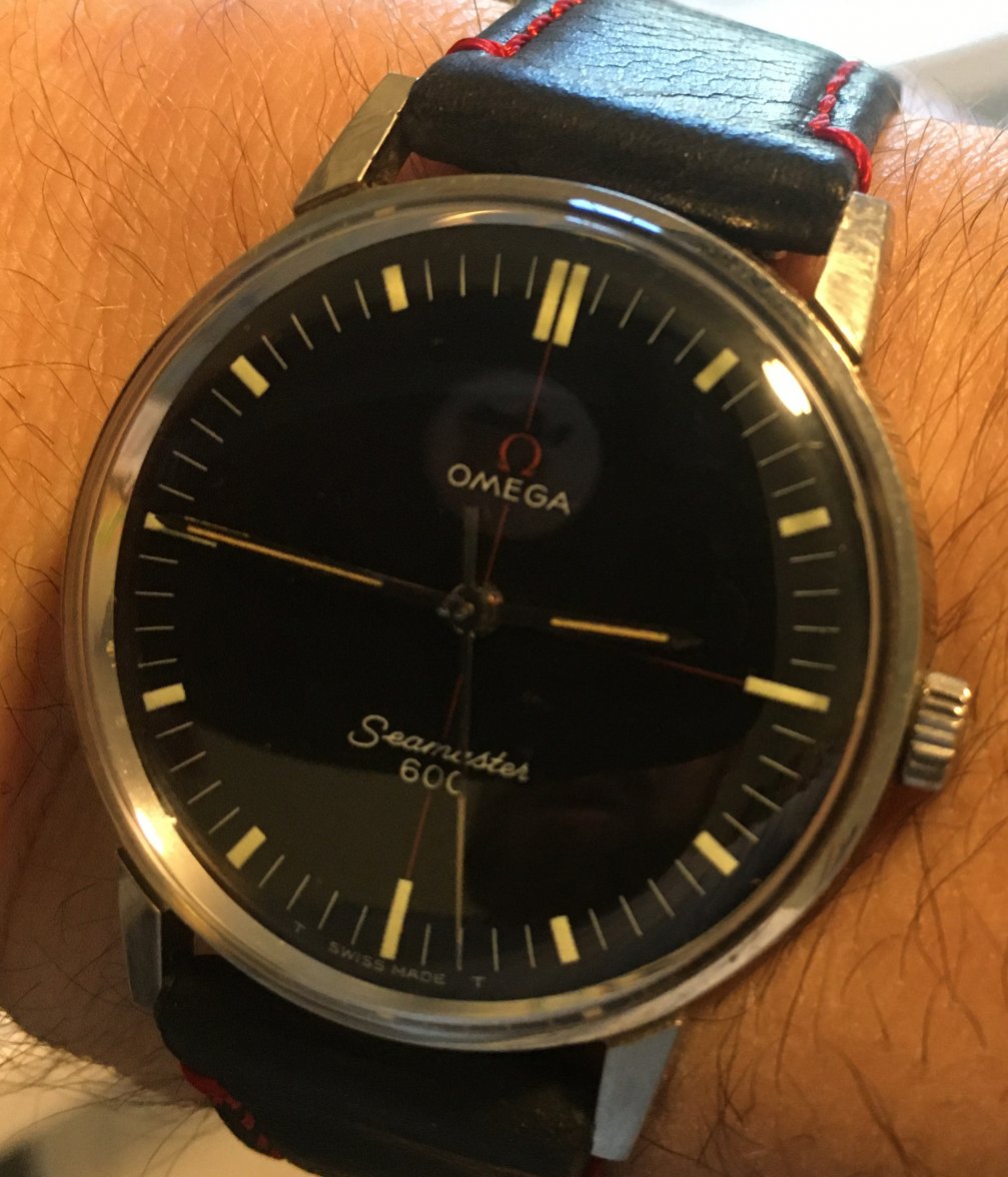

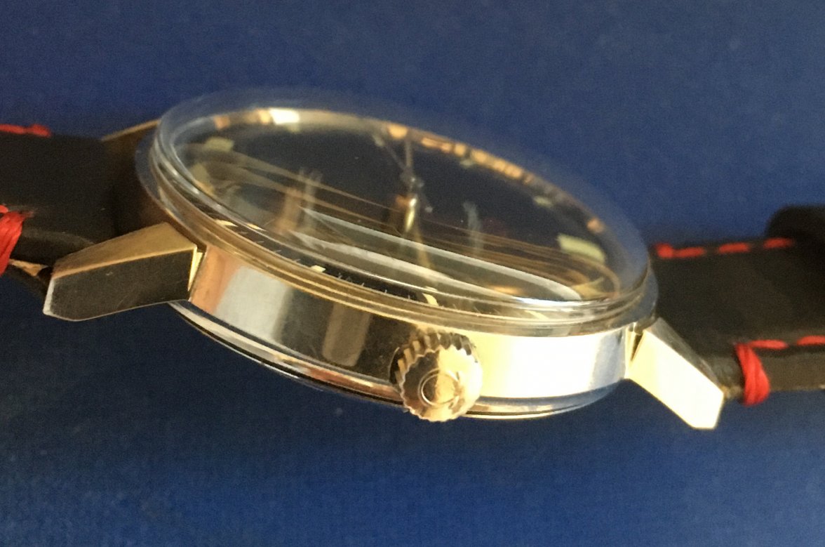

Been loving my 1965 Seamaster 600 w/ the black technical dial. Such a beautiful watch, and my first foray into Omegas. Won't bother posting images here as I provided a full complement with my earlier post and I don't want to needlessly duplicate and use up unnecessary server space. Earlier post.

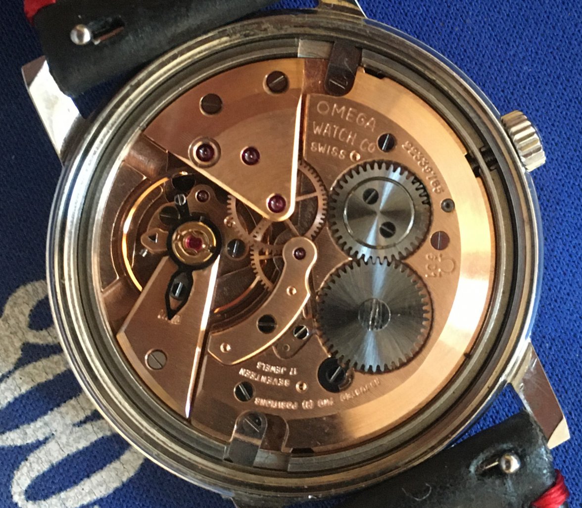

It does look a lovely watch and a nice clean movement, apart from the ratchet wheel screw - probably just the picture, so, you'll probably want to hang on to it.
