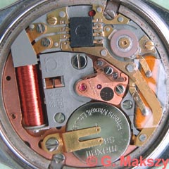

Hello,
I just bought a vintage Omega Quartz (196.0066) with a 1310 caliber. This one delay about 15-20 seconds per day, the battery is a Renata 1,55V. Do you think that the battery is bad for this caliber ? According to my watchmaker the mouvement cant be repaired.
Thanks a lot.

The battery wouldn't be causing this problem, no. These watches have a trimmer, 15/20 seconds is high but if it's regular you could try some trimmer action to see if it helps. That type of drift is not normally indicative of a problem with the circuit.

Thanks a lot, i didnt see your reply before. i'ill try to see that, but how can i adjust myself the trimmer ? (i'm begginer).

Does that model,of Omega quartz have a trimmer? I am not familiar enough with that model, to know. I suspect the watch is stopping momentarily, creating the impression it is losing. If that is the case, adjusting a trimmer is unlikely to remedy the problem.

Yes the trimmer is the round thingy top right. You need a special key to rotate it normally but a small screwdriver can do the trick too. I think turning it left will slow it down, don't quote me on this though. I don't think the 1310's trimmer is as crazy sensitive as the one on the 15xx but don't turn too much.Without a quartz timer it's not easy to make adjustments of course.

Yes but with a very light touch, these things can break.

I just tried to turn the trimmer on the right as the little arrow indicate (1-2 turns) . The watch working after the manipulation. I ll tell you if the problem is resolved. Thanks.
