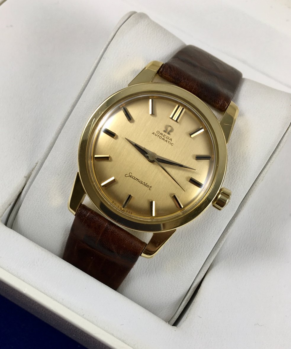

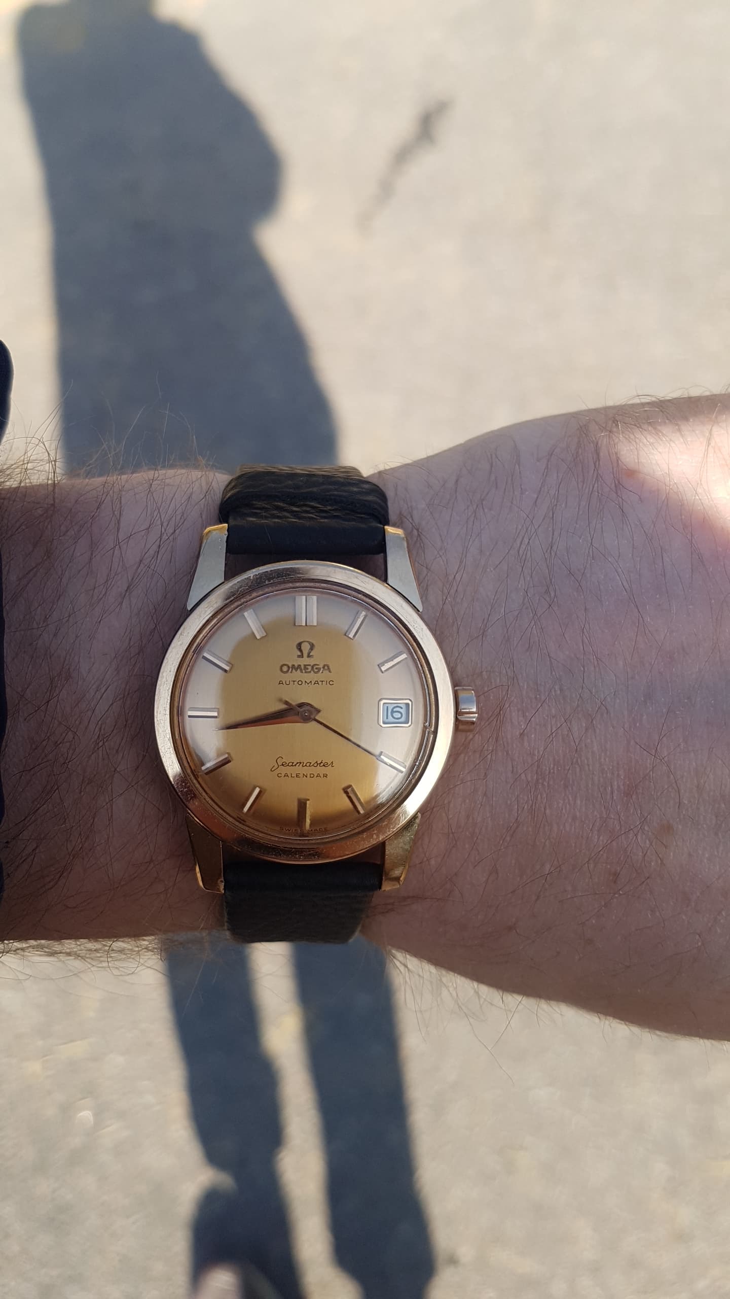

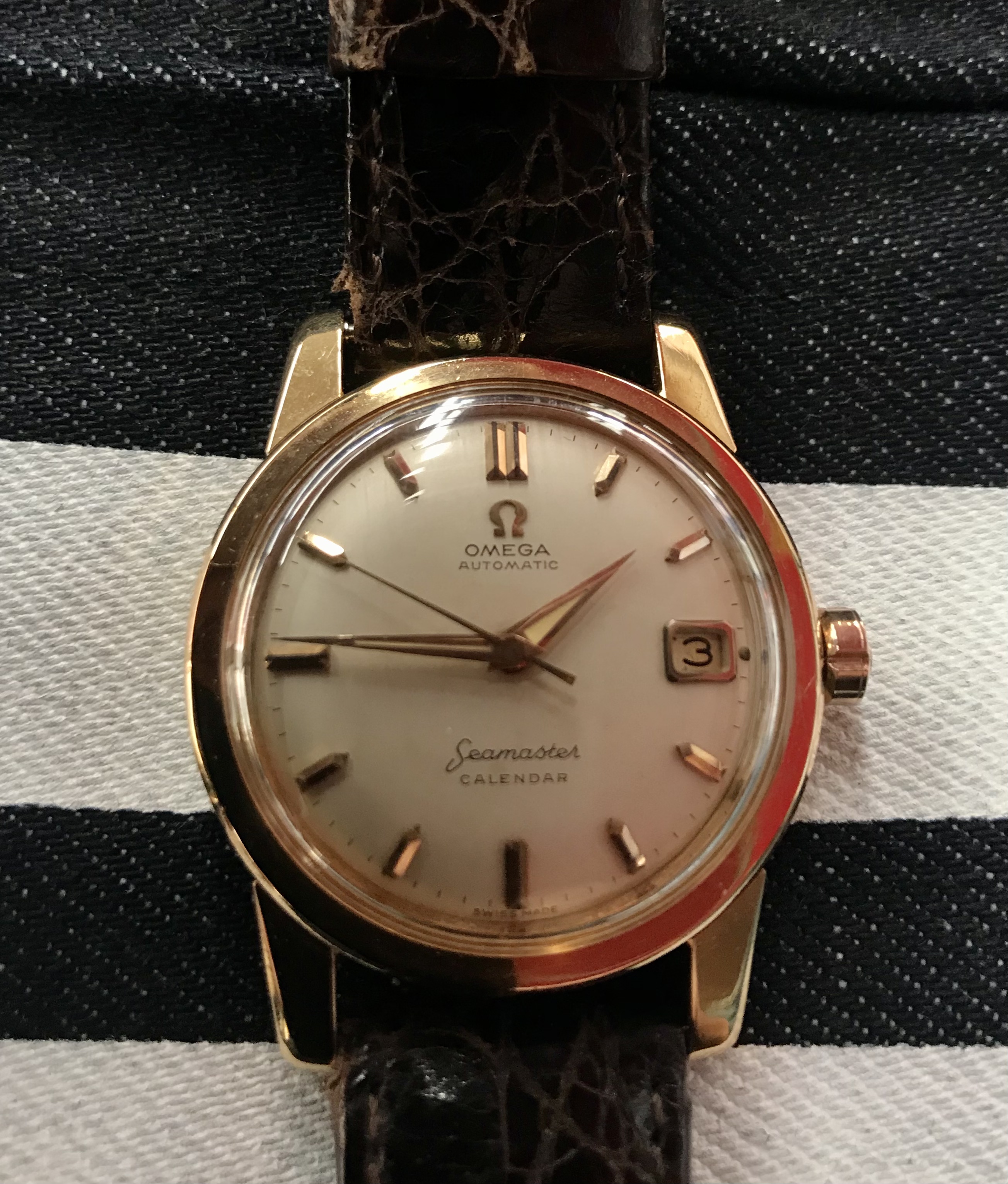

Posts 200 Likes 328 Masterofkarate ·Nov 15, 2020 sc 2849 with 503 movement. My camera cant really capture its beauty Edited: Nov 15, 2020
Posts 1,113 Likes 7,821 Alpenschneerot ·Nov 15, 2020 I have never seen such a great distance between Omega and AUTOMATIC! Redial? Desmond may help..

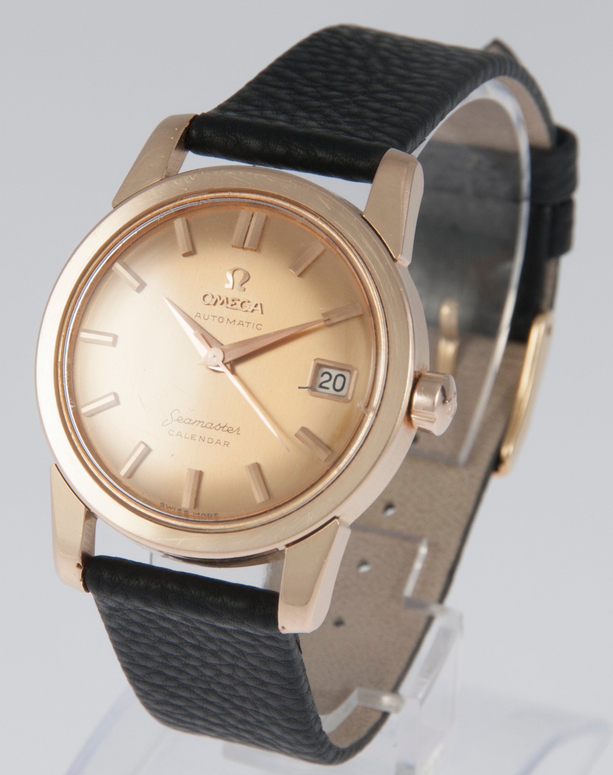

Posts 2,298 Likes 3,157 Passover ·Nov 15, 2020 Alpenschneerot Redial? Ouch! A quick online search for the reference shows only examples with a different angled 'M' in Automatic like in the picture below...
Posts 200 Likes 328 Masterofkarate ·Nov 15, 2020 I can say im pretty certain its not a redial. For reference, how many gold dial calendar have you seen? under the lume i can clearly see the print boldness. And even redialing a solid gold dial without damaging the dial..

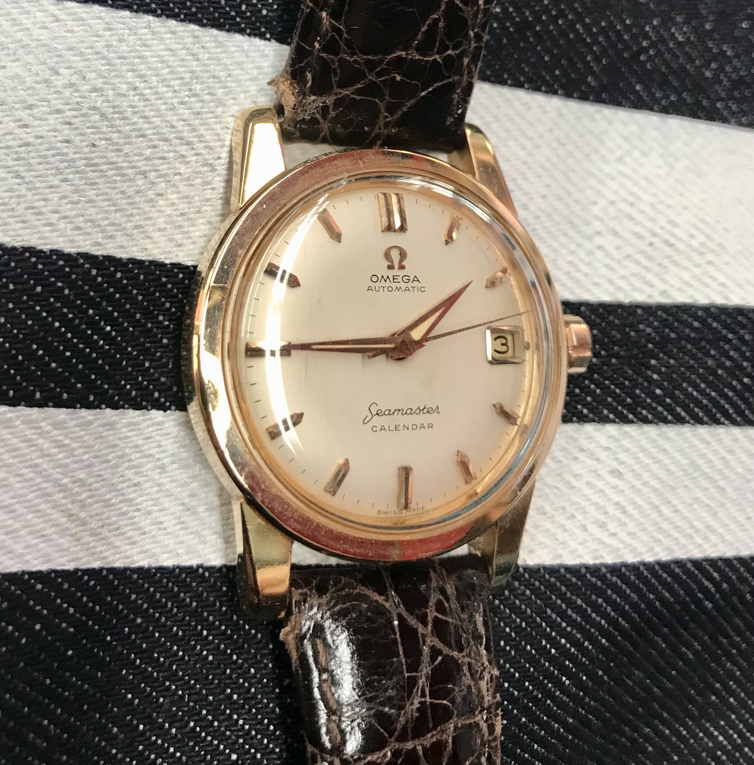

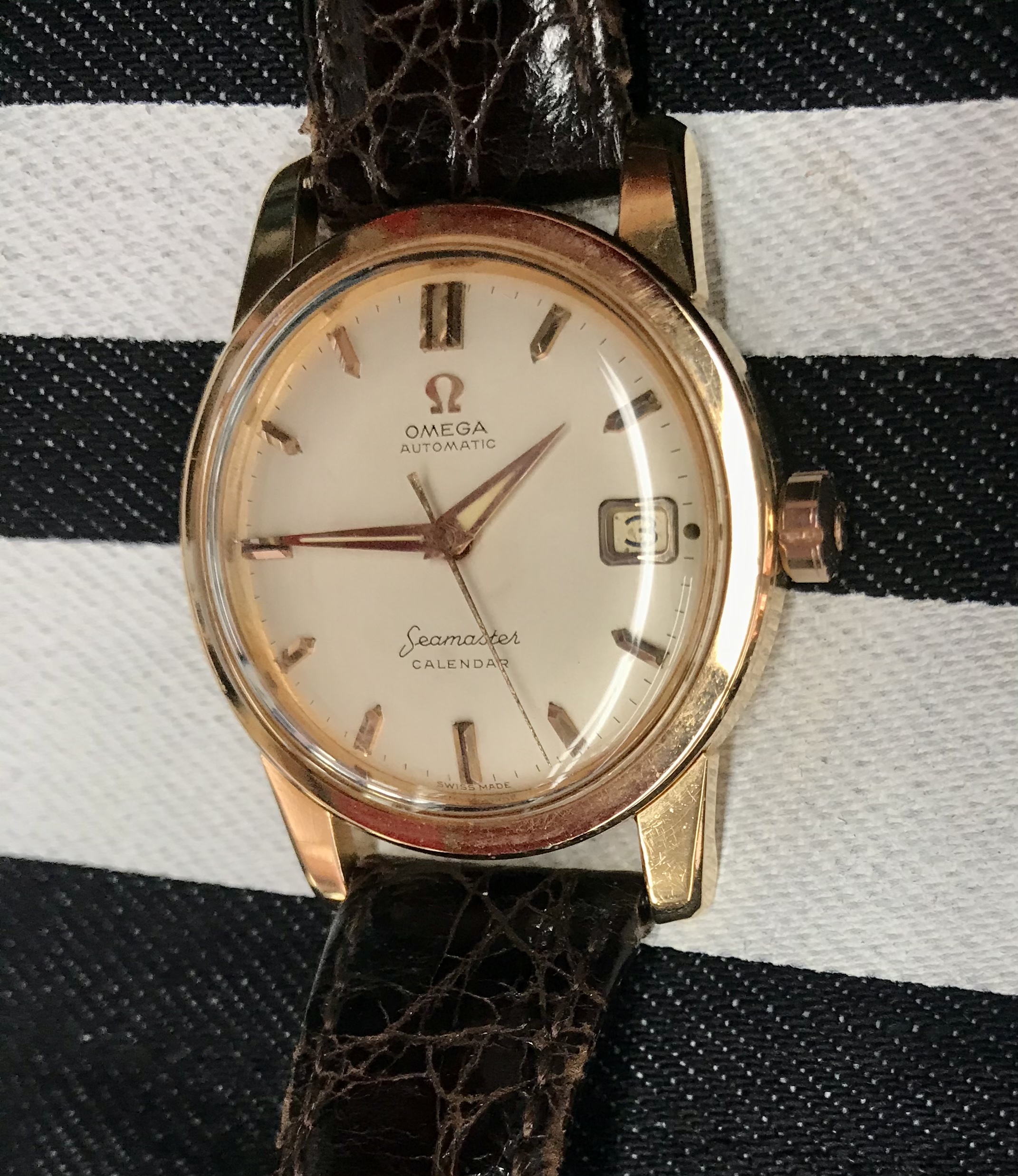

Posts 1,024 Likes 4,126 qazwsx1 ·Nov 16, 2020 No minute markers again. and agree with gap. Alpenschneerot I have never seen such a great distance between Omega and AUTOMATIC! Redial? Desmond may help..
Posts 1,024 Likes 4,126 qazwsx1 ·Nov 16, 2020 Do you find another omega ref.2849 with gold “omega” word like yours?
Posts 16,918 Likes 48,150 STANDY ·Nov 16, 2020 You can’t compare a printed Omega with a applied Omega. Most applied have a further gap between Omega and Automatic than printed IIRC

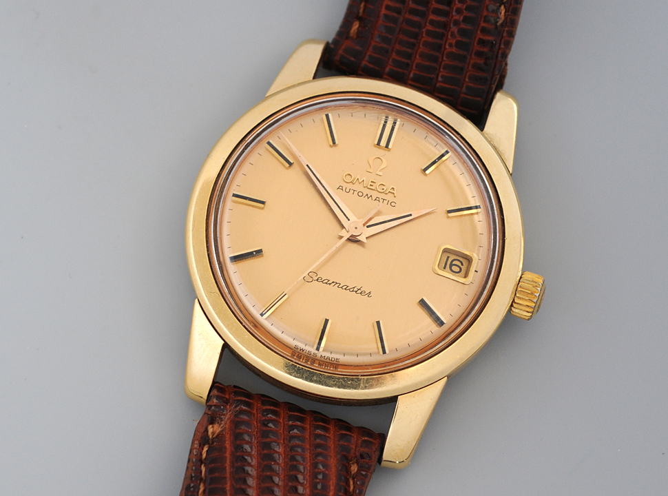

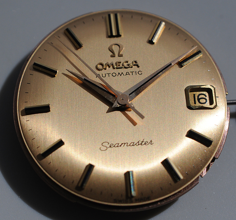

Posts 3,653 Likes 7,770 mac_omega ·Nov 16, 2020 Here is another SM de Luxe with 18K solid gold dial and applied Omega wording, also with a wide gap... However this is with minute hashes and the movement is younger, its a cal 562
Posts 1,623 Likes 6,076 bardamu ·Jan 3, 2021 Just my two cents: since the OP’s dial doesn’t look repainted in any case, could it be an later Omega replacement dial?
