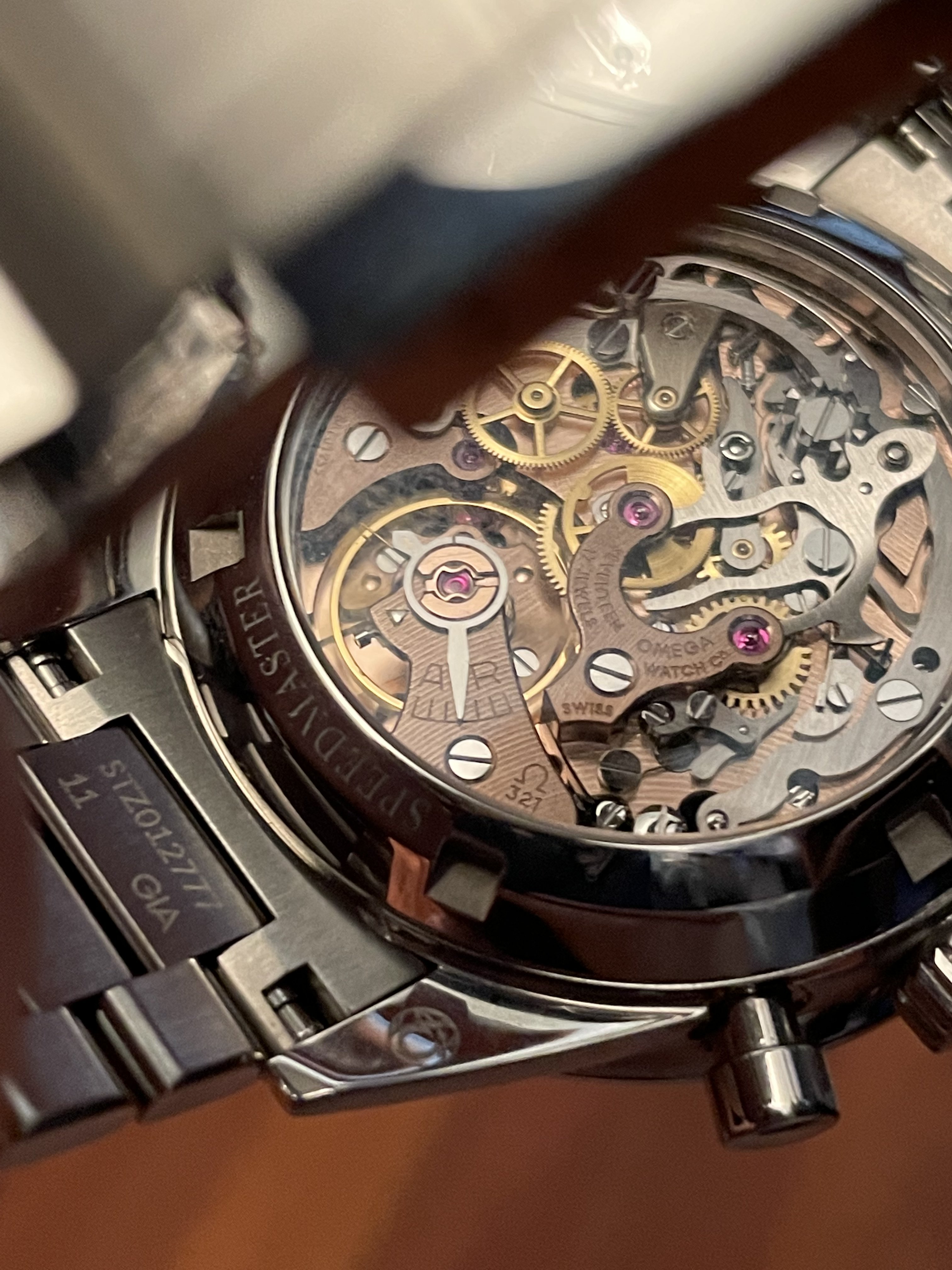

Passed all of my standard tests, altitude was fine, escalation perfect, angle of variance well within MESTA guidelines. As a precaution, I have checked the timekeeping several times yesterday at 30-minute intervals against an atomic clock suspended in a vacuum, and my martinis were perfect every time.

Implying that it’s okay, or not okay?
It means that Omega didn't care enough to make it centered. If that is "okay" or "not okay" is up to each individual to decide.
these are regulated after build to ensure high accuracy so i assume its correct.

Sorry, I don’t understand.
From a watchmaker’s perspective, is the indicator ideally pointing dead center if properly serviced and adjusted, and then moved to either side as time passes, and timing changes, to improve accuracy; or is the indicator fine anywhere along it’s adjustment parameters as long as the watch is performing correctly?

I've covered this previously, but yes, it should be centered, and Omega didn't bother to.

My regulator was off center too, so I took off the back and shoved it over a bit with my Bergeon regulator/strap tool. Scratched the movement plate a tiny bit (just to the right in this photo), but it only shows at a certain light/angles and you can't see it at all while wearing the watch. Looking at it again just now, also see that I may have left a bit of lint in the movement, but no worries - I will get that sorted at the next annual service. 👍
Always good to leave some lint in there, then you can check they actually serviced it, instead of just spraying some wd40 in it ::stirthepot::

I find it especially odd, and a bit disconcerting, that Omega touts that the 321 is assembled in a dedicated workroom by one well experienced watch technician, contrary to the assembly line process of most other movements. Good horology practice through the ages is to obtain the proper timing through use of washers, or other means, during assembly which keeps the regulator centered. But it seems Omega 'best practice' these days is to assemble it and use the regulator to dial in the timekeeping. It just goes against what they are advertising this product to be, a super duper luxury product produced with the utmost of care and personal assembly. I have no idea how the old 321's were timed since they were hidden under a solid back, maybe the same process was used. But if you are going to show it off with a sapphire back at least assemble it to best practice. Nitpicky perhaps, but when charging double the price of a 3861 Speedmaster I would expect better. What would it take....20 min per watch maybe? This isn't to rain on anybody's 321.....they are a beautiful watch, but I never bought the hype on how special this product is or the reverence the 321 carries.

Is it possible that all the regulators on the new 321s are being placed one notch towards the "retard" side of the scale? I feel like I've seen pretty much all of the 321s have their regulator in the same position, one notch towards that side.

Mine is nearly centered so not sure what all the fuss is about. I own the 321 and 3861 sapphire (love it) and yes the 321 is next level in finishing and build quality just as it should be considering it’s twice the price…

Neither my 321 steel nor 321 platinum are centered and I don’t give a damn they are amazing pieces and I love them

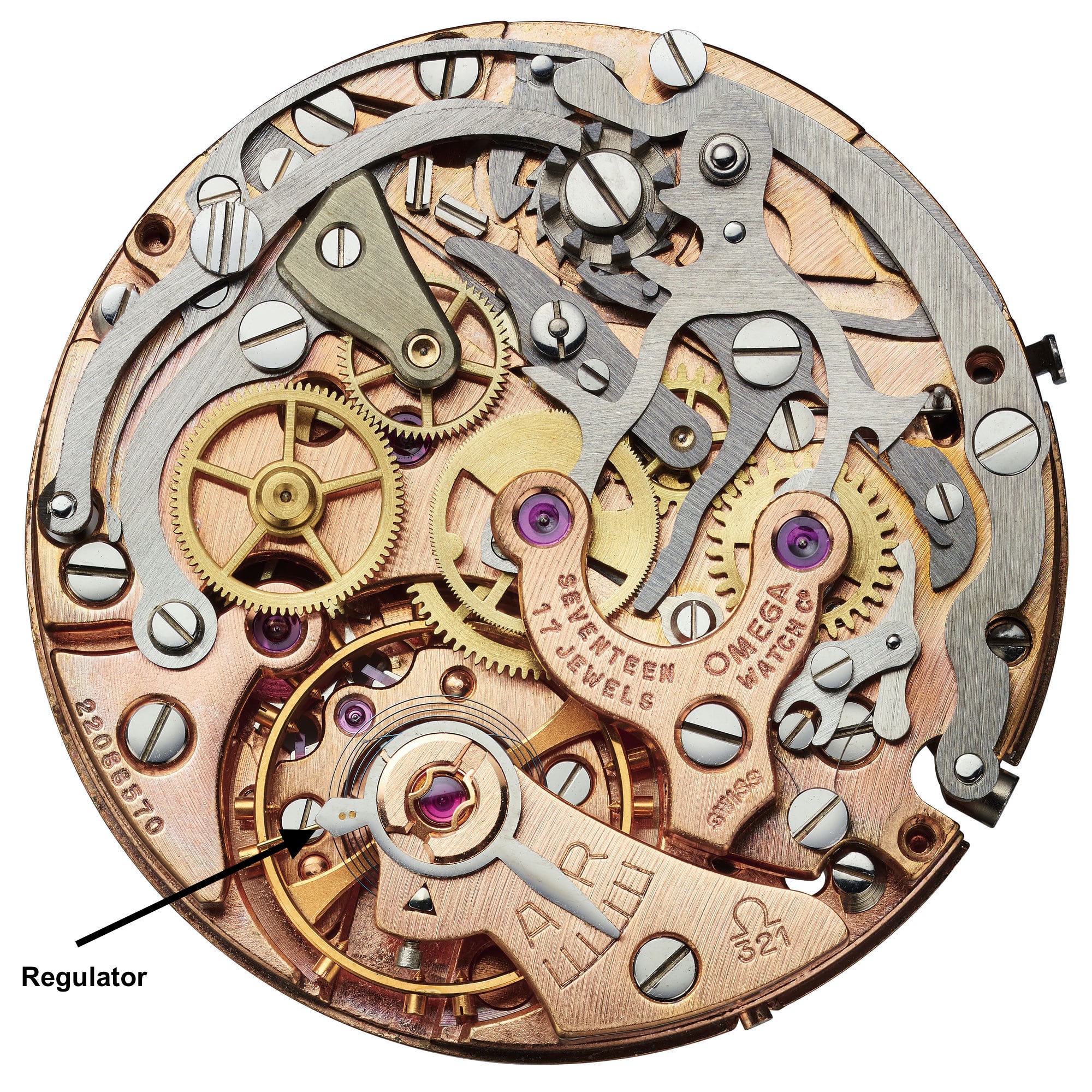

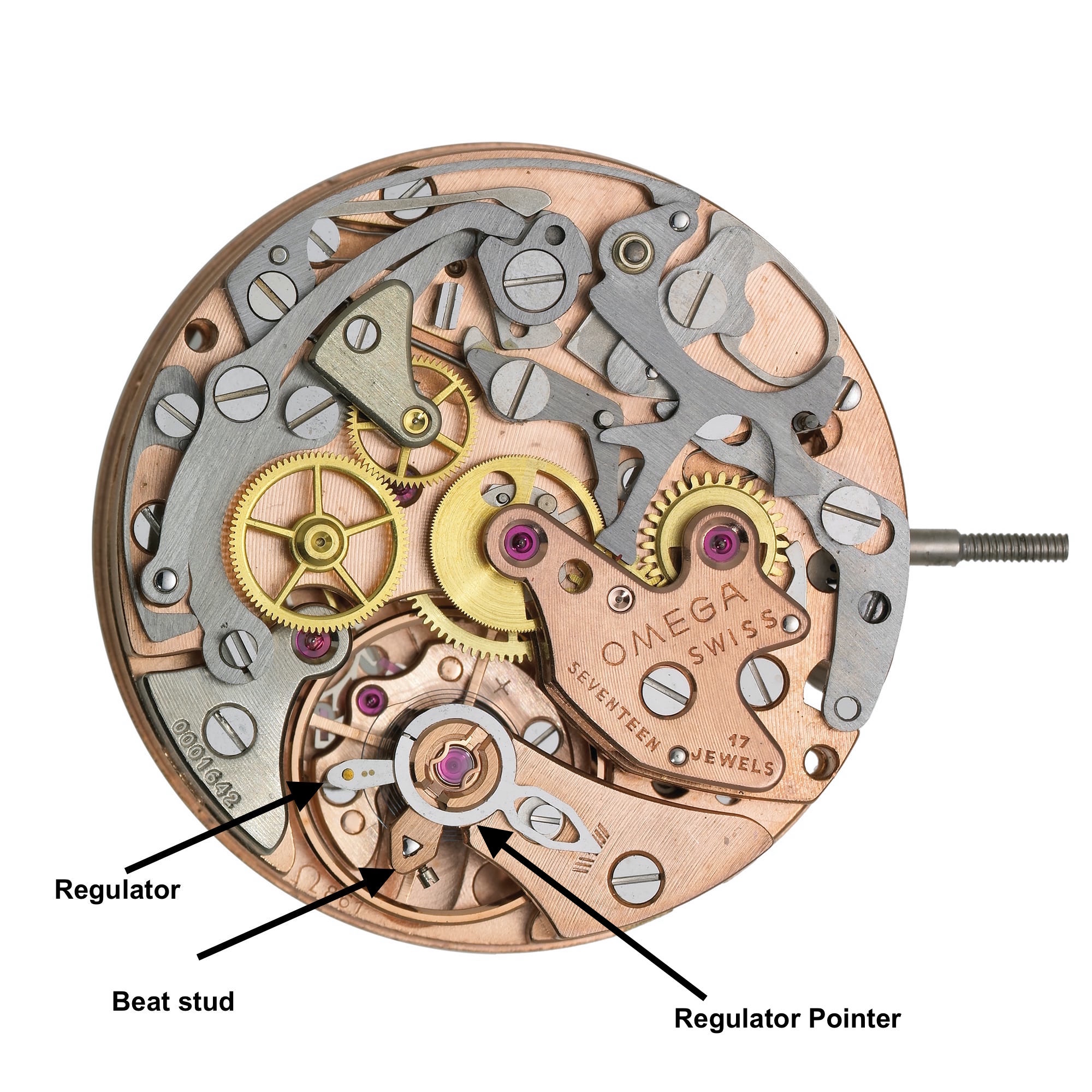

Some things to keep in mind, the 321 and 861 have some rather large fundamental differences in the way they are regulated. The 861/1861 has a moveable beat stud, and the regulator and the regulator pointer have a friction interface between each other. This means the pointer which is ideally centered and the regulator can be moved independently from each other. In the picture below you can see how the two parts of the regulator are separate parts.
On the 321, to adjust for beat error the hairspring has be be shifted on the balance. The 321 uses balance screws as well. The regulator and the pointer are one piece on the 321. This means if you want the have the regulator centered, weight would have to be removed or added to the balance.
On movements that aren't the 321, Omega allows the pointer to be no more than one division fast or slow.
