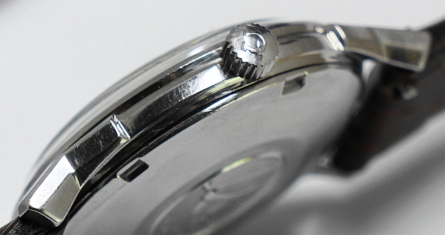

My last (newest)purchase, 168005 caseback question.
779
2,447

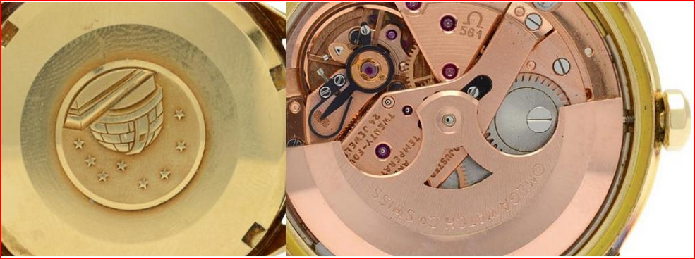

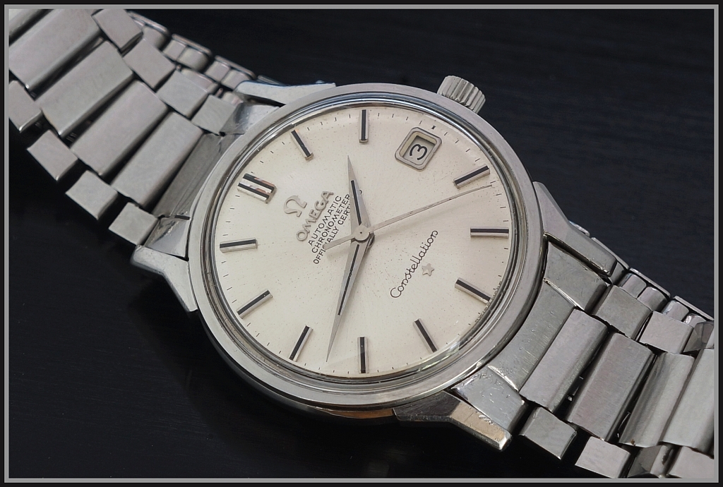

Dial looks good and the case is crisp.But the caseback looks different?
168.005+cal+561+1964.jpg ???
Picture from; http://omega-constellation-collectors.blogspot.jp/2008/03/constellation-medallions.html

It is correct. All steel 168.005's should have a one piece back, with a struck steel medallion.

Thanks!

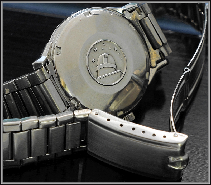

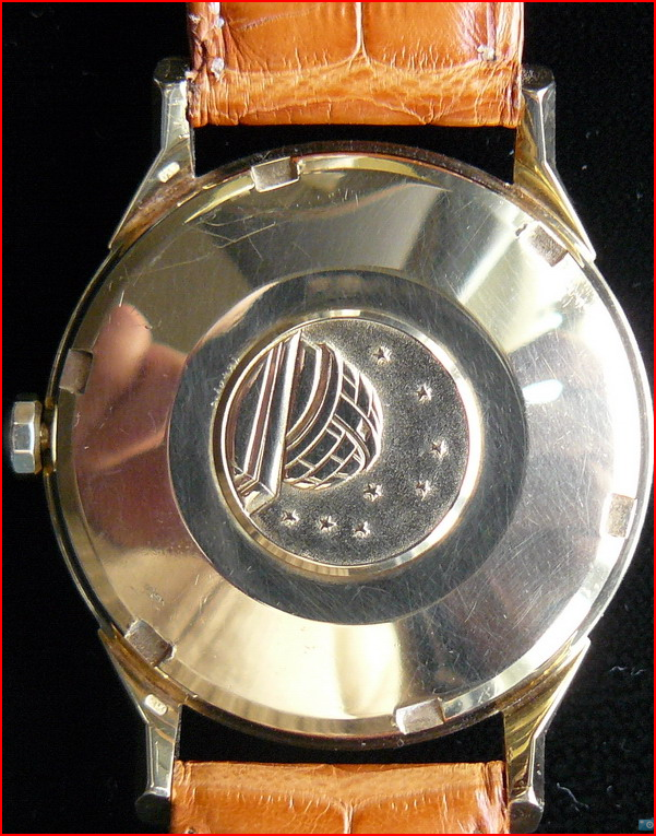

With and without the flat area around the medallion?
2,876
1,962
There are at least 3 manufacturers for this reference and there are some variations even within the same manufacturer. I guess yours was made by HF. Can you post a picture of the inside case back?

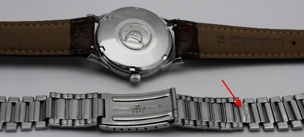

Nice bracelet! Did it come with the watch?

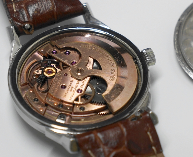

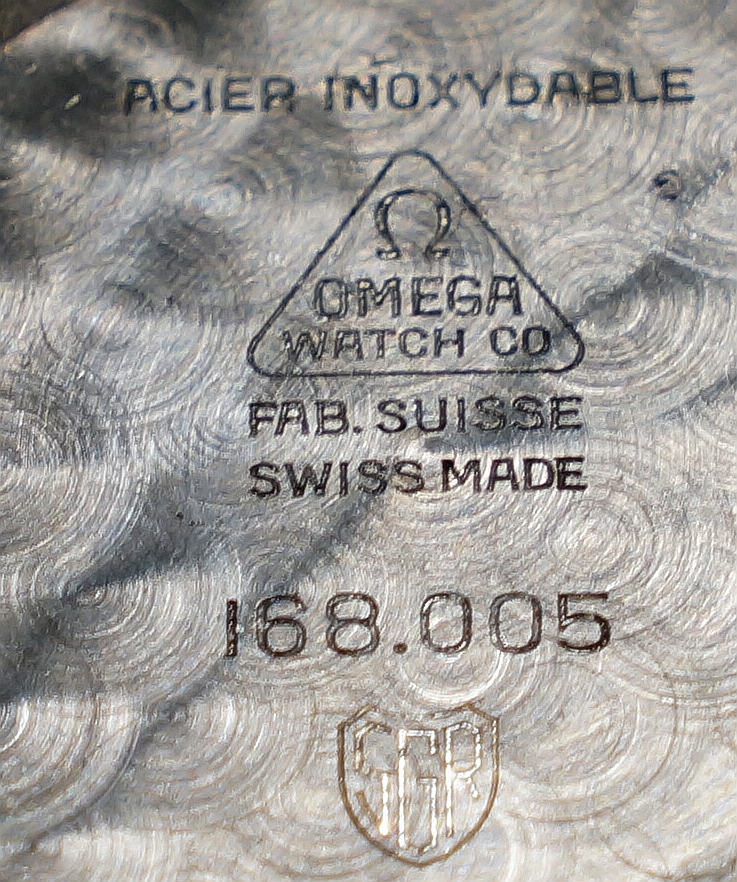

More pictures - case back looks laser engraved, movement number is 195xxxx....
Bracelet came with the watch.
Franken bracelet?

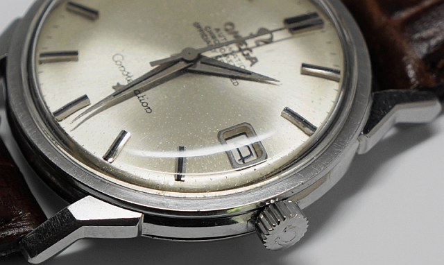

The lugs' side bevels and edges also vary slightly for the stainless steel 168.005.
