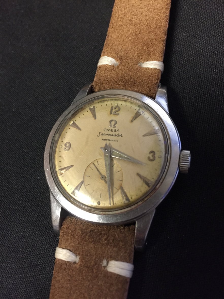

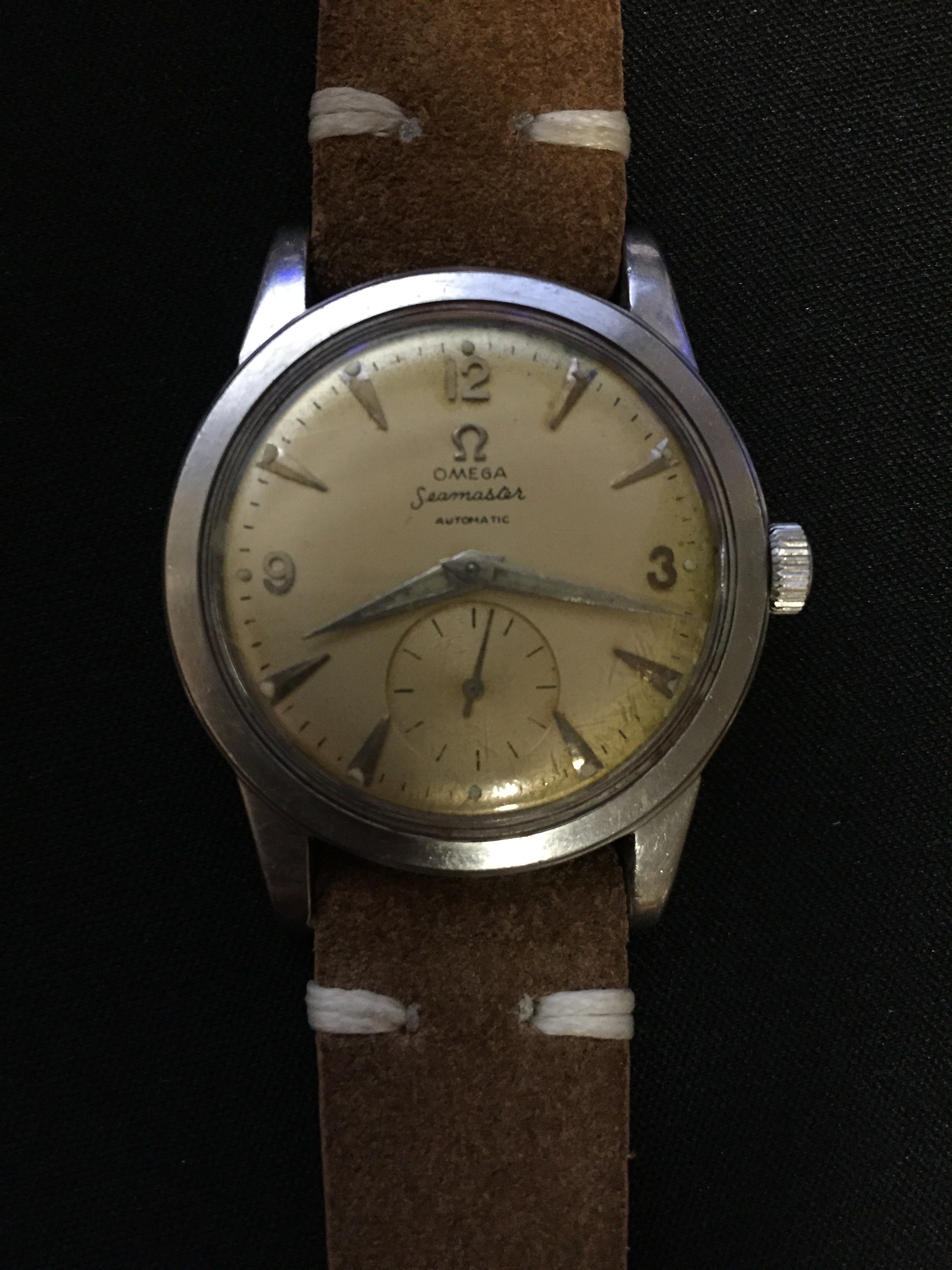

Hey all, I'm a 19 year old freshman mechanical engineer and a massive watch enthusiast. I'm no means a vintage expert but I have always had an appreciation for them. Previously I had never really found a piece that "spoke" to me per se, lots of nice watches but none that gave the right vibe I was looking for.
Well, a friend and I were at a knife and gun expo here in town and out of the 400 or so booths, a small handful were selling watches. They were almost exclusively vintage pieces, tons of old Rolex's from the 80s and 90s, lots of Bullovas, etc, but only two Omegas.

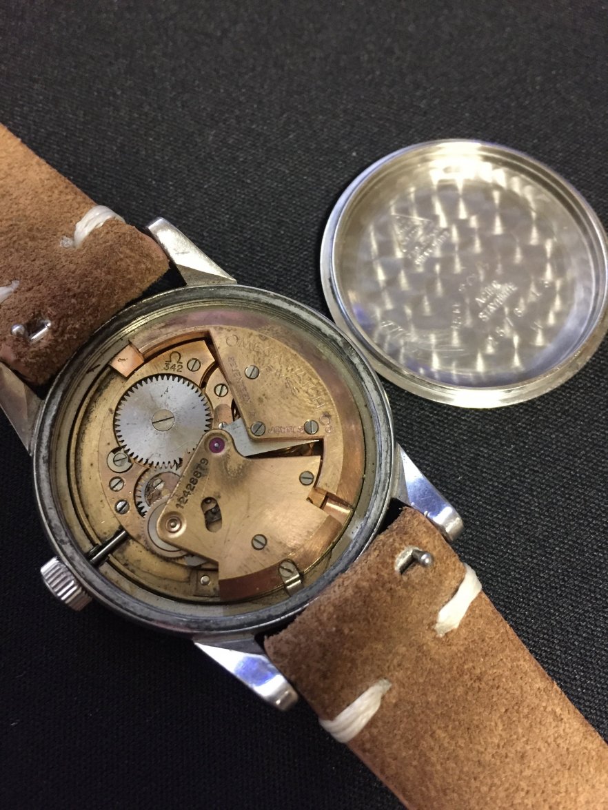

The one I fell in love with was this little cutie. From what I've managed to find it's an early 1950s Seamaster with a 344 caliber bump movement in it. I had no idea movements like this existed but I absolutely love the little taps I feel every now and then. The engineering behind it is also super cool and I love staring at the movement despite it not being the cleanest example out there.

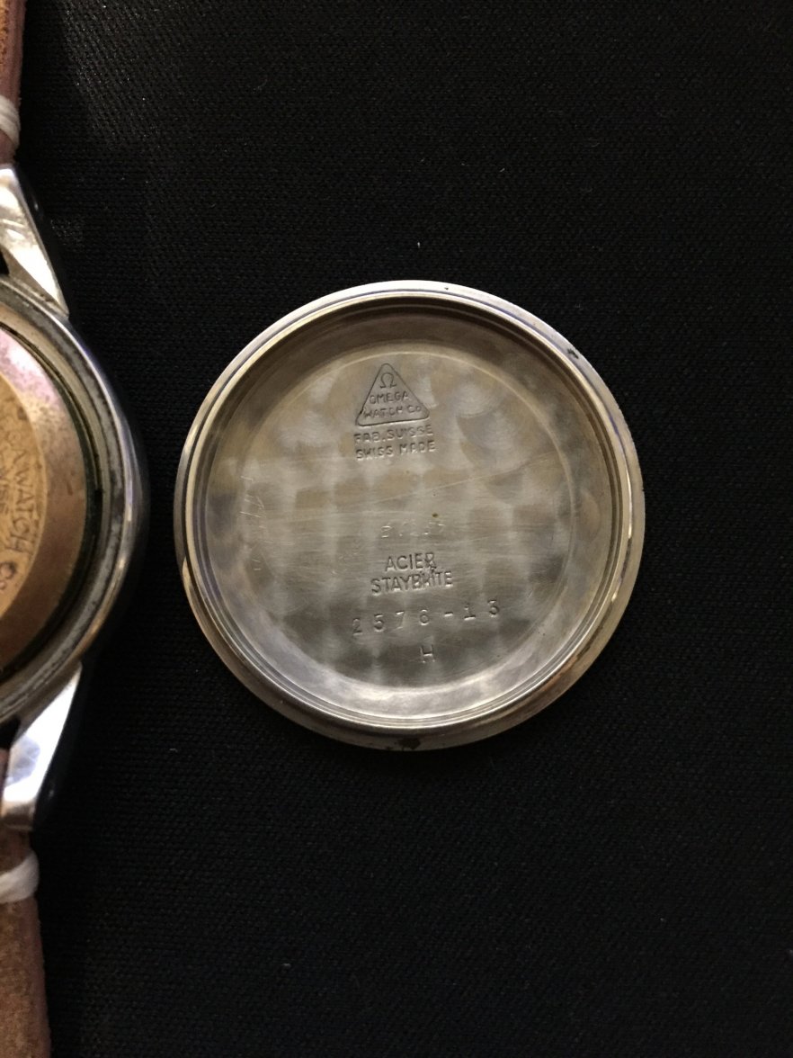

I snagged it for $150 and I felt pretty good about that. Did I get a reasonable first start to the world of vintage or should I have done more research like I normally would have? I'd love to know if the 2576-13 on the interior of the case back is the reference number or what it is otherwise, what year it's from, and anything else a newcomer should know. Strap suggestions are also welcome!
I made an account here just to get some thoughts so please go easy on me if there's something I managed to miss.
Thank you!

Welcome to the forum. Indeed 2576 is the reference number, and the "-13" refers to the 13th run of that reference. The movement appears to be a cal 342, not 344 as indicated by the OP. Here is the Omega Vintage Database page for the reference: https://www.omegawatches.com/en-us/watch-omega-seamaster-omega-ck-2576
As noted, the watch is from the early 1950s, and it appears to be mostly original, including probably the hands. The dial on your watch has been repainted at some point in the past, and the original luminescent compound on the hands and dial has also been replaced (probably a long time ago). The crown has been replaced, with what I suspect may be a non-Omega crown. For $150, none of these issues need bother you too much if you are happy with the watch.
The faint hand-scribed engravings inside the case-back were made by watchmakers who serviced the watch in the past. As you may know, mechanical watch movements must be "serviced" every 5-10 years in order to continue to run properly. This involves disassembly of the movement, cleaning the parts, and reassembly with proper lubrication.

Ya that’s a pretty bad redial but you didn’t pay much and you like it. As long as your happy it’s cool

Redial and tired movement. But for $150 you done OK.
Get a quote for a service and decide if it’s worth putting that amount of money into

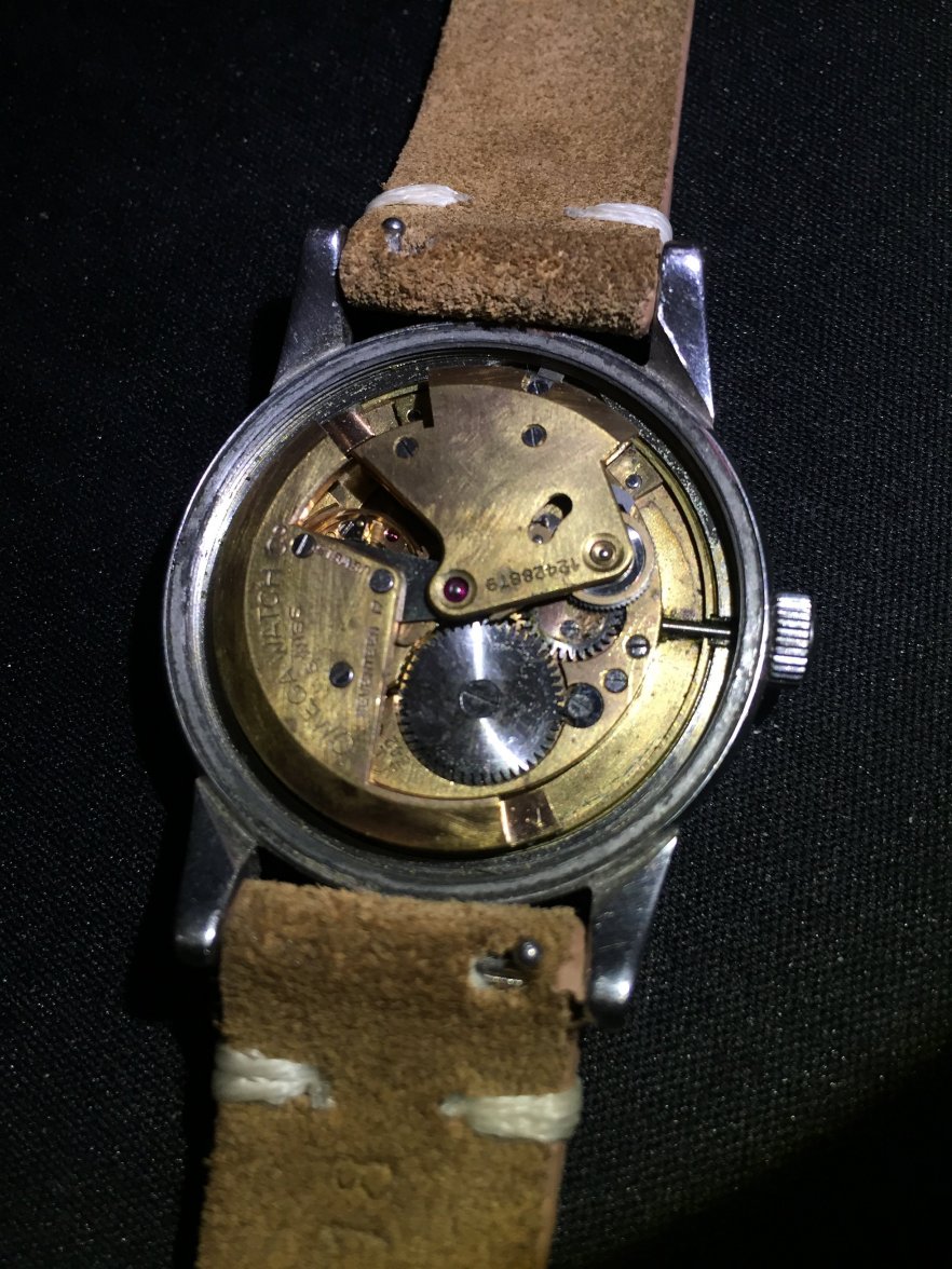

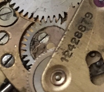

this bit looks troubled but @Archer or @JimInOz might know what it does
18,834
39,166
The bit with the screw in it is the Crown Wheel Core, it's a plate that hold the Crown Wheel (the silver coloured gear thing) down and stops it escaping.
Its purpose is to transmit winding force from the crown/stem or the automatic winder to the ratchet wheel (the bigger silvery gear thing). That in turn is connected to the mainspring via an arbor, so the ratchet wheel eventually winds the mainspring.
The Crown Wheel Core looks to either:
Have the side broken off
or
Have been badly stained by rust/corrosion.
It's close to the crown/stem so if water gets in, that's usually the place that corrosion starts.
Hard to tell what it is without a better well lit pic.

@JimInOz Here's some better lighting maybe, to my eyes in person it looks like corrosion.

Good start with vintage Omegas. The core will hold and function a while longer. The movement has been abused in the past. If you want to wear it on a daily basis, you should have serviced/cleaned/oiled. I would not replace parts for optical reasons. The plating looks gone due to past services and the wrong cleaning solution. As long as it works well, don't bother. Will do the job anyway. Case is ok. Dial is what it is. Lume is present behind the markers and on hands. Enjoy it and use as an entry to learn more. Be careful, vintage watches are addictive.....correct crown easy to find on eBay. You will have to replace the stem too; chances are high, that moisture in the past has rusted the stem in the crown.but, again, enjoy it and wear it! Nice model. Kind regards. Achim
or
I think it might just be dirty, and possibly has a scratch on it - will likely clean up fine.

Parts account isn't much help with these, as Omega carries very few parts for the movements. I often have to go to the open market to find parts.

You got a well used watch at a good price. Sub dialed seamaster models are very popular. You also have an incorrect crown,, but easy to find
You should show a picture of the balance to see where the regulator is sitting as you mention it's running fast

............................You should show a picture of the balance to see where the regulator is sitting as you mention it's running fast
DON
I'll put $5 on it being fully "R".
