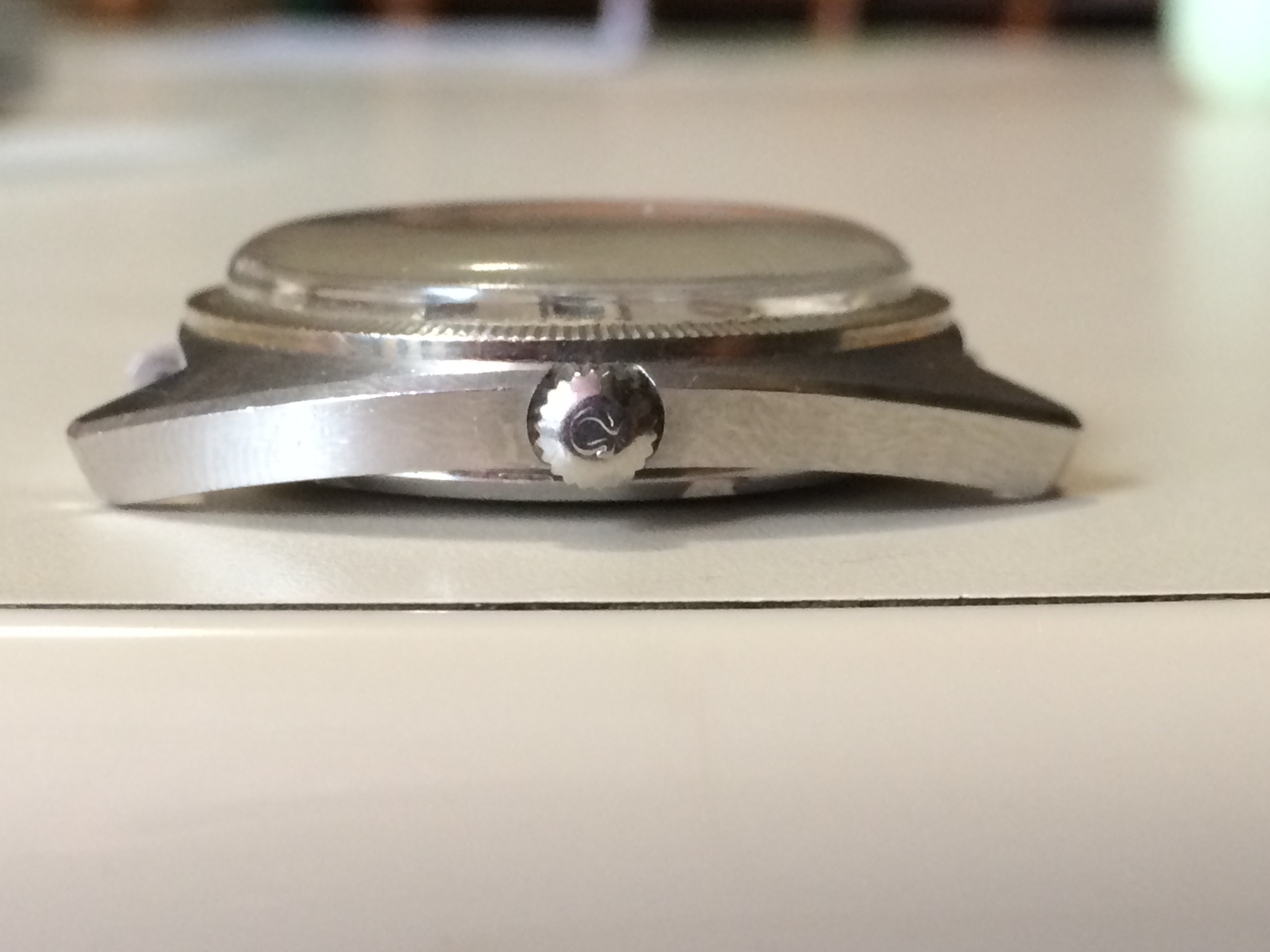

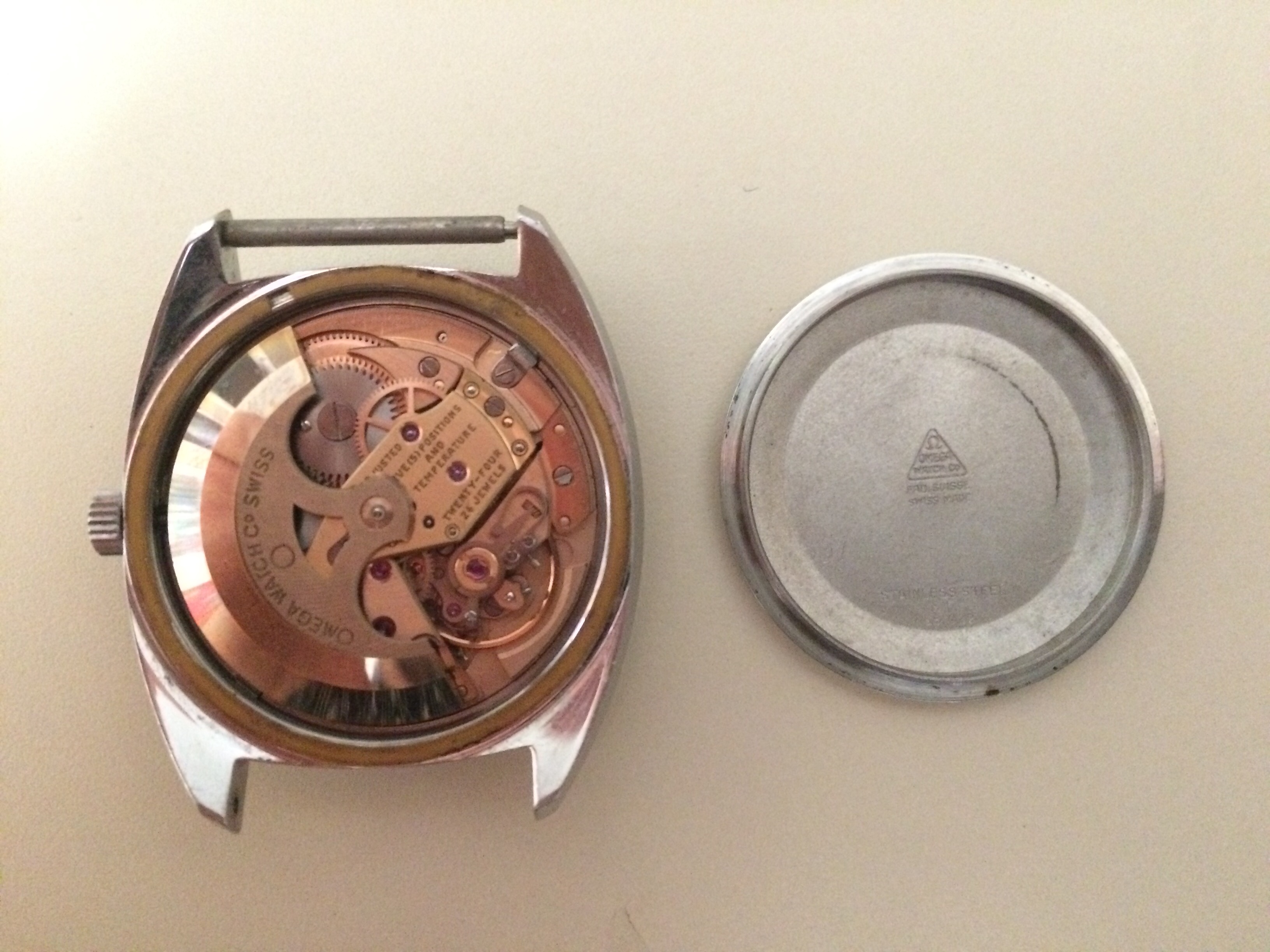

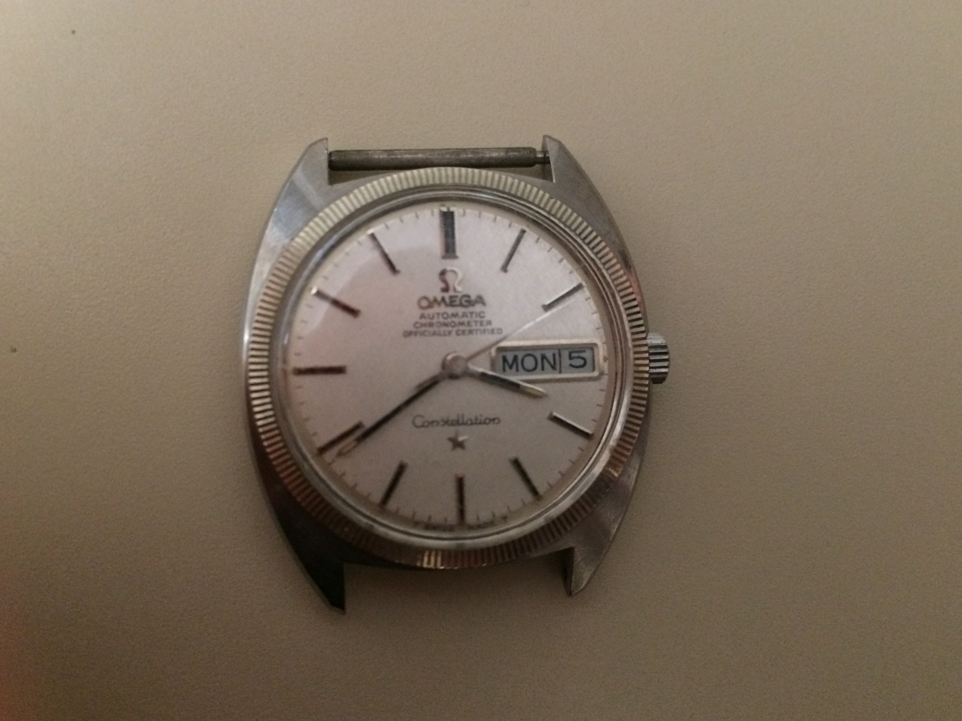

Hello Omega Forums, I have been eyeing up an Omega Constellation for years and I finally picked up this C case at a local estate sale. I would appreciate any opinions or information on the watch. Its caliber 751, ref.168.029. Thanks in advance.

Great pick up you got there! Will be nice if you can round up an original bracelet for it as well. Looks like you have the acrylic 7XX mvt version with white gold bezel. 👍

Nice catch @Losi11. Great condition. Looks to have the original yellow o ring in back...always wondered about that.

Do you see the black line on the inside of the caseback? That's where the winding rotor has been rubbing against it, probably because of a worn bushing. This needs to be looked at.

What a find for an estate sale, especially with the beautiful white gold bezel. Congratulations!

I see the line on the caseback from the rotor, thanks for pointing that out. I will get this looked at. 👍
