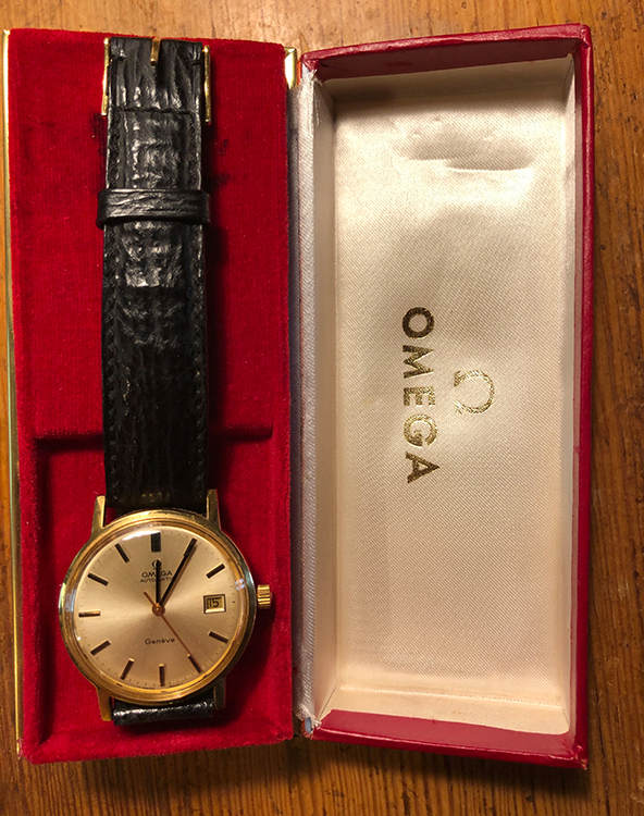

Hi, I´m new here! I inherited this beautiful 1973 18K gold Omega Genève Automatic from my father, and wore it everyday for 20 years until I bought a Rolex Submariner 14060 new in 1996. Since then it´s been in a desk drawer in the original box. A few times a year I take it out, give it a good wind and let it run for a few days. It was only serviced once and, quite amazingly, still runs beautifully, +10/+15 secs per day!! My question…I want to start wearing it again, so should I just leave it alone or have it serviced/cleaned again by my Rolex AD, whom I know and trust and are also an authorised Omega AD? I have read/heard it´s best to leave vintage watches alone if they´re running fine! Thanks for any help/suggestions! Regards, Ian.

If you intend to wear your watch and it has not been serviced in a while, consider taking your watch to an independent watchmaker who specializes in vintage watch repair rather than to an Authorized Dealer. You'll find the level of service to be a bit higher and the prices to be lower.
Ask for a full movement service from your watchmaker. Be sure to avoid any machine polishing or buffing of the gold case because the gold is quite soft. A light polish by hand is all you need.
Your watch needs a movement service because the oils that lubricate all of the small moving parts inside your watch dry out over time. A movement service consists of removing the movement from the case, checking the parts for wear, cleaning off the old crusty oils and lubricating all the small parts with fresh oils, then reassembling the movement and adjusting the timing. After that service you will have a reliable timepiece for years.
