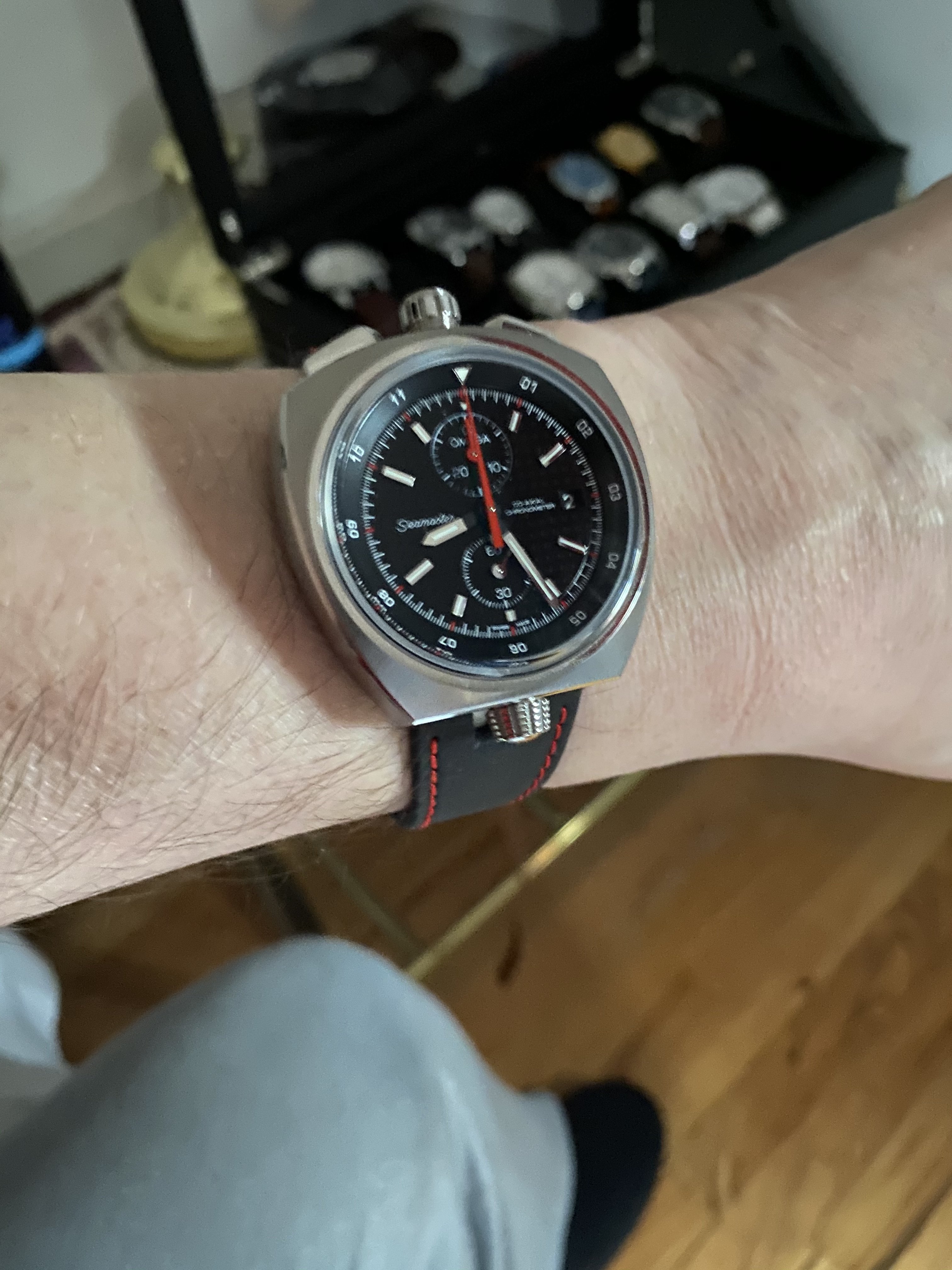

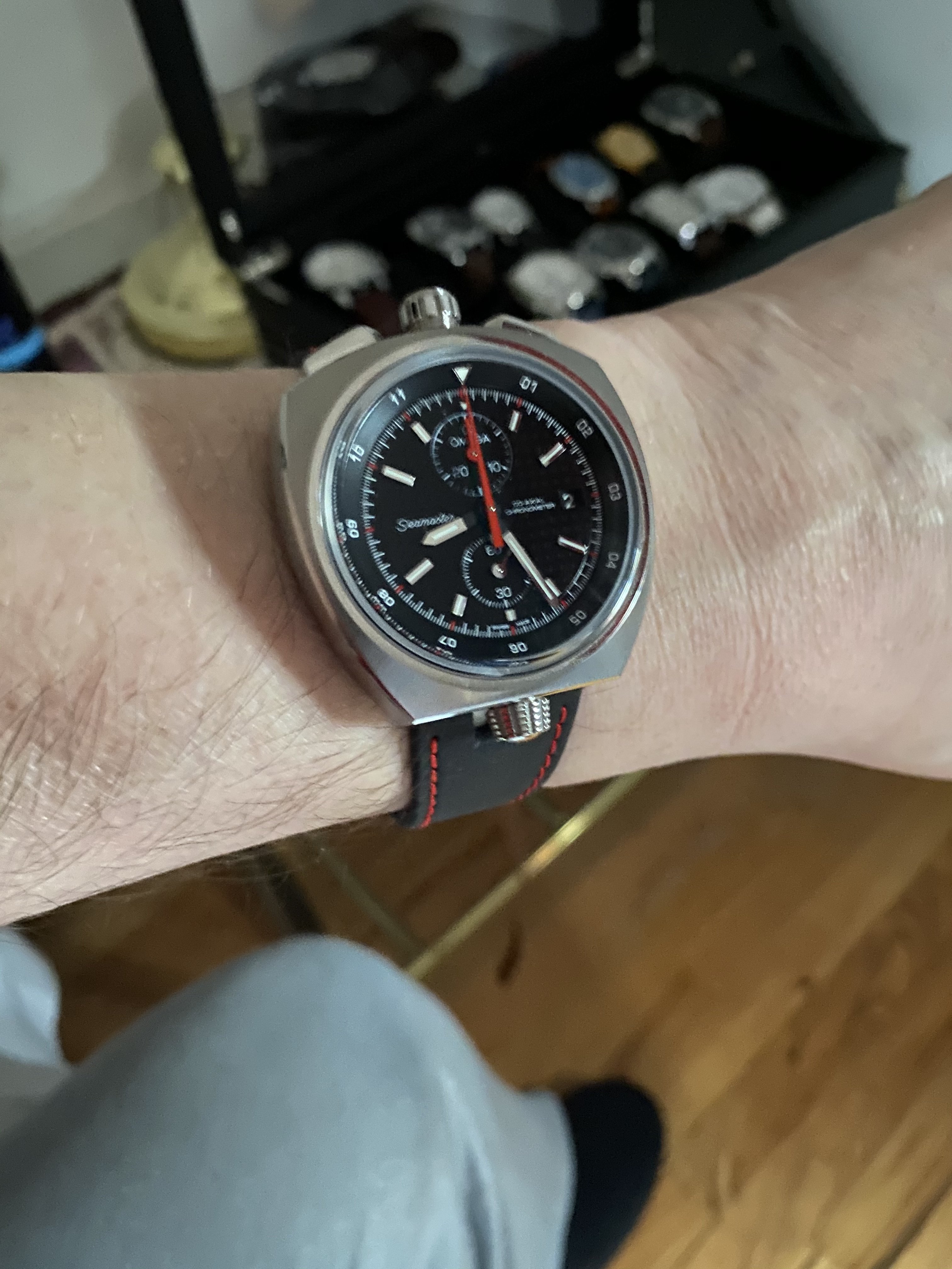

Did you take a wrist shot before you returned it? If so please post!
64
144
Love it and have been hankering after one for a while. The ones I have seen have busy dials styles. Your black dial is a beauty. How does it wear on the wrist? Thanks.
13
3
Comfortable. It sits flat and fills my 6” wrist. It’s thick, sitting proud on the wrist. It’s stunning in person.
64
144
Thank you sir.
