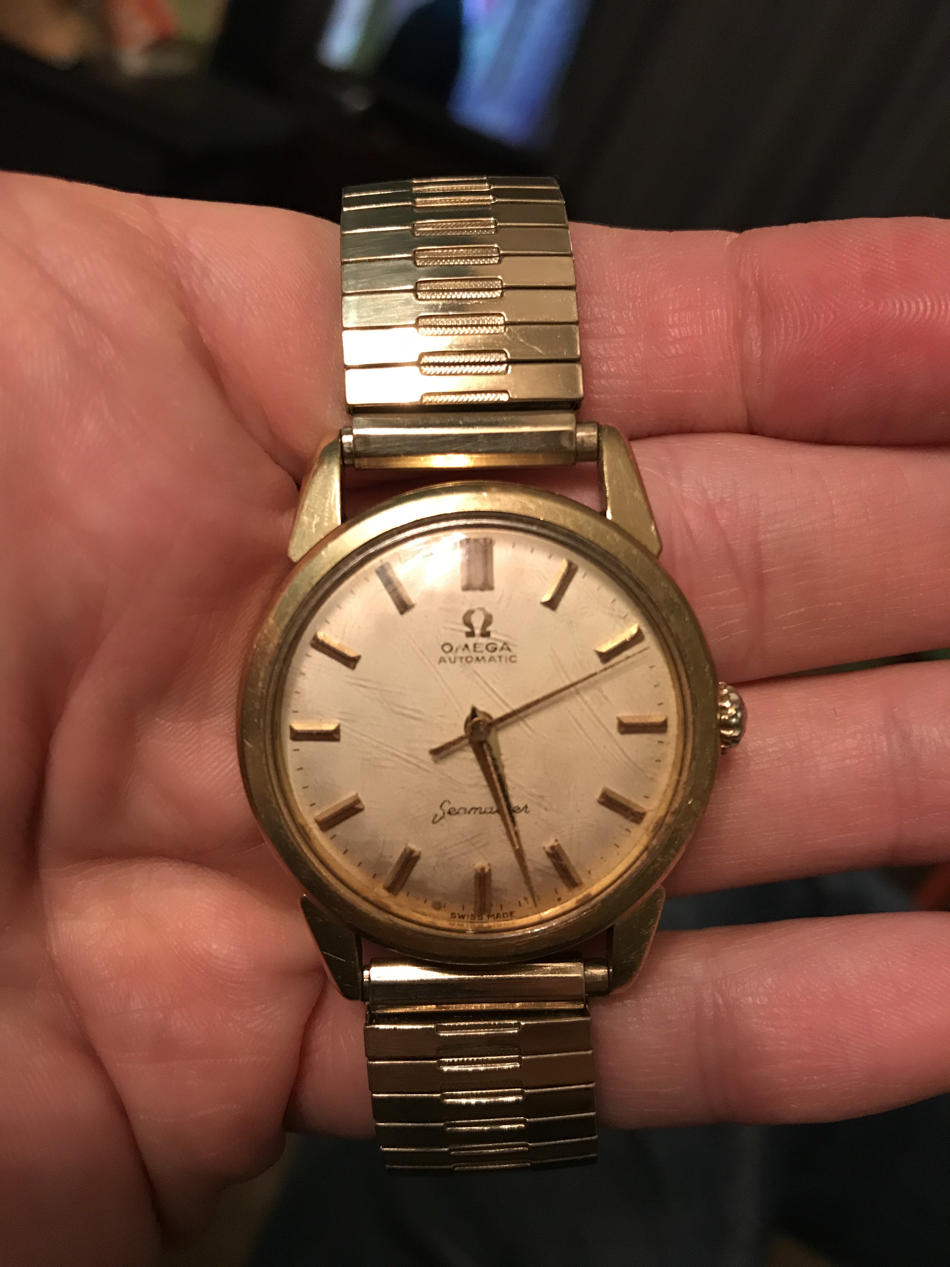

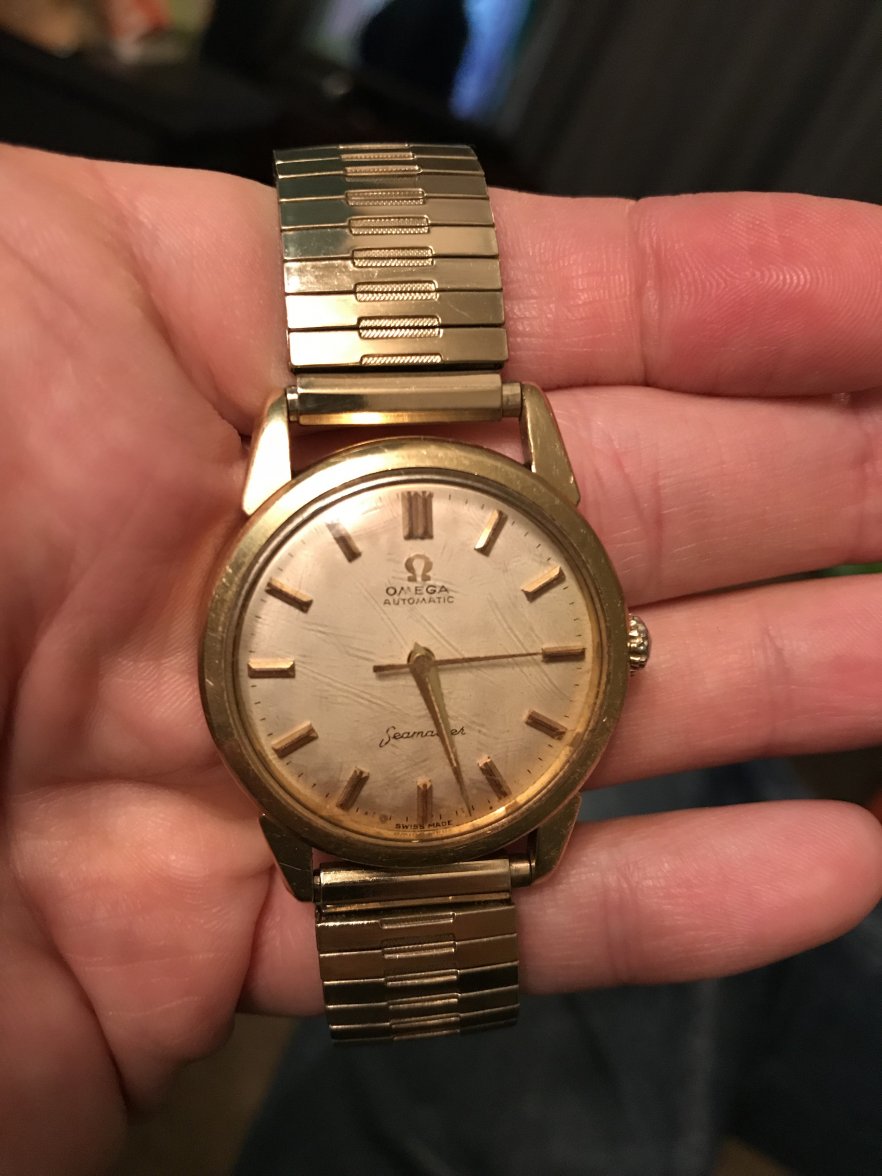

My Dad’s old Seamaster. Advice please
4
Any help on dating, if the strap is original etc please.
I think it’s 1960’s.
There is a hallmark on the watch so also assuming gold.
But any advice gratefully received

We really need more to tell more but it looks like a nice watch, bracelet needs to go asap as it damages lugs.

Hi Jbrad,
Thank you for sharing this gold watch.
Watch and dial, hands look original. Dial - though aged but again looks beautiful. Not sure the condition of crown or whether it is a correct one.
Without opening the case back, you can try to "shake" the watch gently. If you head sounds of bumping, the movement will probably an early one of 1950s. Say, cal. 351. Otherwise, when you hear rotating sound, it will be a later movement of 1960s , say cal. 552. IMO.

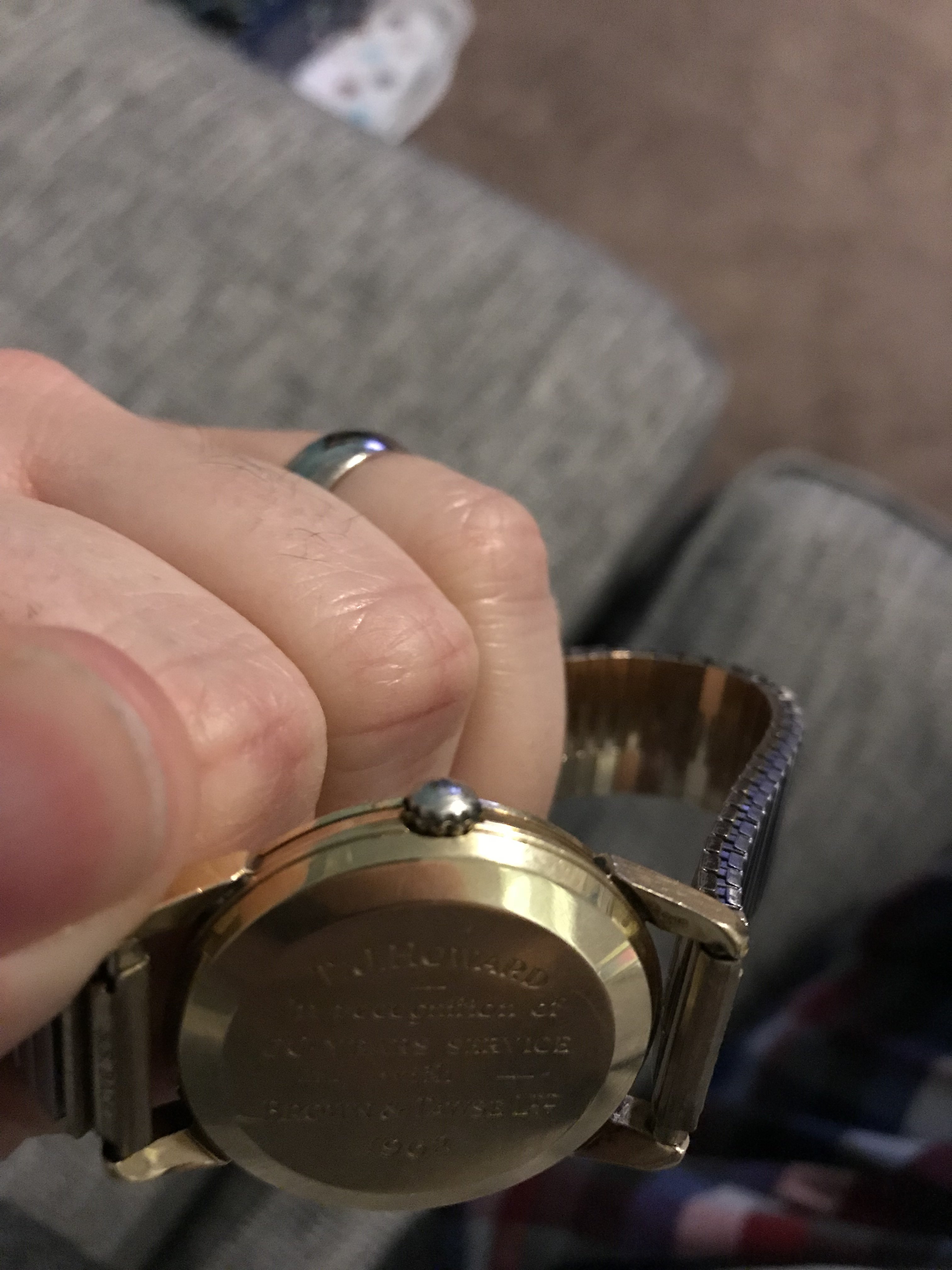

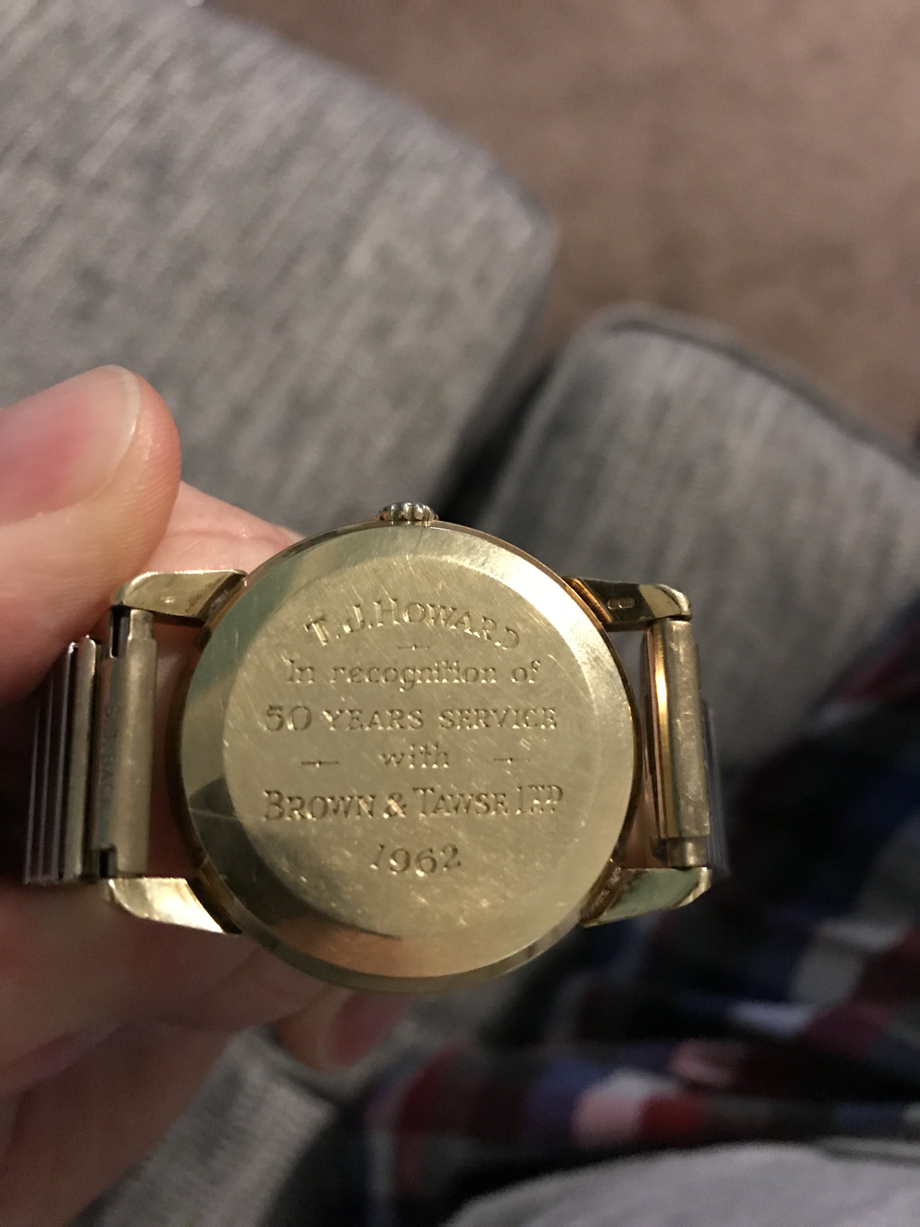

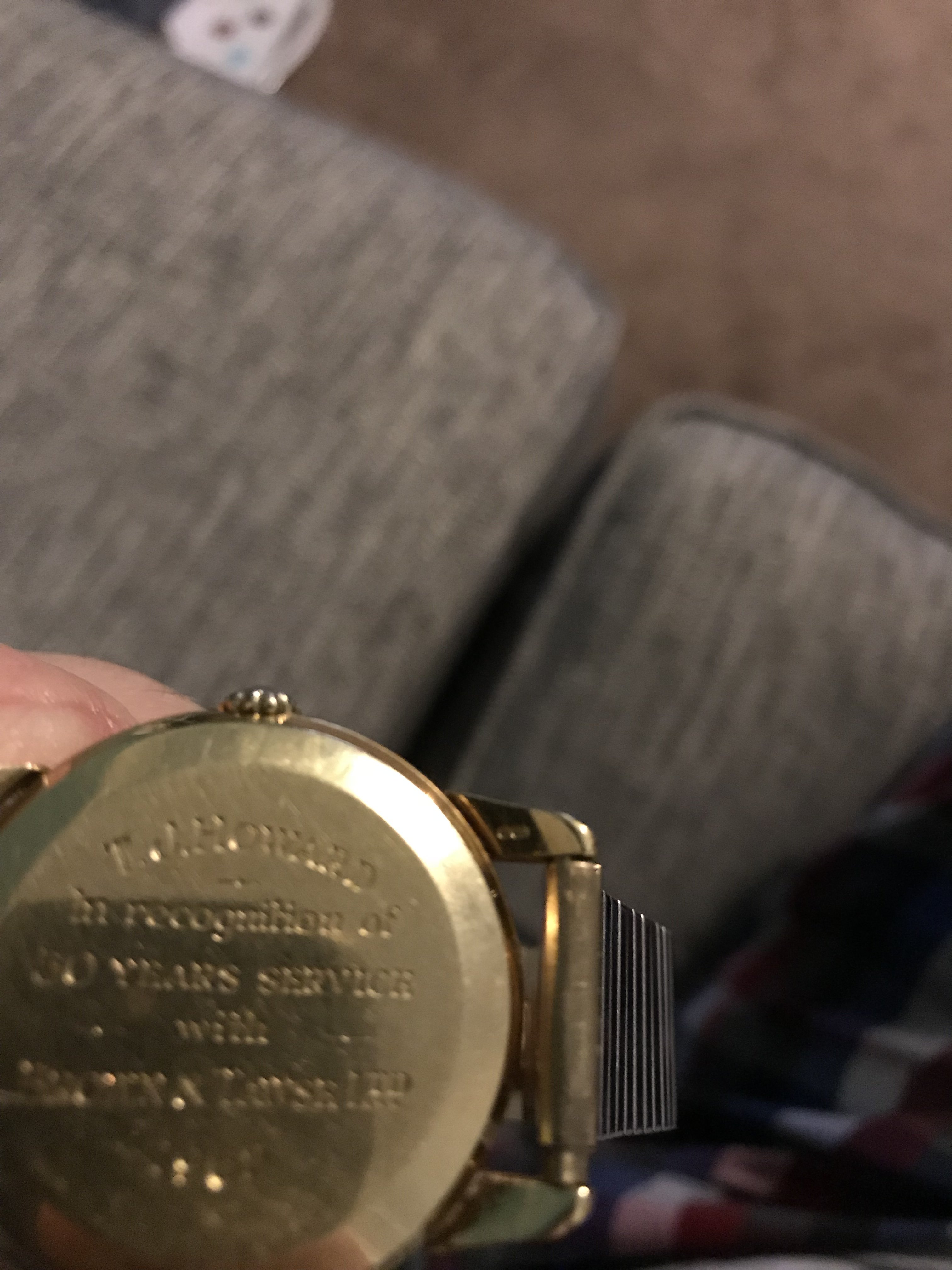

As you’ll see the case back is engraved. I can’t get a clear enough photo of the hallmark. Top right.
The crown does have the omega symbol. But the crown looks like the gold partial come off. Almost like the crown is gold plated.

Thank you for you information. The movement sounds quite smooth so I guess it’s a later movement. Which would correspond with the engraved date on the back.
I’m taking the watch to a Omega servicing agent today. Hoping they can tell me some information and see what it needs to restore it.

Hi Jbrad,
Thank you for the updated photos.
It's amazing to find a memorial watch for 50 years' service. Congrats!
As the focus of the hallmarks is not there on the picture, not sure if it is 14K or 18K solid gold.
Good luck on enquiry with Omega service agent!
