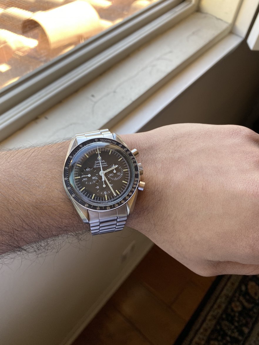

They recommended Jostmar Jewelers in South Coast Plaza. It was kind of hard to find, but it's about a two minute walk from the boutique. Here's my watch:
Nice late 1977 production!
