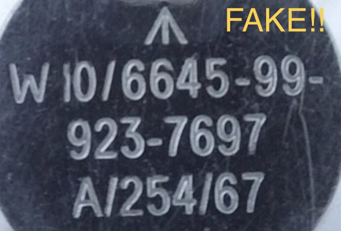

Hi I have been offered a 565 with all the correct casing (the movement number is 27575xxx) but I have not come accross a 565 military 300 before in the flesh?
if you have seen one first hand please would you confirm this is correct. Thank you for any help in advance

No, military SM300 shipped to Royal Navy (ref. 165.024) were all cal. 552, without date. And so were the W10 marked ones, delivered to the British Army, also ref. 165.024.
However, fake military SM300, even if dials had no date, were produced often with cal. 565 or 563 (date) taken from other references (deVille, Constellation. other Seamasters) being scrapped
it would be useful if you show some images, bear in mind that fake military SM300 (apart from many other signs). often had this back inscription:
Thanks Franco.
