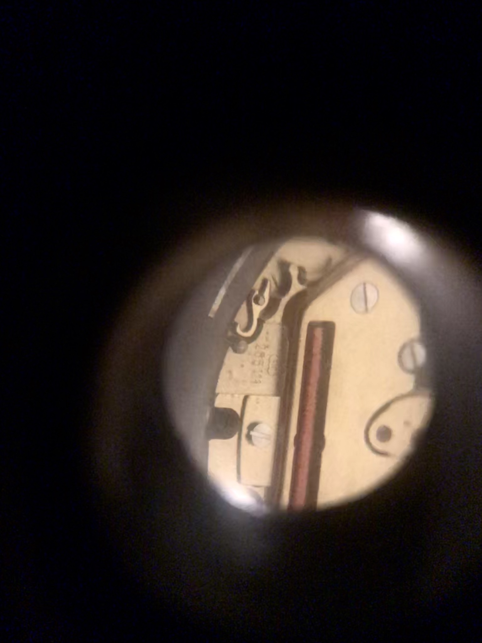

My father has a Longines L4.790.4 quartz dress watch. It keeps stopping randomly and had been to my watchmaker friend who found a broken setting lever and a few other issues but after changing them it is the same and looks to be a bad circuit.

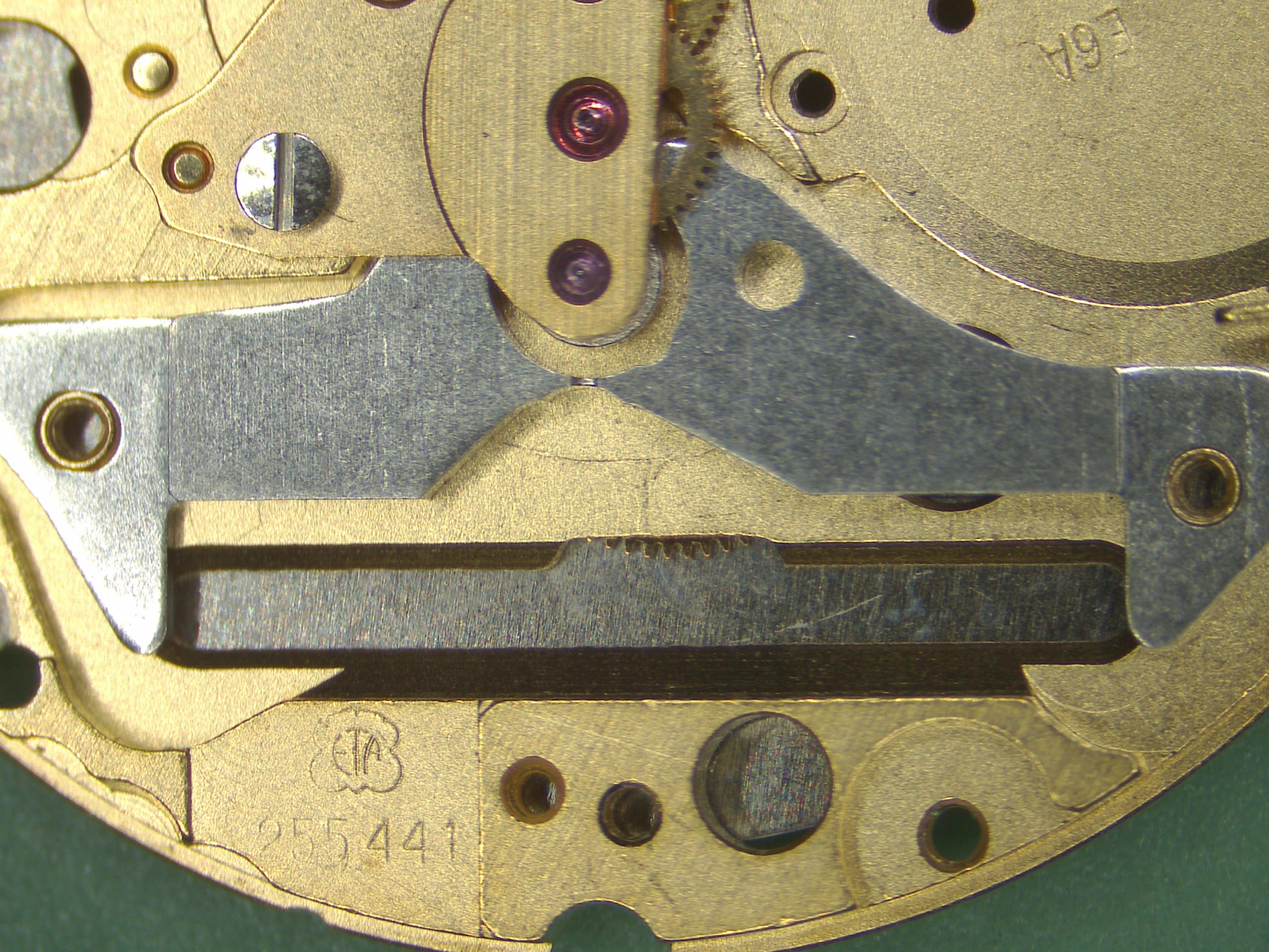

I have pictures of the inside which seem to show a L157.2 movement but I can鈥檛 read the ETA movement number. Is this a 255.111 or 255.112 movement? I understand that is obsolete so not sure if I can get a replacement Longines movement on the newer ETA caliber or just stick a generic ETA in once I know the correct movement.
I was hoping someone might have access to their extranet and can check if I gave them the serial number. I dont have the watch to hand to pop the back off. I do have a spare L156.4 which is an ETA 255.411 but not sure if it is any use.

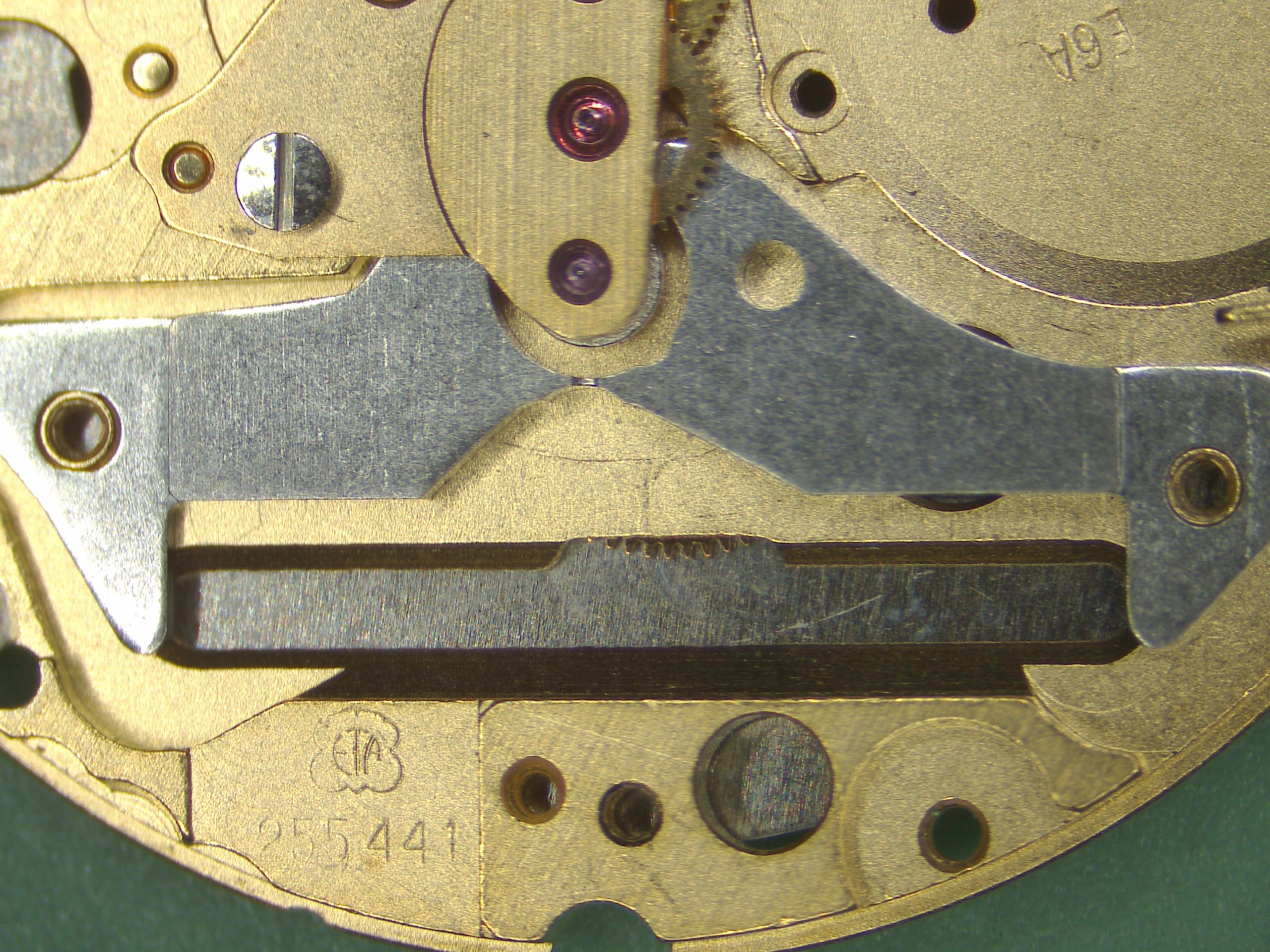

The ETA caliber is stamped just below the coil position. You may need a good loupe and lighting to see it.
The ETA calibers should be fairly easy to obtain.

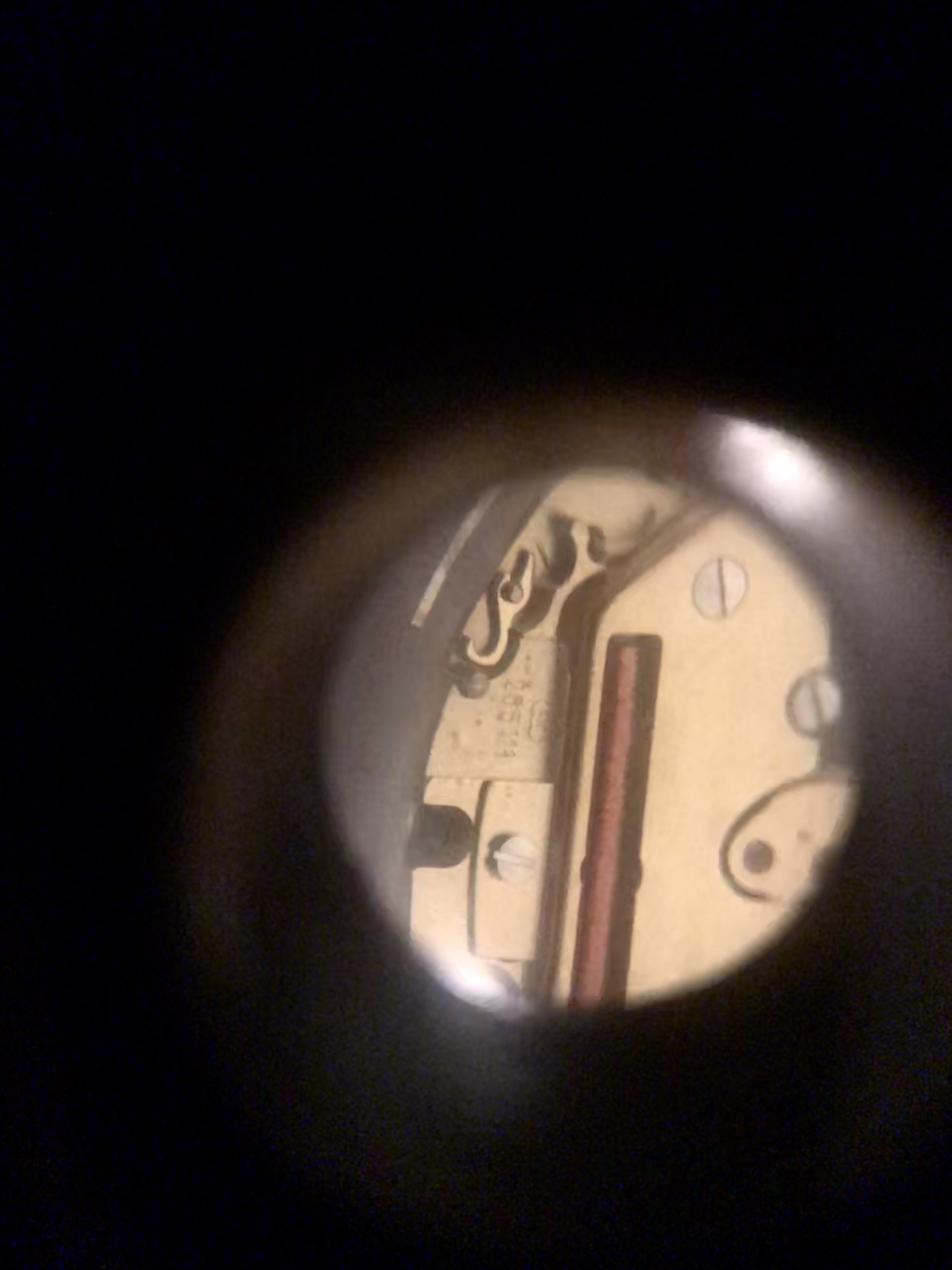

Thanks Guys. I don鈥檛 have the watch to hand right now. I might have to go and get it.
I found the webpage that suggested it should be a 255112. It is just my blurry picture looks like 255111.
I think popping the case back will be the easiest method. I will drive and get it at the weekend.

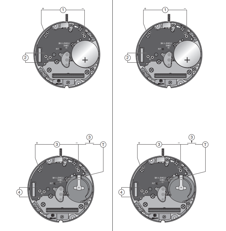

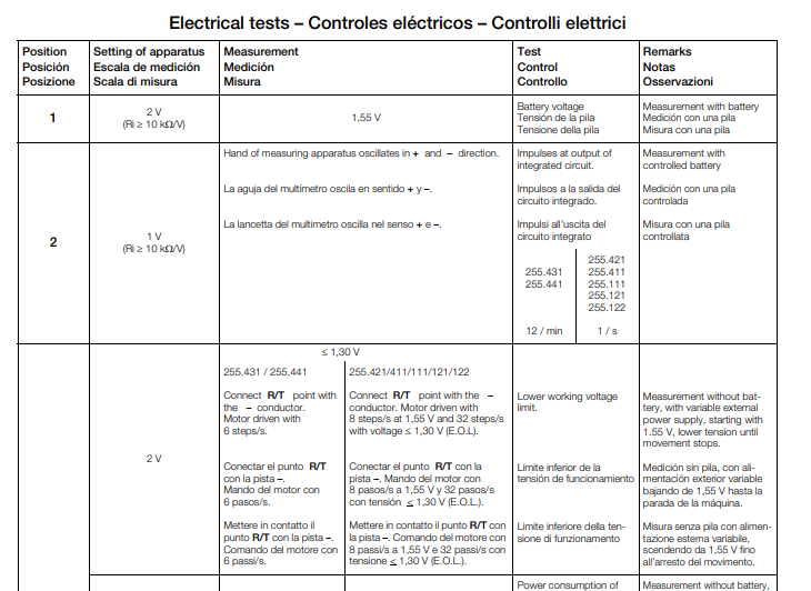

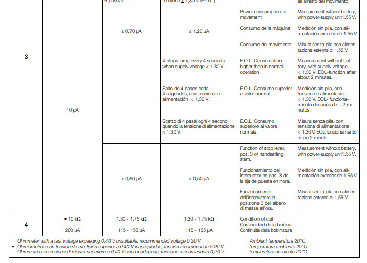

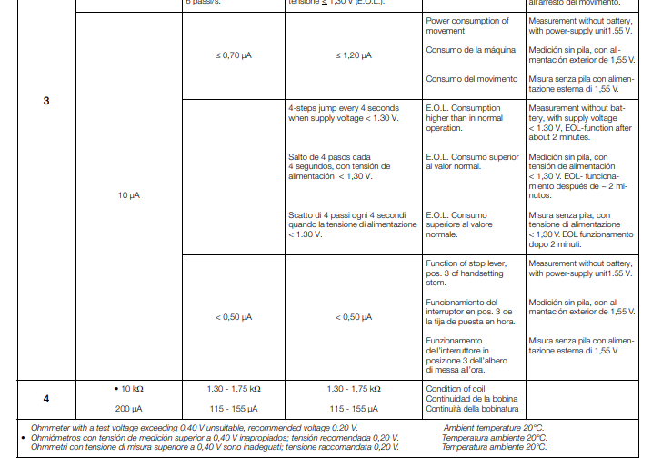

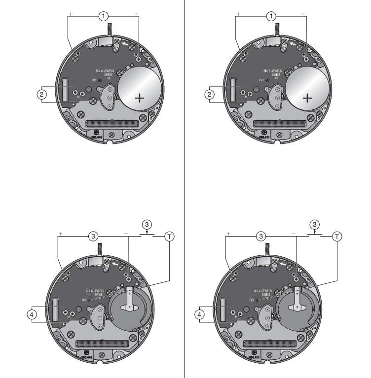

Bumping my old dead thread. The watch started working for another 2 years after this thread. Then died again. I put in a new fresh Renata 373 and no joy. I can confirm it is an ETA 255.111. I also did test 1, 2 and 4 from the ETA datasheet. I don't have a power supply to try test 3.
Test 1 result: 1.57 volts measured across the two contacts.
Test 2 result: voltage detected every 1 second. Hard to read as it flashes up and goes back down again.
Test 4 result: 1.5 KOhms measured on the coil.
After the tests it came to life again then got to 39 seconds (where it stopped before) stuttered and stopped. Bad wheel?
So to me it seems the circuit is good. The hands don't seem to be fouling the case or dial. The movement is as dead out of the case as in the case (not likely to be a stem that is too short causing the hacking to kick in). I can't send it back to my last watchmaker easily as he is based in Sweden and I am in the UK so don't want to get hit with import taxes for a repair. I have a watchmaker not too far away who is Rolex, Patek, Omega and TAG certified and beleive the Omega cert opens you up to almost any swatch owned brand, but he isn't cheap (and rightly so).
