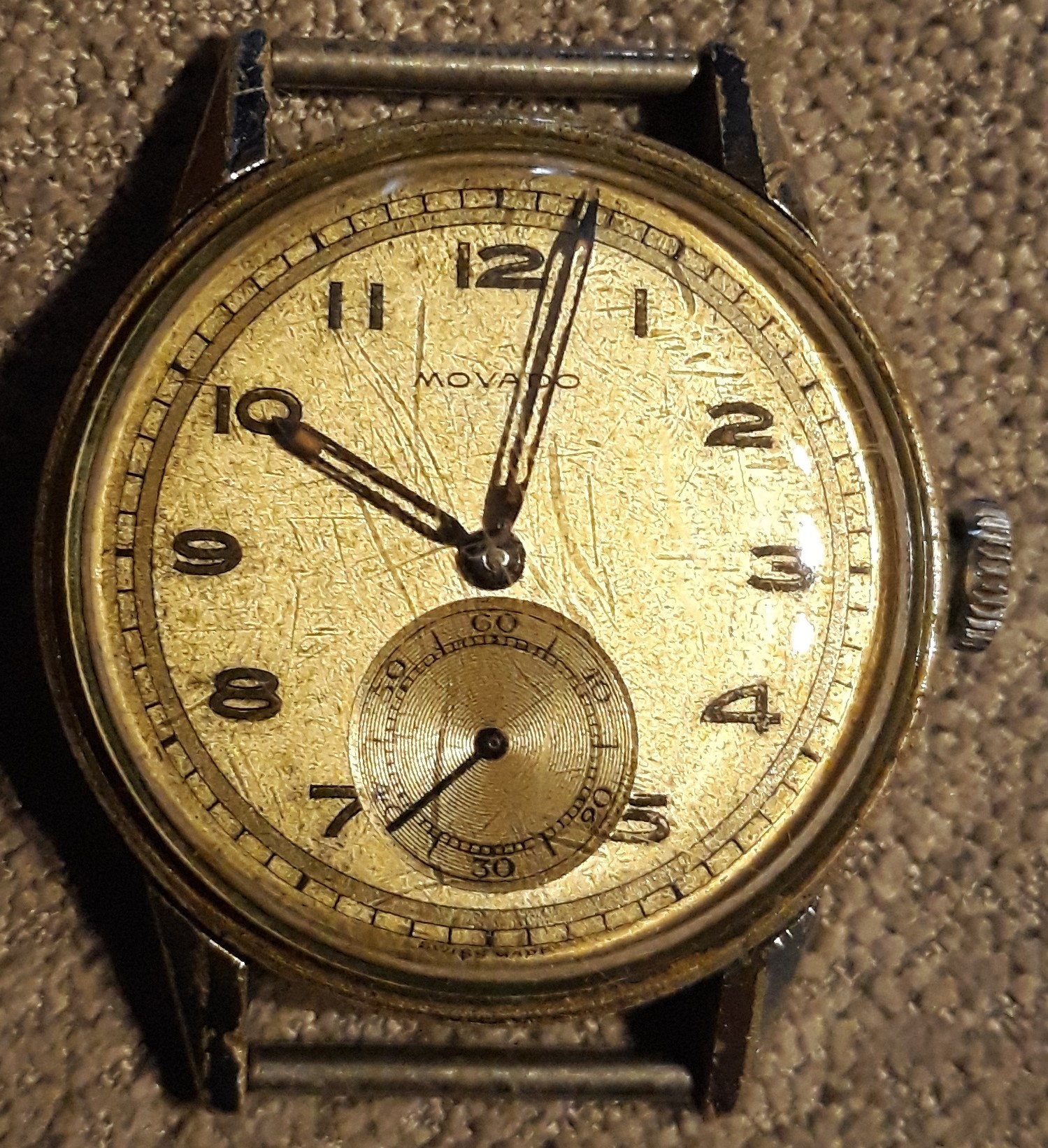

Hello, I hope someone can help me and describe this Movado watch of mine (which movement, year of manufacture...). Thank you
13,636
18,994
Getting information on vintage Movado is not an easy task. The current company is pretty much useless when it comes to non-quartz watches.
There is only one source I know of to assist with old Movados:
https://movadolookup.wordpress.com/
You are going to need the inside of the caseback, which will contain the case reference and elements of a serial number. A table will match the caliber to the reference. A separate table has information on dates for each movement caliber.
An inexact science at best, but it is all we have.
gatorcpa
6,854
10,674
Nice one. What size is it? As stated above dating Movado's is not easy but based on the design I'd say around 1940. Dial is in very good condition and the good thing about cal 75 is that they are abundant

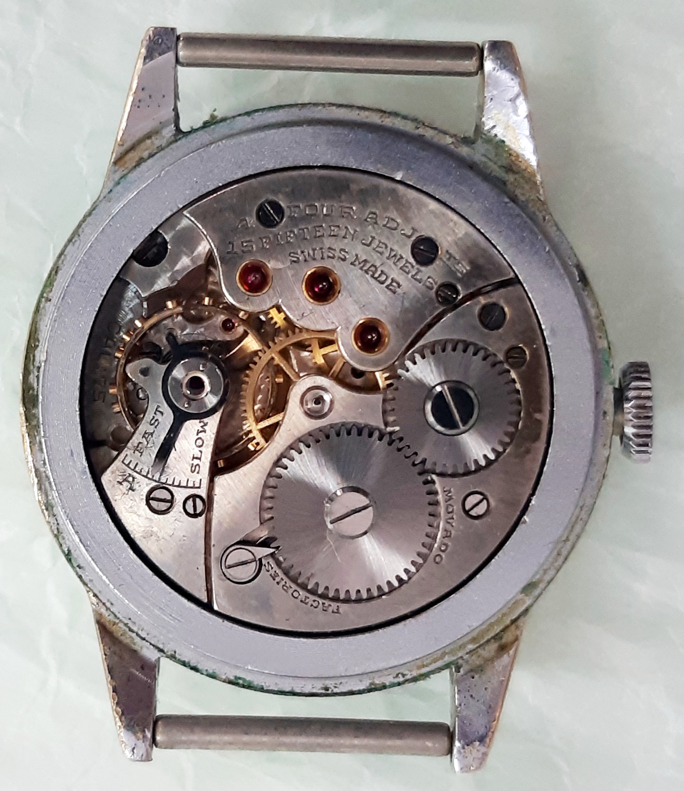

13,636
18,994
Cal. 75 stamped under the balance.
Table 2, Page 1 shows that cal. 75 was produced from about 1930 to 1960. Like I said, an inexact science. Based on the style, I would say more like mid-1940’s.

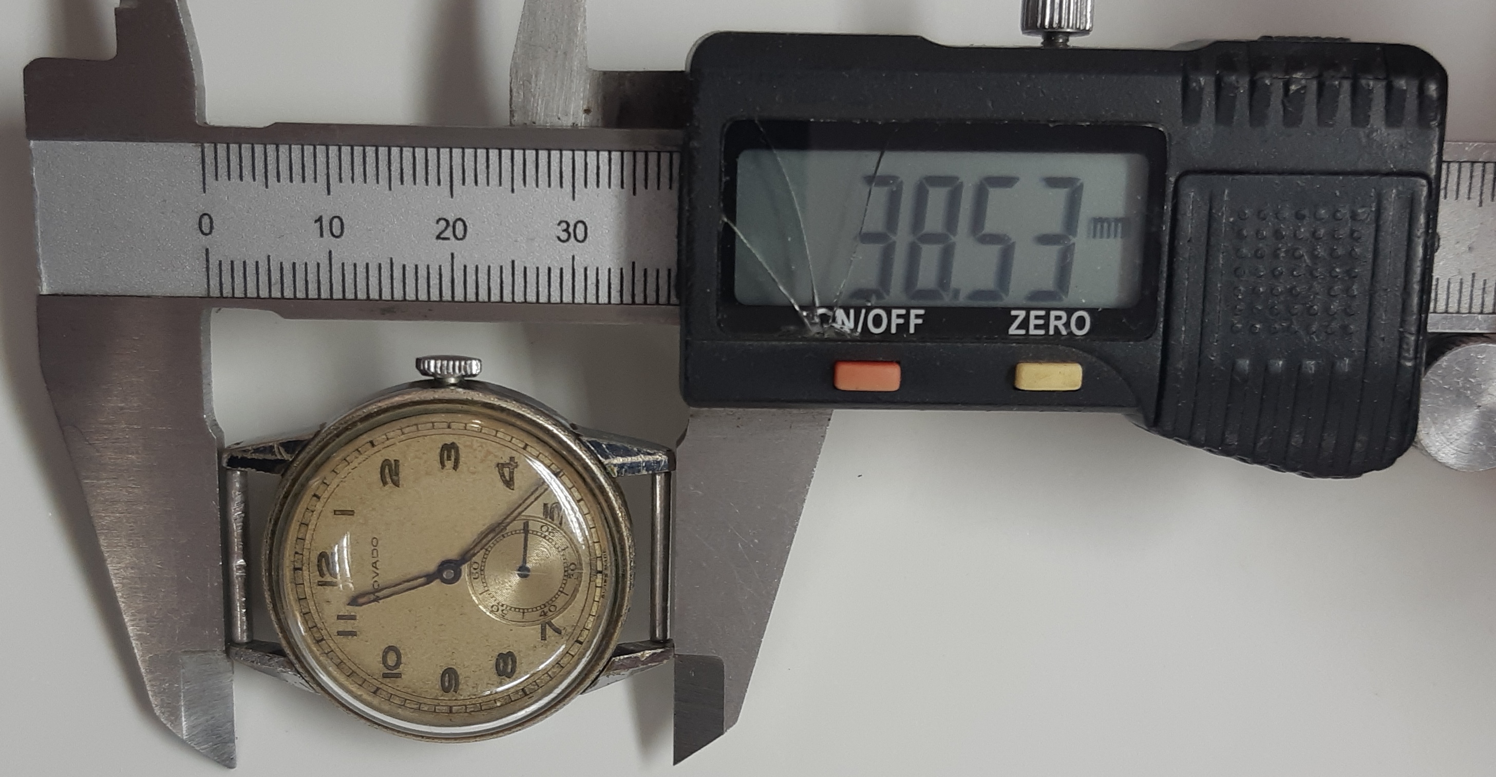

What about the size 😎
27
56

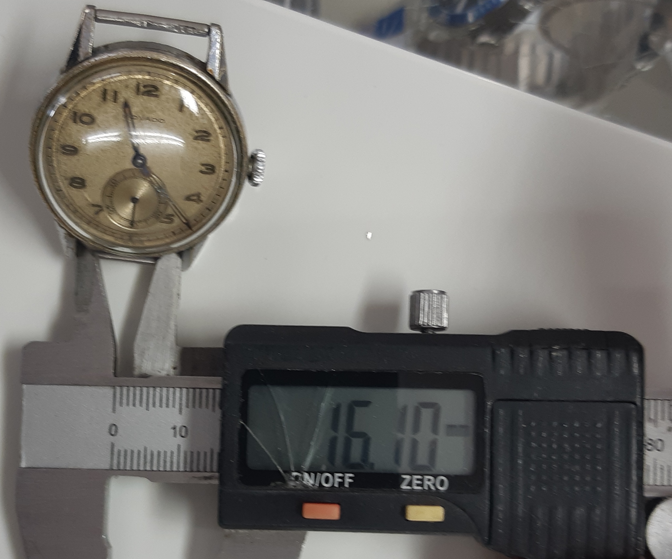

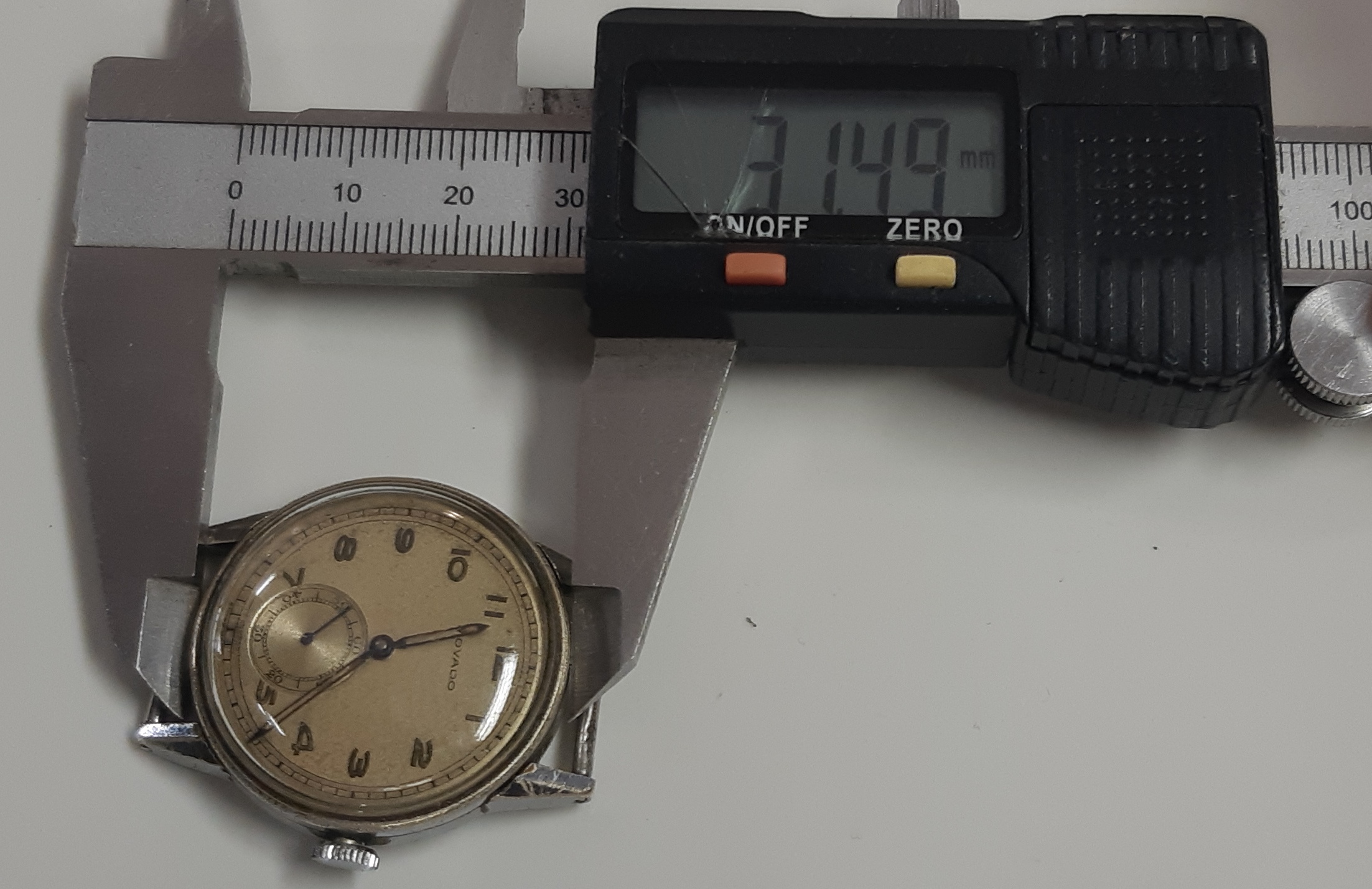

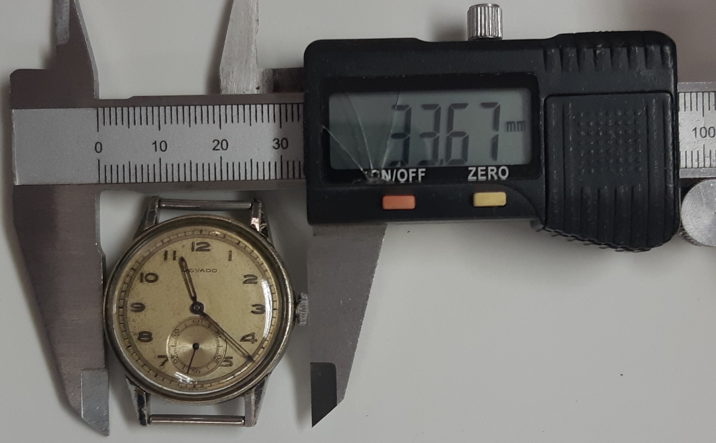

Hello, sorry it took so long. Here are a couple of additional photos, which will bring some useful information, I believe. If any new conclusions can be drawn based on the mentioned photos, please let me know. Thank you very much.
6,854
10,674
So 31.5mm case. Bit on the small side unfortunately
Could you please explain a little more precisely what that means? I don't know much about watches, so I would be grateful if you could explain it to me. Thank you very much.
6,854
10,674
I think most men like to wear a watch with a case size of 35-40mm
27
56
That is correct. That is why, as I wrote before, that watch was bought in 1941 by my grandmother. A women's watch, unisex or at that time maybe also a men's watch for men with smaller wrists, of which there were certainly more 80 years ago than today. In any case, that watch is too small for most men today 😀

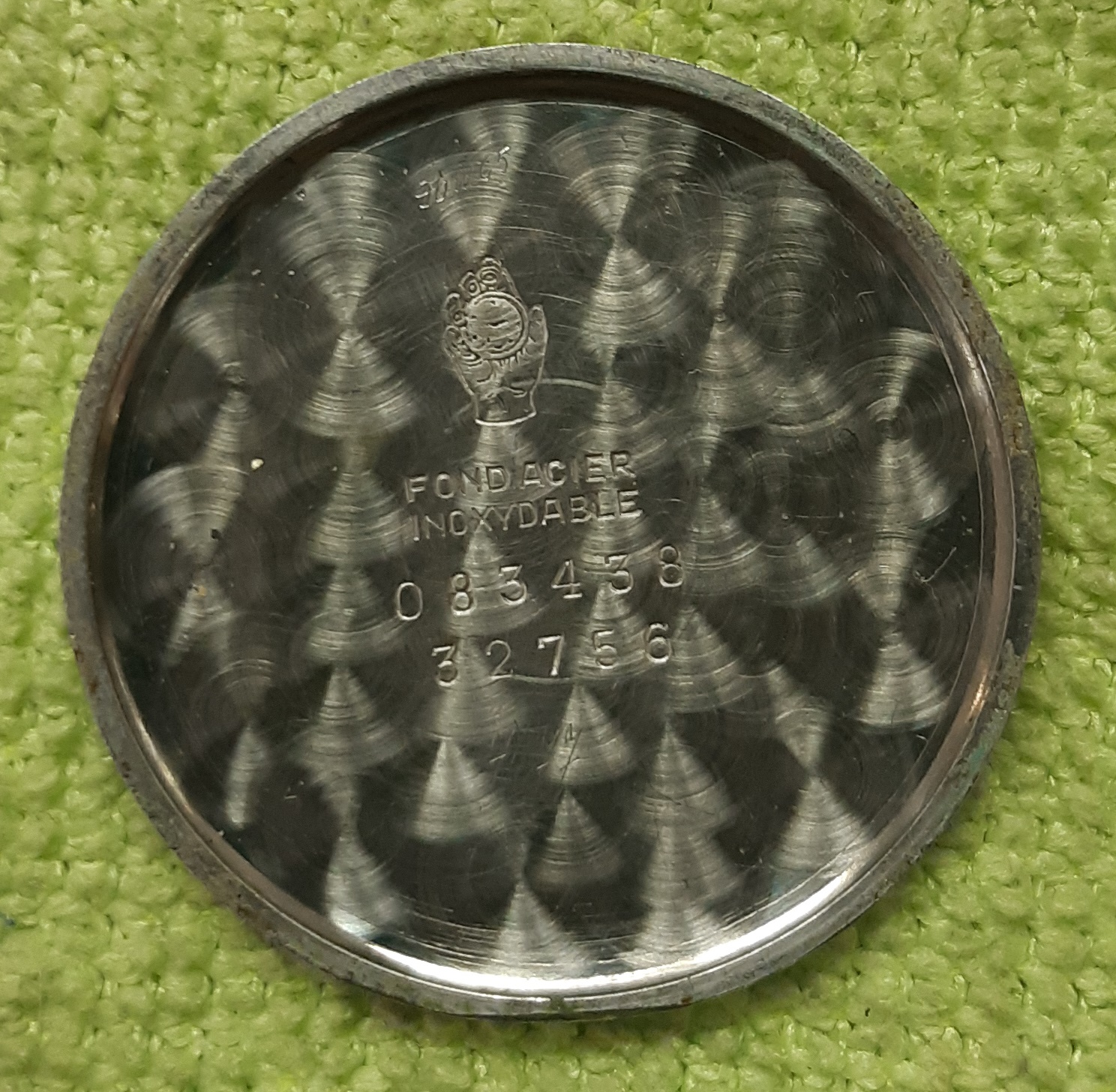

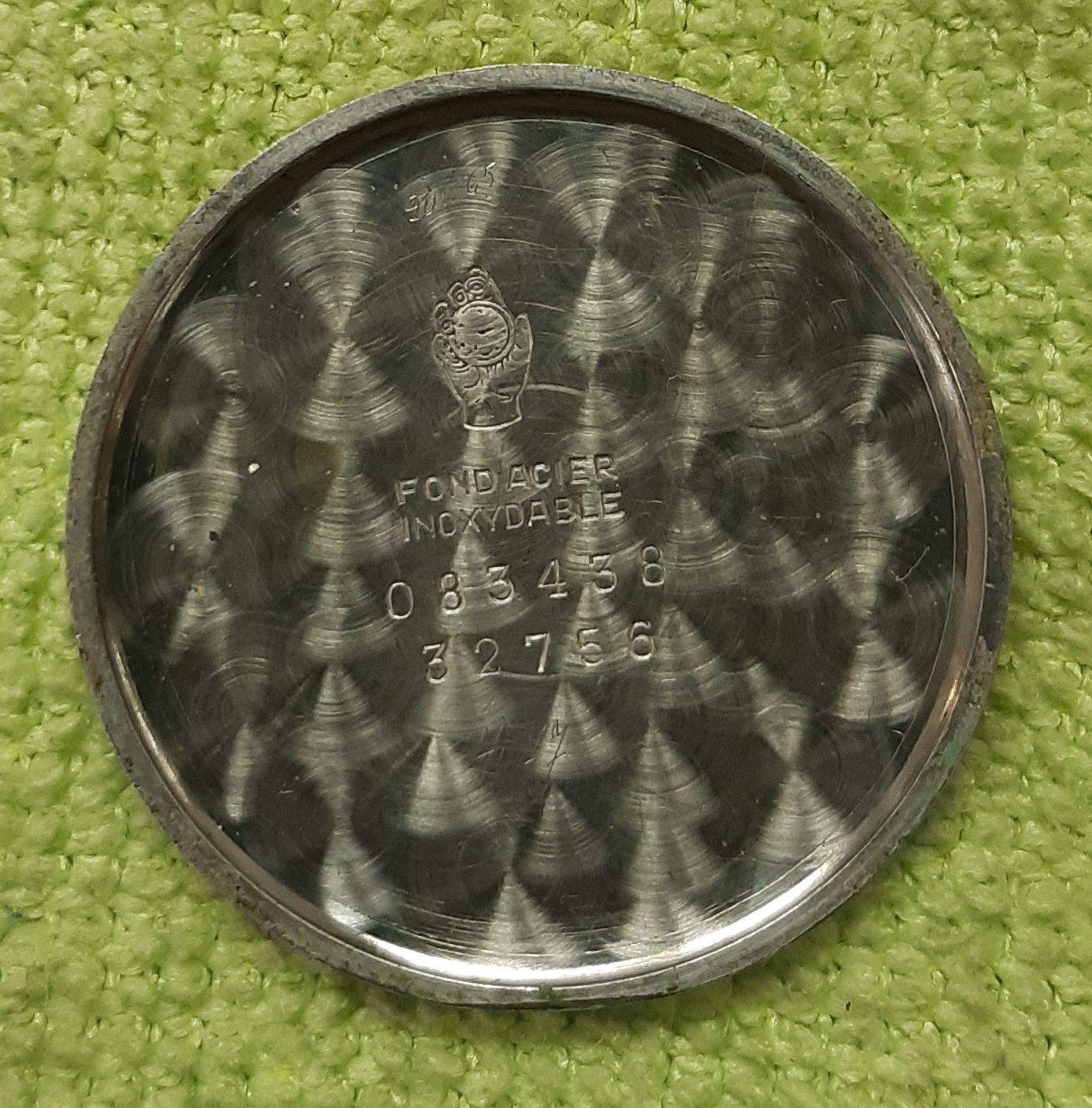

Hello, could you explain the numbers in the picture? Thank you
8,257
29,173
While it was made for men originally, the small size by today's standards is just one of the issues with the watch that degrade its value. Unfortunately, "Fond Acier Inoxydable" means that the back of the case is made of stainless steel, but the upper case is chrome-plated, which is far less durable, and far less attractive to collectors. Also, the missing luminous material in the hands is also a negative.
The numbers are serial and possibly model reference numbers. The watch likely dates to the 1940s.
6,854
10,674
Serial is the one starting with 0. Reference is 32756
13,636
18,994
The number on the bottom is the reference number.
The first digit is “3”, which means the case is not steel, but chrome plated. “2756” is the style number, which, per the table on page 2 of part 1, corresponds to caliber 75, as we thought.
We’ve already estimated the production date of the movement to be between 1930 and 1960.
