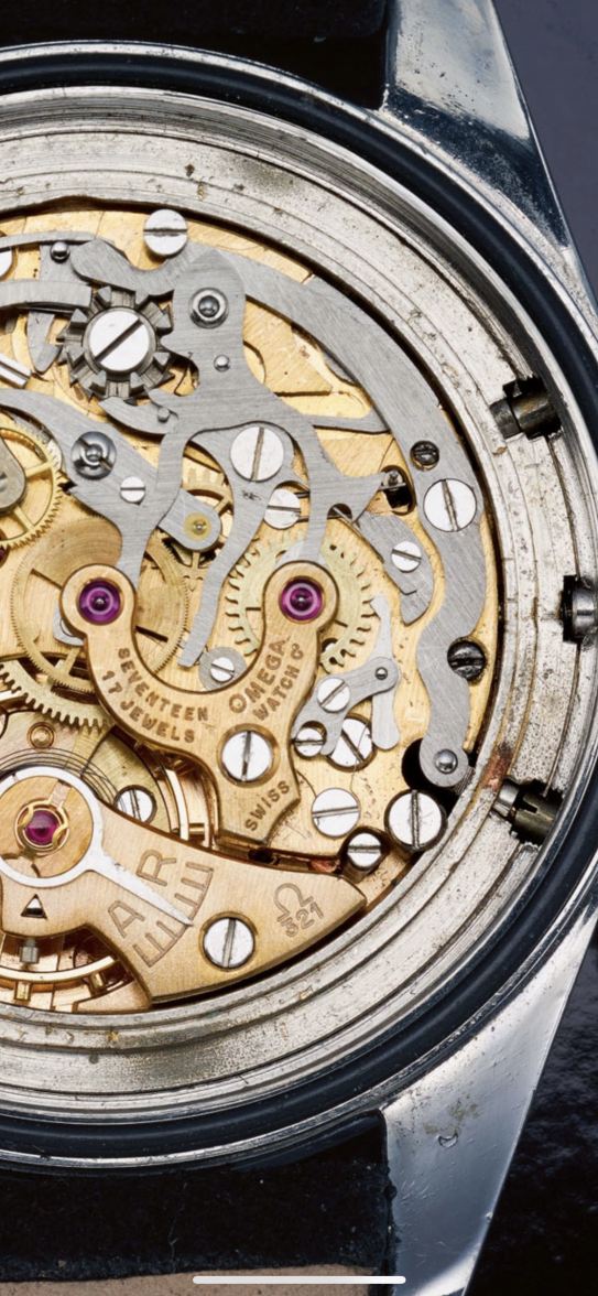

Because I shoot macro photos of my watches I noticed that my caliber 321 Seamaster is missing one screw.
Does anyone know the exact part number? I tried to Google it but couldn't find the correct answer.

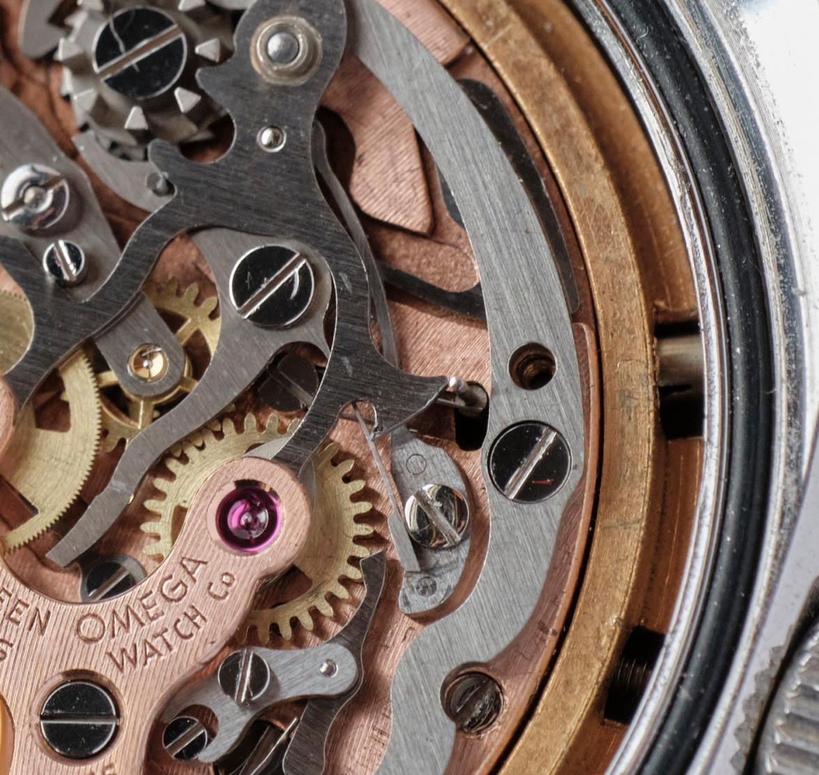

Can you provide a photo from another 321 movement showing what you expect to see there. If you get some better lighting on your movement, it may look the same.

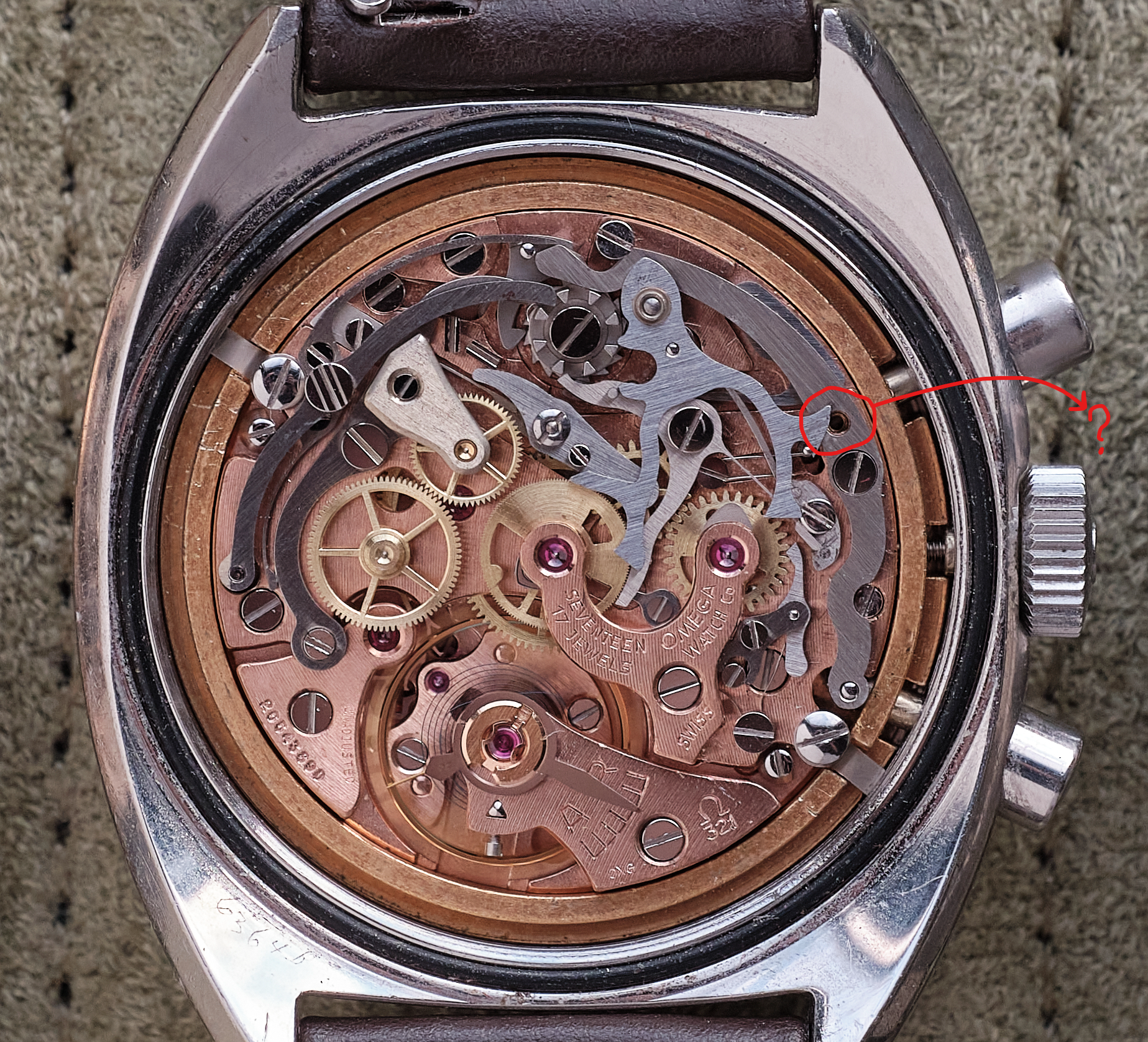

I checked from another photo and clearly is missing and I can see there's a screw hole.
1,733
5,380
OK... this is interesting now. I've checked many photos of Omega 145.006 cal 321 movements. And I think all of them are missing that screw. Every listing on C24.
