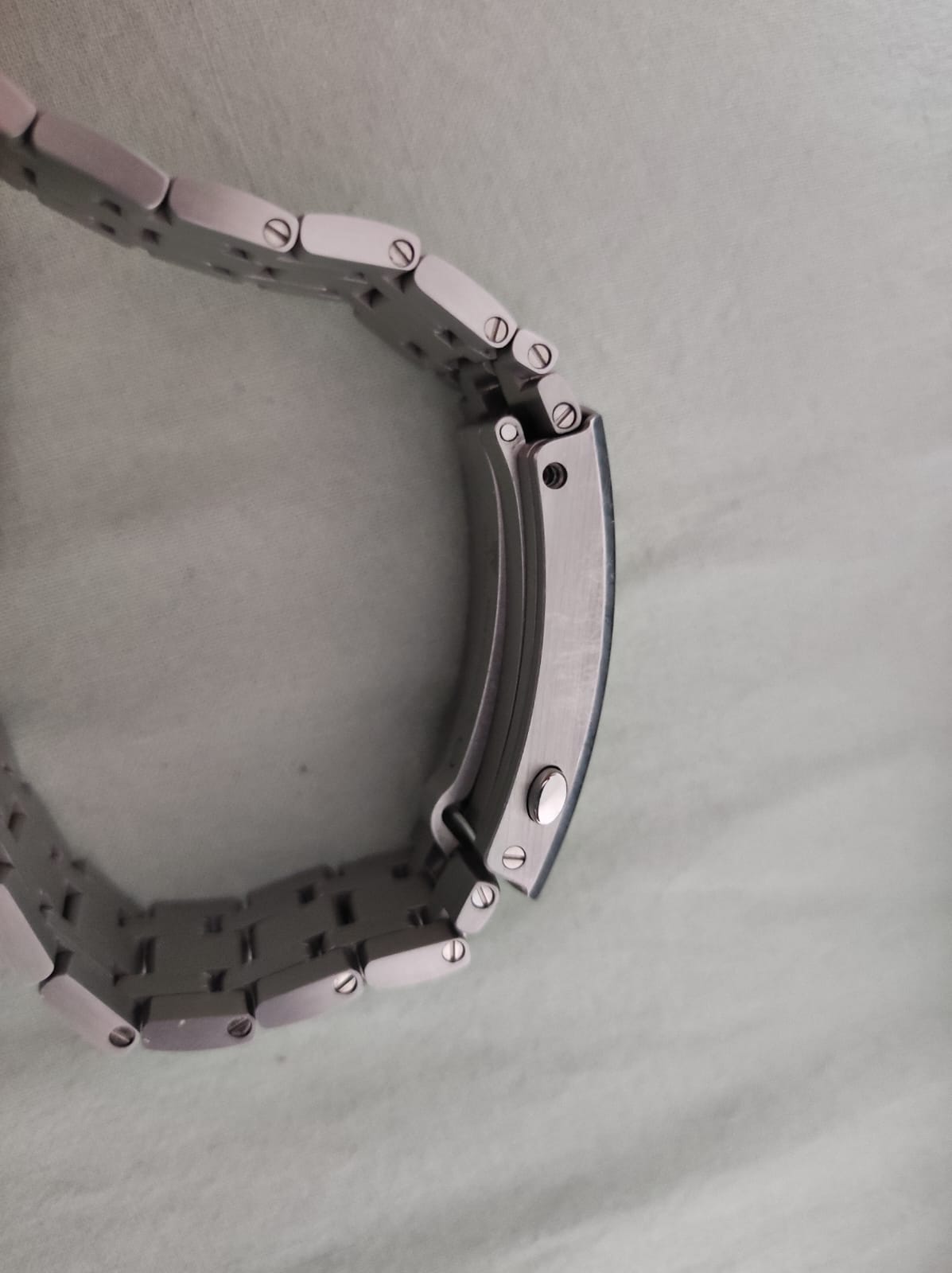

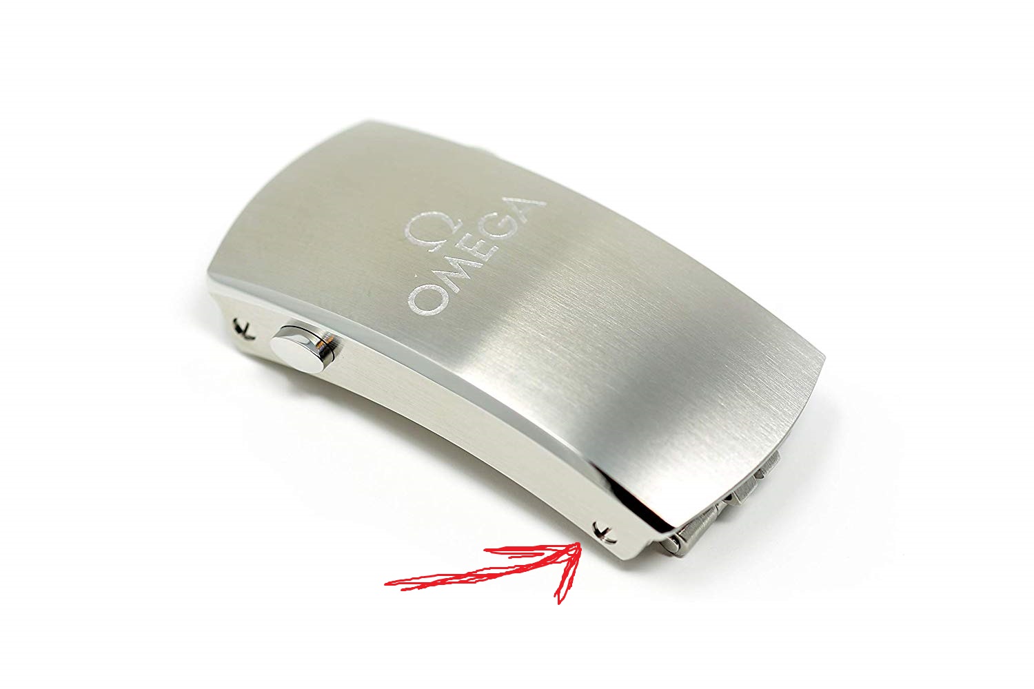

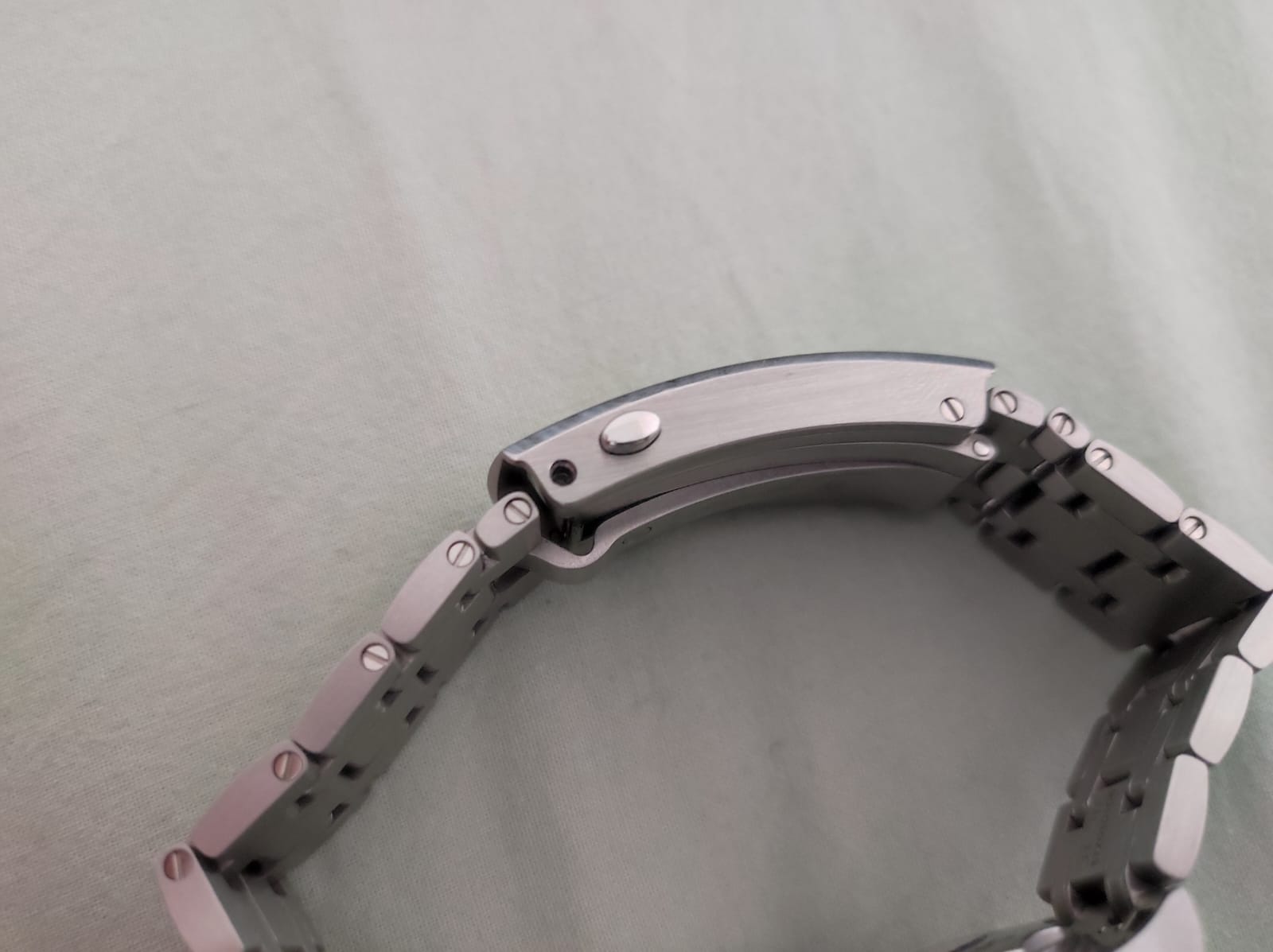

Hi guys,
I have a Seamaster 300m with the adjustable clasp part #117STZ004666.
My clasp has for whatever reason had a screw fall out. I've attached a photo that points to the screw. It's not a regular bracelet link screw, it must be slightly longer because when I try and screw in a bracelet link screw, it's too short and doesn't catch or screw in the spot in any way.
Does anyone know where I can get a replacement screw??

unfortunately, i've seen this happen a few times. take it to an OB and they will provide you with a new screw (most likely not charge you too) and secure all 4 screws with a little loctite
