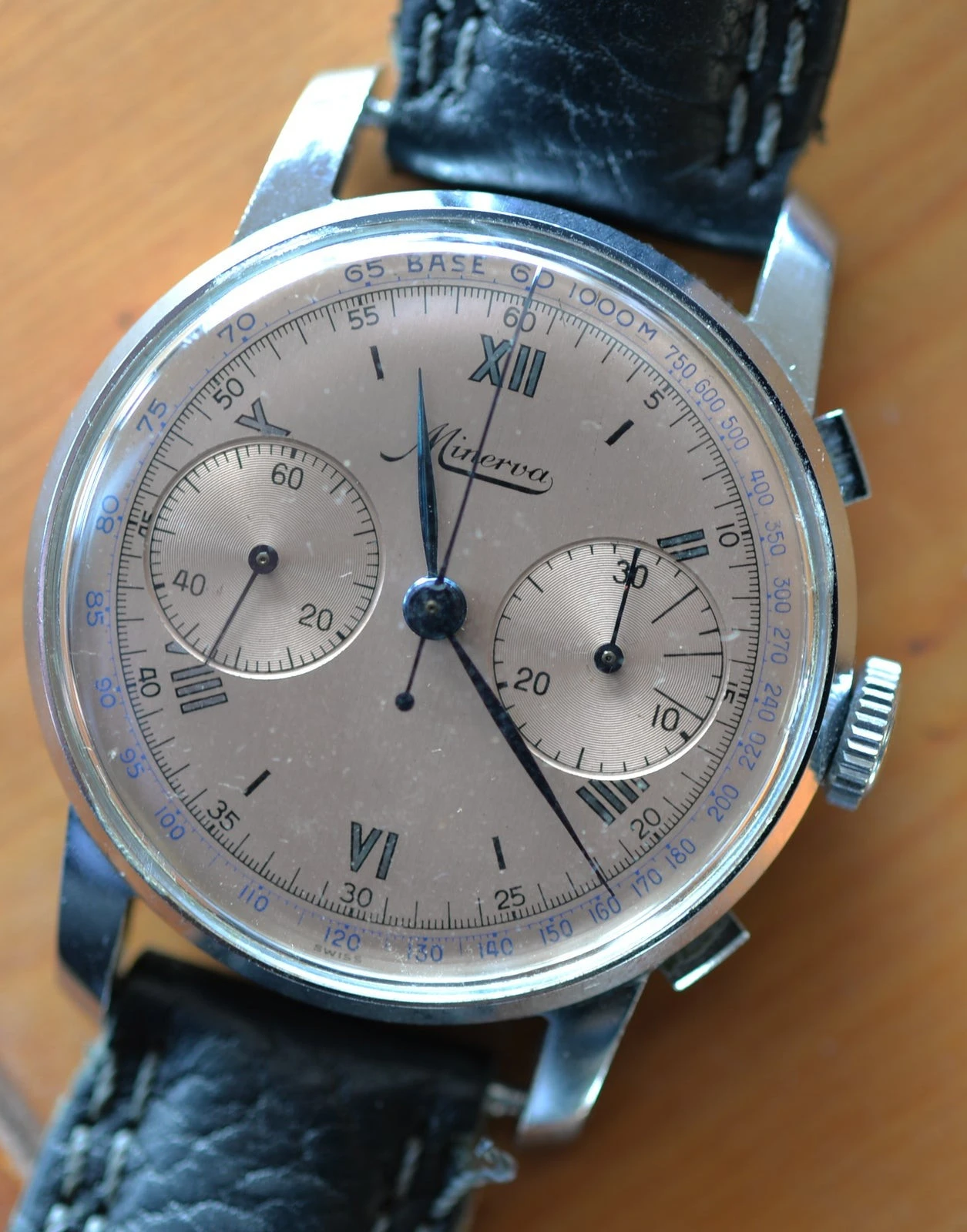

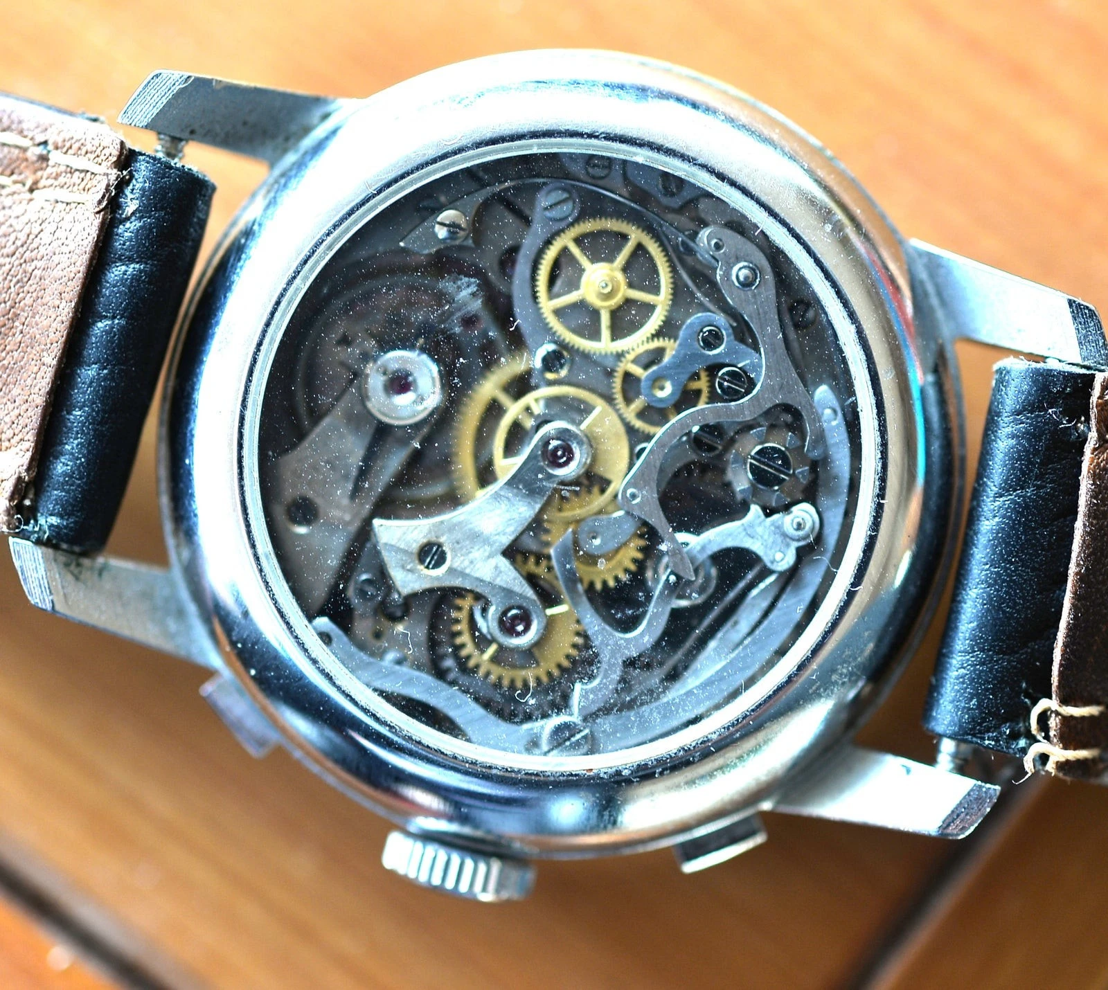

I found this Minerva Chronograph but can't seem to find this exact reference. It comes with a glass caseback, which must be aftermarket, but what about the rest of the watch?

It looks legit, although I would have expected to see the bridge engraved with Minerva branding.

without the original caseback it is generelly a problem for collectors
and it reduces the value
unsigned bridge as said before
and for these reasons everyone will think about the case - but it could be original
dial and hands will be the conclusion, that they are original
The seller says that the case is not original, but the movement, dial, and hands are. The seller is asking for 550 euros. Is that a fair price?
353
1,081
so the seller can also tell you, wich movement it is
781
1,342

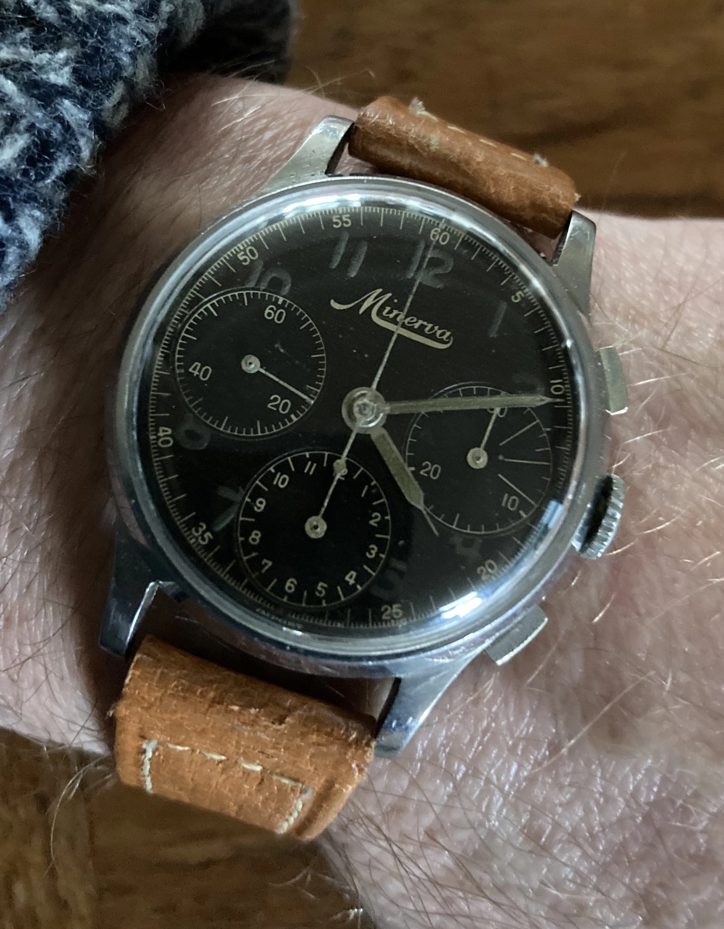

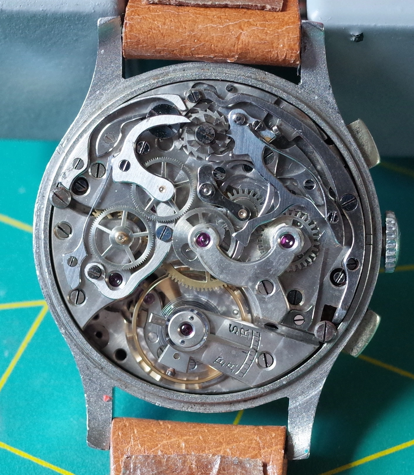

I have a Minerva chrono that I am pretty confident is all original, with a valjoux cal 71 mvt that doesn't have a signed bridge, but I am no expert on these.
353
1,081
