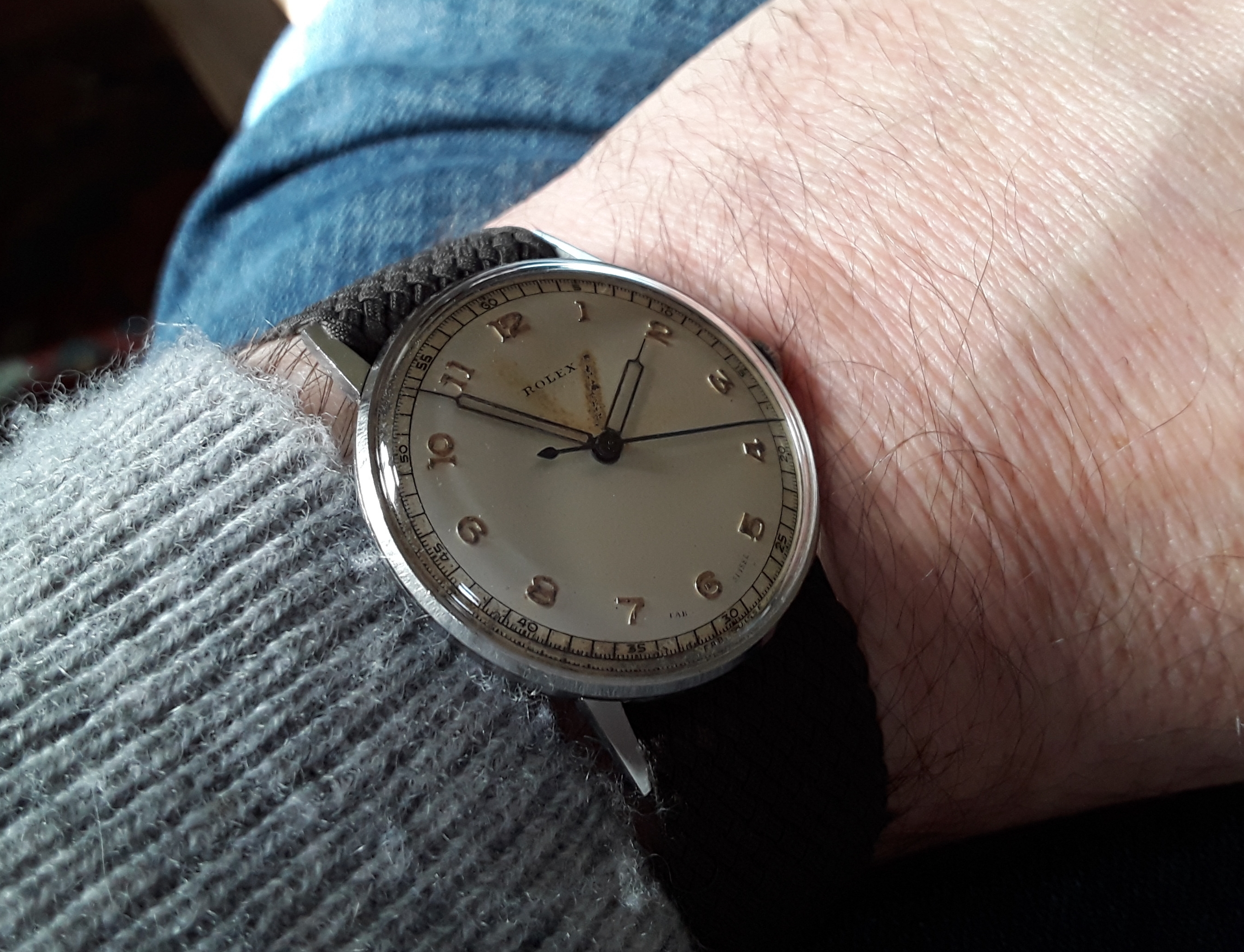

Hi Tom,
Nice watch, I have the same réf with another dial and fixed lugs.
Mine is from 1937

Hi Tom,
Mine is from 1937
Thanks!! I like the dial on your watch too. After seeing the hands on your watch, I'm wondering if I misunderstood that mine were replaced.
