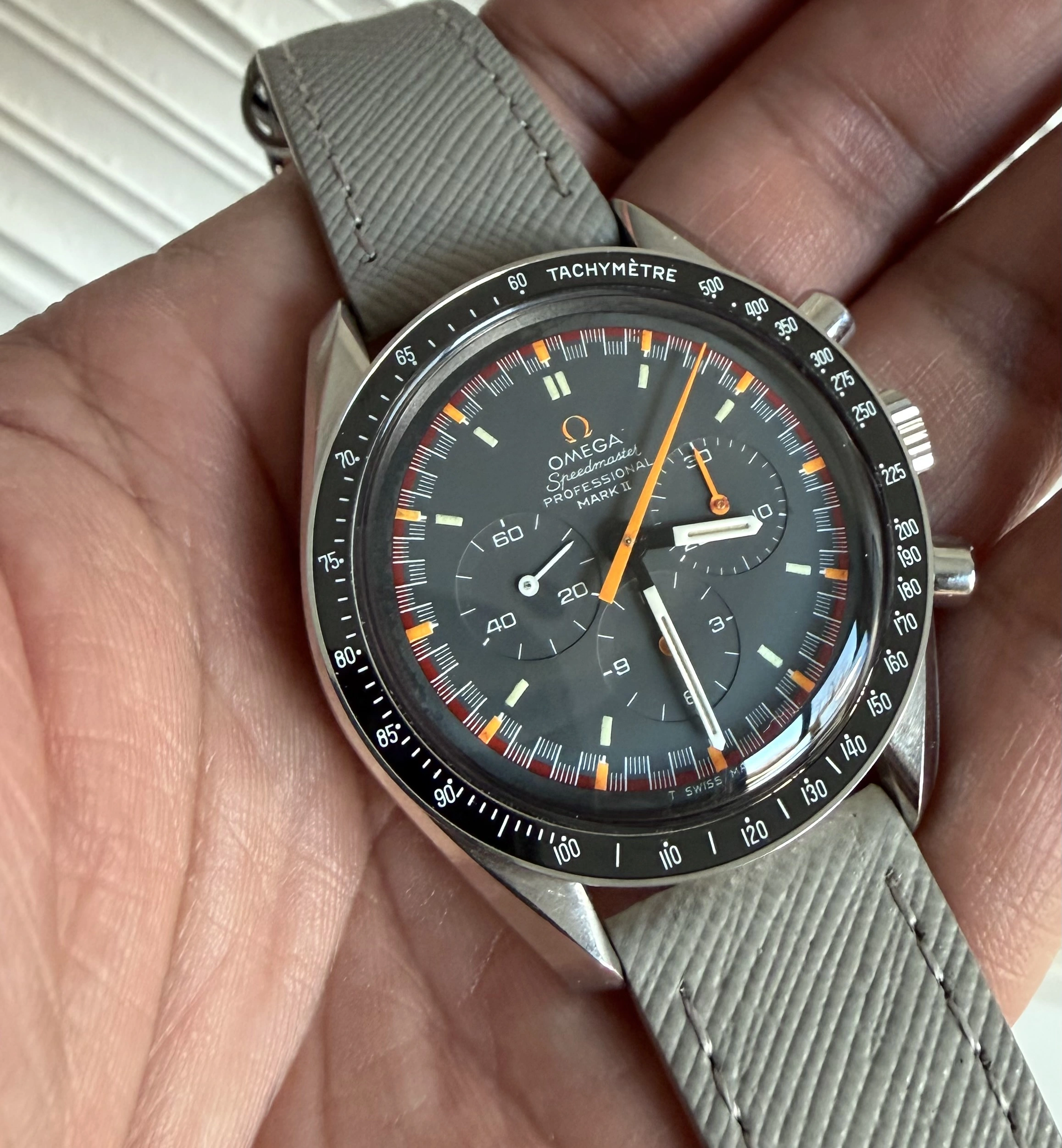

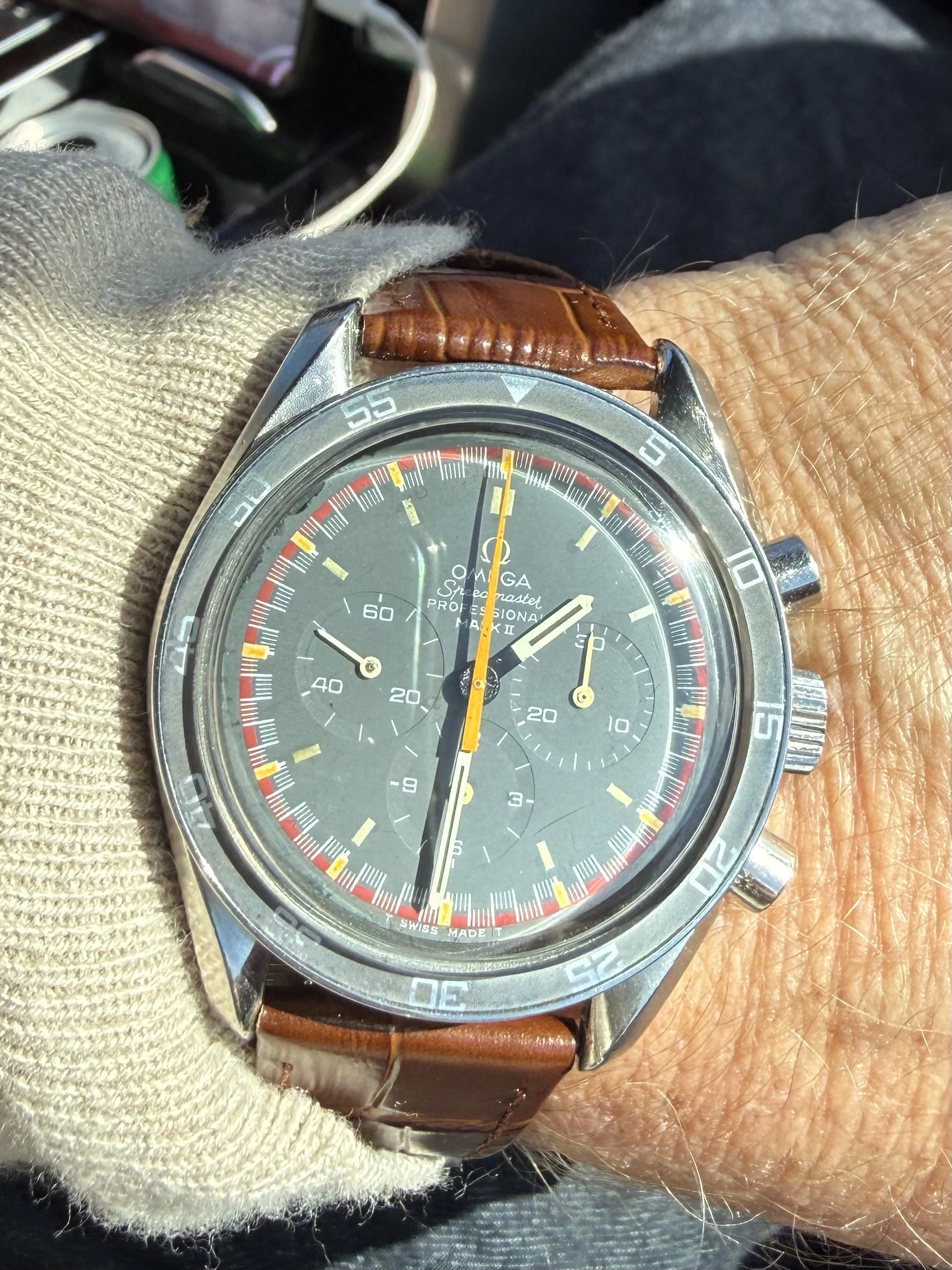

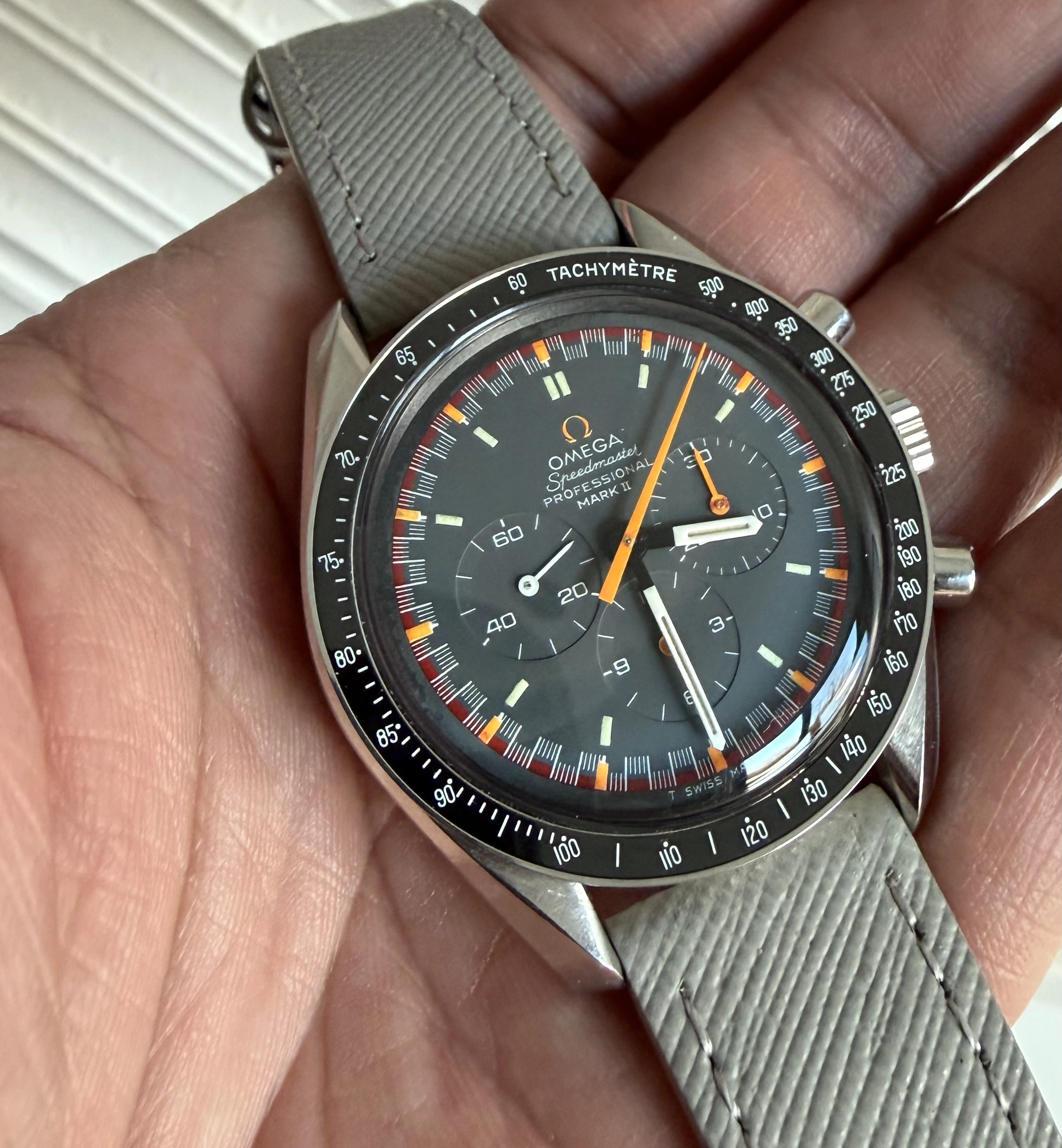

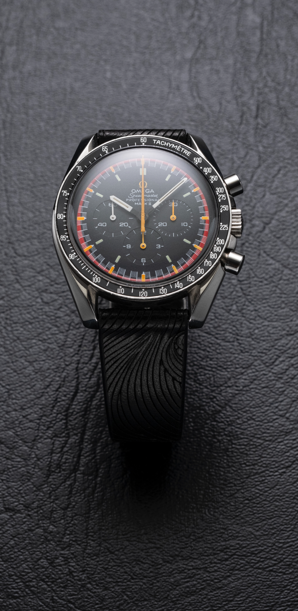

I have worn my modded Speedy on many straps. So, here are some samples. I love Veblenist straps!
Nona
Excellent pictures and some good looking straps !

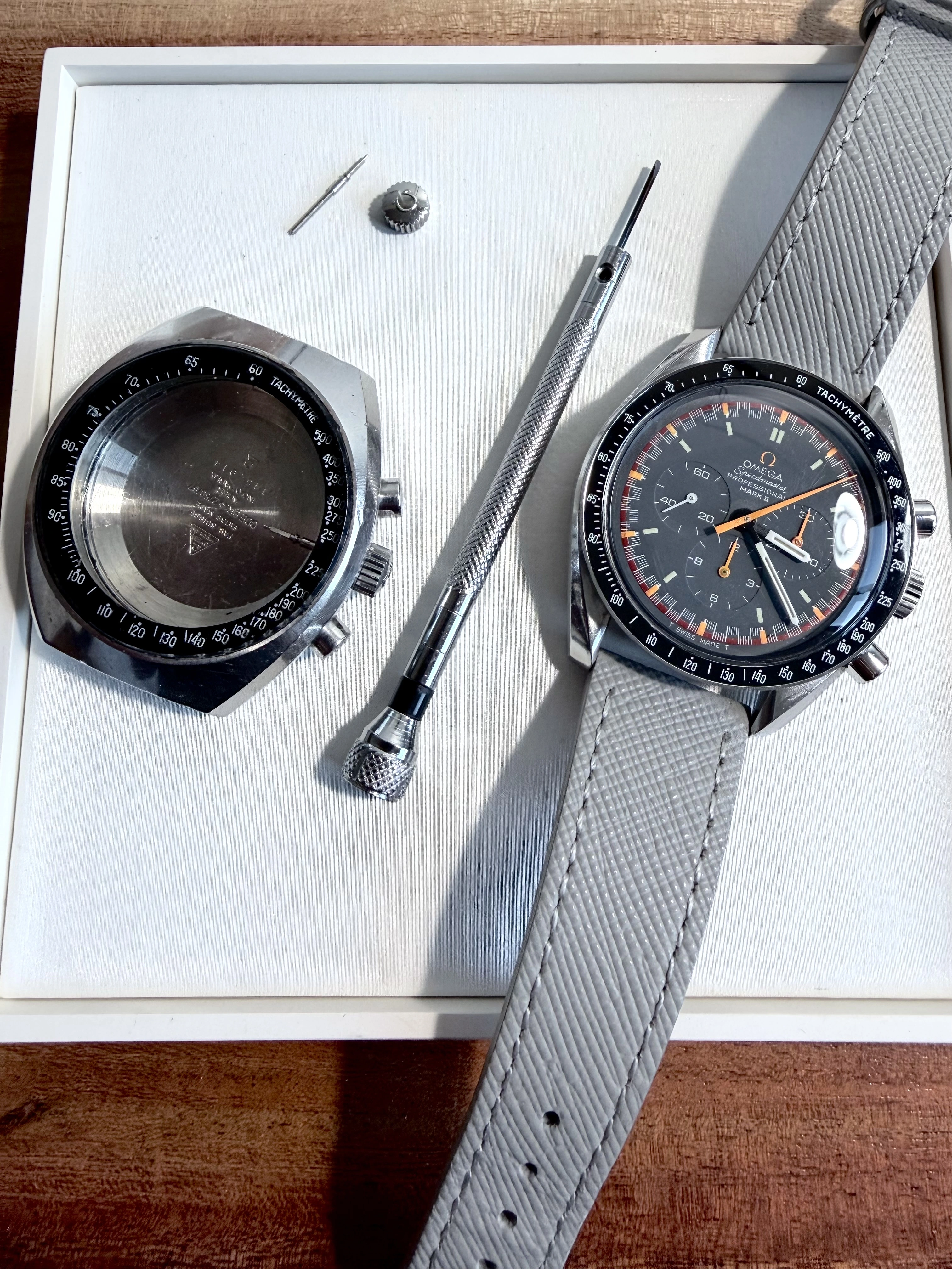

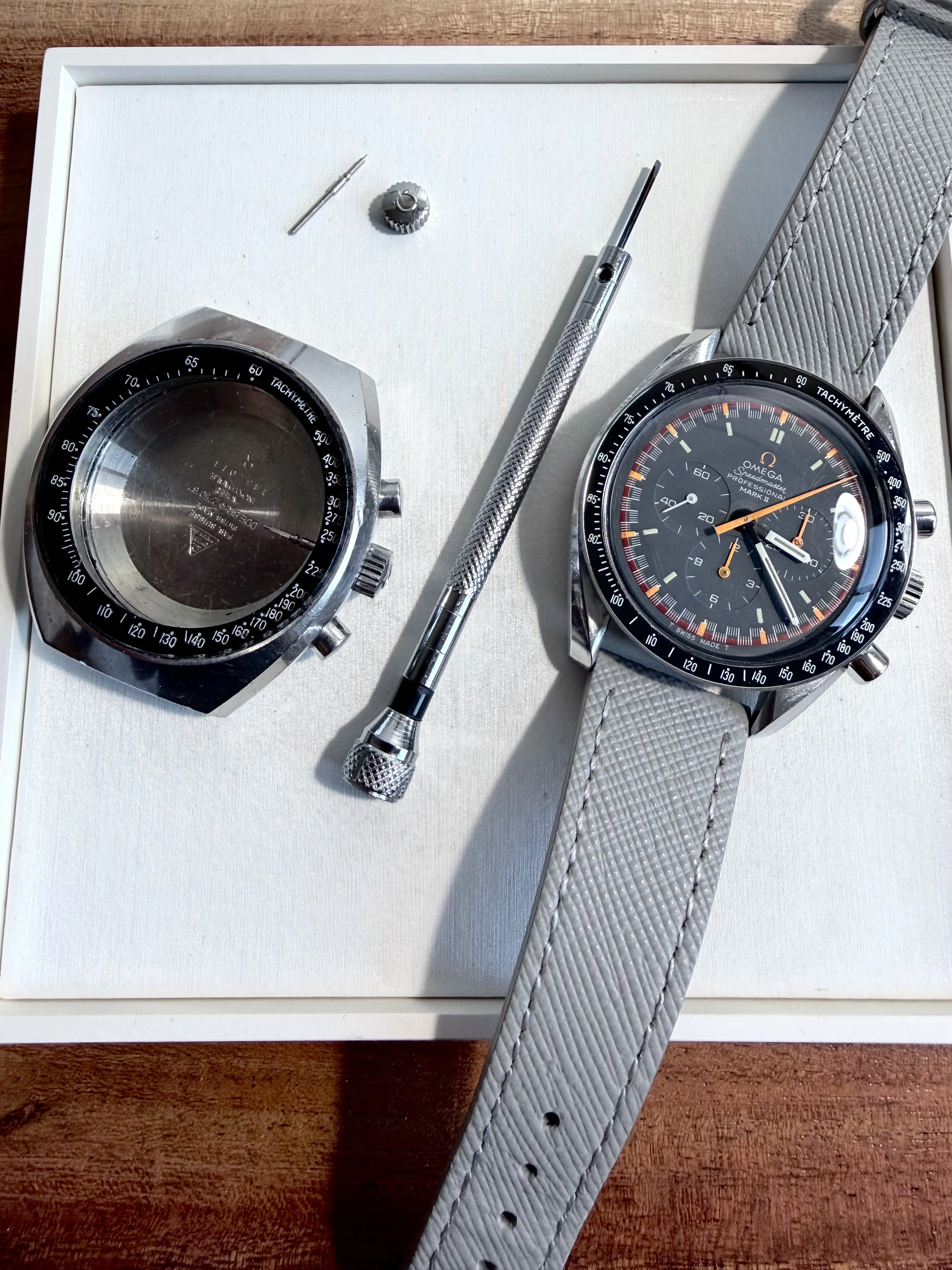

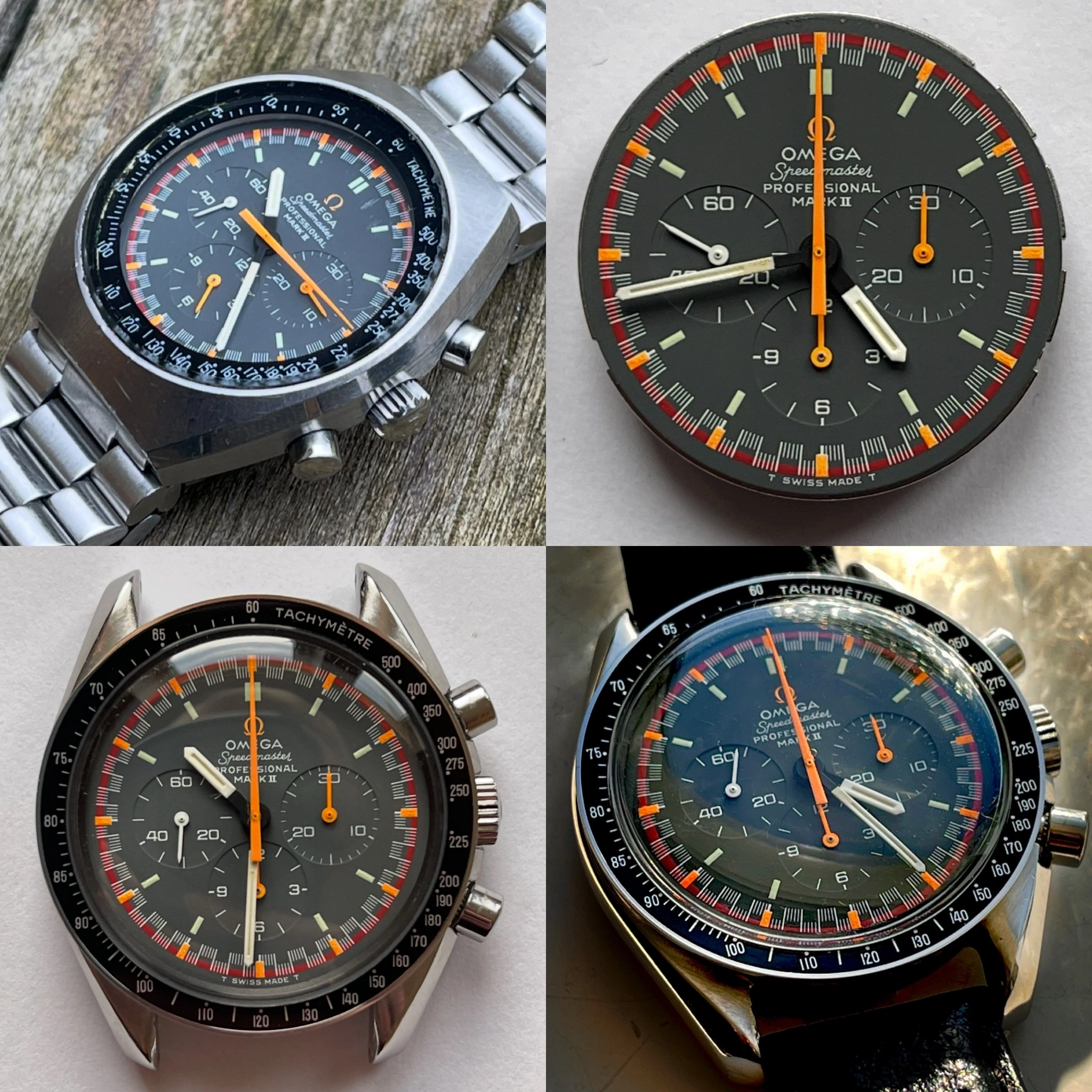

Some truly outstanding work here, gentlemen. Many thanks to @eugeneandresson for the original inspiration—seeing everyone’s mods gave me the confidence to finally try my own Mark II → Speedy Pro recase.
After several attempts trimming a new stem to length, I finally got one to fit perfectly. This project wouldn’t have been possible without the guidance of @gdupree, who very generously walked me through my first mod.
The trickiest part for me was getting the stem to lock correctly. In my case, I needed to fully insert the stem and back off the setting lever screw about a quarter turn to allow proper alignment before it would engage as expected.
This thread was incredibly helpful and made a big difference:

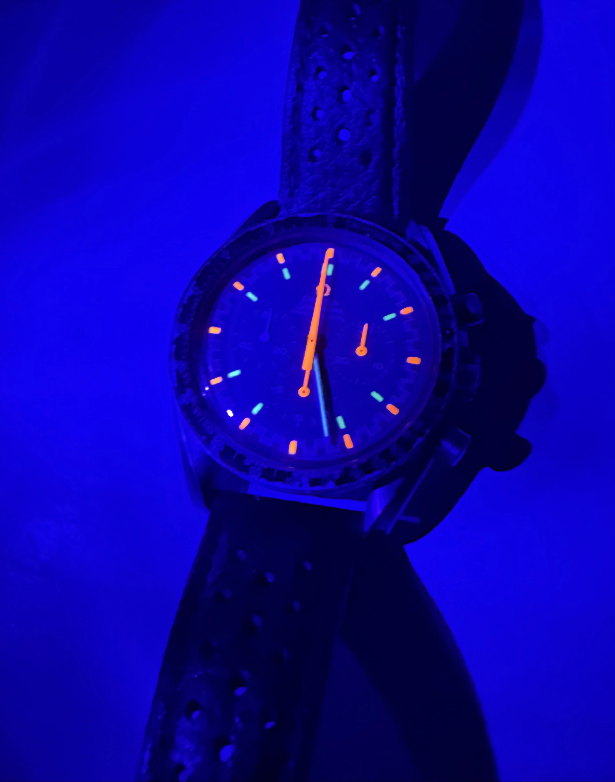

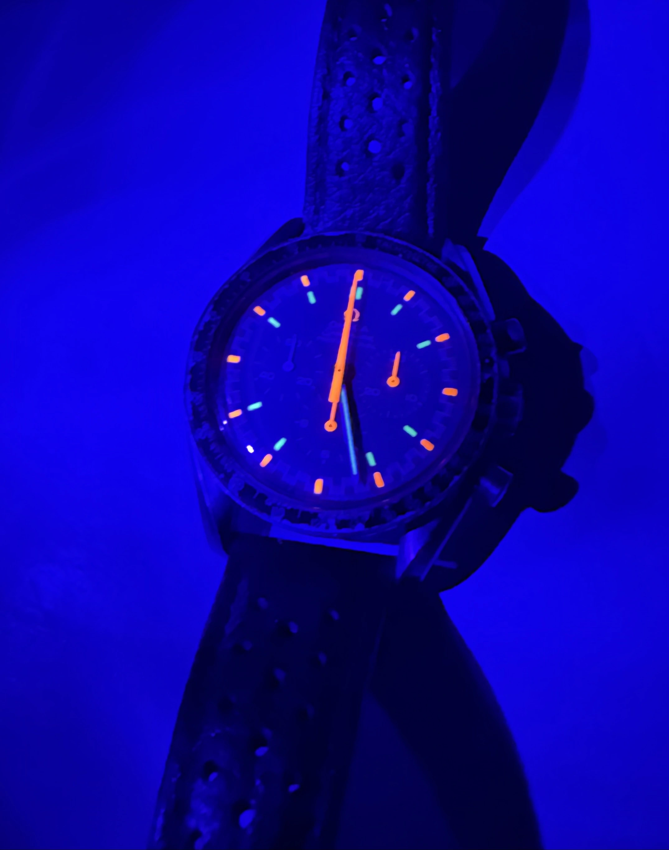

Will add more shots with the spiral winder luminous DON ceramic bezel activated. Can’t wait to see the pairing.
Welcome ! and that is a good result.

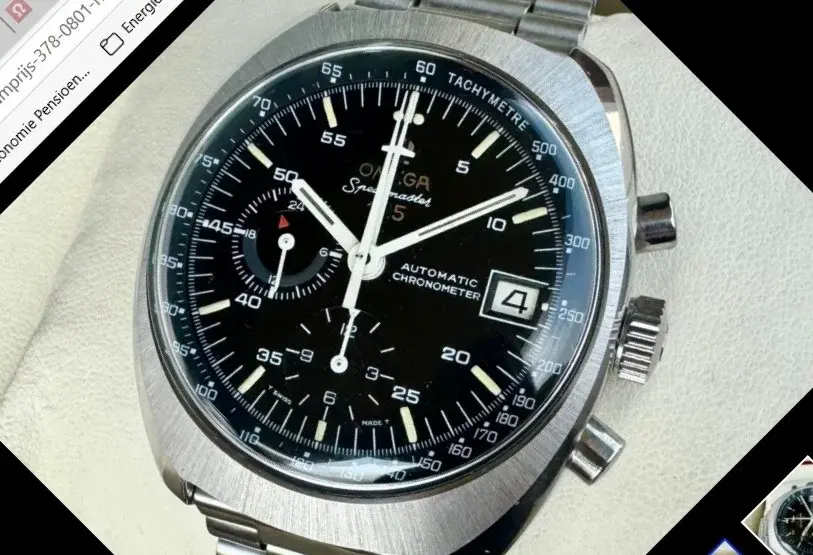

I've had similar ideas on if I could re-case the Omega 1045 (Lemania 5100) movement from a MK4.5 into a standard style speedy case (was thinking 145.022) and this thread makes me excited that it could happen! Any guidance / thoughts on if that build could work, or how I would go about verifying before buying all the donor parts?
2,003
3,901
Wow these builds look amazing!!
I am pretty sure that will not fit, as the 1045 is thicker then a 861 movement, the Omega Caliber 1045 (based on the Lemania 5100) movement itself has a height (thickness) of about 8.2mm, but the overall watch case thickness varies significantly by model, generally ranging from around 15mm to over 15.8mm.
It will fit in a Tissot Navigator case.... or similair Omega case
Darn, thanks for the feedback though!

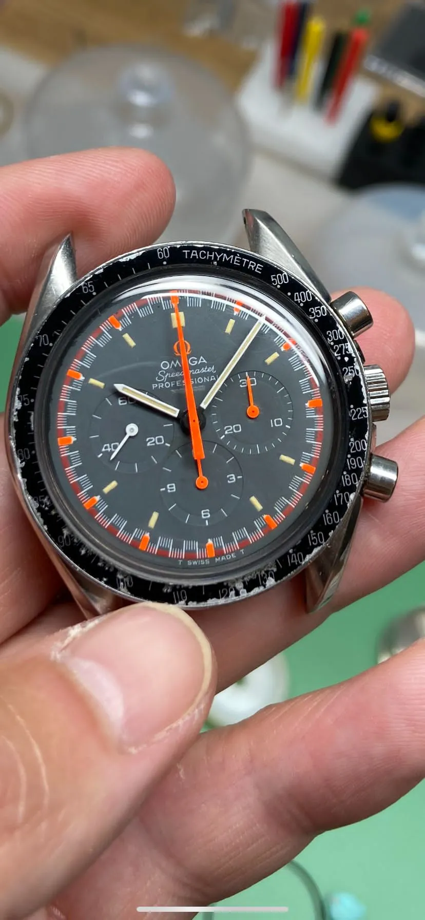

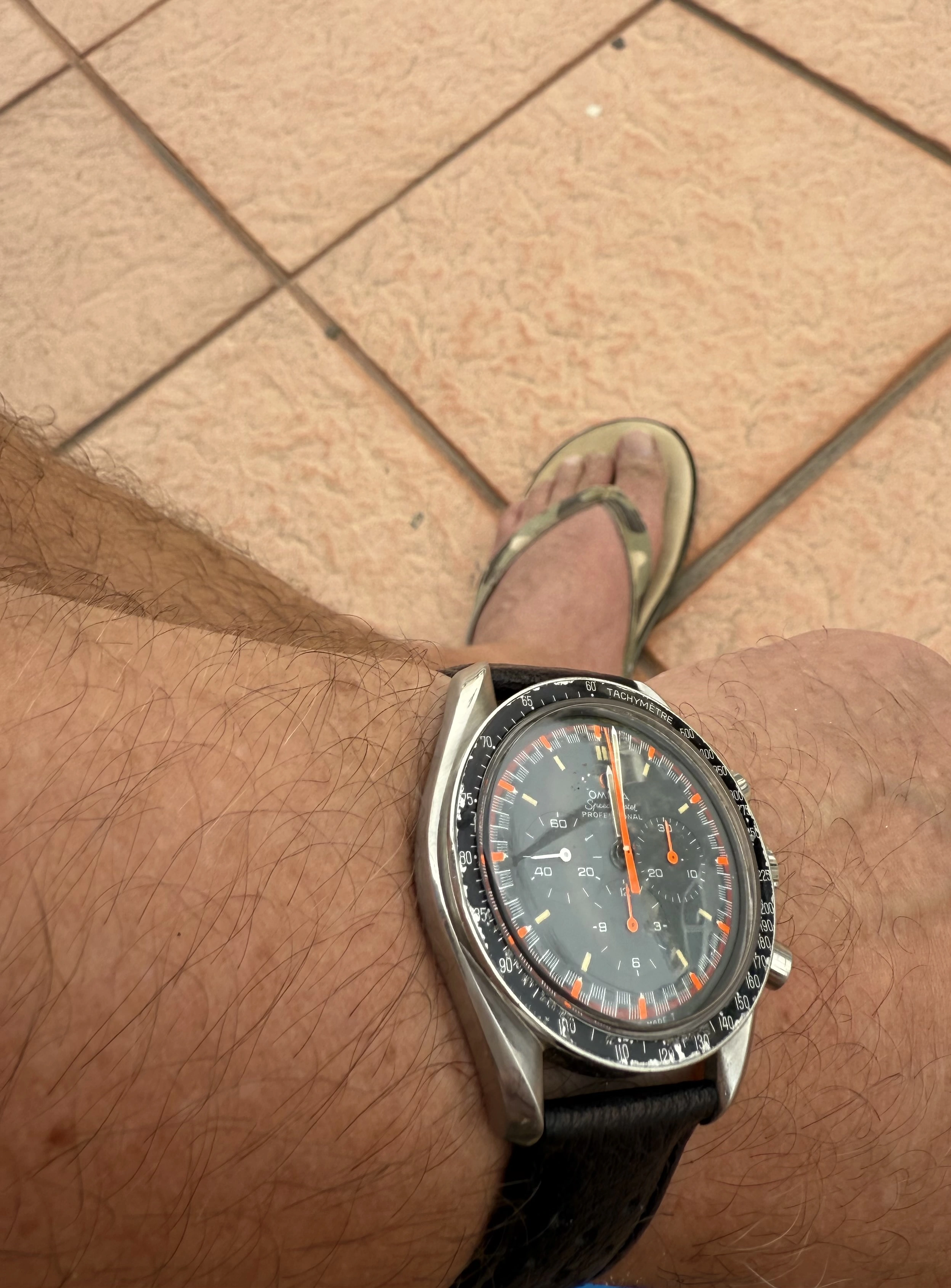

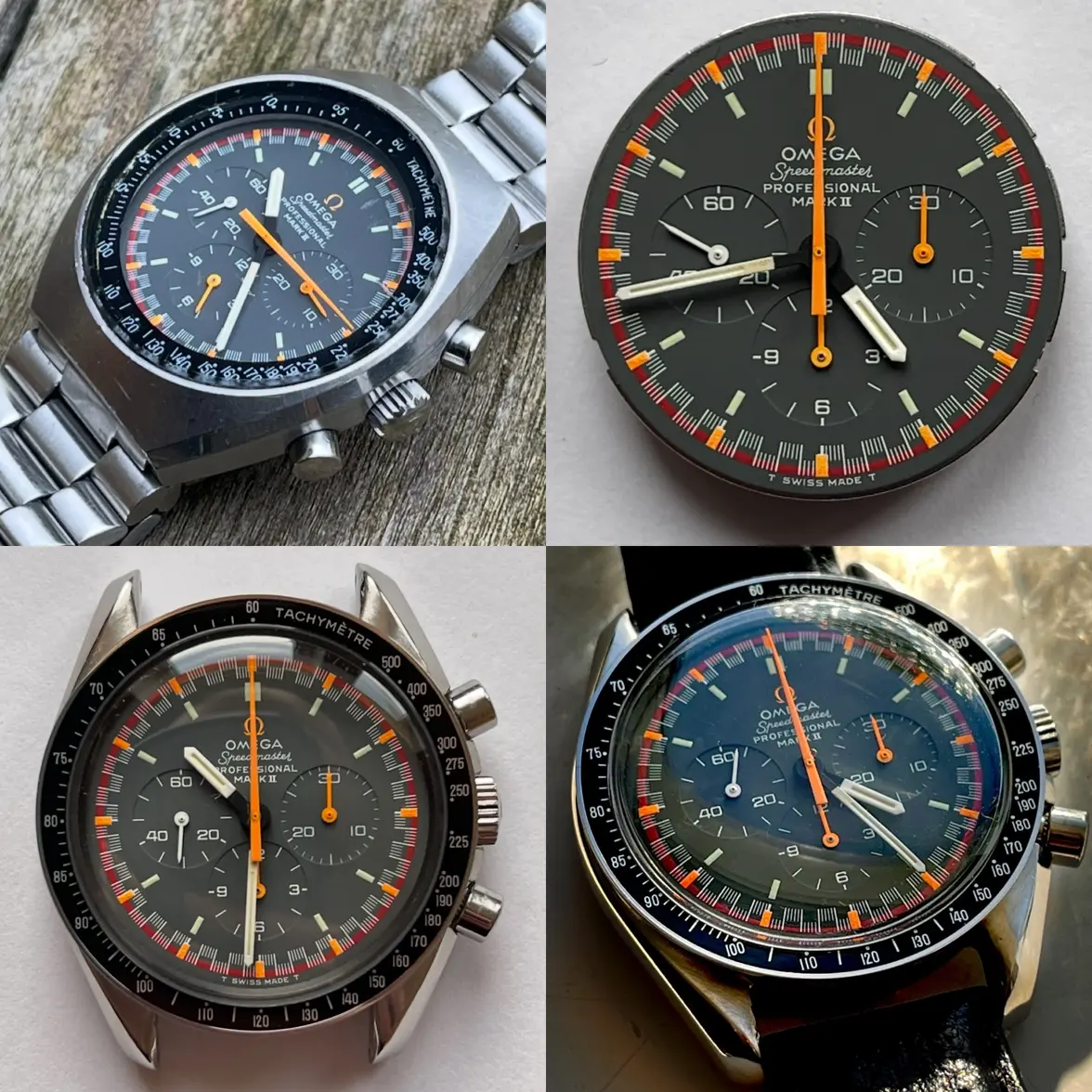

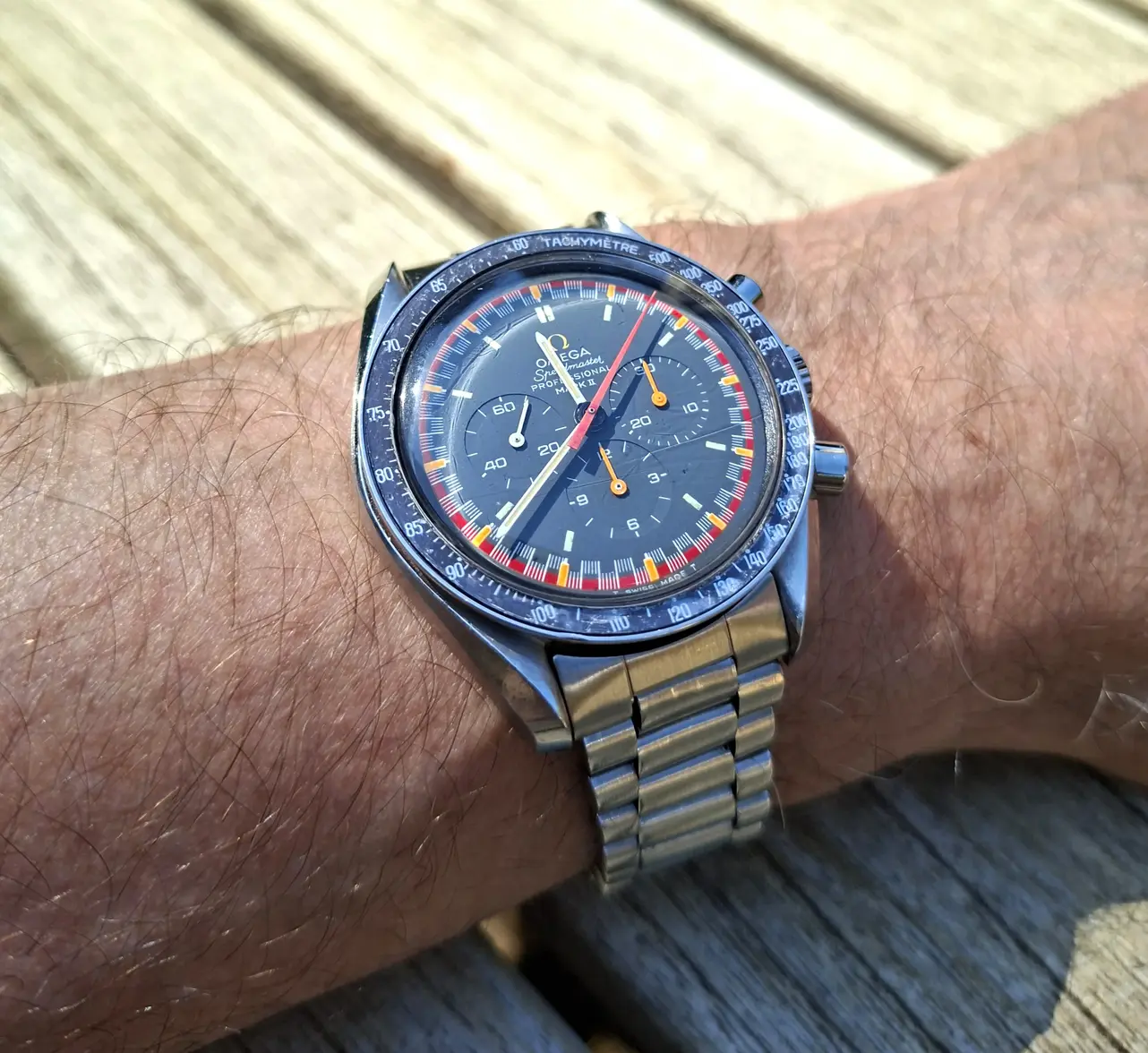

I was finally able to complete the Racing dial project, inspired by @eugeneandresson , with the longer Speedmaster hands and a DON bezel. I knew a liked the look vs the beefier MKII hands but i did not expect it to be this good !
The red of the seconds hand matches the outer ring but i have never seen a discoloration like this, it does not look like an extra layer of paint either, and its not Ultraman size, so who knows ?

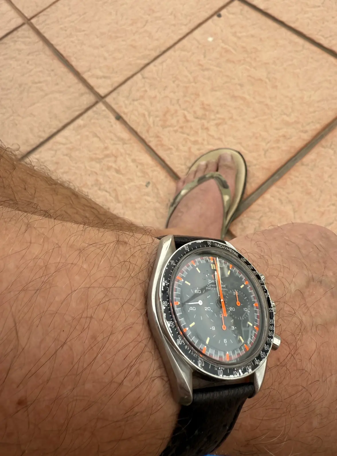

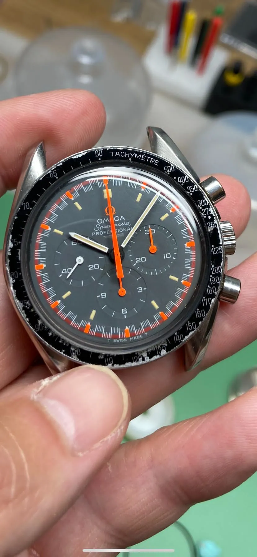

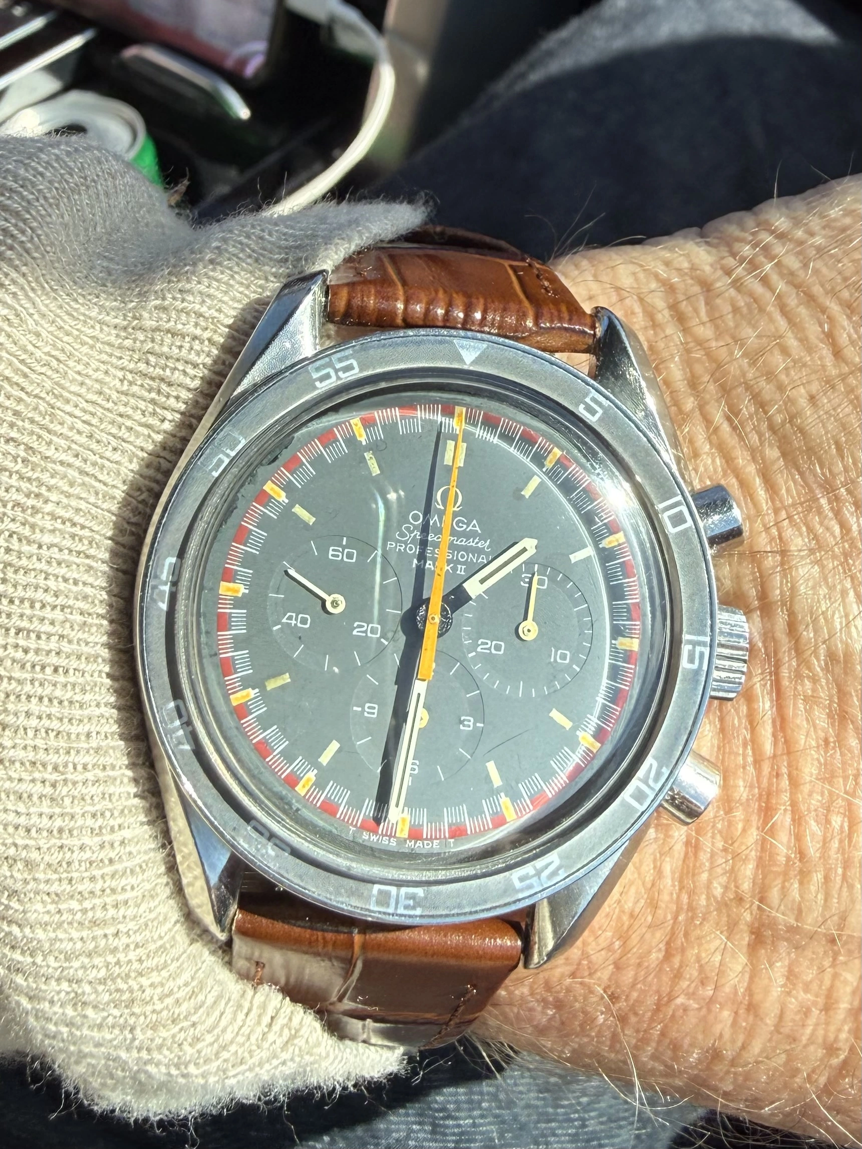

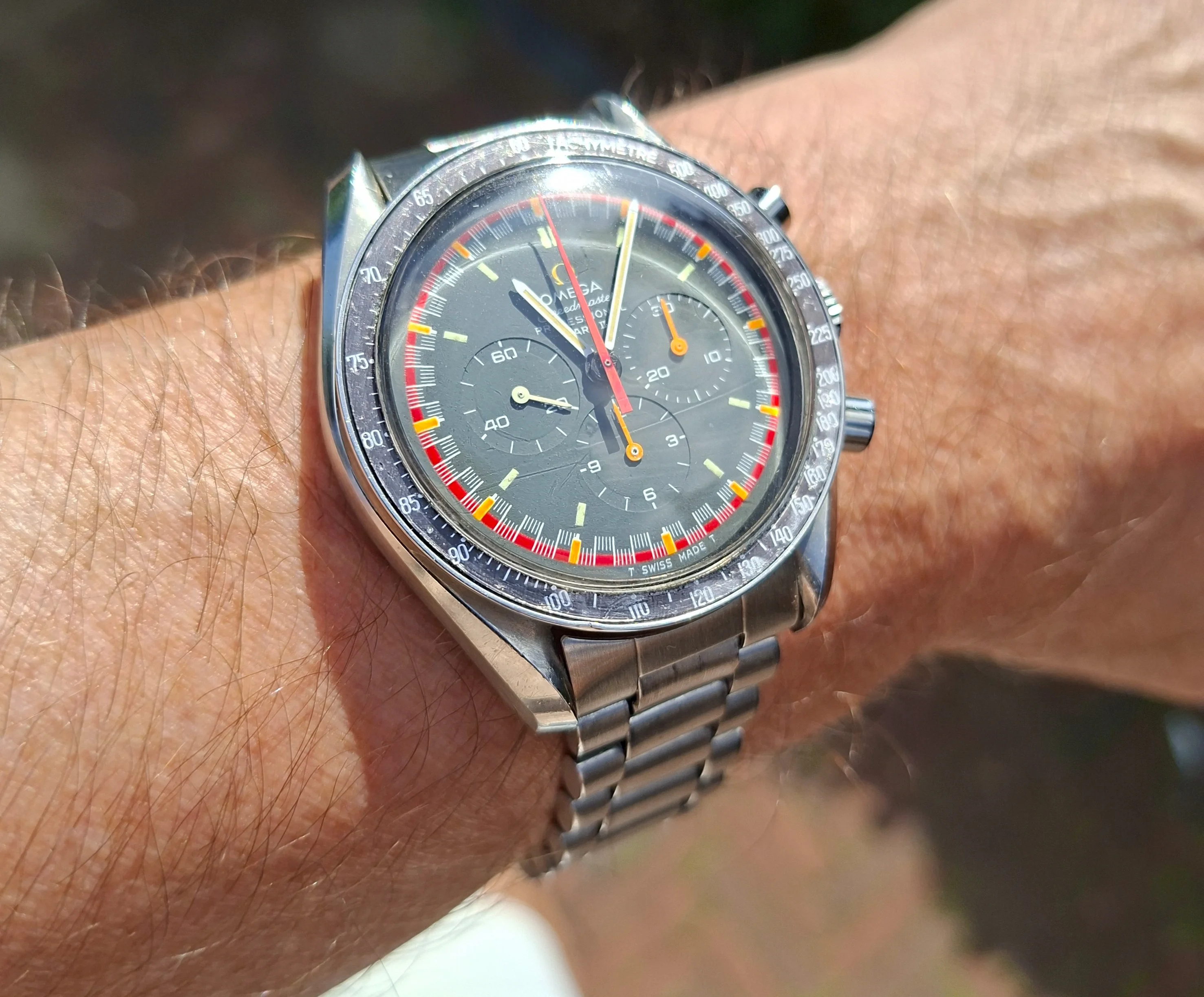

Here is my Mkii Racing, now in 1969 145-022-69ST Mid-Case, with Service Bezel and Service Caseback, wears very nicely with the Omega Black Leather Rally Strap..
2,003
3,901
Here is my Mkii Racing, now in 1969 145022-69ST Case, Service Bezel and Casebook, wears very nicely with the Omega Black Leather rally Strap..
Great colors, congrats ! These are such fun watches .

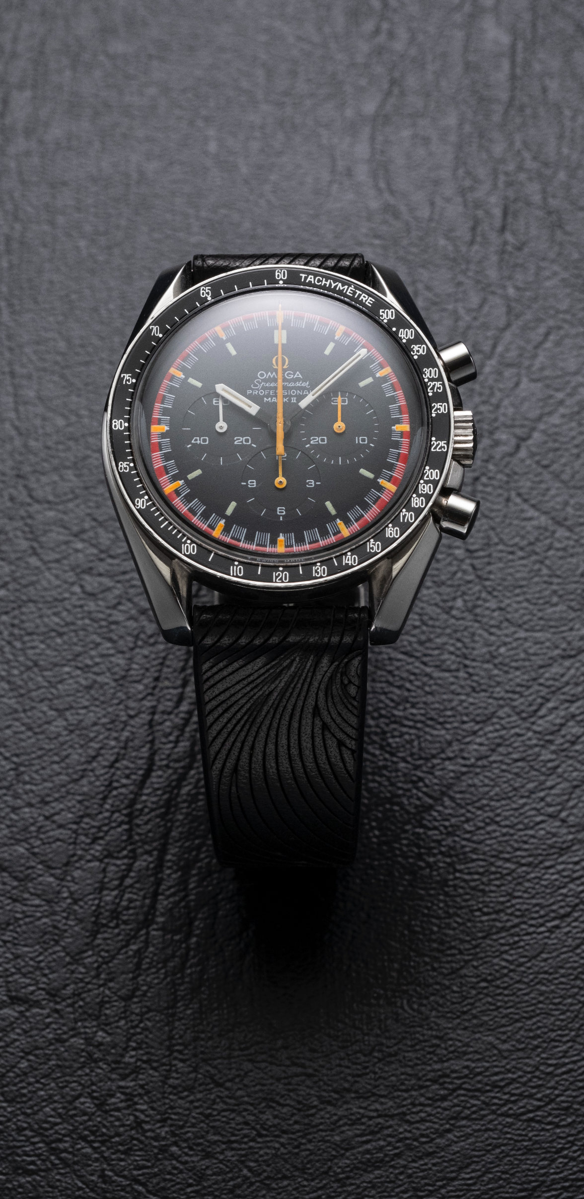

Beautiful watches!
This is my fav strap by Veblenist.
Nice combo and what a great picture!
