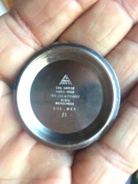

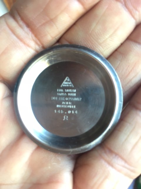

Additional information: the 321 movement serial number is 26.545.xxx
The Mark II casebook is marked:
FAB. SUISSE
DDE BR. + 2750/67
ACIER INOXYDABLE
145.014
Then this Mark II is from 1967?
Thanks
4,106
16,321
That serial is from fall 1968.
You seem not to get it. The movement in your watch does not belong to your watch.
You can try to order an extract from the archives at Omega to confirm what we’re trying to tell you.

Thank you Kov, I've got it already, I was just posting the movement serial because I was asked for, and also asking if the engraving on the caseback means that the watch if from 1967 or it means something different (2750/67) you get it?😀
4,106
16,321
It does mean something different. 😀

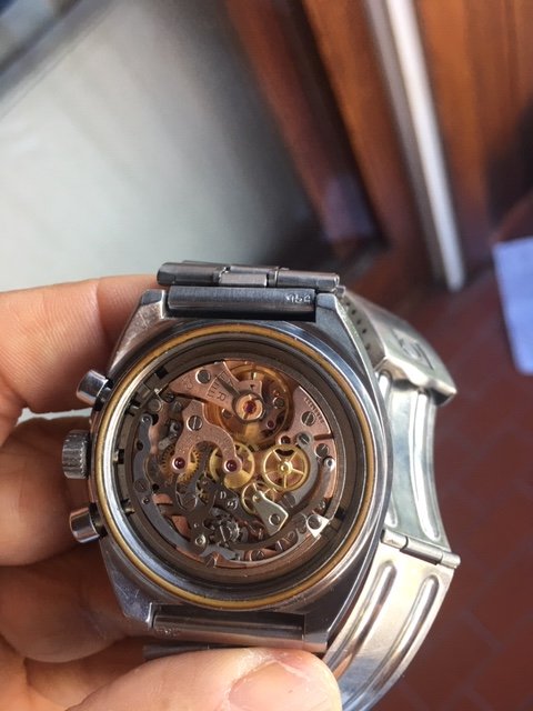

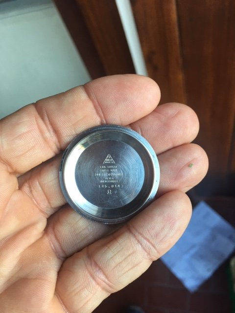

Pictures of the caseback and movement?

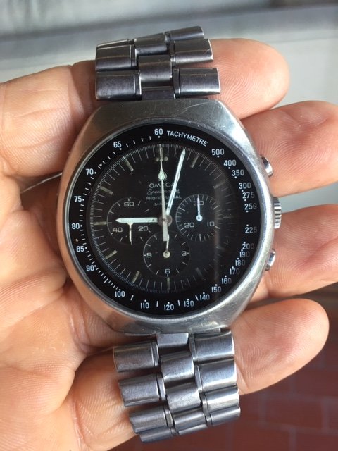

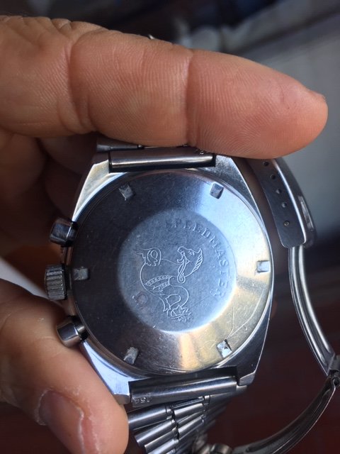

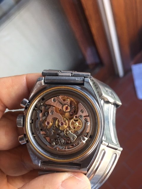

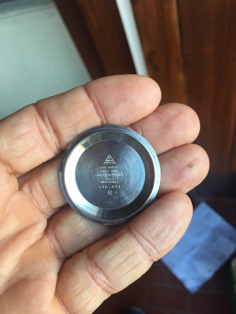

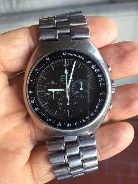

And if I want to get an extract from the archives which information should I provide?. Are there any numbers somewhere on the case I have to look for? Here are some pics, thanks
1,325
1,872
I’m not sure its worth spending any more money on an extract, or tracking down an correct cal 861
My guess is that the watch has suffered severe water damage at some stage ( looking at the dial damage) and so a watchmaker has swapped out a 861 for a 321 he had lying around
just enjoy it
65
8
just enjoy it
Buy the way: how do you realize it had water damage?, just for learning, thank you
18,330
27,698
An extract will most likely be rejected due to mismatch with no refund.
