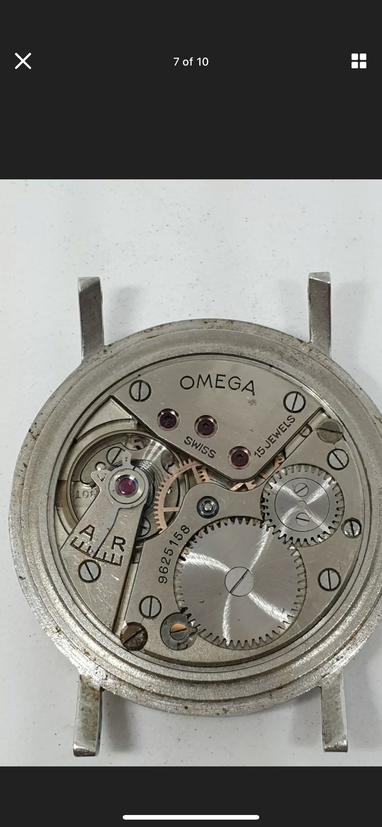

Just a regular 30T2. Here’s a photo from the advert when I bought it. Hairspring is worse than pictured. I guess because I didn’t notice their was a problem as seller told me it has just been serviced..
Anyway hopefully I’ll be able to source the parts to get it up and running again 😀

The watch is running in that photo, and you can’t judge the condition of the balance spring when it it running and the spring is expanding and contracting. If you can post a photo of the spring now that the watch has stopped, we might be able to tell you if it’s repairable.

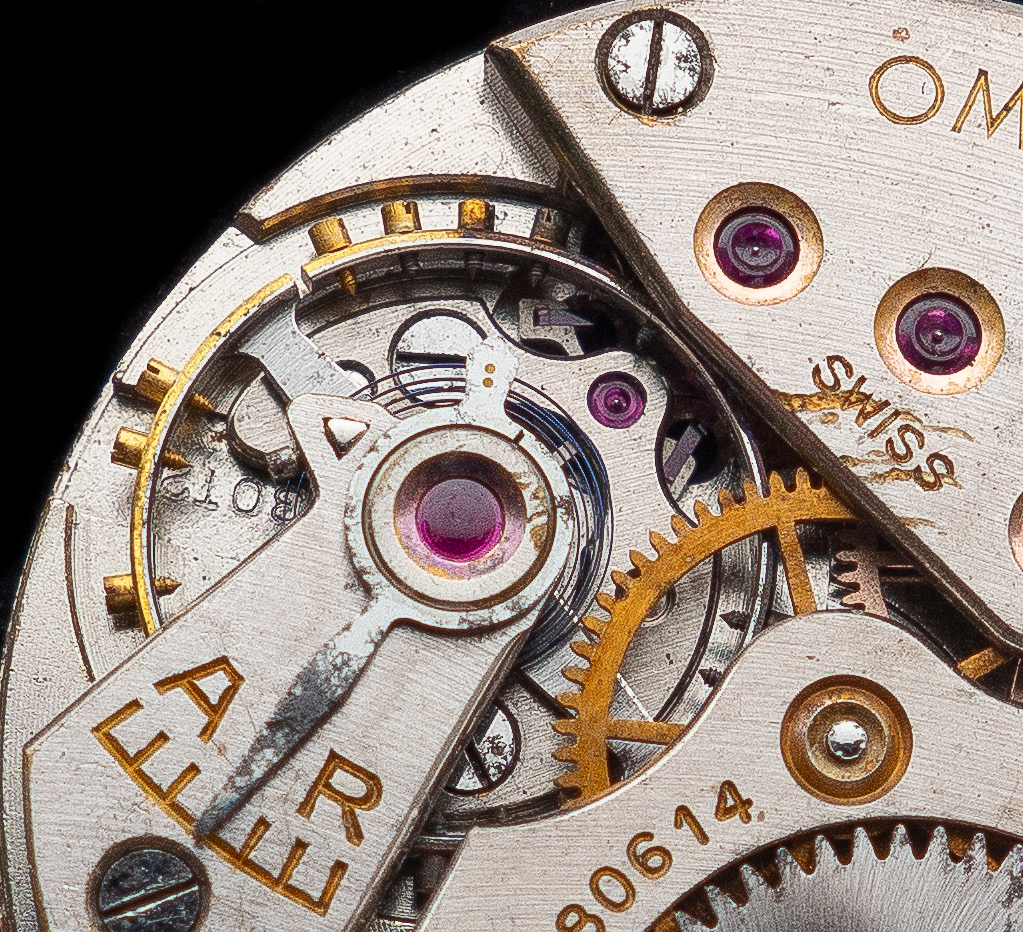

The 30T2 should look like this. The mangle could in fact be the overcoil.
Edit: Like @ChrisN said. The Breguet overcoil...

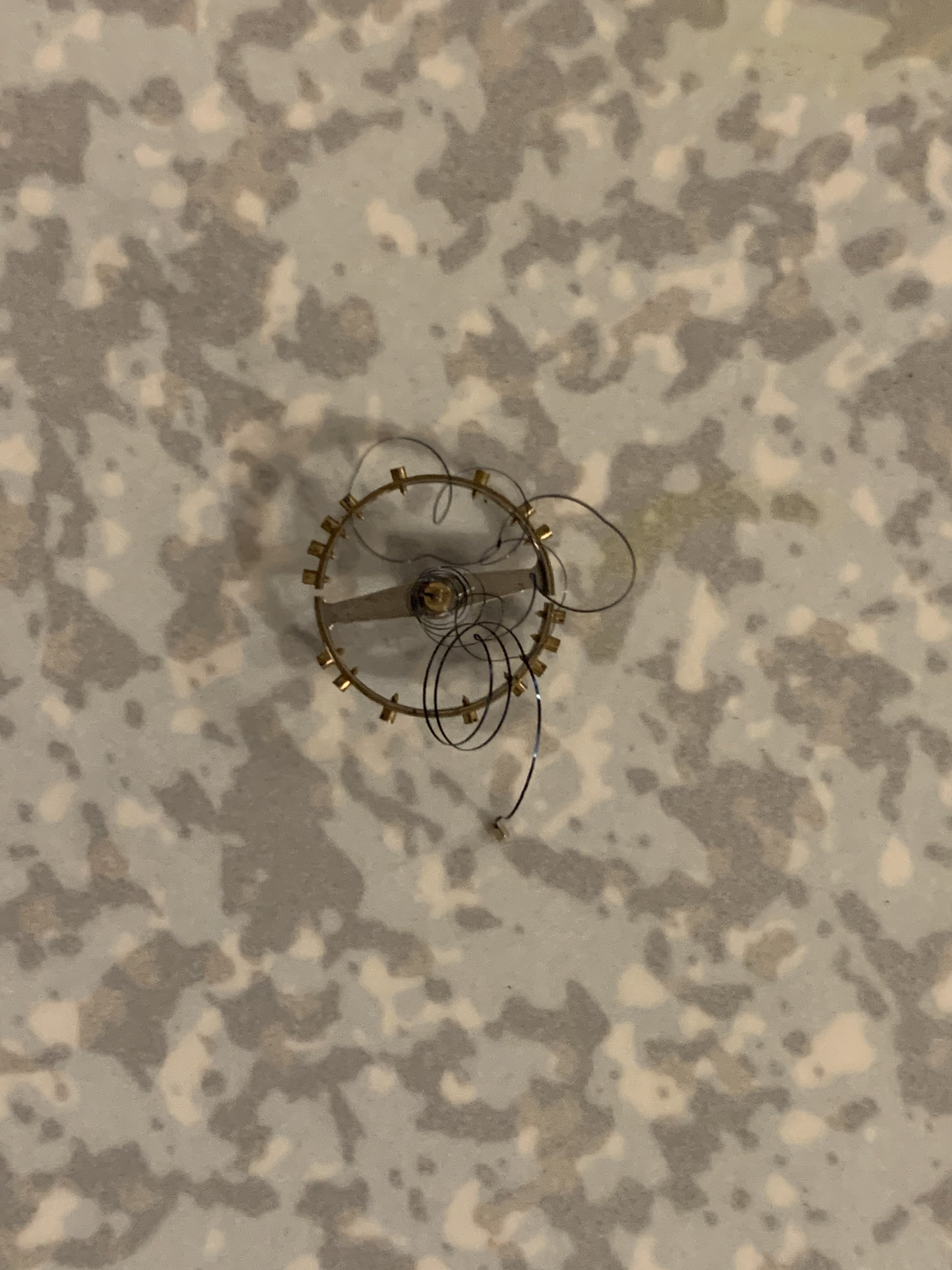

Okay so here it is. It was Twisted somehow Around the balance perhaps it caught one of the holes. I unscrewed it and this is what is left I doubt this can be saved. But I invite your opinions. I will be sending the watch for a service, if you advise that I provide a balance and hairspring within the Package to help speed up its repair I will do. I apologise is this message does not come through correctly I had to dictate it as my phone screen is not working at the moment.

That kind of damage could NOT have happened with the balance wheel in the watch! Unless someone tampered with it. You will need to replace the balance wheel/hairspring totally. Once the watch is made operational, resolve to no longer monkey around with things about which clearly you know little about.
1,453
3,023
As I said I removed it because it was mangled around the balance wheel. I guess it somehow caught between the two slits in the wheel, I have no idea how this happened but this is all I can say. Nobody else had touched the watch, as nobody else has access to it. I did remove it like I said, just to try and release it from where it had caught, which looked to create a kink in it, but I imagine it was long gone before I had even done this, literally none of the spiral was concentric (if that is the correct term, it was all over the place, with 90 degree kinks and worse). I had hoped that there was a small chance once it was released it would spring back to place as it were. But no, this is the result. I didn't do anything to it apart from remove it from the movement and given the condition I was happy to remove it, as I felt it was far too gone anyway so no harm done. Plus I've learnt how these parts interact with other gears etc in the movement so as far as I am concerned it was a useful exercise.
P.S. I appreciate your insight, but I don't find your unnecessary aggressive tone very helpful. Nor do I see why I should have to explain my actions. I've been diplomatic in my responses to you but I don't see why this couldn't have just been a friendly exchange as it has been with the other members who have commented. My question at the end of the day was not how did this happen, but was based around sourcing a new hairspring. I hope a new hairspring and service will prevent this happening again.

When I initially received the watch and wound it, it did not tick. I gave it a gentle shake and it started. As I was told by the seller that it had been serviced I was immediately doubtful by took the benefit of the doubt and presumed it was all okay. I then wore it maybe 3 or 4 times, again each time giving a gentle shake to get it going. This is the only thing I could think that could have caused this to happen. Is this likely? Anyhow I certainly won't be shaking any of these watches again in future if this is indeed the result. Anyway thank you all for your responses, as usual you have all been a great help 😀
Well, the initial issue has likely come from some sort of shock. As much as the spring may have looked a mess when you saw it first, it was likely something that could be fixed pretty easily. Often balance springs will look much worse than they actually are to the untrained eye if they are caught on something.
As it stands now, that one is toast. Lesson learned for next time - don't try to remove or fix this yourself.

That's scrap, sadly.
Why don't you get the watch to your watchmaker of choice and see what they recommend. Not everyone will accept parts from their customers but are usually happy to ask for help if they really can't source something. There are all sorts of places to get obsolete parts and we all have contacts that you won't have. Buying secondhand parts can be a problem as they may be worn or incompatible.
