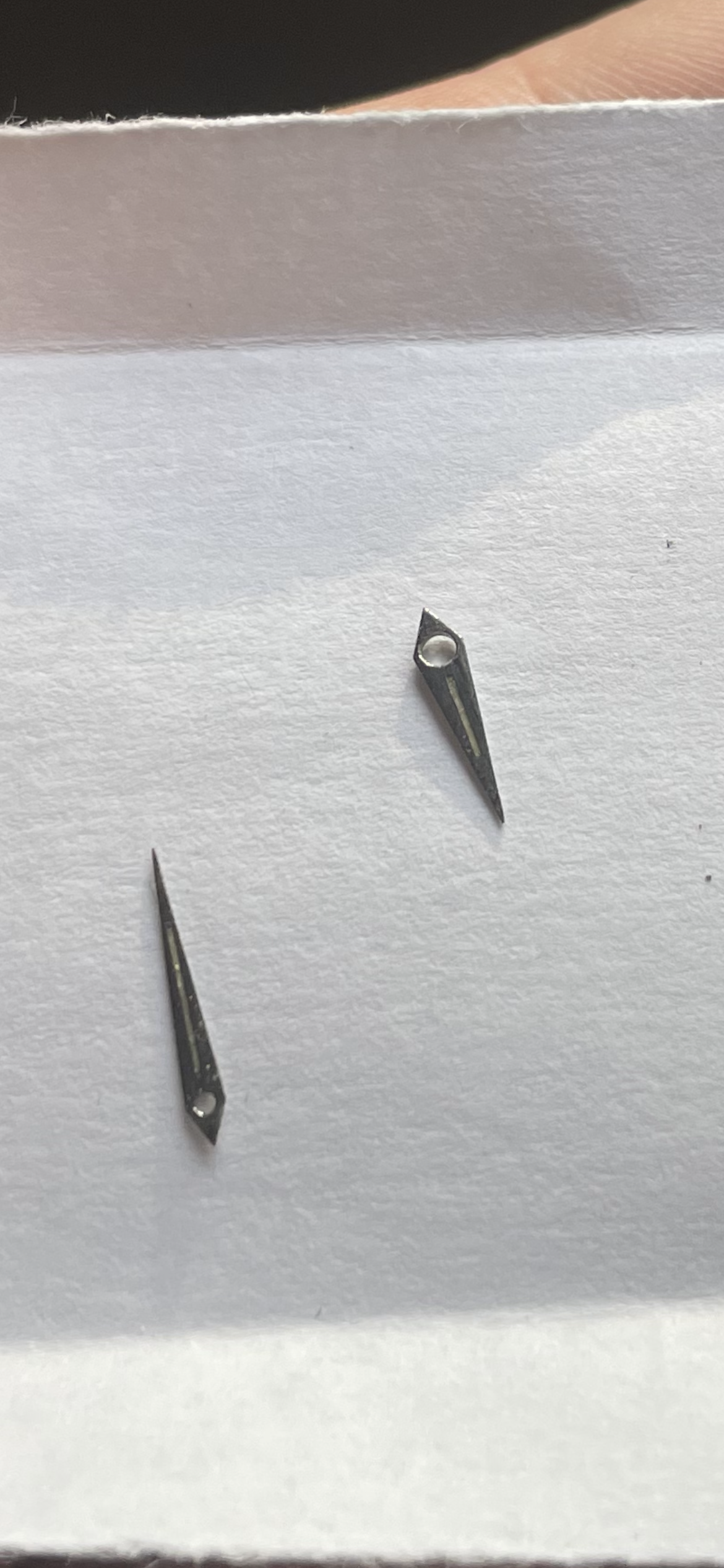

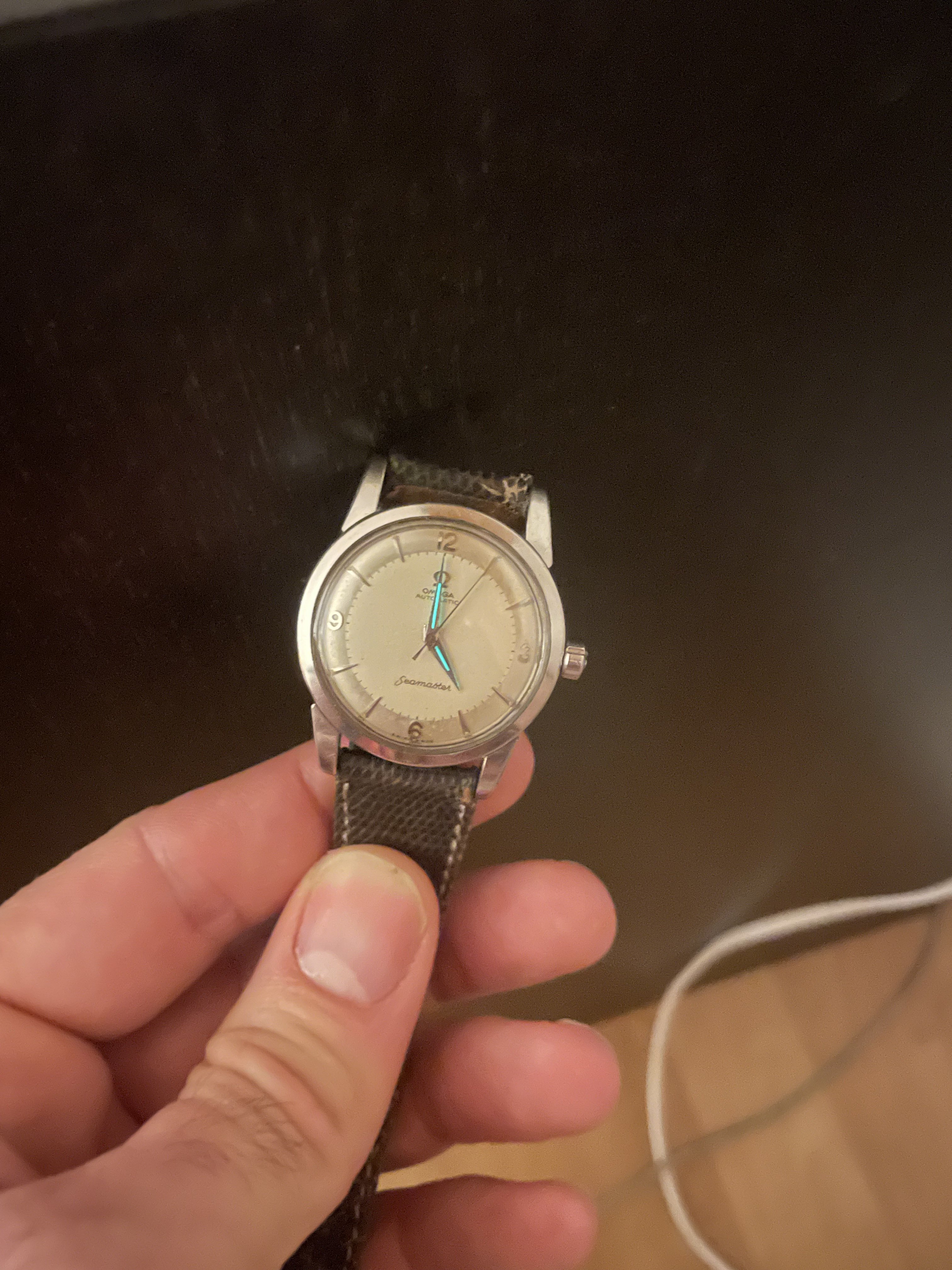

hello,

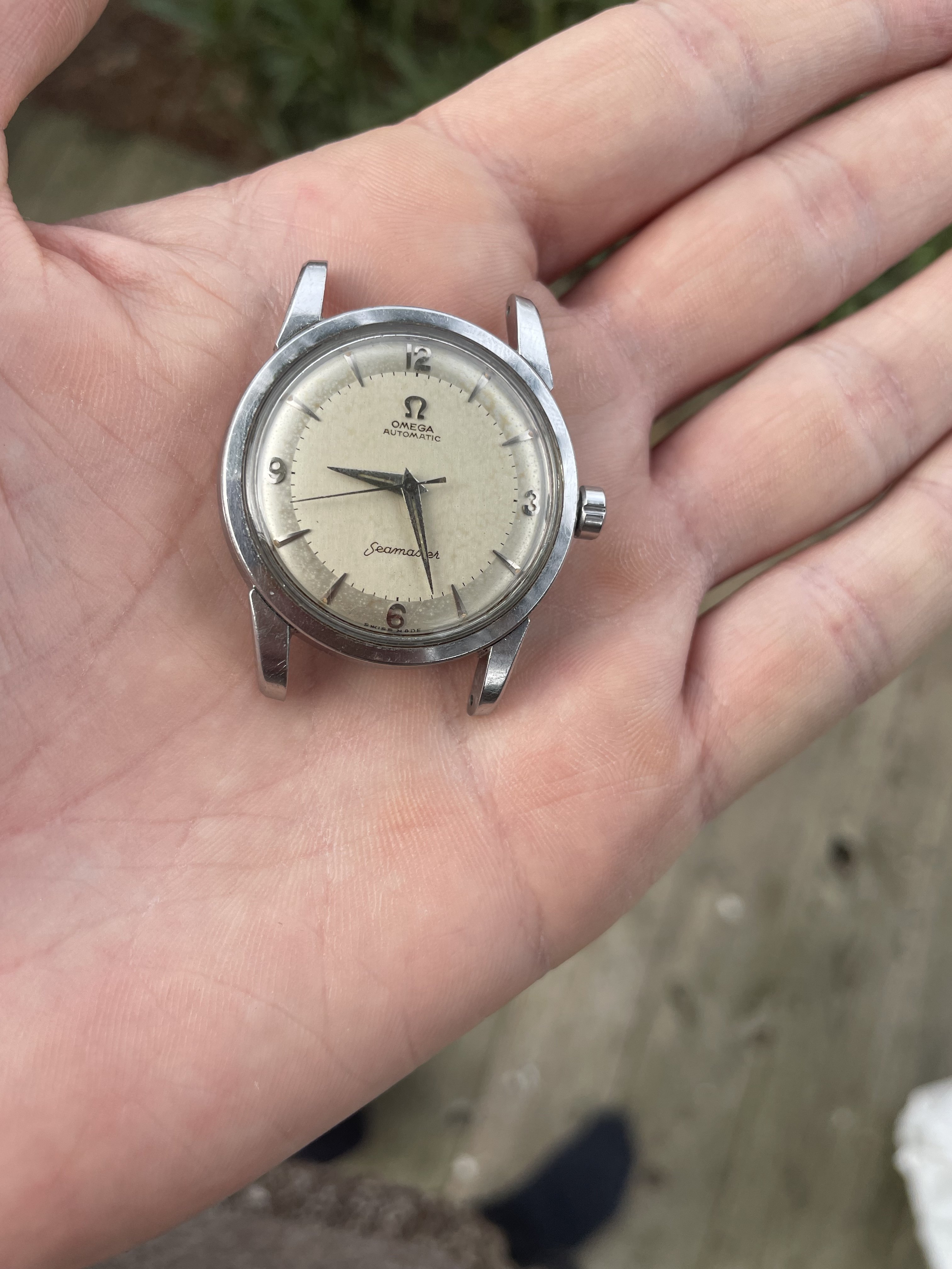

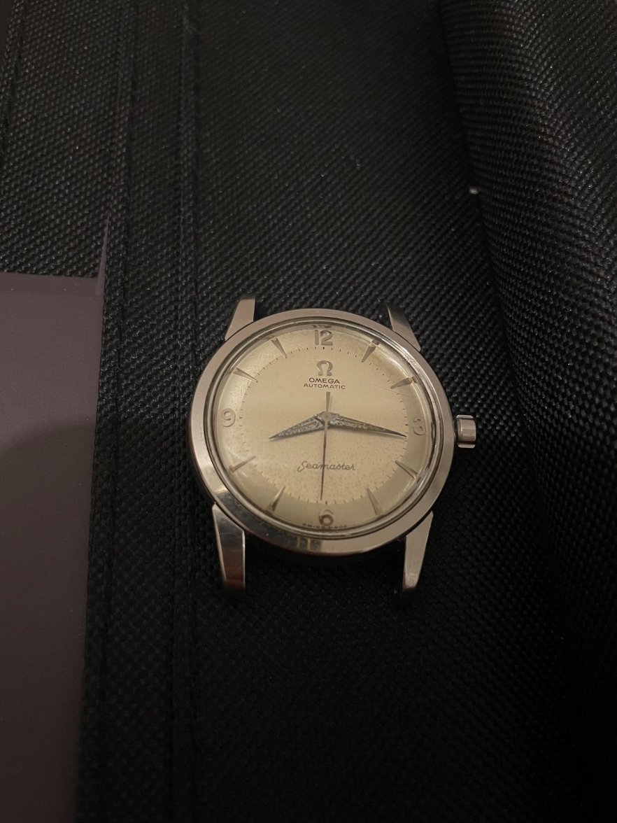

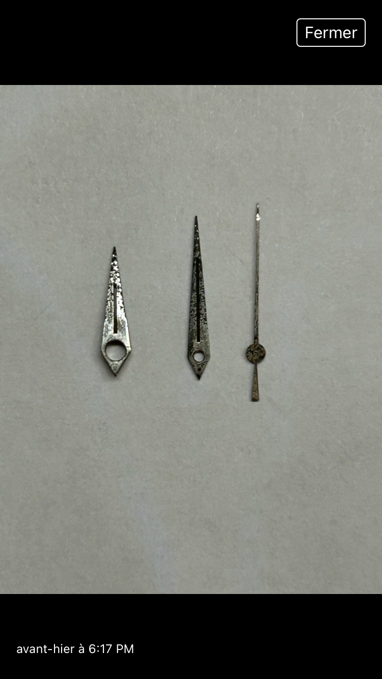

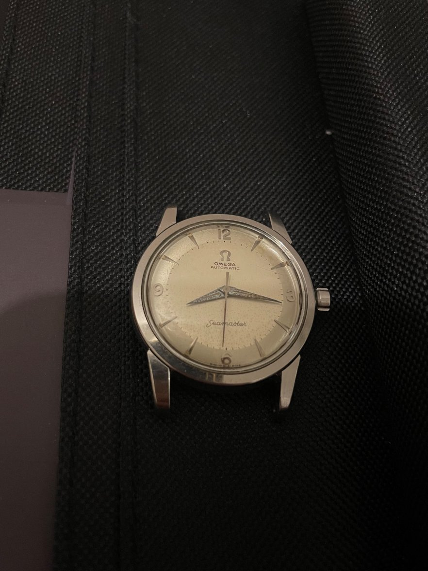

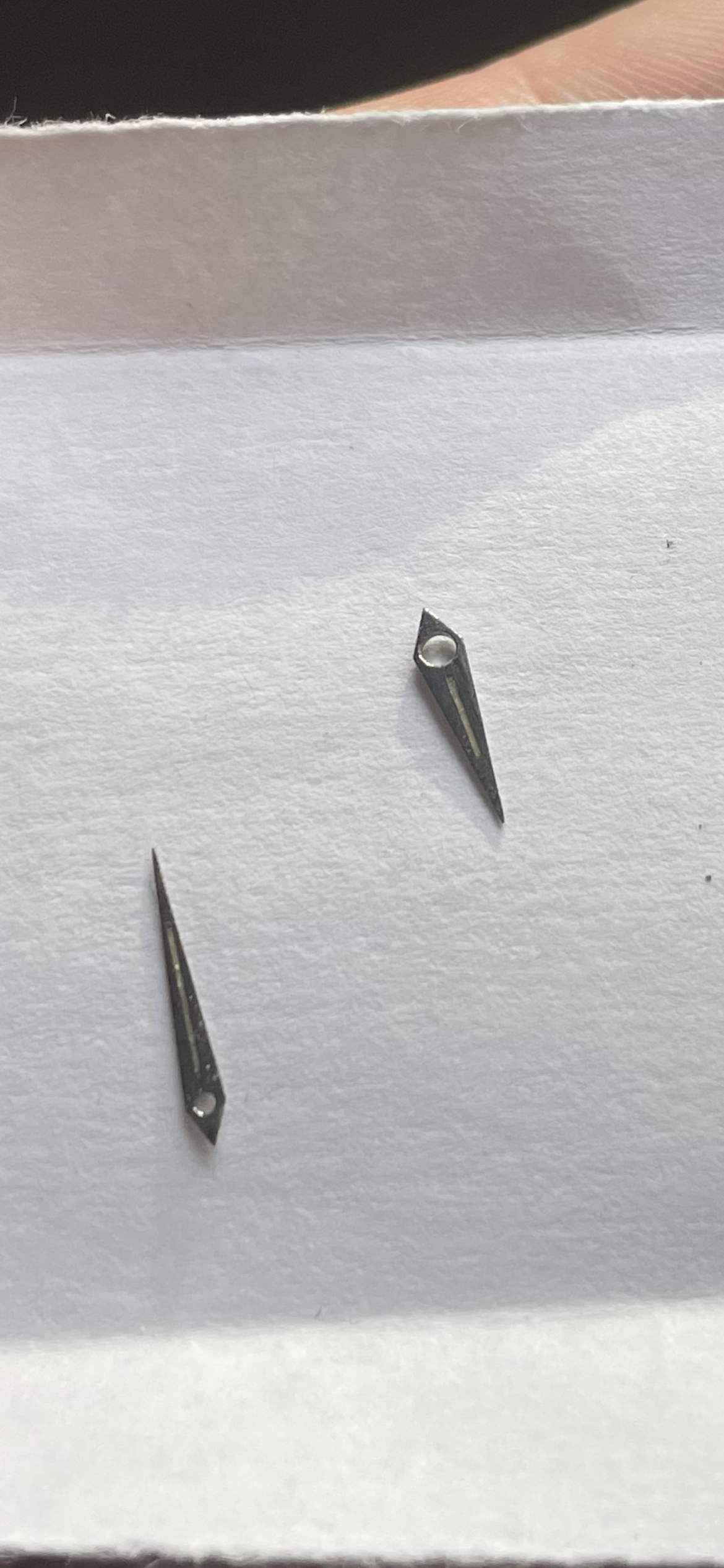

I have sourced some hands in the hope of restoring them and replacing the ones from my Seamaster 2767 that are very pitted.
I essentially got them for free, so I am willing to try few restoration methods on them, including bathing them in acid, polishing, replacing the lume etc. Any recommendations? I have never done that before but I am very aware of the presence of radium on these hands.
Here are the watch and the replacement hands.
2,680
3,158
I used ammonia on old hands and the results were incredible, correct me if I'm wrong but maybe these aren't coated?
Use ammonia on anything modern and it strips of coating super fast
Seconds hand I guess be more careful than the hours/minutes, that one looks coated

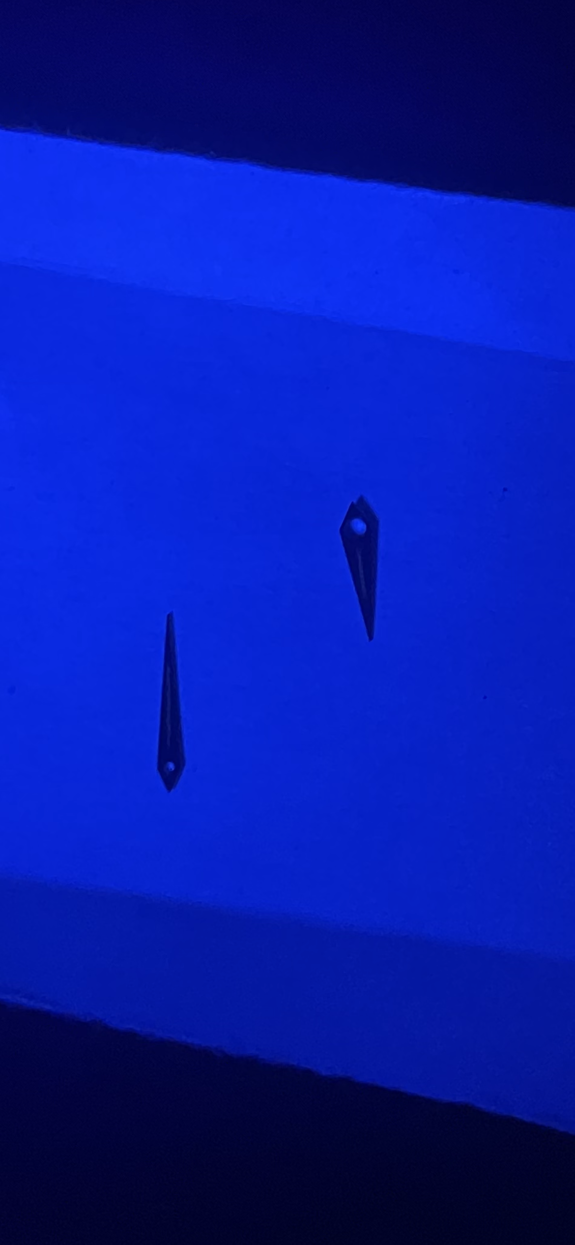

I'm not an expert, but a tip I found helpful is to scrape off the radium while the hands are submerged inside a small jar of alcohol. It does a great job of controlling the dust. You also want to be careful with radium dust that may be stuck inside the dial. A UV flashlight should help you spot those.
It could be the photos you posted, but the replacement hands you are showing above don't look luminous to me.
I recently had a set of hands in similar condition to yours. The company I sent them in for re-plating told me that the seconds hand was made out of steel, so it could not be re-plated. The hour and minute hands look better after the process, but the pitting is still visible.

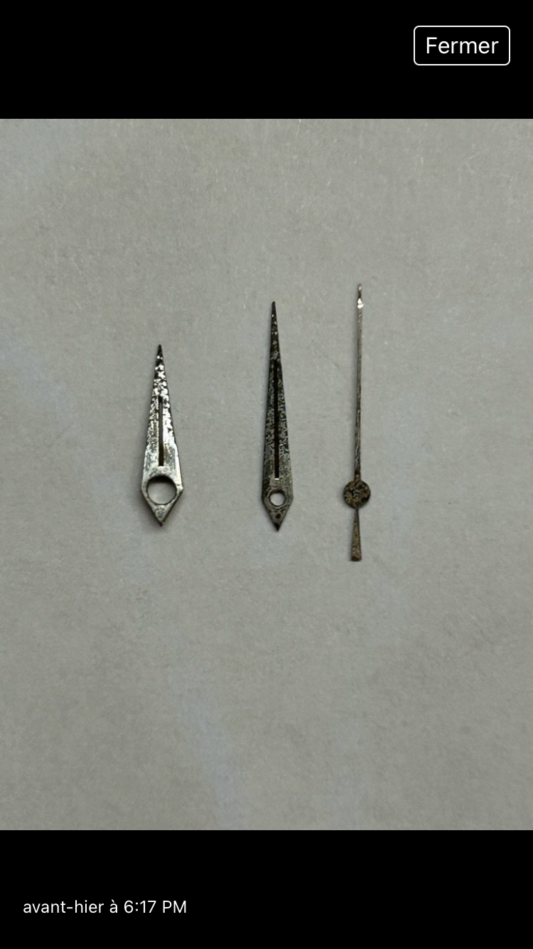

My refinished told me if the hands are too pitted. They’re not suitable for restoration. Also they’re brass plated, so any sanding will remove the plating.
he restored hands for me in fair condition. Replated and relumed

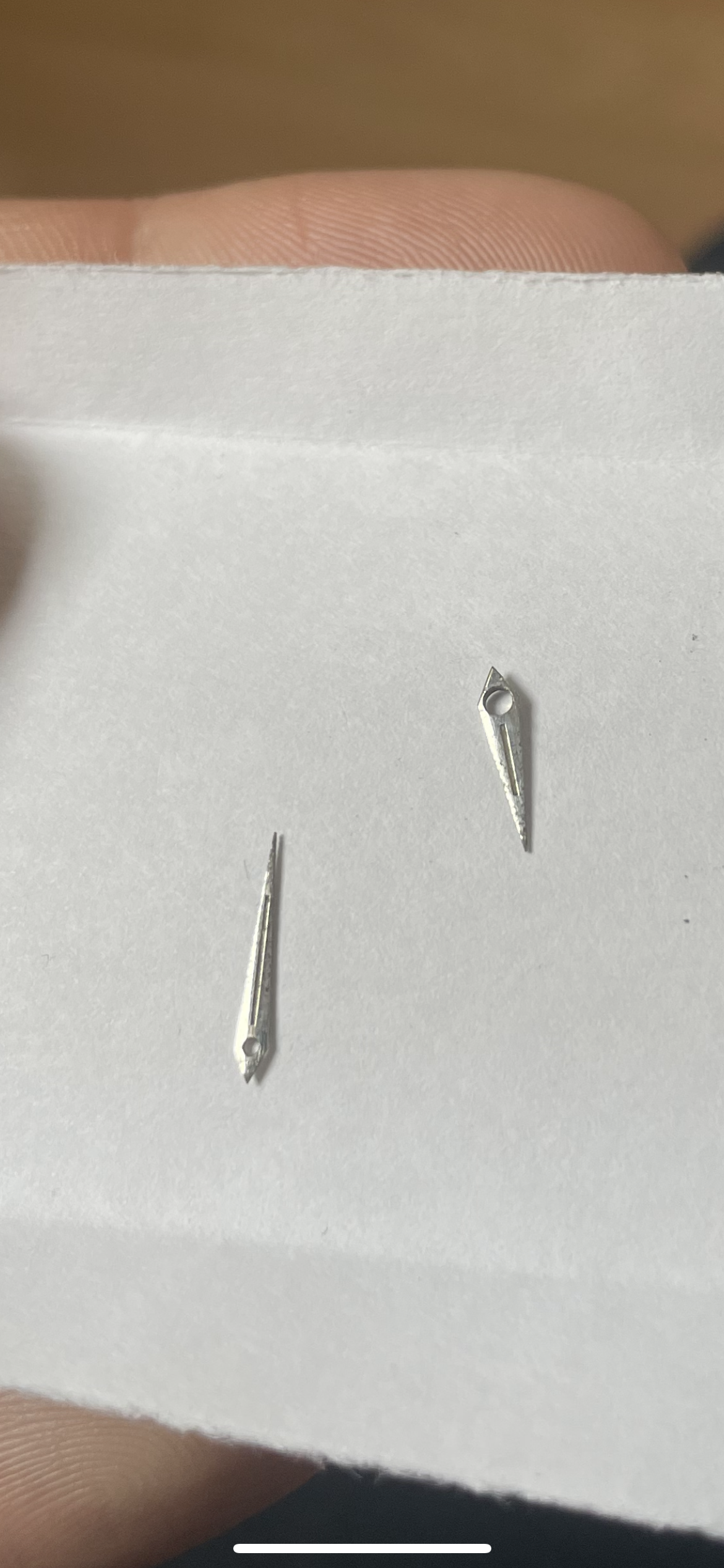

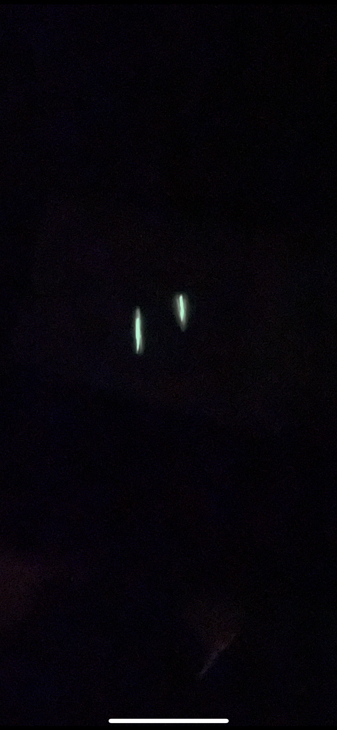

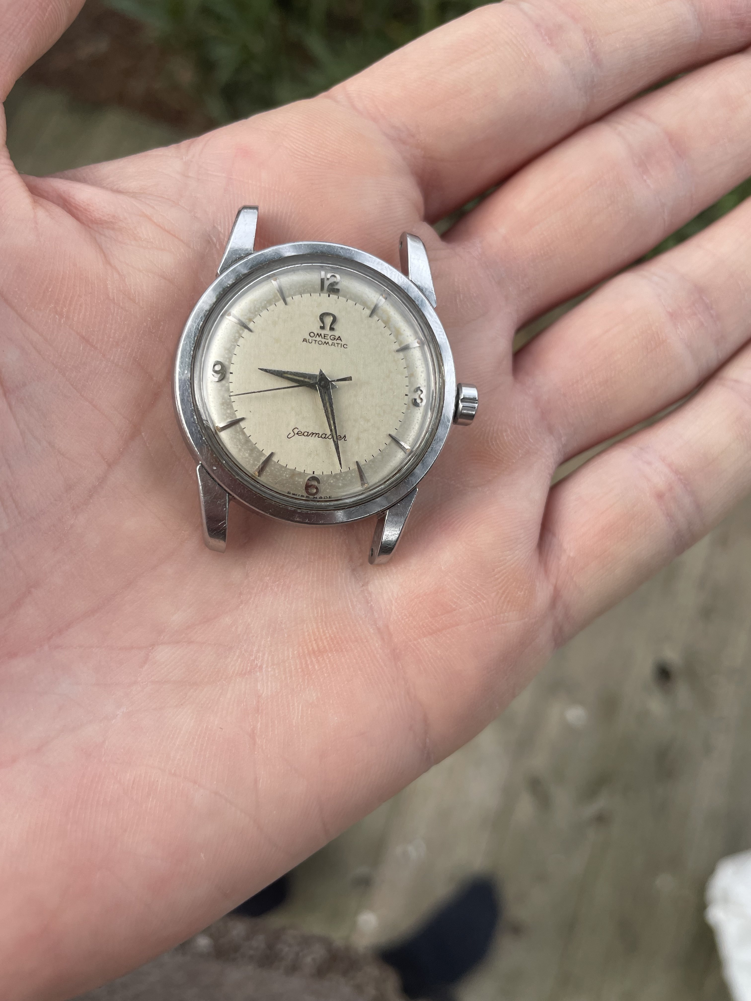

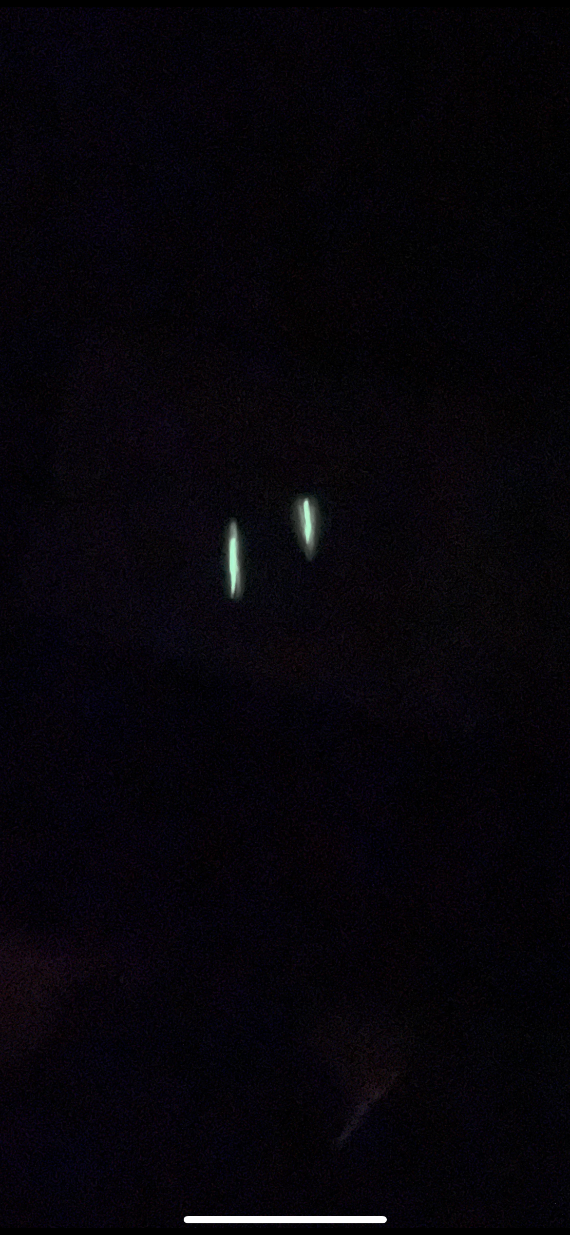

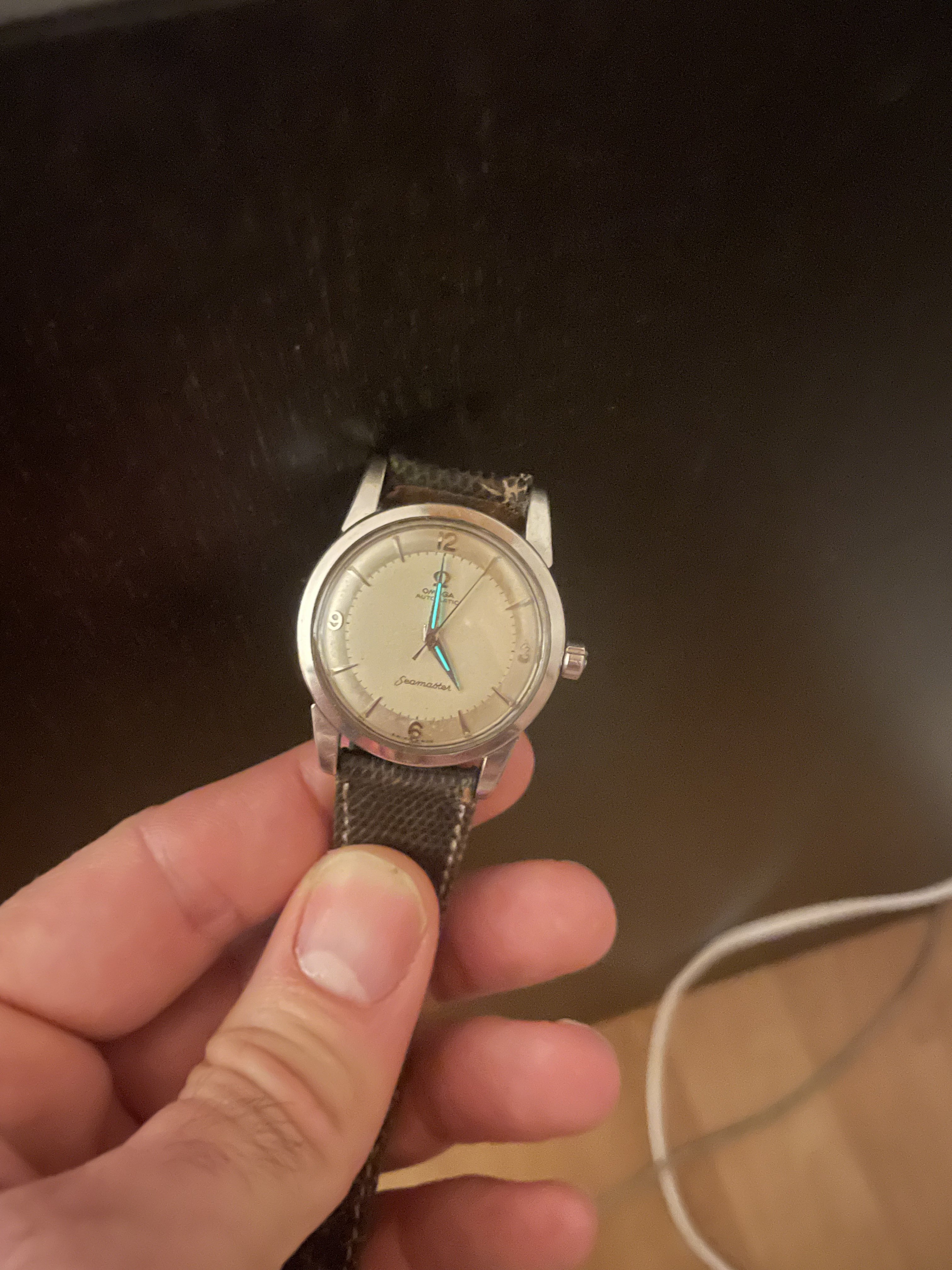

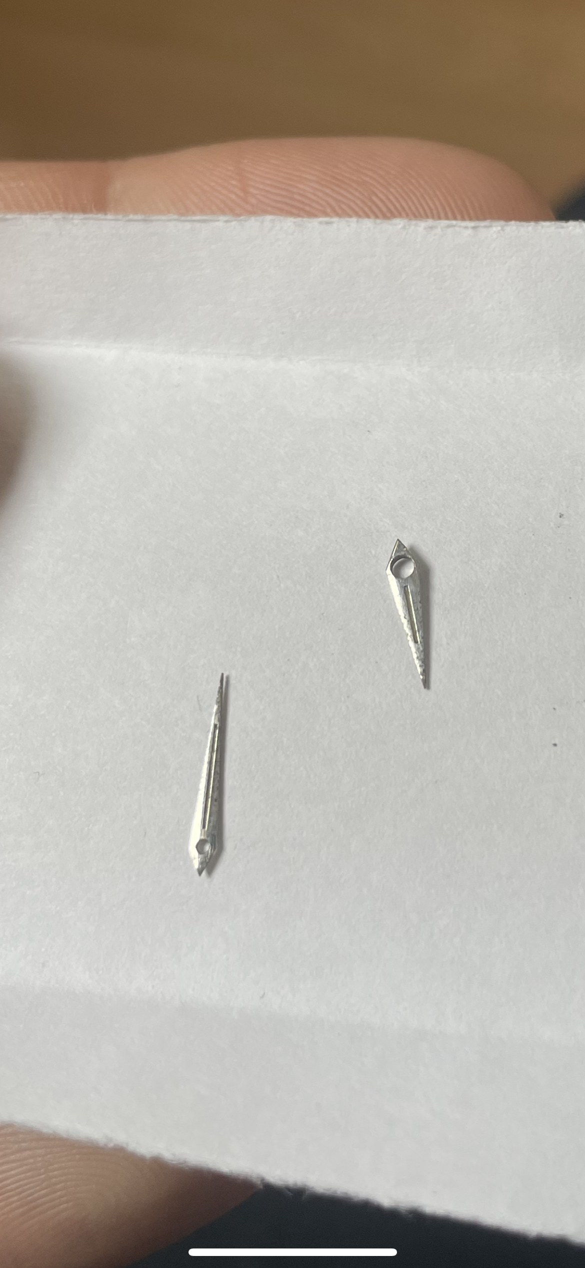

Hello,
Here is an update. They don’t look brand new for sure, but I am kind of happy with the result. I have mixed some coffee to the lume so that it looks old and not too white.
4,856
12,282
It is quite the improvement. The hands have cleaned up nicely, but still have a bit of patina to match the rest of the watch. An ideal outcome IMHO. The watch looks really nice!
406
2,107
A very authentic look. Absolutely well done, congrats!

I mixed some coffee directly into the mix. Should I now paint over the hands with a brush and coffee?
2,680
3,158
I actually did that once and got very good results with it, it provided better shading than just a premix - but ymmv
Mainly the initial issue is the end result always being so much more lighter than the mix
