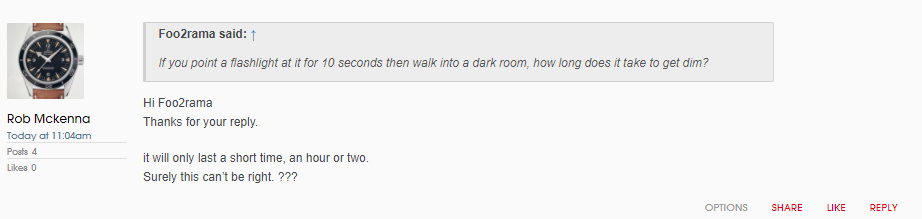

Hi Guys/Gals
I recently bought my first Omega,which is a Seamaster 300 Co-Axial.
Which i love,but i dont think the Lume is working properly,as it only lasts a short time.
I assumed that once activated,it would self charge ?????????.
But that doesn’t seem to be the case.
I have done the usual ultra violet without great results.
any help or advice would be greatly appreciated.
thanks in advance.
Rob
