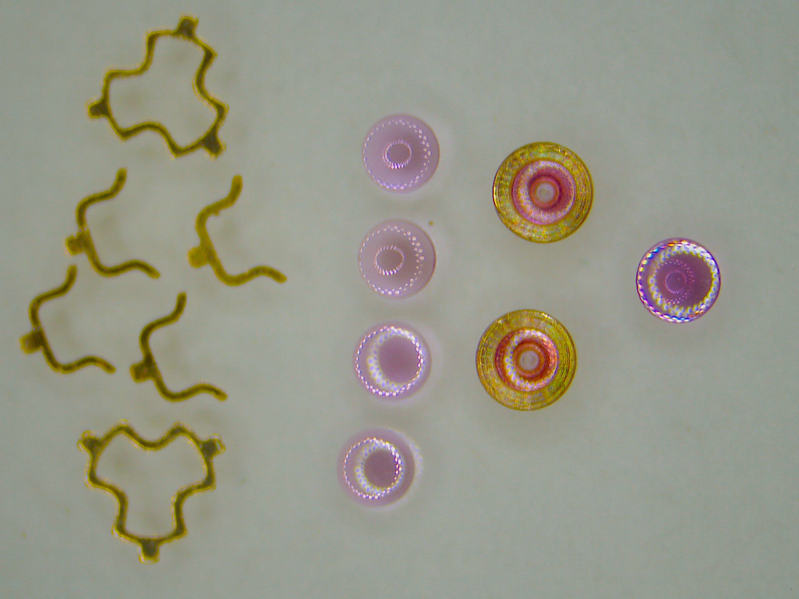

Just fished a movement out of the cleaning machine.
Got all of the large parts out of the Elma baskets and into the parts tray.
Opened the little basket that held the pallet and two Diashock settings, two Diafix jewels and two Diashock springs.
Getting the jewels out of the basket and into the tray was a delicate task, just enough gentle pressure on the tweezers to hold the jewel and not ping it into space. That all went well, just the shock spring to get.
Saw one on the side of the basket so picked it up and dropped it into the tray.
Went back for the other one. Nowhere to be seen!
Basket under the microscope and a thorough check of the basket and lid reveled nothing.
Spent ten minutes trying to find it in the other baskets but nothing.
Damn, I'll have to raid my spares.

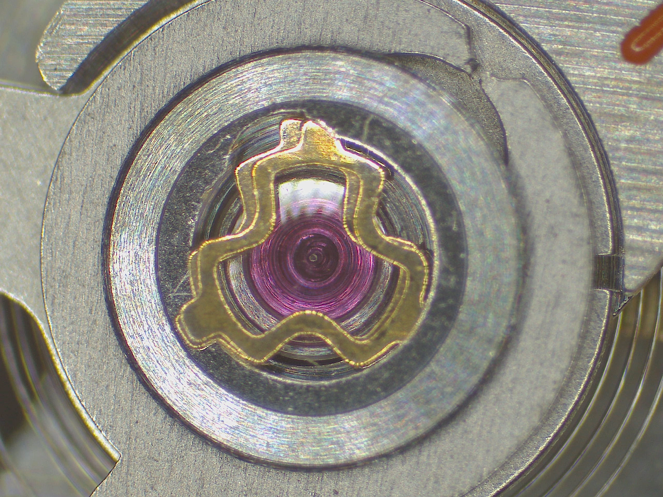

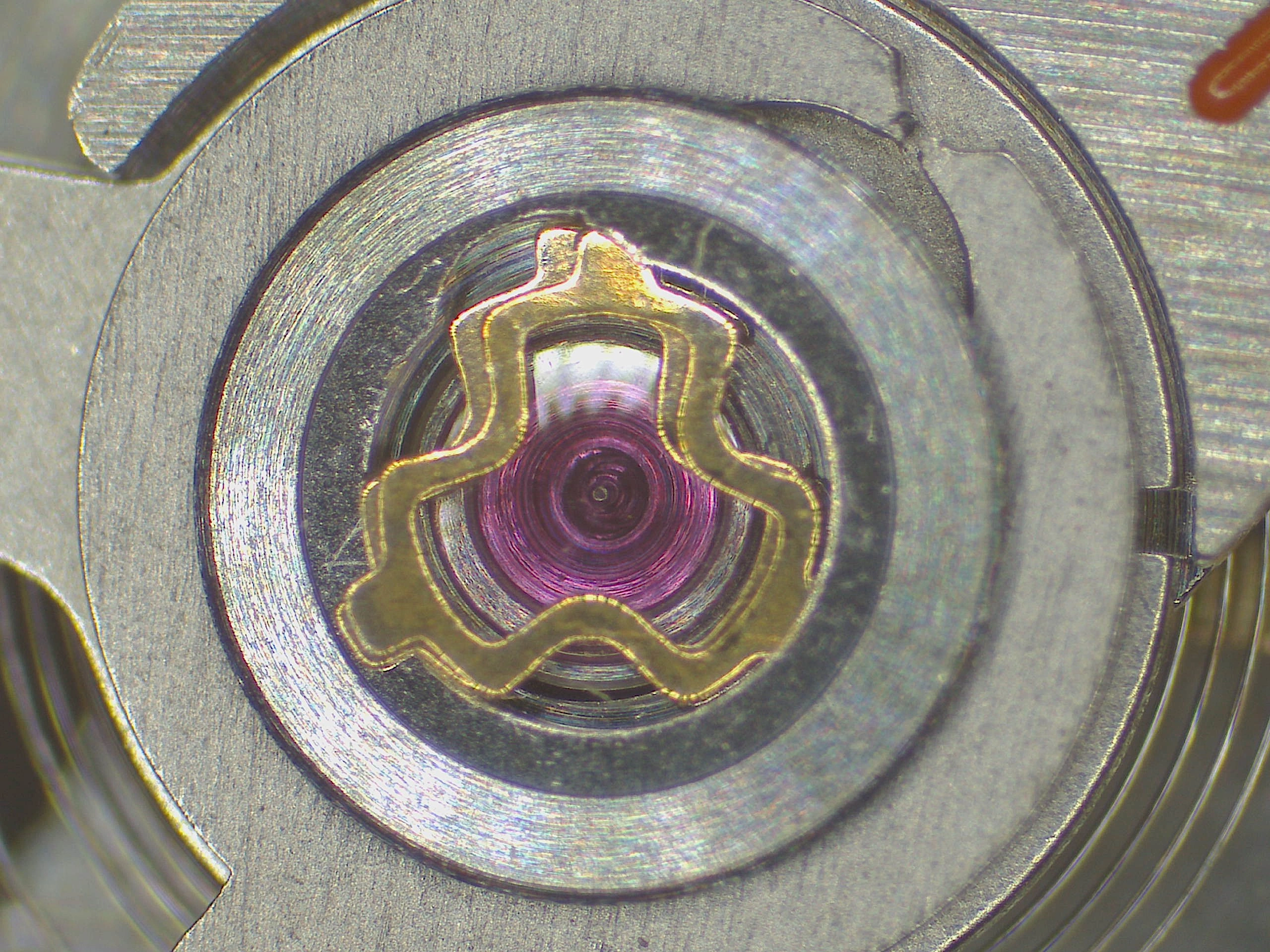

Anyway, as I had the plate and balance all ready, I oiled the cap jewels and assembled the settings and into the balance cock with the first one.
Picked up the lonely shock spring with tweezers and gently placed it on the jewel setting and then put the movement under the microscope to install the spring.
Manouvered the spring into position and put one of the tabs under the lip of the chaton and went to press and turn the next tab.
WTH! A second spring suddenly appears beneathe the top one!
Grrrrrrrrr!
Even with all of the handling from the cleaning basket to the movement, the two stayed together, perfectly aligned with not a suggestion of a double up.
So, happy that I found the missing spring and now have to use more mini baskets as @Archer has suggested.
One for settings and one shock spring.
One for cap jewels and another shock spring.
One for small Diafix cap jewels that try to stick to larger cap jewels.
Anyway, enough rambling, time for a pic.

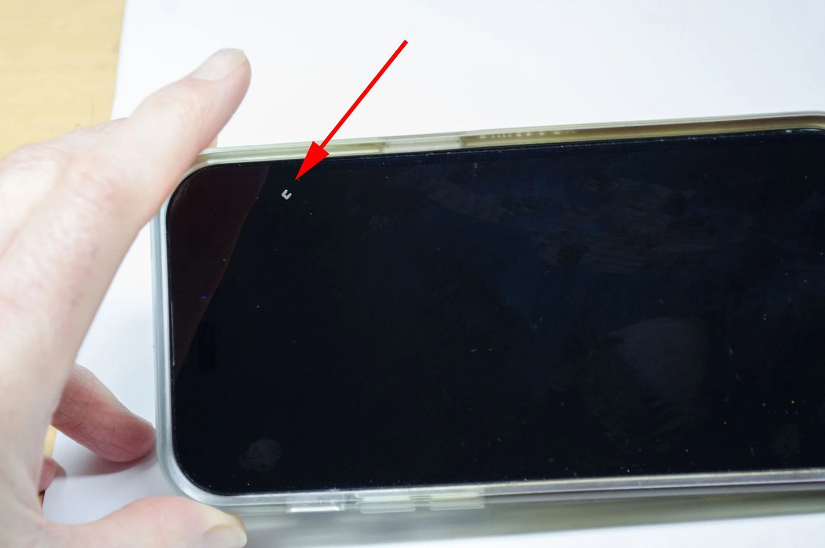

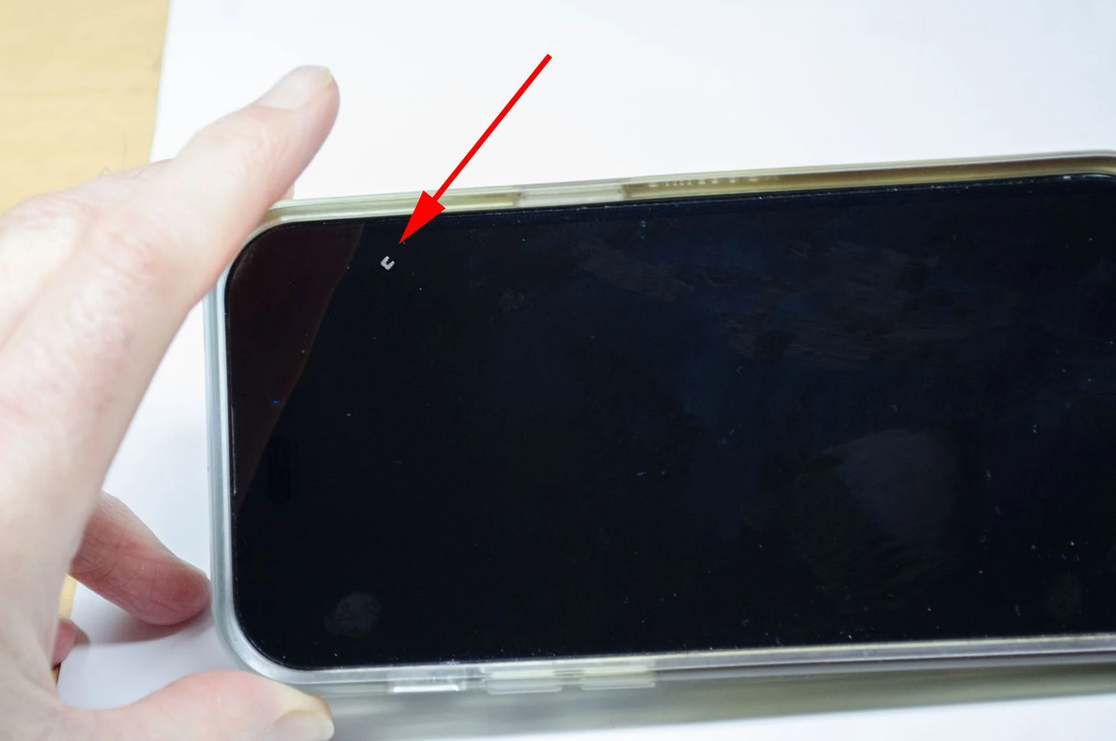

Well I was reminded of this thread the other night. I was sitting in my lounge recliner watching some tennis, and wanted to check something on my phone. I picked it up, and saw this:
This is a small retaining clip commonly used to hold something like a pusher in place. So I see them often, but have not had a watch that used on in the shop for many months. How this ended up stuck to my phone screen is a mystery...
It was added to one of the three "found parts" containers I have in the shop, for stray parts that I find either on the floor, on my bench, or now...stuck to my phone. At least with this one I know where it can be used. When you find a random jewel or screw, or even a pallet fork, there's really no way to know what it came from.

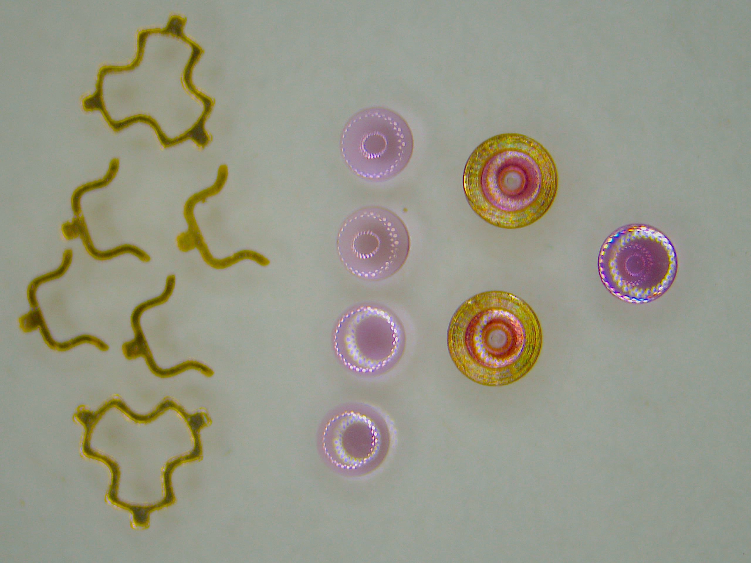

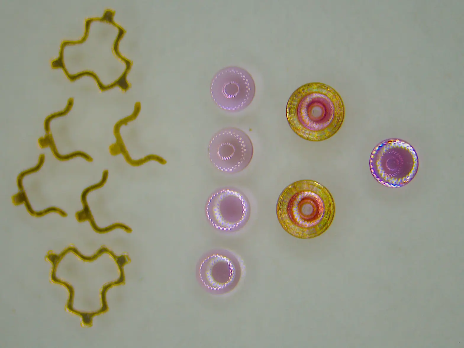

Fresh out of the cleaner today.
This time it's the balance cap jewels that have fallen in love.
