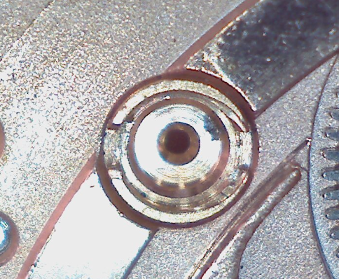

Many sources online indicate you should push the block out, reseat the shock spring, then push the block in to lock it
However I think these come out easy, and can just be inserted in vertical position, and when it moves horizontally it locks into place - at least I believe if it easily comes out, it easily goes in as well
It's been the second time one of these came out, first time was a bit hellish, but this second time, using this method from the get-go, I was able to get it in the first try. This second time I felt an off angle when the spring was unlocked, so instead of picking the jewel out or pushing the spring out, I shaked the jewel out and the spring came off that easy. But luckily installed easy as well.
Just sharing this with hopes that after a Google search, it could pull someone to the easy option

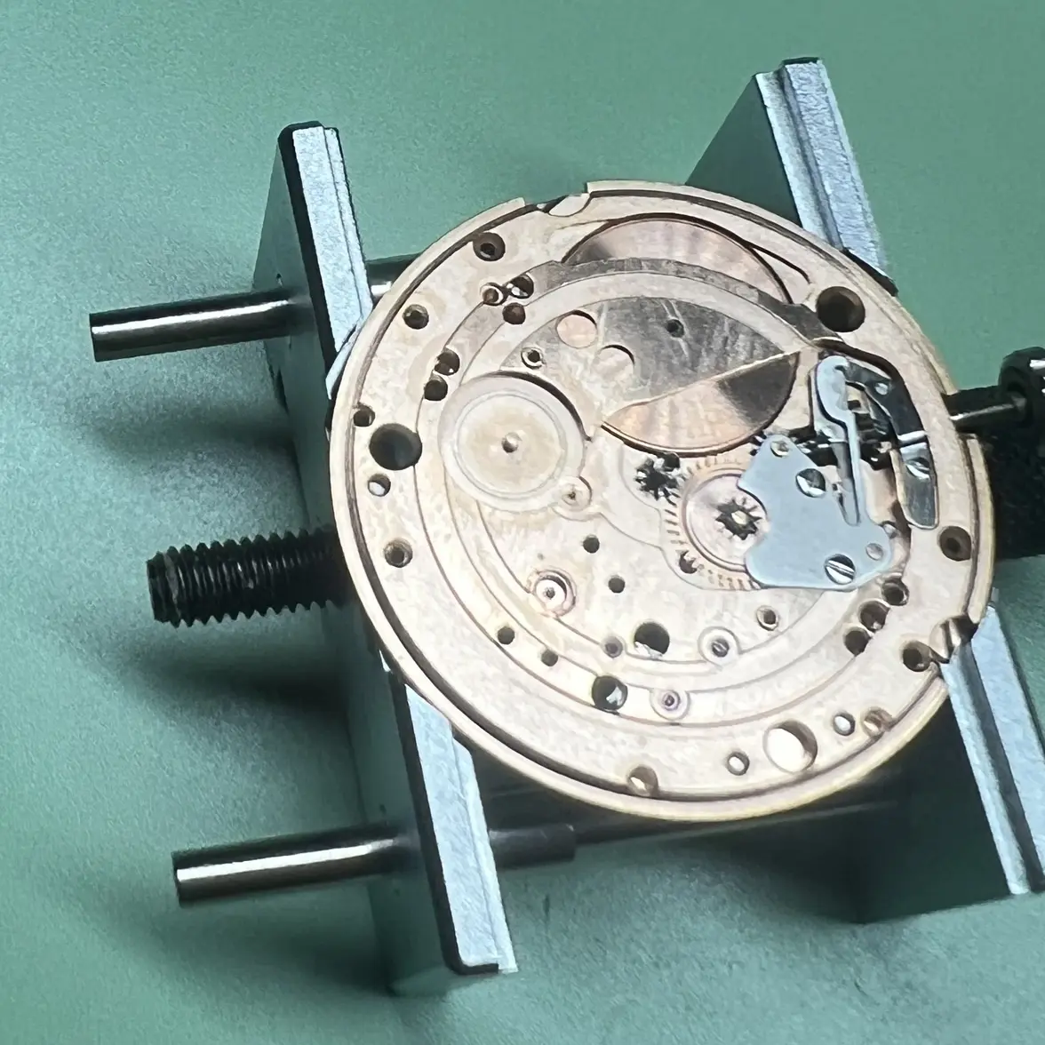

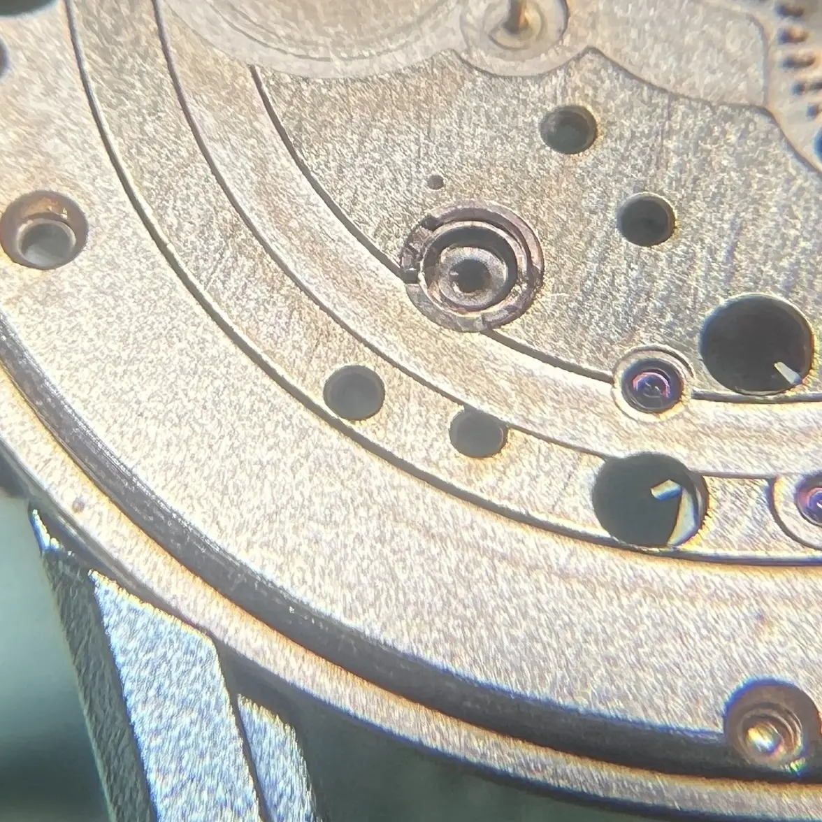

Thanks @kaplan for this kind suggestion. I've got a case where I'm not sure it will work, but would like to tap into the collective knowledge as to how to solve this... And yes, I did mess this up myself in the first place. 😬
As you can see, the incabloc spring is (almost entirely) gone. I snapped off one part of it and tried to pry out the remains. To no avail. I guess it has to do with how the incabloc block is oriented, in this case, the openings are aligned with the higher parts of the plate, which leaves no room to get the shock spring out or in.
This of course leaves the question on the table; how can I go about fixing this? Pressing the block out a little, or would turning it be an option to be able to proceed according to the suggestion the OP here made? Benefit of the first could be that getting the end shake in order is less of a challenge?
In short; help!
In short; help!

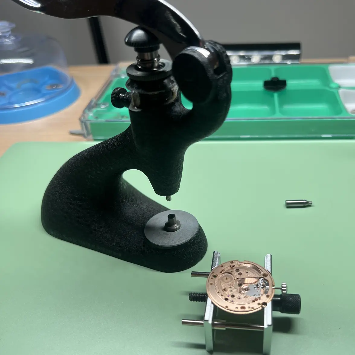

Carefully pushing out the Incabloc with a staking tool, inserting the spring, and pushing it back in was definitely the best approach for me. It is pretty straight forward and not a hard job to do.. Trying to fiddle it back in may work, but I would get an extra spring, as even the slightest pressure at an unfavorable angle could send the spring flying off into oblivion.
2,681
3,161
You are welcome
I would suggest pulling it out at a 135 degrees angle and just wiggling it out, or just yank it out of there and discard it
But so far the angle trick always worked for me
After the original post I had a lot more experience with it, lately I just push the spring in place using a toothpick - I place the spring flat between the block and the jewel, then push it forward with the toothpick, when it comes into contact with the block it naturally lifts up and around the 135 degree angle, it starts becoming "stuck" into place, I just wiggle it in there at 135 degree angle using the toothpick
Without any special tools you can also push the block out, and push it back in (like with a flat plastic hands pusher etc.). The horizontal angle matters most, as you see in your picture currently it's angled so the date disk has full clearance, and the block is flat with the surface. So as long as you make it flat again, I assume the endshake will be the same
So if you end up pushing it out, you can gently push it back in, turn it so the date disk clears, and then gently push it back into flatness 😀
Yep - and make sure that if you push it all the way out (you don;t have to - it just needs to be pushed out a bit) that it is pressed back in with the same orientation, so the cut out in the setting clears the calendar disk.

Well, thanks to the good advice here, it wasn’t too hard. I did have to press the block out a little and back in. The patient is running again. 😀
And I can confirm that the 175.03 fits this 565.
