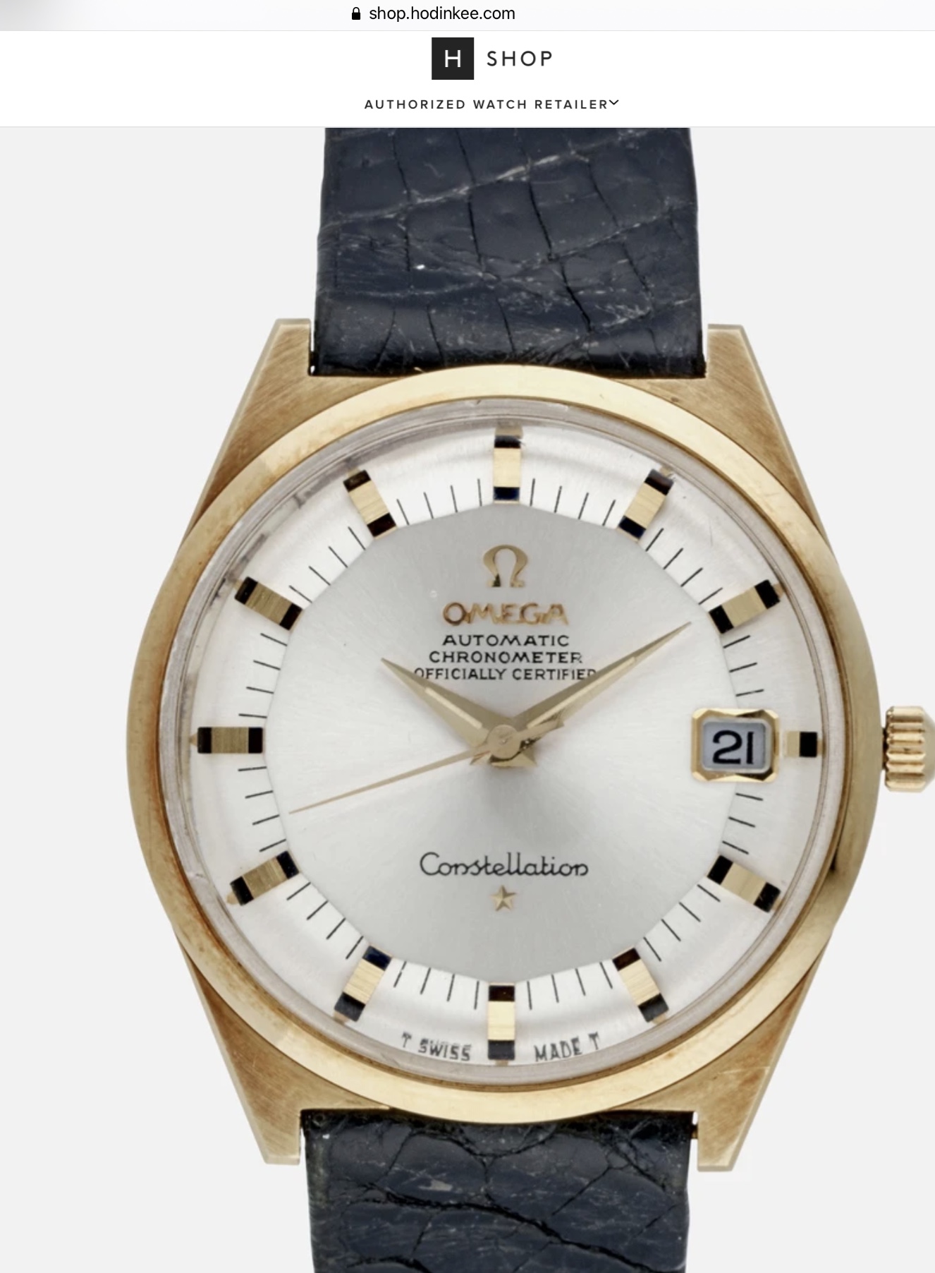

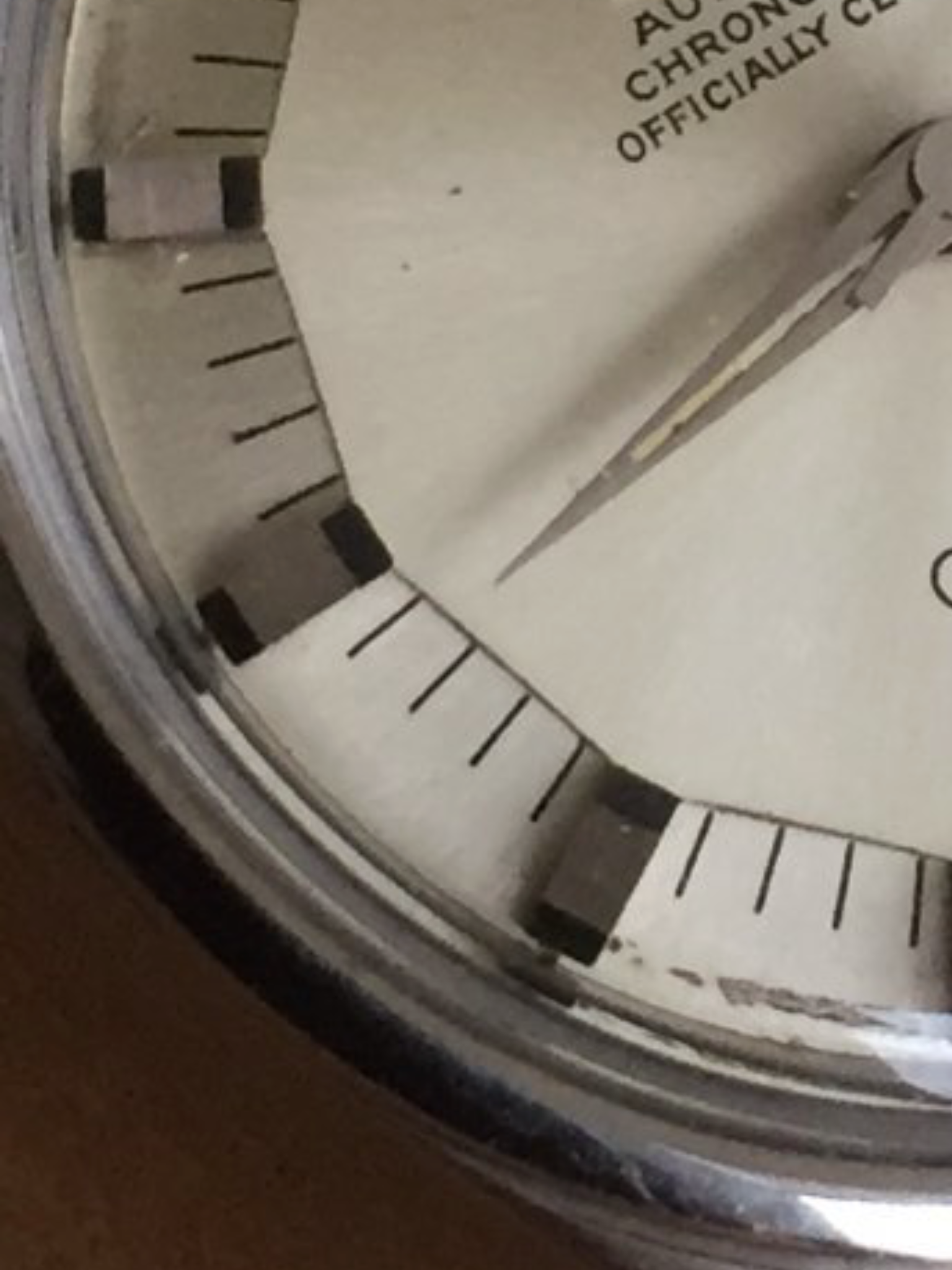

Looks like a Re - Dial ??
7
4
Is this an obvious redial ??? Now that my eye is getting trained most of the watches i see seem to be redials??
Anyone know of a nice Constellation steel pie pan or not ??
Thanks

It’s really well done with the exception of the minute markers.
Ie too me it looks ok except for the odd large minute markers which I’ve never seen… but that doesn’t mean anything.

I stand corrected! Looked like a redial to me.

While I won't claim to be an authority on these, I would say it is okay. These 168.025s came with some pretty unusual dial types.
Edit: There is something off with the lume though. Perhaps it has an incorrect crystal obscuring the plots? It does seem like at least one of the hour markers have been reglued.

A double T without obvious hour marker lume isn’t exactly conclusive but interesting. I know it’s not a rule.
your thoughts? For my education?

Double T or single T means the same. The idea that there are dials without lume fitted with hands that are lumed is more or less a myth, at least when we're talking Omega.
I would hazard a guess that it has either been cleaned and/or it has had a wrong crystal installed which obscures the markers.

These .015s and in this case .025s do have some ‘unusual’ dials.
this one looks like it is wearing false eyelashes.
Whilst the printing looks crude, I think this one is correct.
The lume , in contrast to the oversized markers and minute haches, are small dots and I also think @ConElPueblo has it right that the retaining ring is obscuring the lume.
you can just see them on a different angled pic and they’re more obvious on the hoodinkee offering.

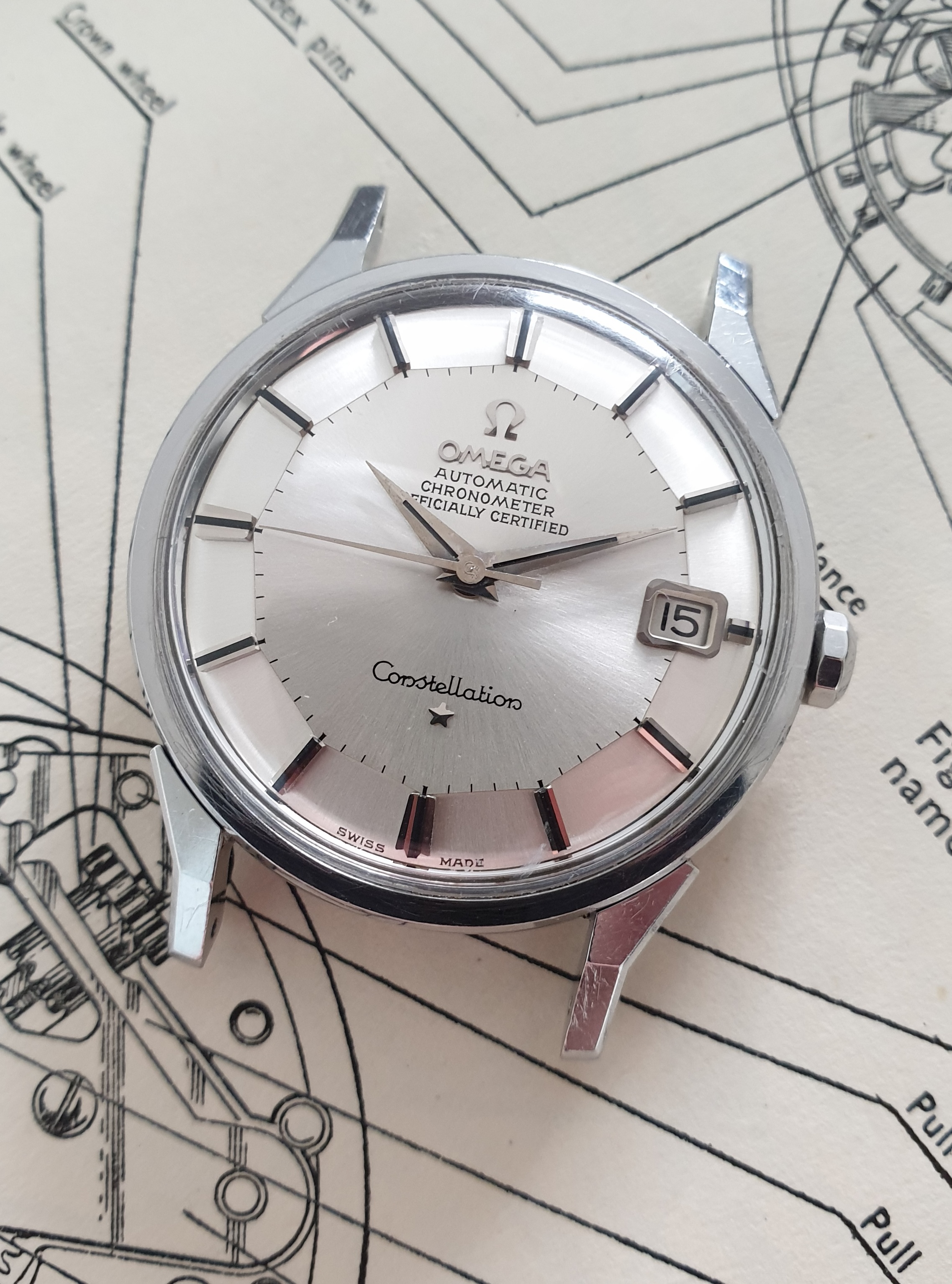

That depends on what you intent to spend - money or time? I've found wonderful Constellations at very affordable prices at online sales places such as local "craigslist" variants and on eBay. But I have a knack for visual identification and have spent a lot of time getting to know my way around old watches - not all have those skills and that much time on hand.
This one I found last year:
They are out there.
If you cannot put aside the time needed for this, you should find a trusted seller and then get ready to spend around $2,5k for something similar.
