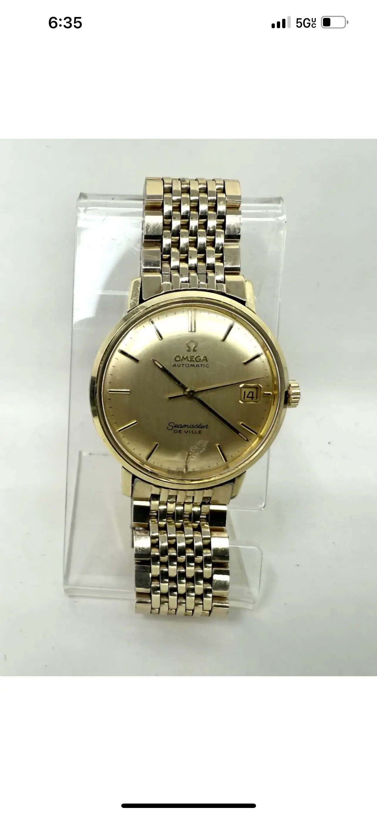

Hello!
I’m looking for any information I can get from the ultra low quality photos. In particular, where can I find a decent authentic replacement crystal? And any special pointers on replacement? I’ve already learned about the movement removal which obviously includes removal of the bezel and crystal. Is it as simple as pushing the old crystal out and the new one in?
Thanks!

Looks like 166.020 from mid 60's, this is a front loader requires special technique and tools to open from front not for beginners. Also looks like bad damage on dial at 6:00 marker. Hard pass move on

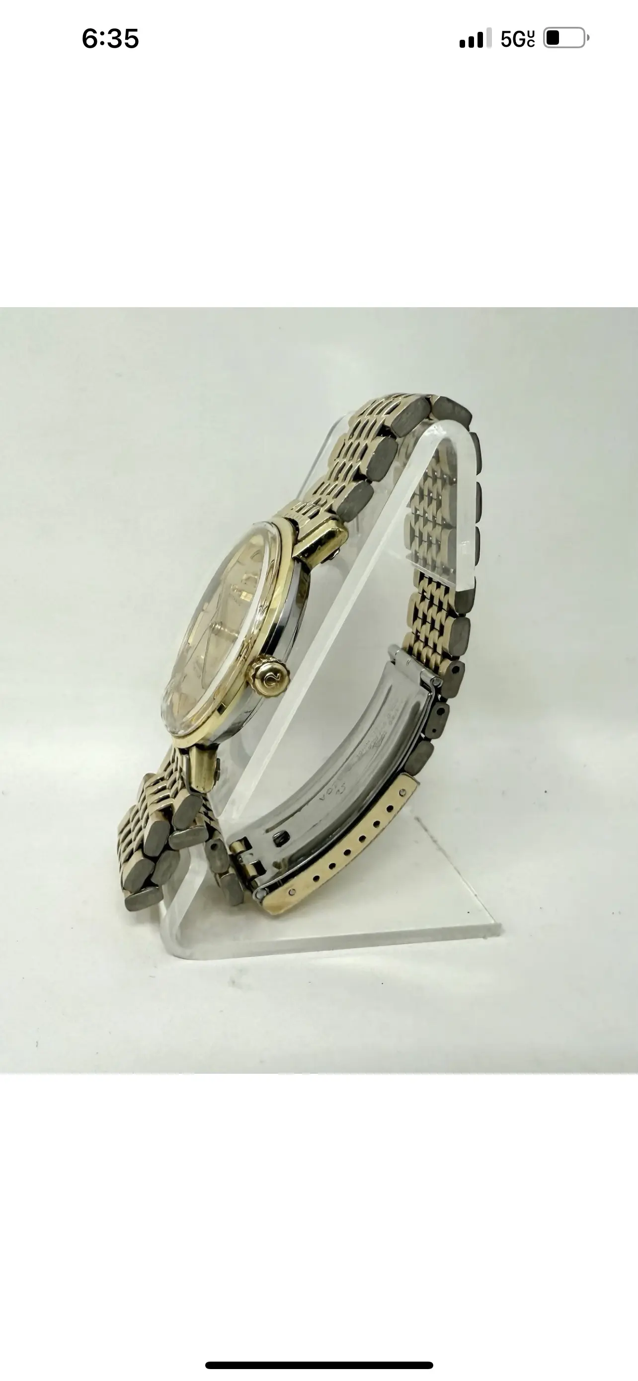

thanks for the reply! I already bought it. The damage is actually to the crystal, you can kind of see it in the profile view but it almost looks like it was a little melted. Dial is in good shape to my amateur eye.
