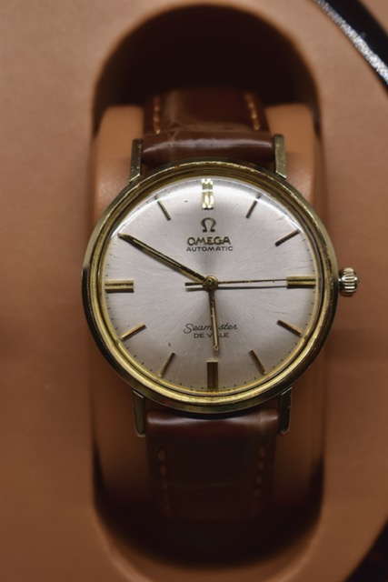

Fellow enthusiasts,
I write to you all after coming across a family heirloom that no one in my family thought to give a second look. For my most recent birthday, my father passed down to me his uncle's Longines Automatic Olympian. It's a beautiful and unique piece. After discussing other family heirlooms and trinkets, he sent me a picture of his father's (my grandfather and my namesake) Omega Seamaster De Ville, laying at the bottom of a drawer with a dusty box. My father thought it was comparable to something like a Timex. To be clear, neither of us were very familiar with the world of fine mechanical watchmaking prior to finding these pieces. In the last year, I have taken an intense interest to automatic watches and specifically in maintaining these two vintage watches to the best of my ability. When I heard that he had a Seamaster laying around in a drawer, I knew it was something special.
I took this Seamaster De Ville to an Omega boutique that is local to me this past weekend and I was told by the friendly staff that the watch would require a round trip to Switzerland for approximately 6 months in order to undergo a full restoration. The gentleman I spoke with informed me that the crown is not an original crown, and I could not find an original Omega strap to present with the watch either. It appears that my grandfather wore this watch with a Bulova expansion band (included in pictures).
It might be worth while to add a few crucial details here before I eventually get to my question, namely, that this watch also appears to be engraved on the back of the case. Something that my grandmother likely had written as a note to my grandfather when she gifted this watch to him. I think I would want to preserve that as much as possible. I also want to preserve as many of the original Omega components as possible, something that the gentleman at Omega informed be would be difficult, due to apparent water damage on the face/back of the face/in the movement.
The Omega salesman informed me that the cost of a full restoration would be approximately $2500, clearly more than the current value of the watch. I have no intention of selling it, but I am still in my 20's and not necessarily in the position to spend $2500 for a restoration. My question is: would I be better off taking it to an authorized Omega watch repair center? Would I still receive any papers or authentication that the watch was rehabilitated by Omega?
Thank you all for reading. I very much appreciate any and all guidance.

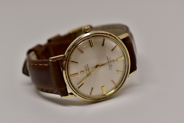

Great introduction, and welcome to the forum. I don’t see any significant damage that would require a restoration (others will chime in). I would get it serviced locally ($300?) and wear it as your grandfather left it. I wouldn’t keep it on a watch winder myself, but would certainly suggest you take it off of it until you get it serviced

Neither do i. If the case looks rough to you, a bit of cleaning ans maybe some light capecod will really bring back the shine!

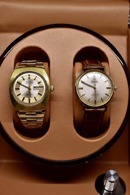

Thanks very much for the reply. Can I ask you why you would take it off the watch winder? Is that something I should do after it is serviced as well? Thanks again.

There are as many opinions on watch winders as there are people here, just do site search on the topic. I expect though that most would agree that if the watch hasn’t been serviced recently (maybe within 5 - 7years), and if you love the watch, then don’t wear it regularly, and certainly don’t keep it on a watch winder. The watch might be working, but the oils have dried and it will be grinding itself to a slow sad and expensive death 😬

a restoration quoted at 2,500.$ seems not reasonable (to say the least) for that model .. just get it serviced (180. to 300.€ max) by a competent watch smith and wear it !

Don't see anything that suggests water damage. Simple clean, very light case polish and replace the crystal.

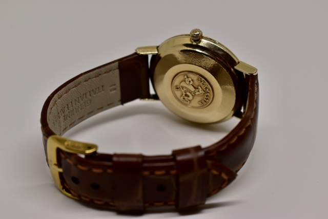

Crown. More difficult. You can buy modern, but gold plated. people selling NOS (new old stock) on Ebay are 99.99% selling modern crowns, but you may find a gently used gold filled model, but the seller would need to know the difference

Price of service will vary greatly depending on who you use and what they think is appropriate intervention. Don't get too hung up on "keeping original parts"... that's something hardcore collectors care about, and that watch has been serviced more than once (you note incorrect crown) so it's not as it came from the factory anyways.
What I consider proper service in USA would mean new crown, crystal, mainspring, and caseback gasket (can't tell if it's a frontloader?) at a minimum and replacement of worn movement parts as well. In many areas, this is more than $500. There are rumors of pockets of old watchmakers who don't charge that much. But don't necessarily take as gospel someone who says that any specific price is "too much"... make them tell you who their watchmaker is. 😁
That Omega Boutique person was misinformed, by the way. It might need to go to Switzerland... but it might not. True, you cannot get an original strap, but you can get an Omega-branded strap and buckle, should you want one.
Nesbit's in Seattle is an independent watch repair shop that is Omega factory authorized and has access to genuine Omega parts (not everyone does) so that is where I will be sending certain watches in the future for service. Yours is fairly ordinary within the realm of Omega, so they should be able to do a good job for you, should you choose them.

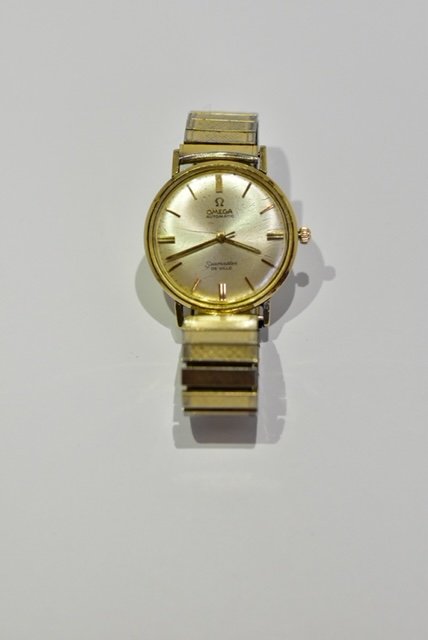

As for the band, be aware first that watches of that time period generally were sold without a band so that the customer could have a choice of several kinds of leather or a metal bracelet. It's not unusual to see a watch with a third party bracelet. Leather straps are available from many sources, and there are Omega branded metal bracelets and straps if you'd like that.

The suggestion that your watch was sold without a strap stretches credulity. Of course it was sold with a strap! That doesn't necessarily mean that the strap it came with is the one your grandparent walked out the door with; if a customer asked for something different, they would certainly be accommodated. Many of us buy an aftermarket strap of good quality and add an Omega buckle, for example.

Generic straps are okay to, no one will think any less of your watch because of it. $40 will buy a nice Hirsch
