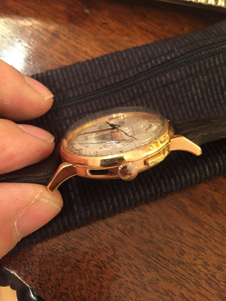

Hello
I am trying to help my mum husband to repair an old Omega
By searching online ,i think it is old 321 but not sure as i am not a pro
Can you help me finding the little button witch is missing and tell me where i can find it and if it will be expensive ?
Can you also tell me if this a good watch to repair or if it didn't worth it
Many thanks and sorry for my poor english
Jojobarj
9,217
24,054
Hi,
Yes, looks like a nice old 321 seamaster. To find the part, you will likely need to know the case reference number which should be stamped into the caseback of the watch. Take it to a watchmaker and get them to help remove the back and take some pics. We love pics.
As for the part, you may have a hard time. Look at ofrei.com or cousinsuk.com once you know the case reference.
Someone with more knowledge may come along too.

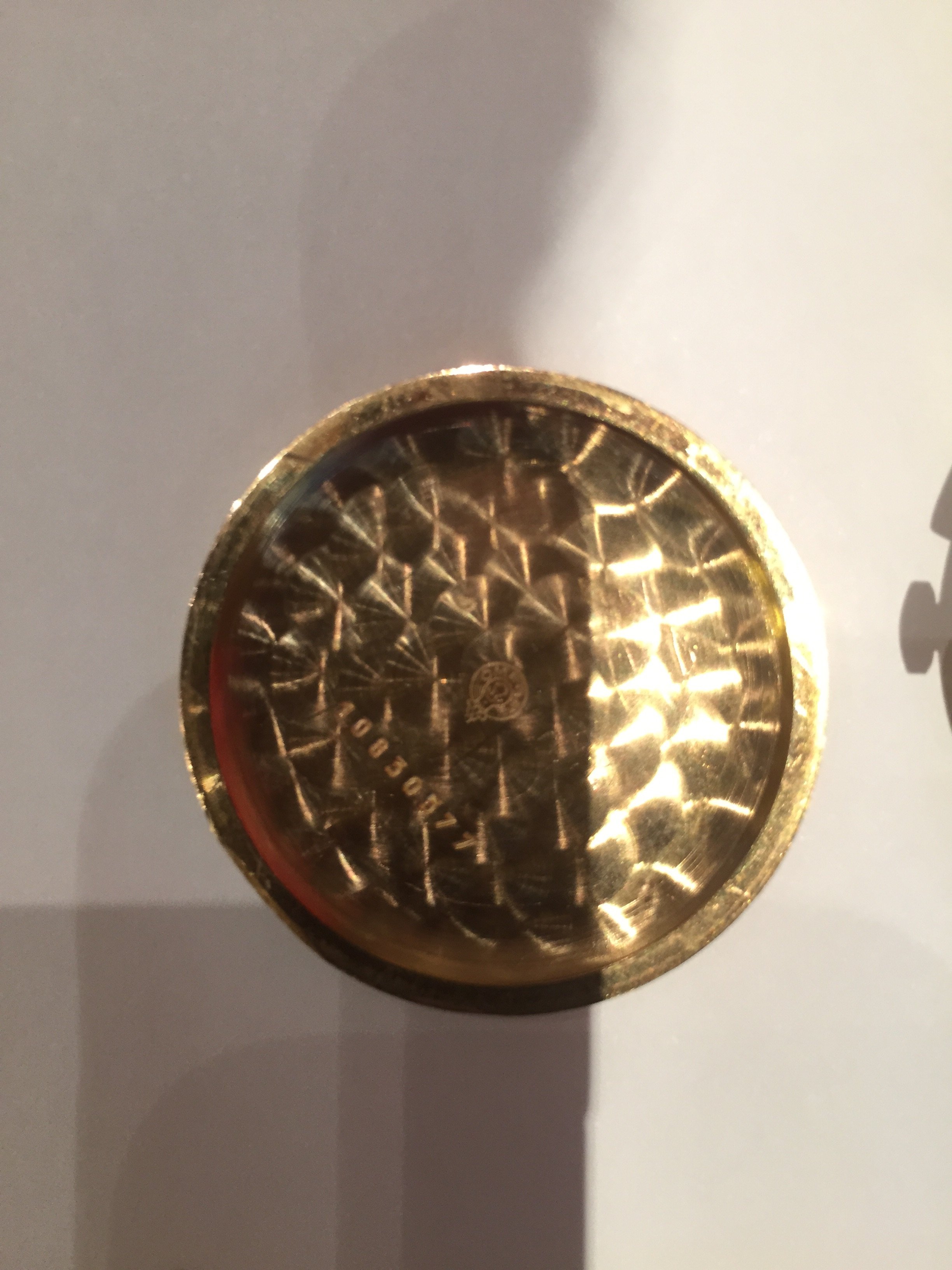

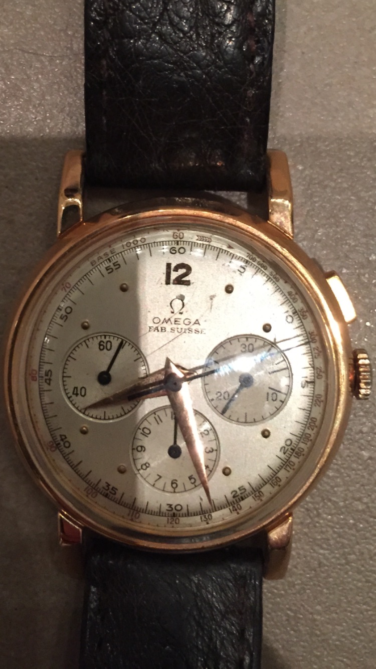

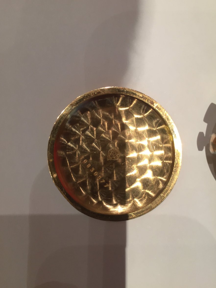

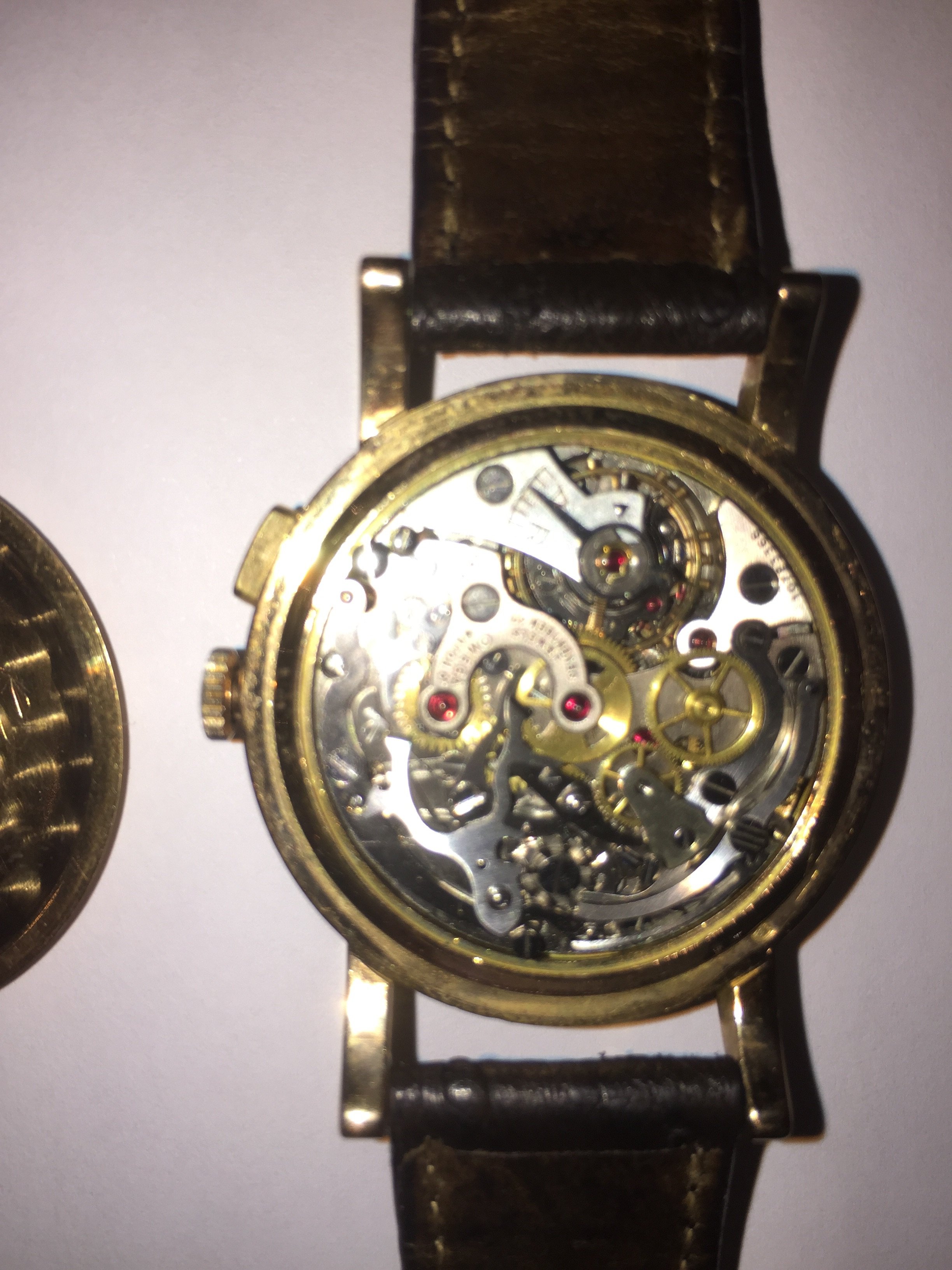

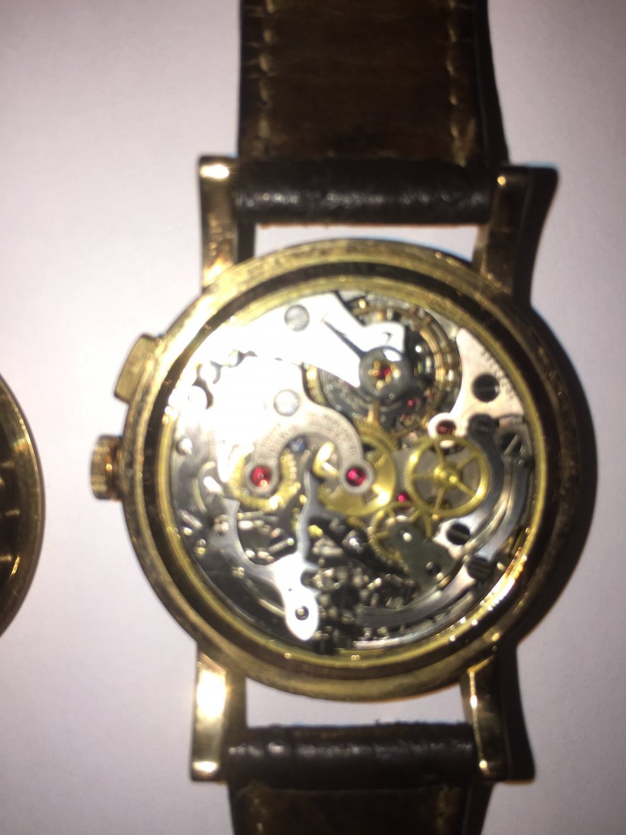

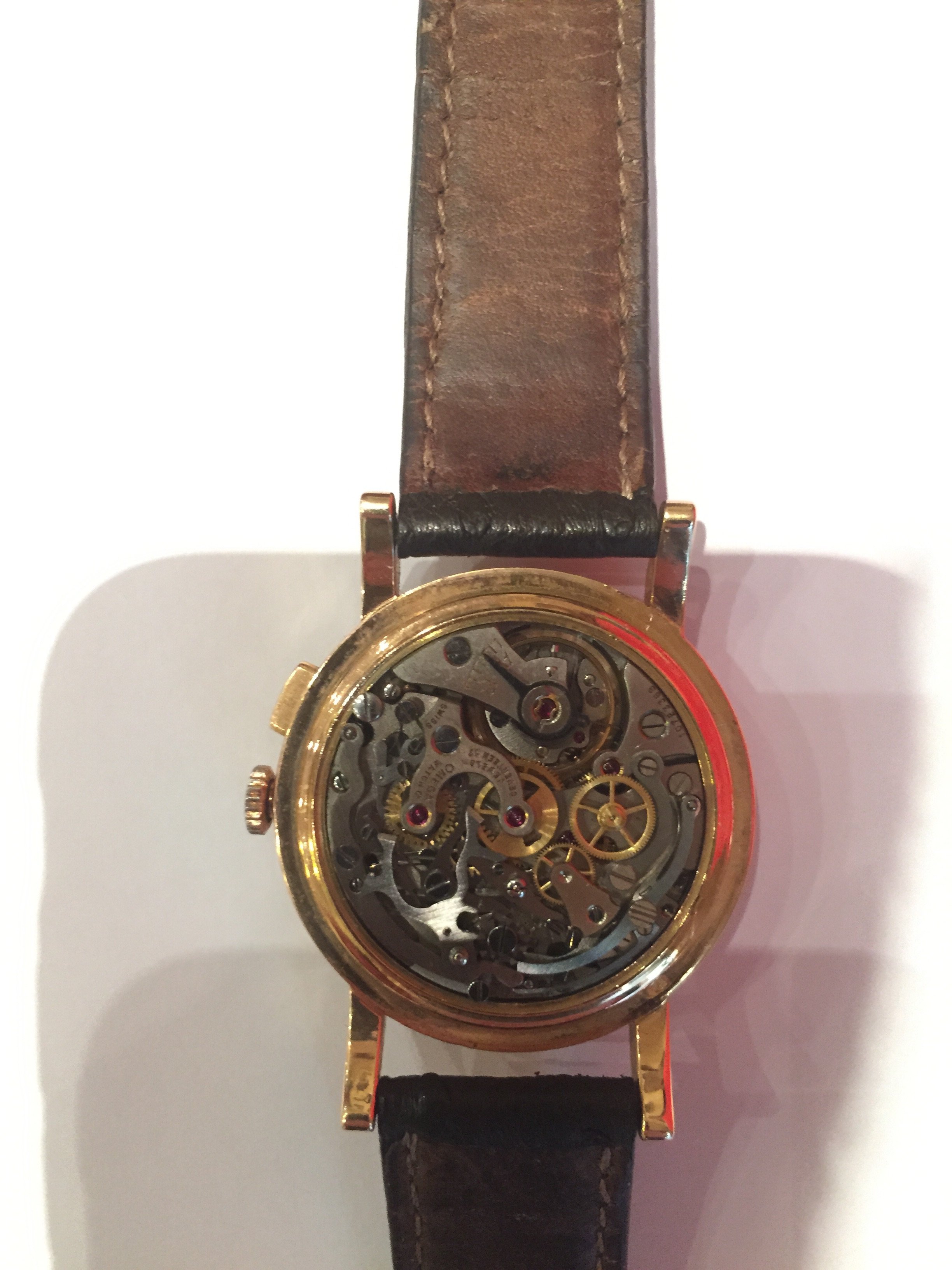

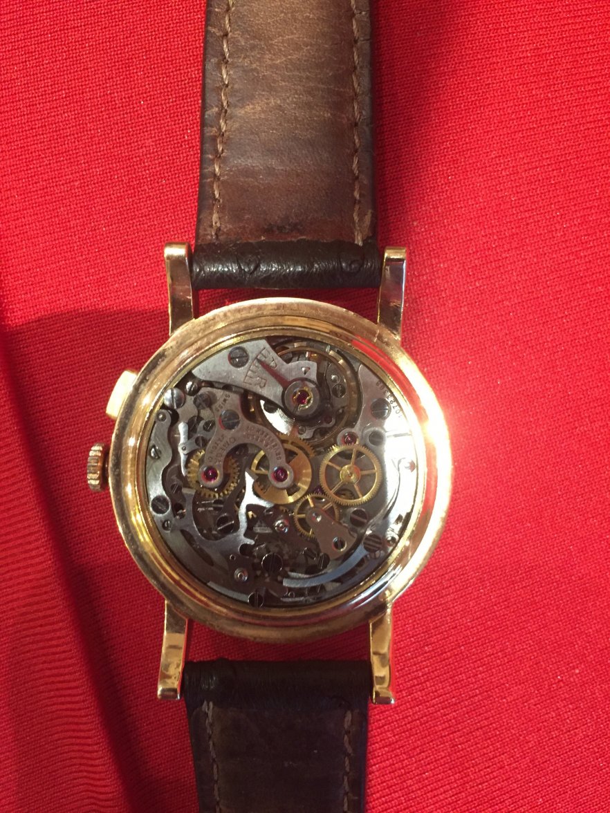

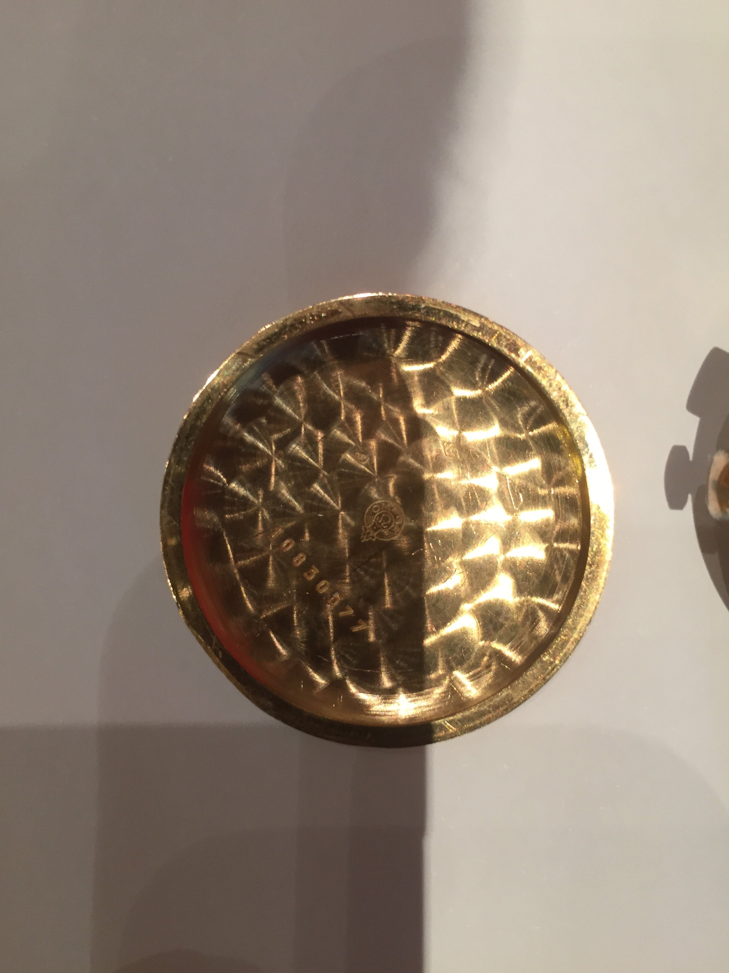

Hello everyone
I just came back from the watchmaker, please find bellow some pictures as you asked me
I am sorry for the bad quality of these pictures.
Thanks again !
Julien
7,796
35,402
As I thought that is a (French) national production case, so you have a French case number but no watch reference number.
Unfortunately it is the watch reference number that you would need to be able to try to locate a replacement pusher.
I'll have look through AJTT later to see if I can find a similar Swiss reference numbered watch to give you a starting point anyway.
Maybe someone here already can put a number to this case design?
