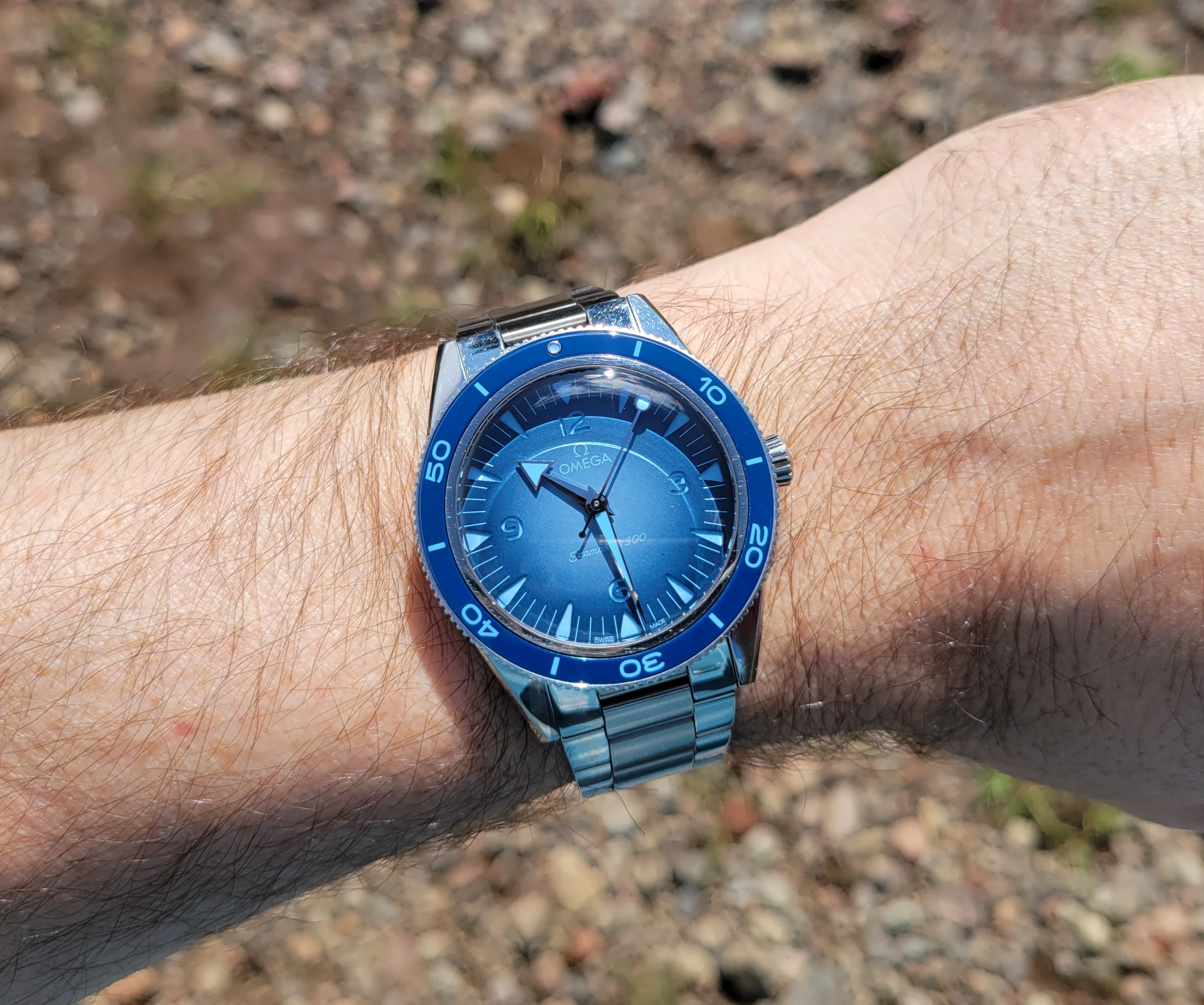

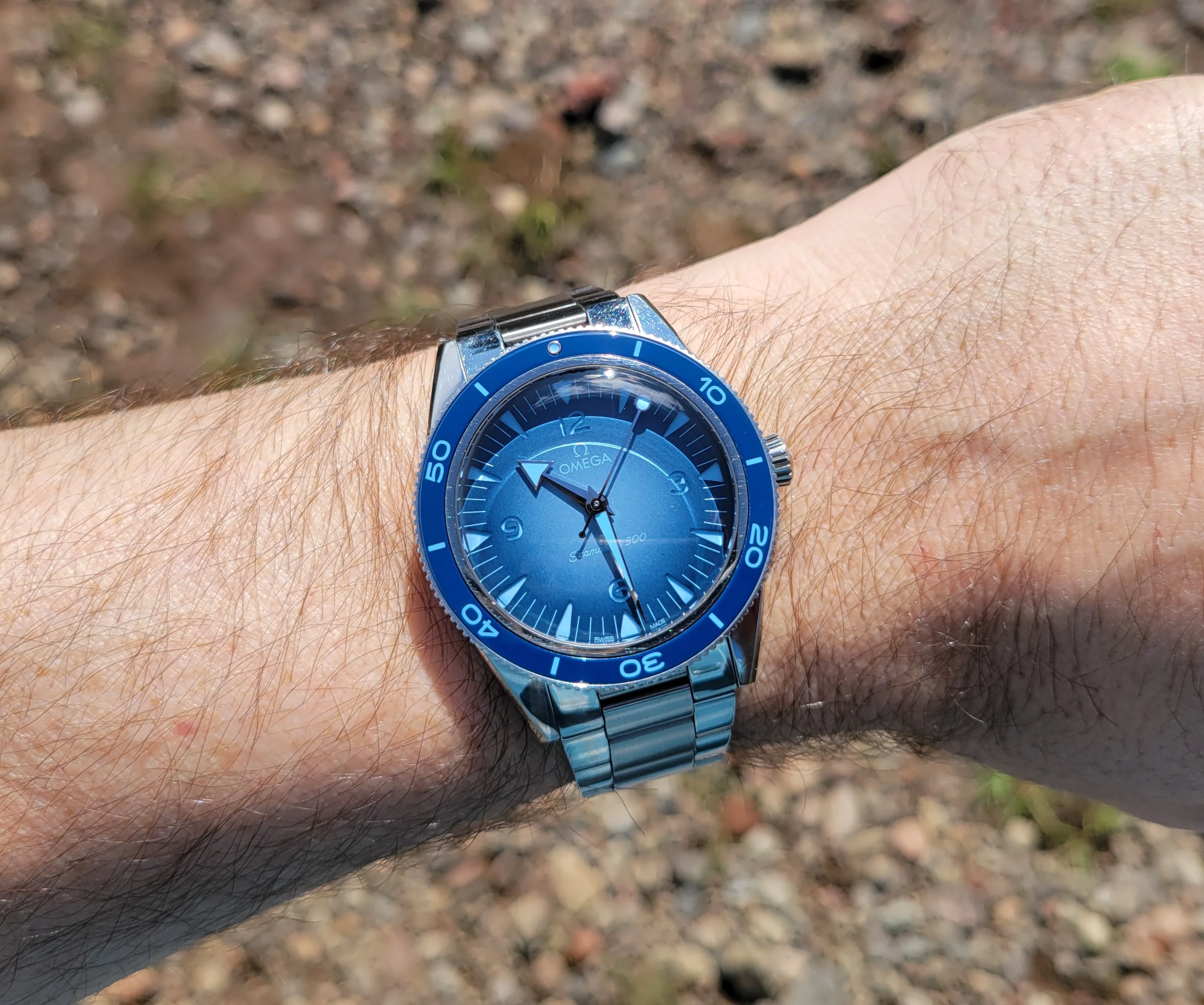

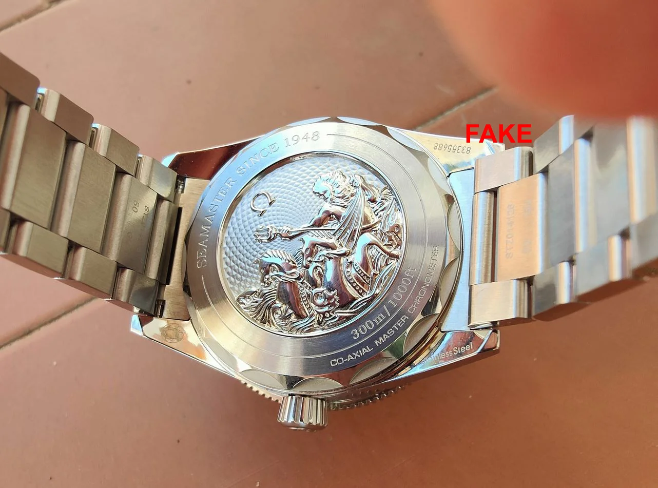

No idea how the Summer Blue looks in real life as I've only seen the Diver 300M Summer Blue in person, but these were the photos posted with captions added by me.
Well gosh, if that isn't a pretty good fake. I bet looking at the back might be helpful, but other than 2 very small things that I'm unsure of, I'd be unable to spot it.

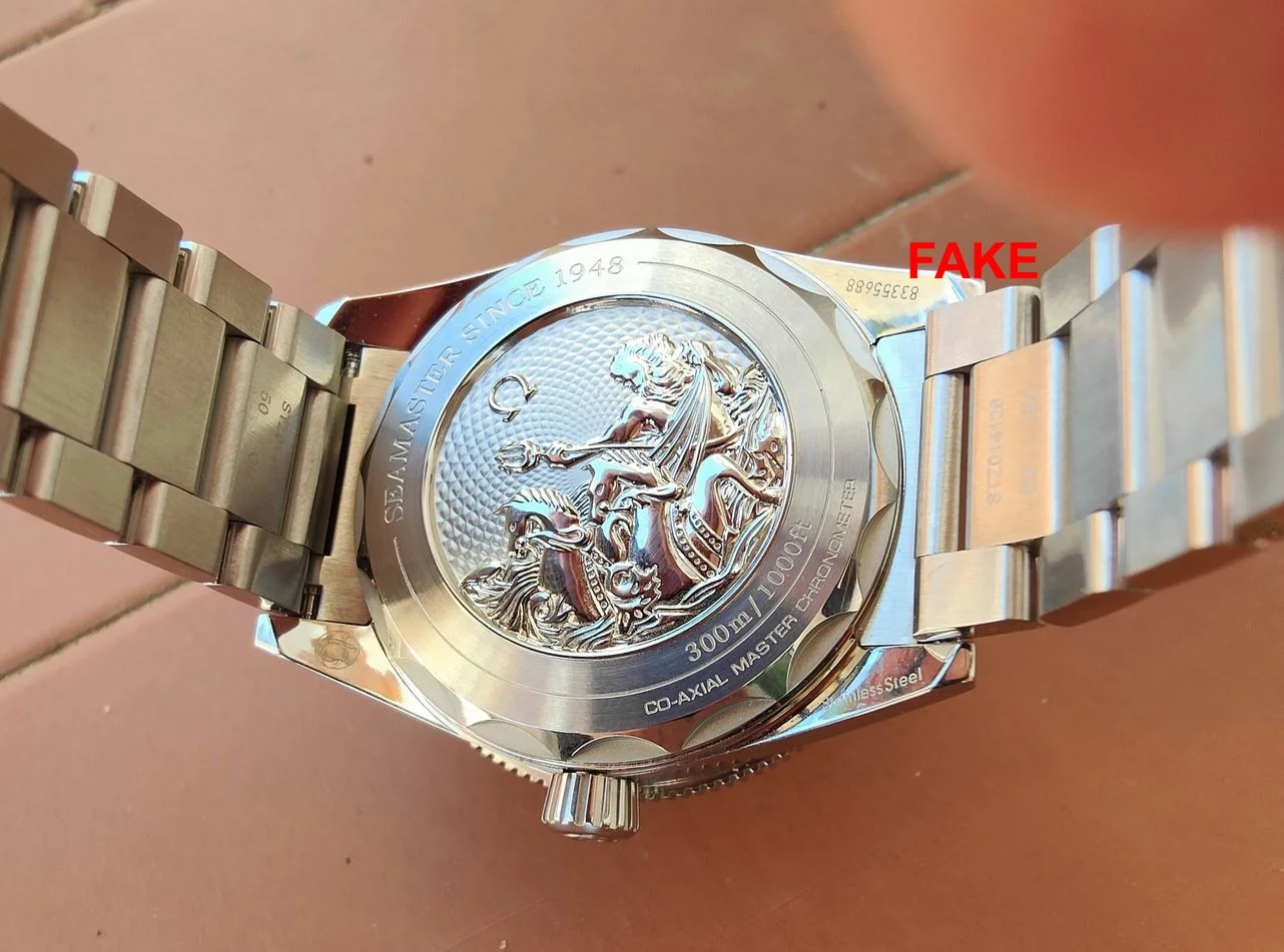

The back engraving isn't as crisp, it's a couple images up. Ev3n my bad picture of my caseback earlier in the thread has better polish. The main tell seems to be in the way the gradient is applied- these dials are spun and the centrifugal force draws the particles of texture/color away from the center. That causes the gradient. It doesn't look the same in the images above.
It's hard to see though.
REAL:
Also, the summer blue lume and inset numbers aren't exactly the right shade.

@ErichPryde is correct in noticing the missing ridges on the underside of the endlinks-- you were indeed sold a fake.
It's easy to research the fakes that are being sold online-- all the "replica" SM300 Heritages all happen to have the ridge-less same endlink and are mated incorrectly with the 20mm STZ001159 clasp. You're the second person in the last 2 months that I've talked to on here that got scammed by an eBay seller (which is quick to accept a return to protect his reputation to continue scamming) with multiple fake bracelets being sold at real prices, as well as other fake straps/bracelets from brands like AP and Patek.
Who'd you get it from on eBay? There's one guy from Germany and another from Israel that is known to be doing this en masse.
Fake SM300 Heritage with the same smooth endlink as yours. Same GIJ factory code on the bracelet and HJE on clasp:

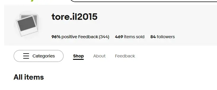

Hi all. Just to follow up, and get the info of the counterfeit seller out there, so no one else gets burned like i did. its tore.il2015. Having finally received the return (!) hes claiming the bracelet is too damaged to re-sell and he won't refund, despite claiming previously that he would (I suspect to prevent me leaving a negative review before the window closed). I'd say he seems to be an experienced fake seller and is selling a host of different brands, but somehow has hugely positive feedback. Guess this is a lesson learned for me!
