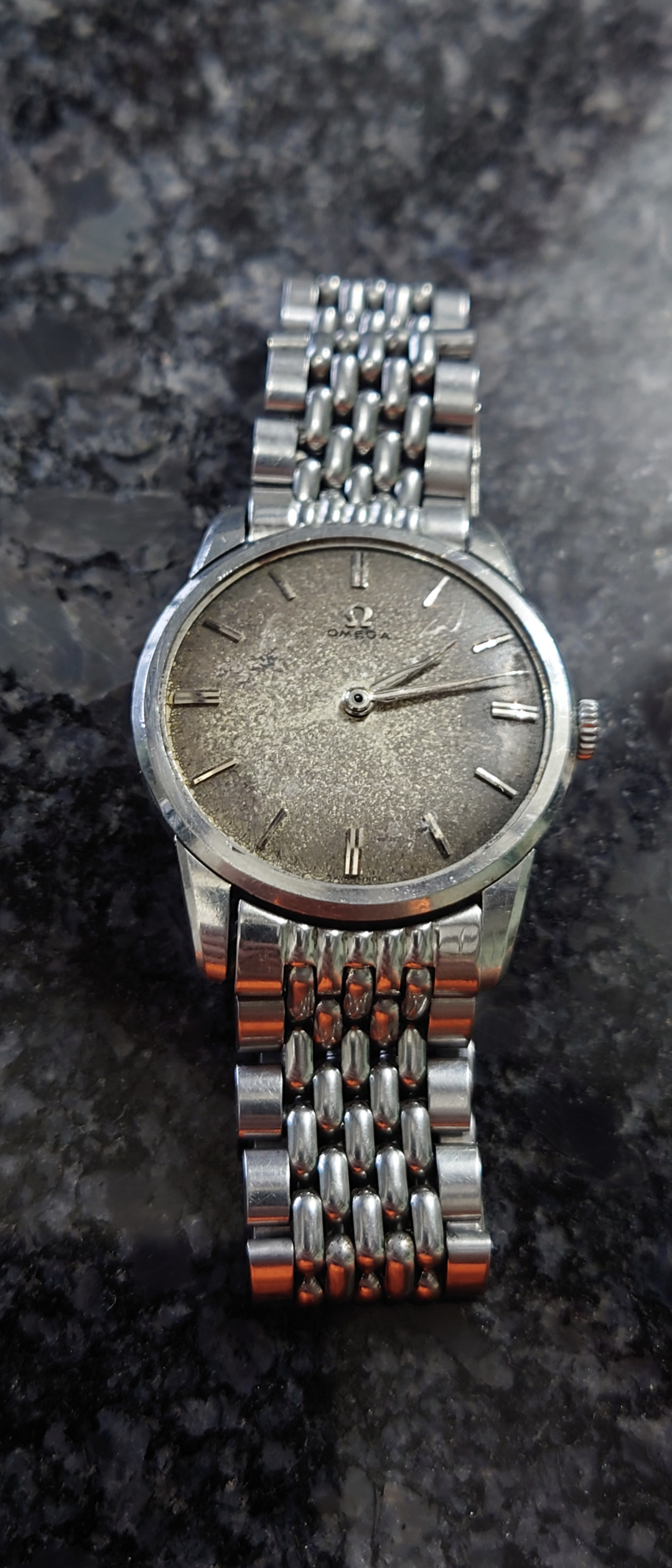

Good afternoon all I'm looking for a little help I'm trying to find a crystal for my 14726-1sc and the second hand. If anyone could help would be much appreciated its in stainless steel

It would be difficult to find a genuine with the Omega logo in the centre. I know Omega at Swatch would not sell me one when I enquired about it 5 years ago as I was not an authorised Omega watchmaker. I gave up and found one in Ireland on
https://www.nwcsupplies.co.uk/
They have an email contact and you can send them an email to ask.
I am not sure if Clark watch supplies do one as I found a generic Rolex crystal at a third of the price and I see it almost undistinguishable from the genuine. They sell on eBay as Nostalgia 2000
https://www.ebay.com/str/clarkwatchparts?_trksid=p4429486.m3561.l161211
It wouldn't hurt to ask.

Crystal is Omega part #062PN1055.
You don;t say what colour the case or hands are, but the plain silver seconds hand is Omega part 066TZ0280LG1375.
These part numbers might help you in your search...

It's stainless steel.

Look at the center tube of the movement. if it's closed up. No sweep hand. If it's open. Should see a small pinion arm for the hand. Need to open it up to check the reference number on the back to know which hand you need

Sorry for a late reply. Yes it should definitely have one as you can see the pinion in the centre

As mentioned. Reference number + caliber number. Mention color just to be safe.
Jules Borel. Otto Frei, McCaw and Co. and UK. Cousins
Can also buy generic if you want to save some money
