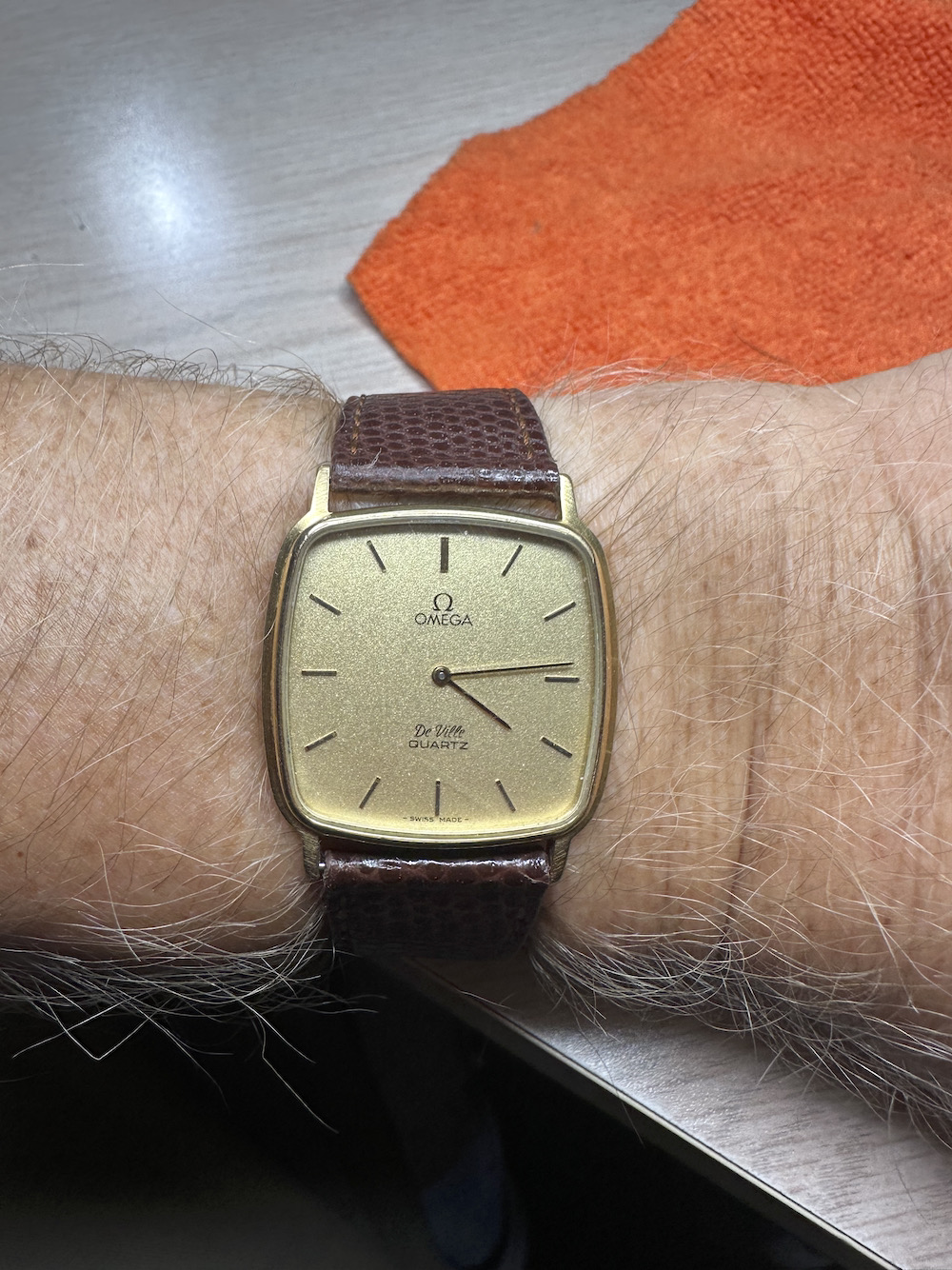

Just got this in from eBay and it has a few more scratches in the crystal/glass than I expected. I tried polishing out with some polywatch and both q-tip, then dremel with no joy. So I'd like to replace it. Odd shape though, so I'm thinking it will have to be NOS or custom made. Any sources for NOS stuff like this? 26.55 mm on a side.

You need to open the watch and identify the case reference number. Probably something like 191.XXXX.
You can then search Cousins UK or Boley in Germany for the crystal and gasket numbers, then it's off to the internet to find one.

I think it may be glass which would be why you couldn't polish it.

I am just curios..Omega still make parts for all those old watches? For any case reference number they still produced all the parts?
