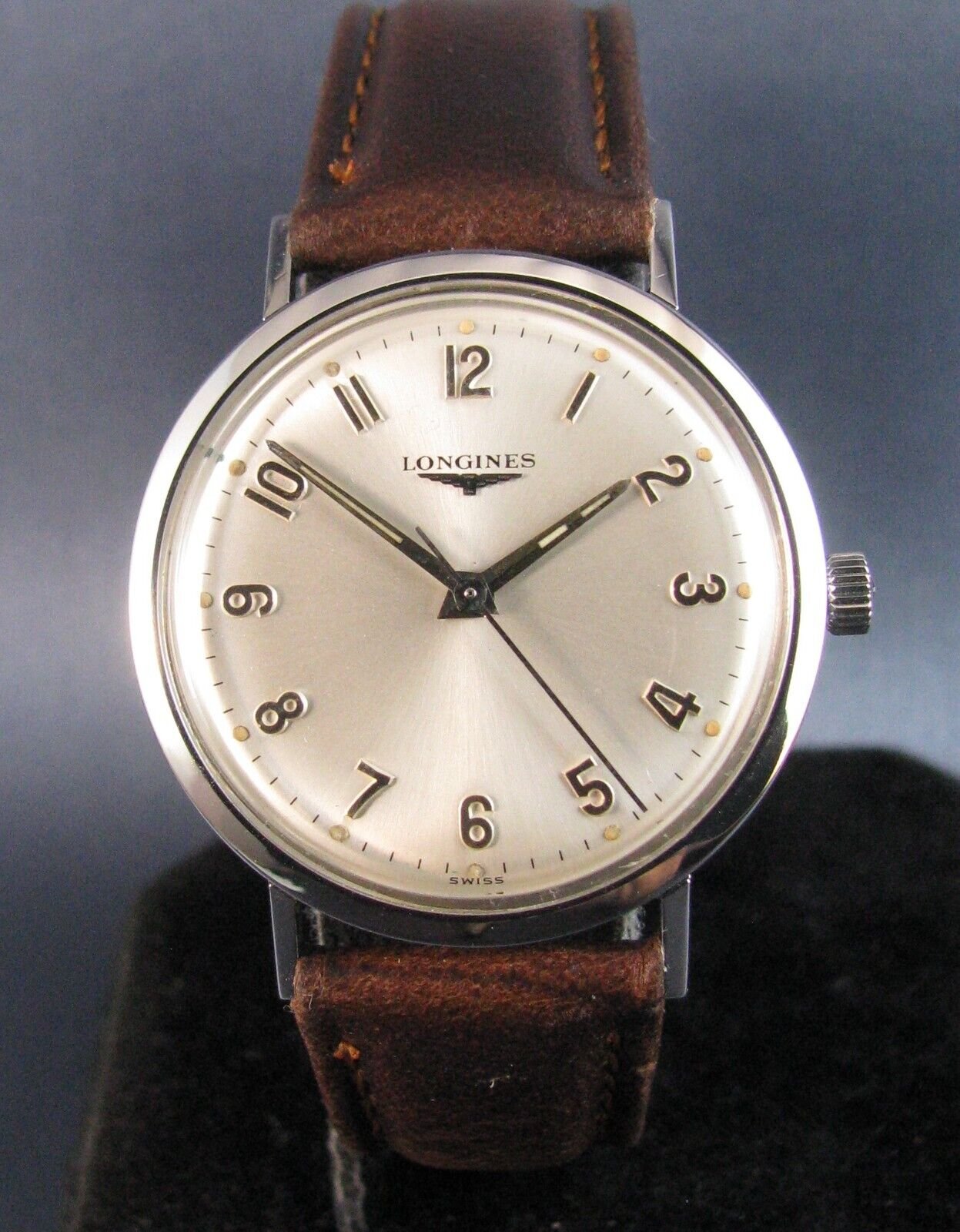

The seller declined my $350 offer; stating it has been recently serviced by their in-house watchmaker. Based on the experience on this forum, is the watch generically worth full price?

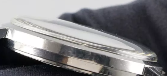

The only other thing is that would bother me is the ebay watch has one of those generic crystals with a sharp corner in the profile. It is more cylindrical rather than domed. The picture below shows the difference in the crystals of the two watches. I am not sure how easily a crystal can be sourced, but it is something to be dealt with if it bothers you.
46
40
Wow...Perfect illustration of what I'm not catching. In the end, I suppose if I like the watch, issues like this could be addressed at its next service in 3 years.

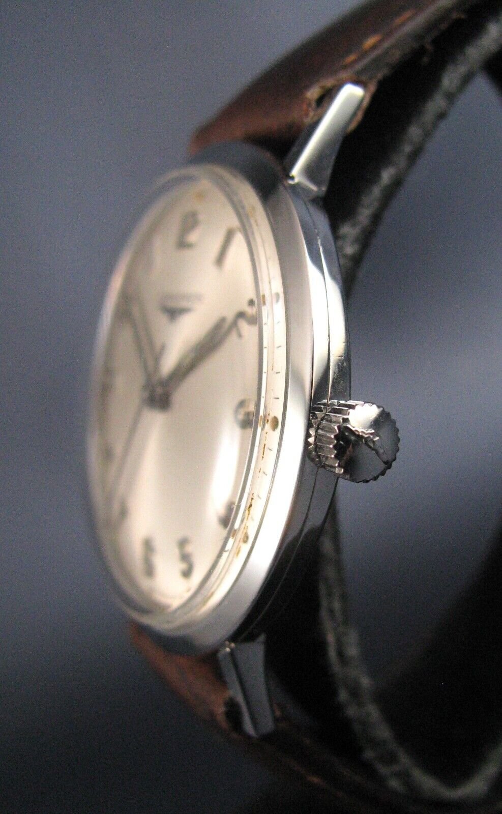

Stem looks bent to me because the crown is not sitting square to the case. I feel like a service would have replaced a bent stem, yah? Or perhaps it is just photo distortion.
4,857
12,285
I agree. Good catch:
46
40
Well, after reading the various posts, I inquired about the crystal and the crown. Here is the response; any thoughts?
"This has a one piece case and a split stem. None of these three pieces is bent or damaged. The crystal is correct for this watch. Also, this watch opens through the crystal using an Allproof 1200 wrench which requires a shouldered crystal as this has...a domed crystal with no should would not work."
It still looks like the crown is every so slightly off kilter, but that may just be an illusion. It is certainly is not significant and should not effect the functionality. I am not familiar enough with this particular case to say that the crystal has to be this shape. There are plenty of 60s era Seamasters that open through the face, and still have a nice domed crystal. I believe that the crystal is a correct fit for the case, but I don't think it is an OEM replacement. Perhaps others will weigh in.
