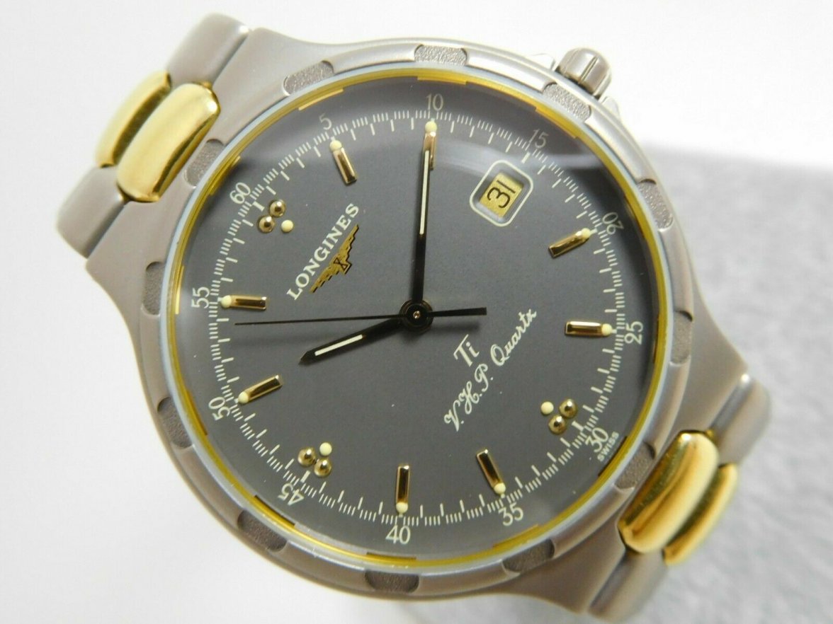

Hi all,
I'm looking for a user manual for my Longines VHP L237.2 with the ETA 255.563 movement. I did find an ETA manual for this movement but it seems written for a watch repair person. I'm looking for a user manual that explains what the three crown position do and how to correctly set time and date. The watch is like new, working perfectly and I don't want to damage it.
Thanks,

I’ll take a guess at this. Position 1, the IN, is the RUN position. Out to position 2 is the date set position. Out to position 3 is the HACK and TIME SET position. In this position, the hack stops the seconds hand while you set the minutes and hours. Remember, there is an AM and a PM, so set it right so your date doesn’t change at noon!

As above. I normally advance forward untill the date advances to make sure I’m in the right 12 hour period.
note setting the date/day is generally a bad idea on many watches if your within 2 hours of midnight as on some movements you can damage the day/date changeover.

Thanks for the reply. How is AM or PM determined and set?

You’re kidding, right? With the crown in the HAND SETTING mode, advance the hands until the calendar changes. That is MIDNIGHT. As the hands are advanced over the next 12 hours, that is AM. When you get to the 12:00 again, that is NOON! THE CALENDAR DOESN’T CHANGE AT NOON! Now as the hands are advanced, the time represented is PM! BEFORE NOON, AM. AFTER NOON, PM. When the calendar changes should be your clue!

Thanks for the reply. Since I got the watch the date has been changing at 12 PM. So yesterday, based on posts I've read, it needs to set for AM. I pulled out the crown to the 2nd position and wound hour hand around to equal 12 hours. The date increased by one day and I thought it was properly set. However, today it changed at 12 PM again. What am I doing wrong.
Another thought I had is, after the date change is completed, I could pull the crown out to the 3rd position to stop the watch and push it back in after 12 hours had passed. Is there any downside doing that?

I think you are telling me that your calendar changes at NOON, and at MIDNIGHT! You now have all the information you need to sort it out yourself!

Why would I be kidding. I asked a straight forward question. I had rotated the hour hand until the date changed thinking it was now set to AM, but today the date changed at 12 PM.

It does not change at AM only PM.

So! Is it morning or afternoon where you are right now? Set the hands ahead until the calendar changes. That is MIDNIGHT! If the time right now where you are is afternoon, set the hands ahead PAST 12:00, then to the correct time. Then, set your calendar to the correct DATE, without moving the hands. Is this really a tough concept?

Ok take a deep breath. It’s impossible for a watch to change the date 2x a day. Read back my instructions near the top and try again then report back.
