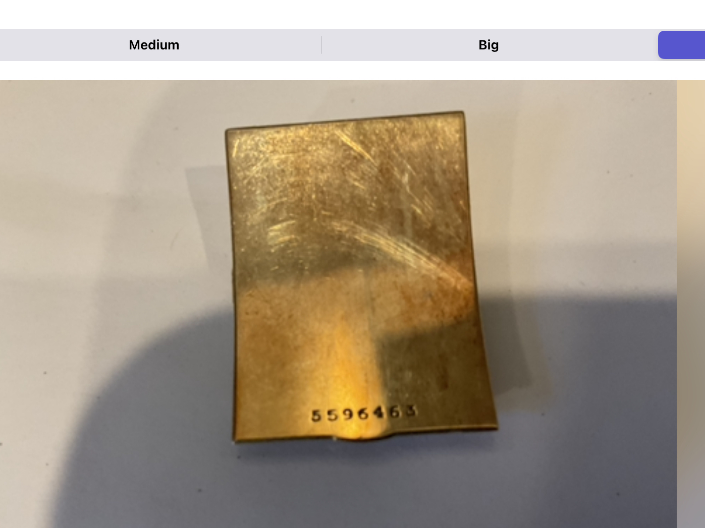

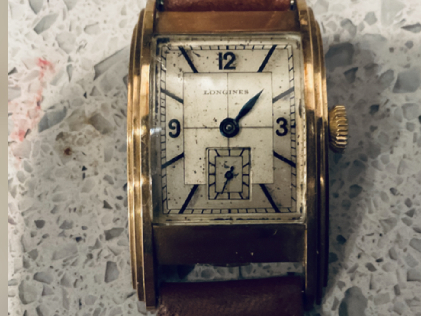

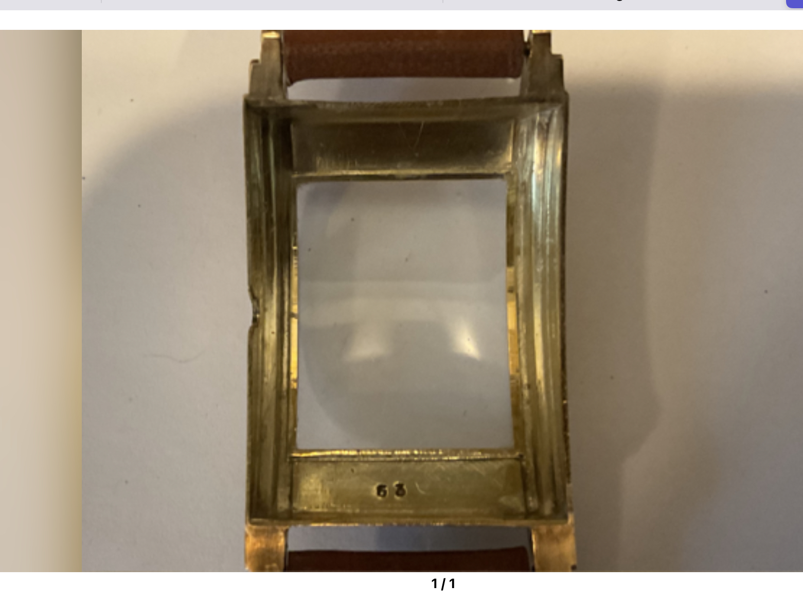

I had been a collector of Hamilton and other vintage; watches Many decades ago I purchased a Longines watch
because I had a attachment to Driver style vintage watches. Besides Gruen and Hamilton I located sn unusual Longines watch…it has matching case and movement serial numbers. I haven’t seen a matching Longines watch.
I checked with the Longines ‘Branding and Heritage’ and they gave me dome basic information.

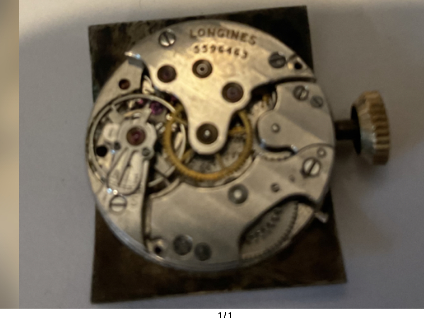

“”The original serial number 5'596'463 identifies a wristwatch in 14ct gold bearing the reference 4100. It is fitted with a Longines manually wound mechanical movement, caliber 8.68Z. It was invoiced on 18 February 1939 to the company Kohn, which was at that time our agent in Prague.””
I have seen curved Longines watches, but this watch has a additional built in addition to make the curve almost feel like it was made for a side wrist mount.
Please, if you have some details ..let me know.. I’m getting old and it’s time to sell but I need some background information that could assist me Thanks

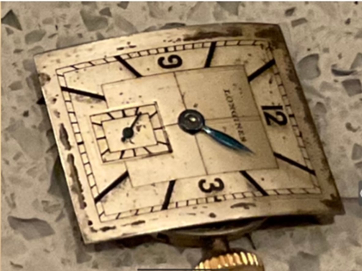

Hi, this is a very nice watch with a wonderful double step case, Is the minute hand missing? I can tell you that ref. 4100 is a rare ref. The movement is origin to the case, you see the movement number on the case back is the same as on the movement. Caliber 8.68 is common to this ref. Another steel cased example ist shown in the large Goldbergers book with the same movement. This watch was invoiced 1938 to London. Your watch has a sector dial which are en vogue in these days. I'm not sure about the crown, maybe it should be more flat. Hope this informations are somehow useful for you.

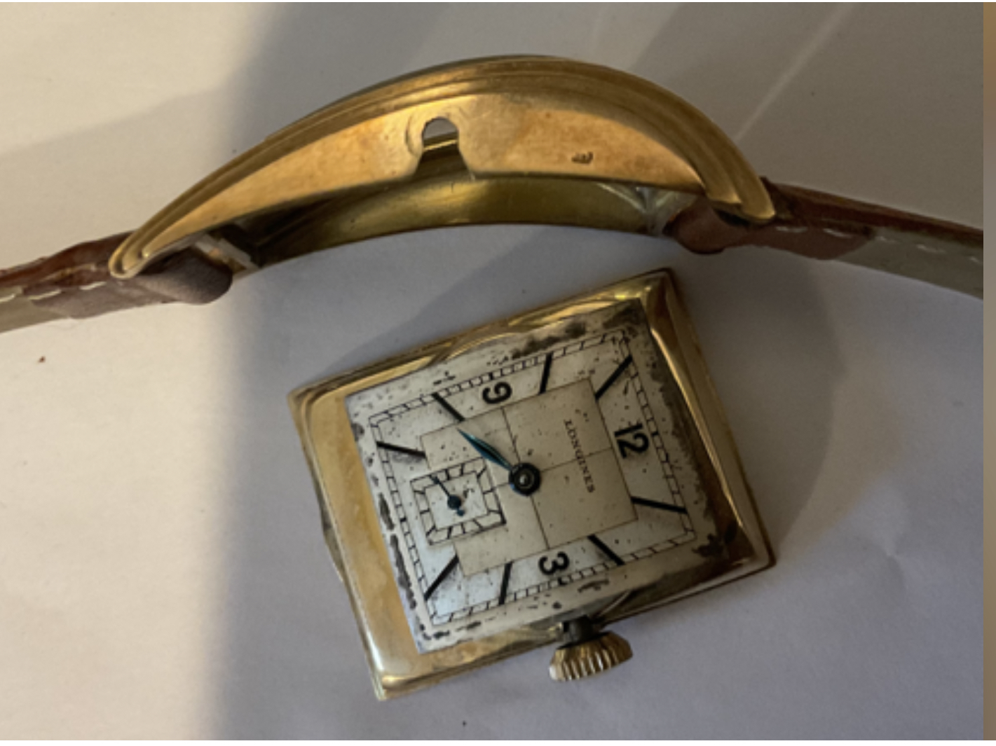

That’s terrific, I had for years assumed it was a rare bird…yes I have the minute hand…yes, I agree. The crown looks slightly oversized.
I remember when I purchased it in the early 1970s the seller was someone I knew..and he said the crown was original…

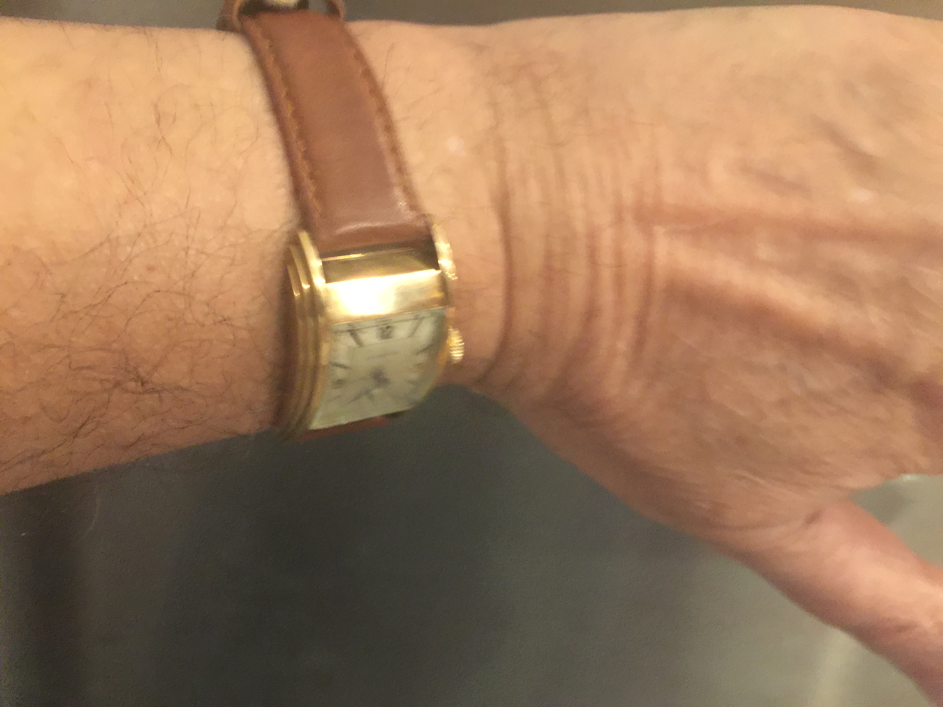

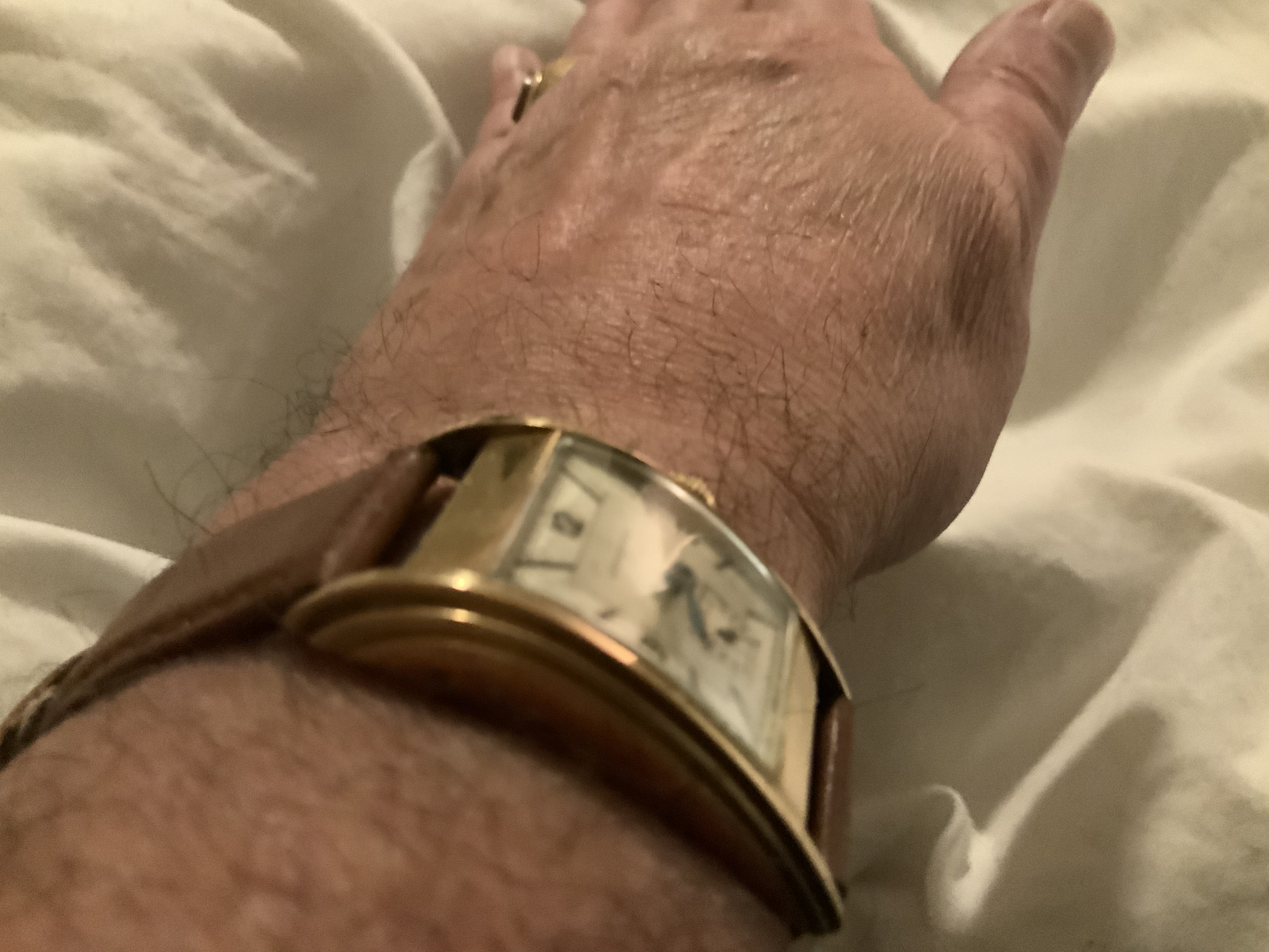

so BlueHands, do you think it was a drivers watch design as I suspect…it does have that extra shape added to the case that makes the curve more exaggerated. And it actually is very comfortable fitting on the side of my wrist… thanks for your assistance…Robert…

Some Longines gold watches, especially chronographs have similar crowns, but I can tell exactly if it belongs to the watch from the beginning.
You can tell it drivers watch, the case design looks a bit like that. Some drivers watches were more curved to put them around the wrist so you needn't change the position to read the time. I love this Longines design, the case is great and unusual.
Surely other experts in the forum can tell more about the crown. I'm quite sure that the dial and the hands are origin to the watch.

That's a gorgeous driver's watch. I would say that the dial and hands are correct; I also believe the crown is correct, though someone more knowledgeable may chime in about that. Why is the minute hand not on the watch? What is its service history?

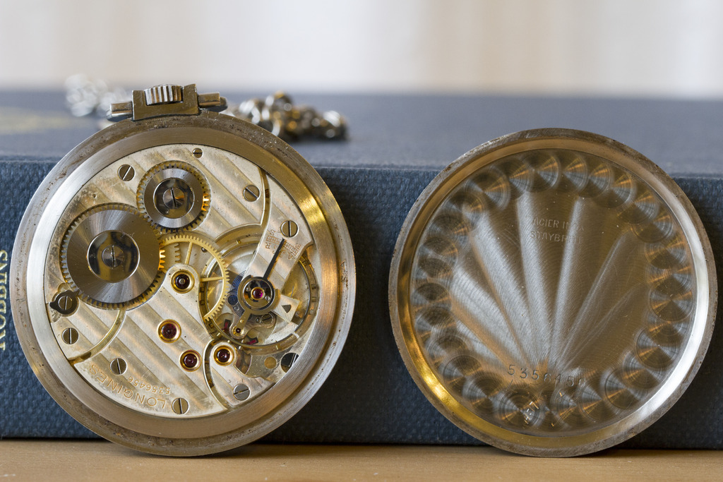

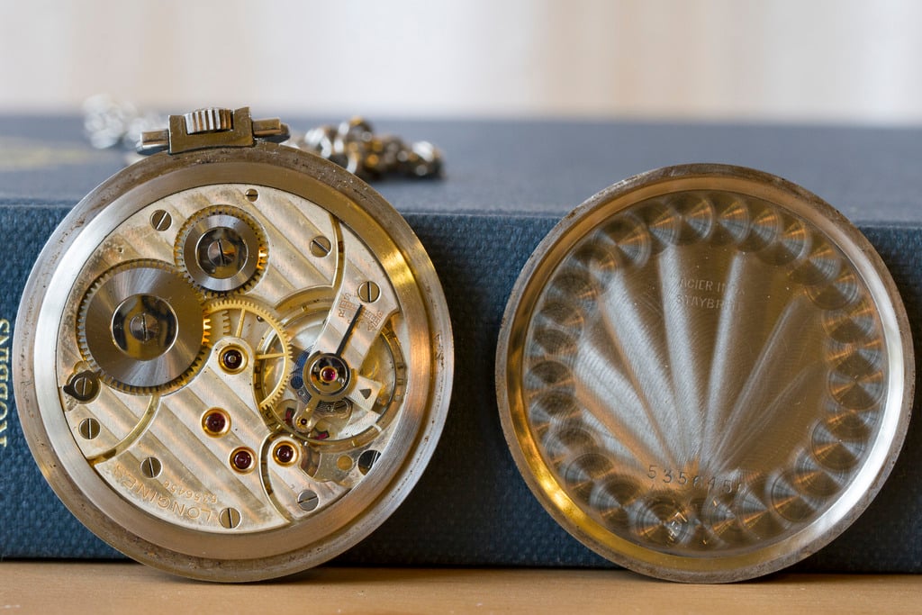

Although not all Longines watches from that period had matching case and movement serial numbers, it is common enough and a welcome sight.

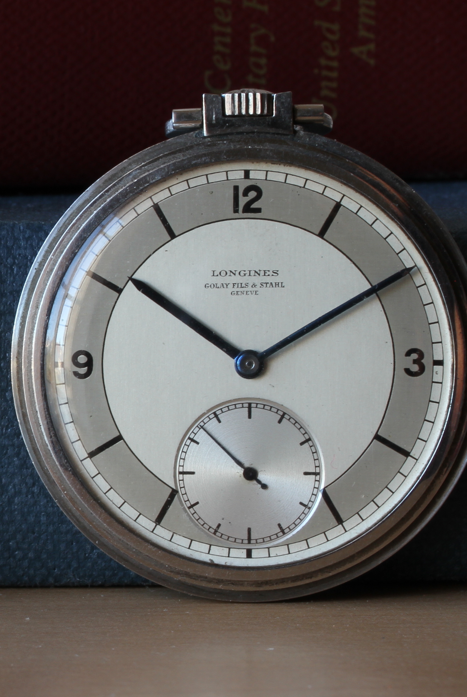

(below, both have serial number: 5356456)
7,690
22,055
Welcome to the forum, it’s a beautiful watch, I haven’t seen the one in Goldberger but indeed a redialed steel one surfaced on the market a few years ago- which was purchased by collector / dealer based in Poland.
Unfortunately I can no longer find my documentation on it, suffice it to say there’s a Patek Philippe model that looks just like it.
I agree the crown is probably a replacement but I think it looks fine.
(below, both have serial number: 5356456) Beautiful case..

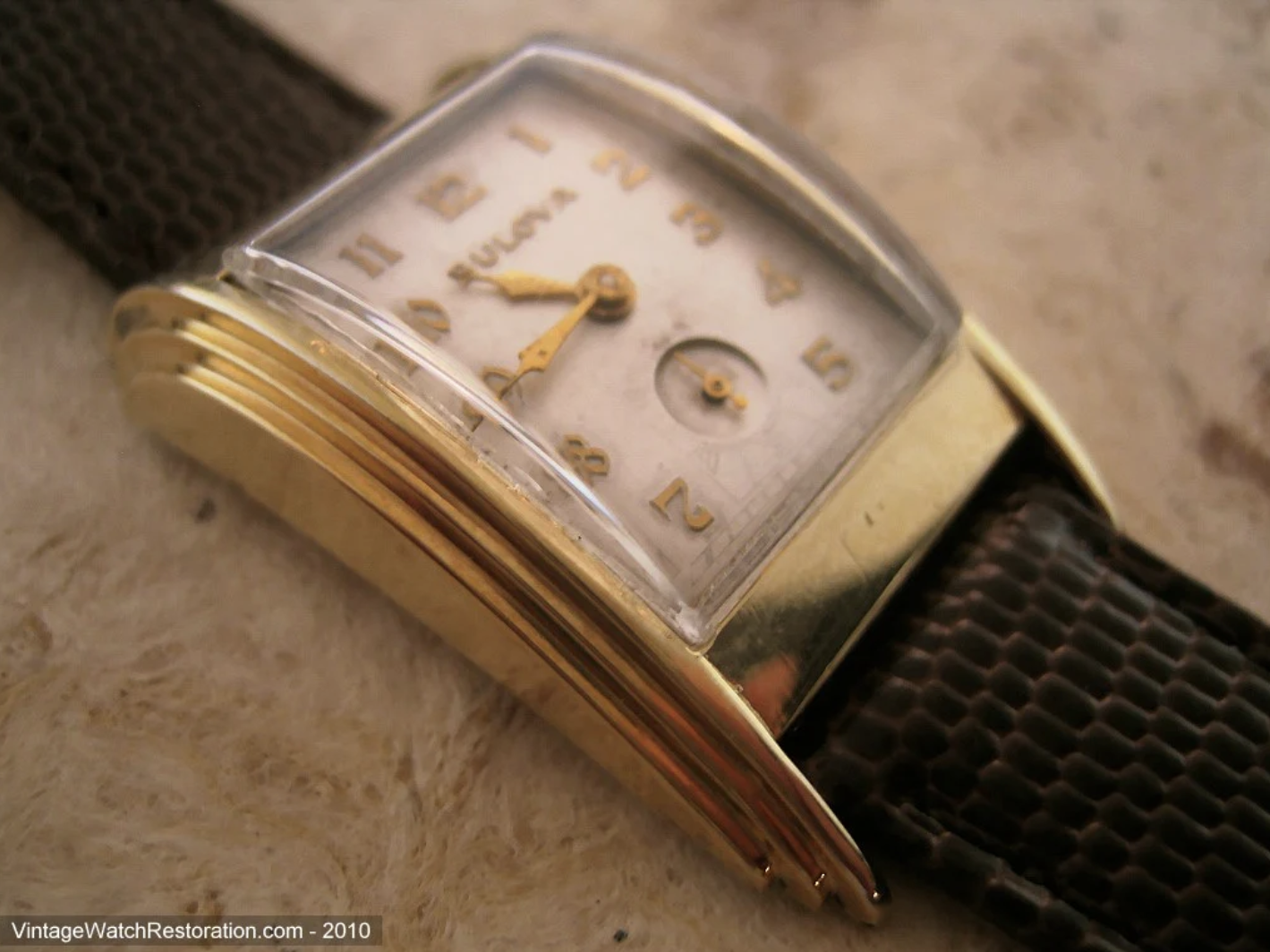

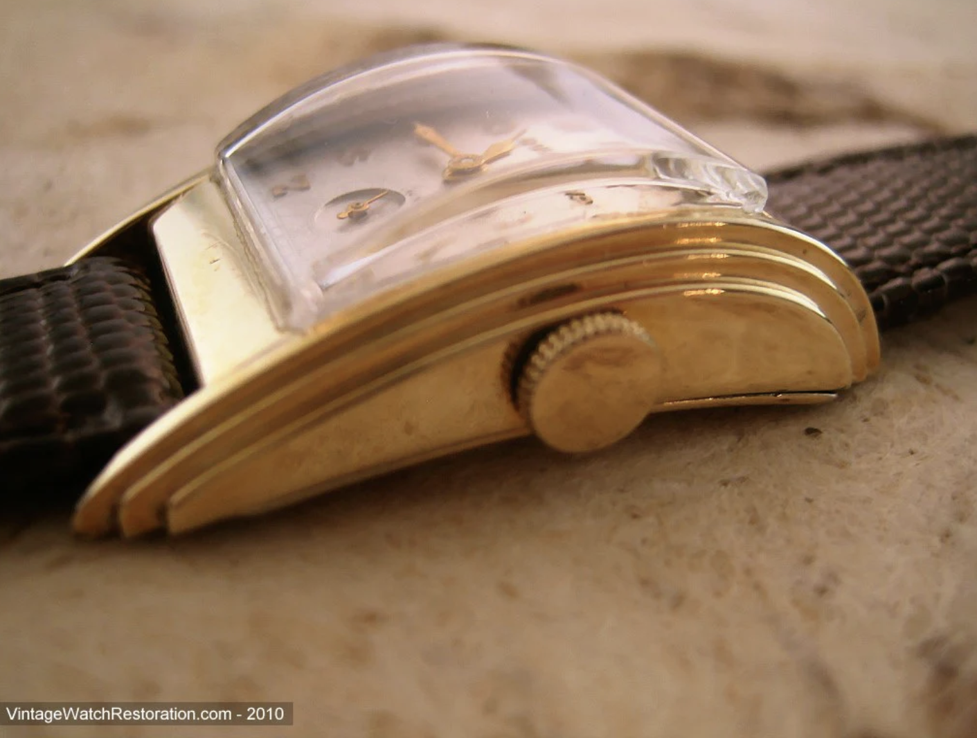

I was able to find the corresponding US market model, called the Inclinex:
https://vintagewatchresources.com/watches/me-inclinex/
The major difference here is that the US model is gold filled, rather than solid 14K or 18K gold.

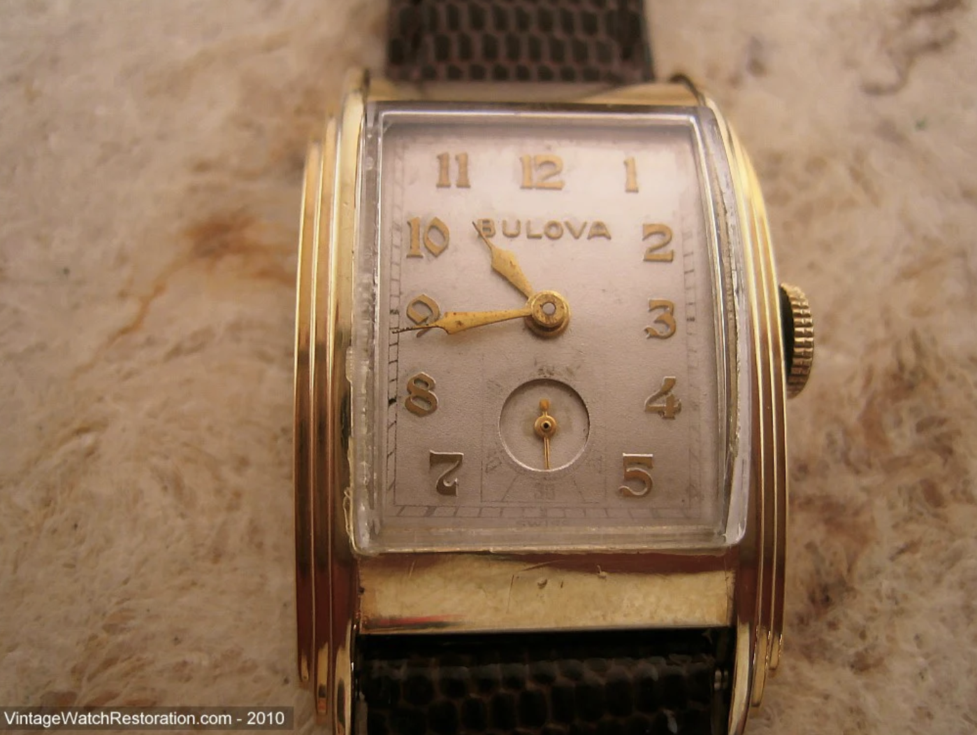

There was the popular Bulova-Curvex,watches and also a popular Gruen-curved-drivers watch styles and now the Unpopular Longines curved/driver watch. All in the late 1930’s.
My thought on these watches is that they were somewhat of a fad just prior to WWII. Clocks in cars were not really common at that time, so the idea had some merit. We really have no idea how many of the Longines version were originally sold or survived.

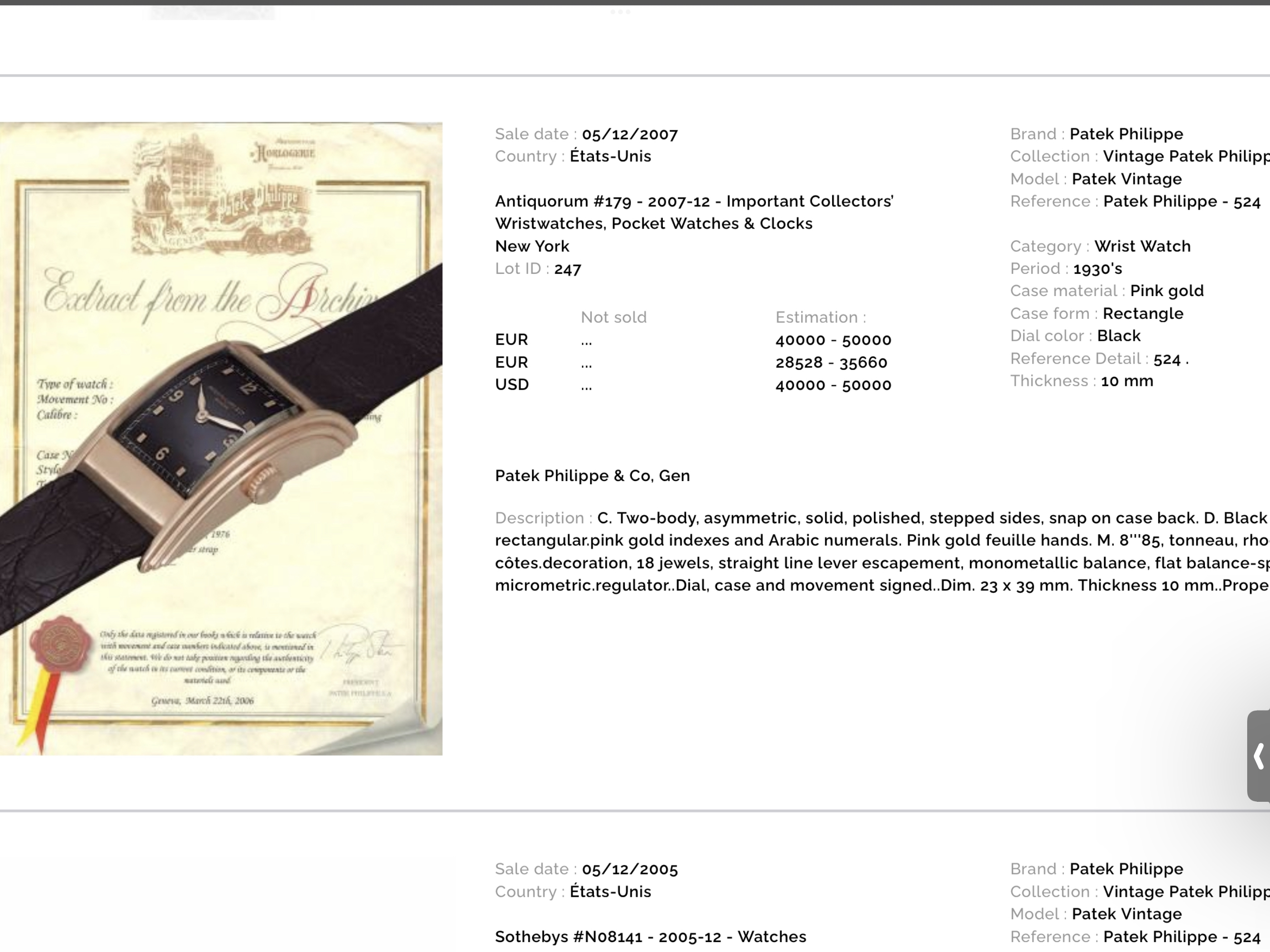

I just spent a few minutes doing some research on your insight and memory of the similar style you remembered from Patek Philippe company.
I came across a ‘Gold Mine’…..Pateck watch company seems to be the originator of this style watch and maybe Longines was just testing a copy of the Pateck watch. .Maybe, to see if it was popular for them to produce.
Look at the many varieties they made of the watch style
PHILIPPE PATEK VINTAGE 524 WATCHES INDEX
https://www.collectorsquare.com/en/watches/patek-philippe/patek-vintage/ref-patek-philippe-524/lpi

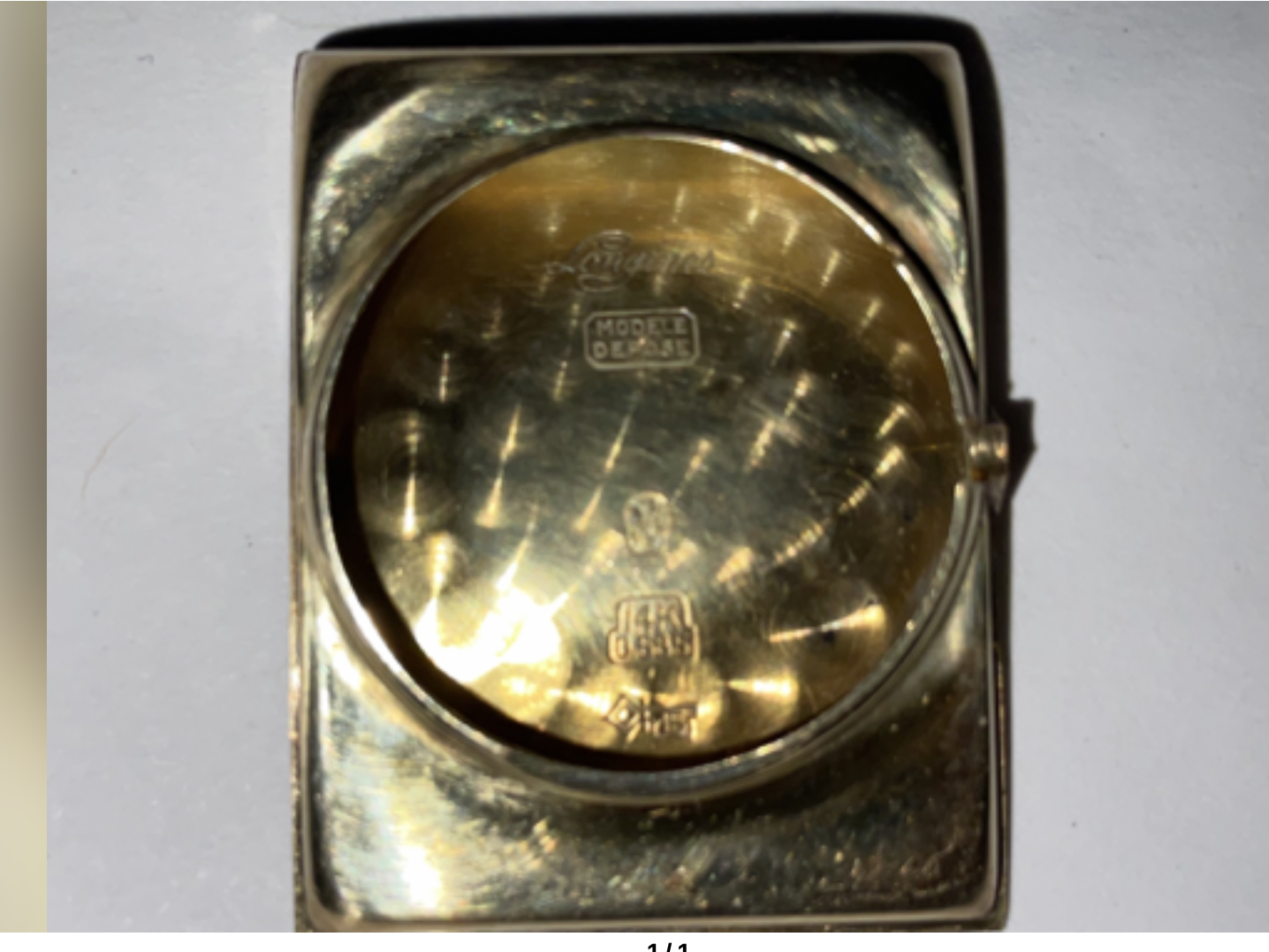

Neat watch, thanks for sharing. The 14K case looks to be in good condition. The marking that looks like a key indicates that it was made by a manufacturer in Geneva for Longines, which was somewhat uncommon. The dial is lovely, as well. It is a variation on what some would call a "sector dial", though the term is overused these days and has sort of lost its meaning/specificity. I am not certain if the crown is correct or not. The style is not typical for a late 1930s Longines.
