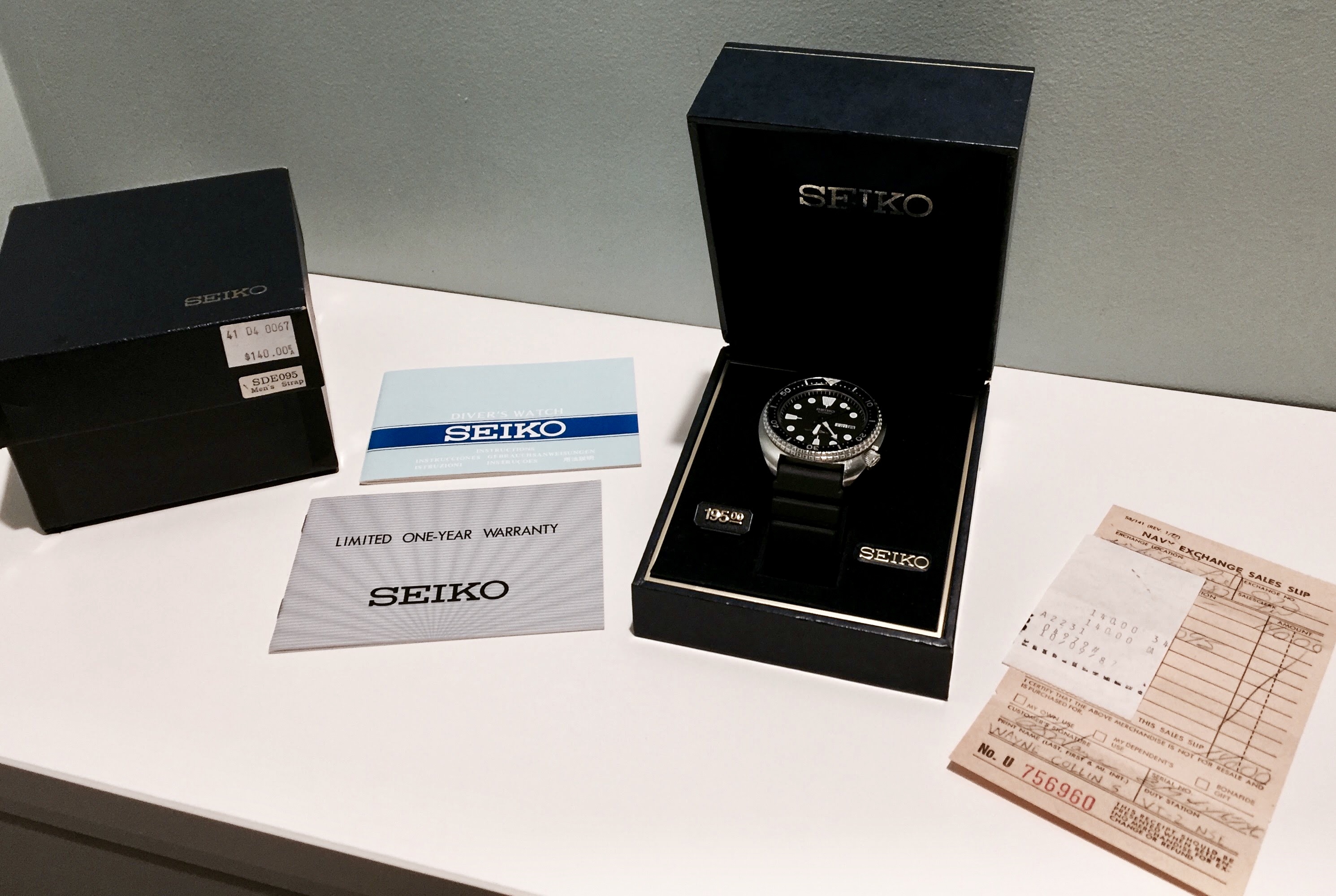

“Longest time without service”
Ummm...I think it was about 28 or 29 years without a service. Why? I’m a super dumbass. It was my beloved Seiko 6309-7049 that I purchased new in 1987 and still own/wear today. It started to run a little slow a few years ago...I thought something might be wrong (gee, imagine that)...so I had it serviced. Don’t worry...I’m not going to go 28 or 29 years without a service again...I’m not a super dumbass anymore...just a regular dumbass.
File pic of my 6309-7049 with its original box(es) and papers...
Bonus gif...
