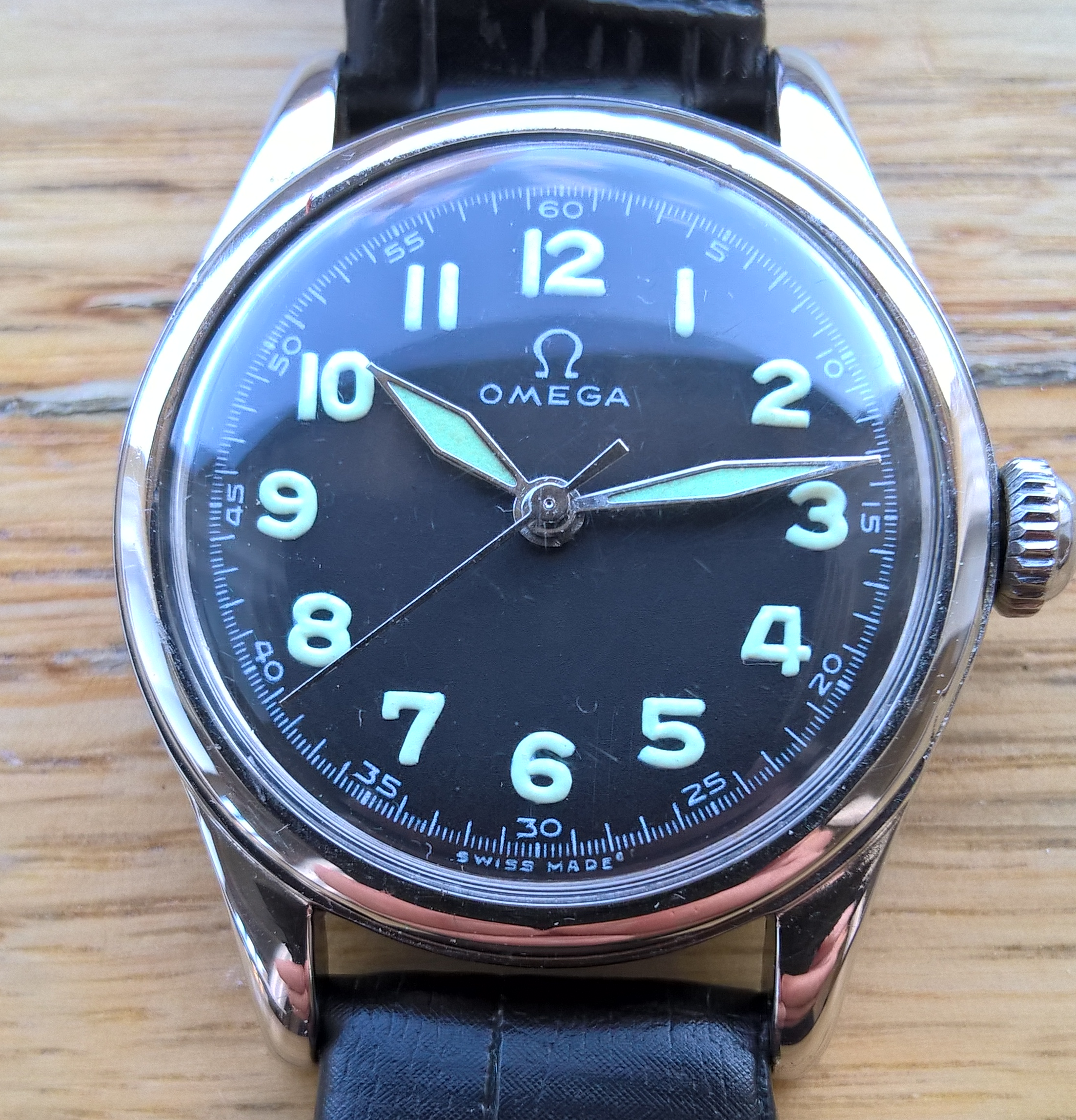

Hi everyone.
I need some help with this 30 T2 watch I want to buy. Might anybody tell me if is there something wrong with it?. I have not much idea and sure some of you can help me. My particular concerns are about the crown, dial and hands.
Thanks in advanced.
I would start with the question "why to you want to buy it?" This is not a particularly collectible piece, so getting all the parts to match may not make much difference in whether you got a good deal. The serial number on the movement and case# indicate those two pieces belong to each other. The case is dated to 1943ish and the movement is 1944ish. The crown does not look correct for the case, but can be ordered here if you wanted to replace it (http://www.ofrei.com/page_147.html). The dial looks to be accurate, might have been redialed along the way at some point. The "A" in Omega is correct font for the era, and the logo is the older version too.
9
Thank you so much 30t2fellow for your help, I really appreciate it. Answering your question, I really like the old fashionated way it looks. I was looking for a everyday's watch with something to tell me. I guess it has to do more with the aesthetic rather than with the value. But anyway, due to I really don't know so much about these kind of watches and I read there are a lot of fakes watches with this calibre I really needed the help of some with your expertise to know a little more about this watch. If I get the right deal, I will get it I replace the crown. Thanks again.
PS: Why do you think the dial might have been redialed?

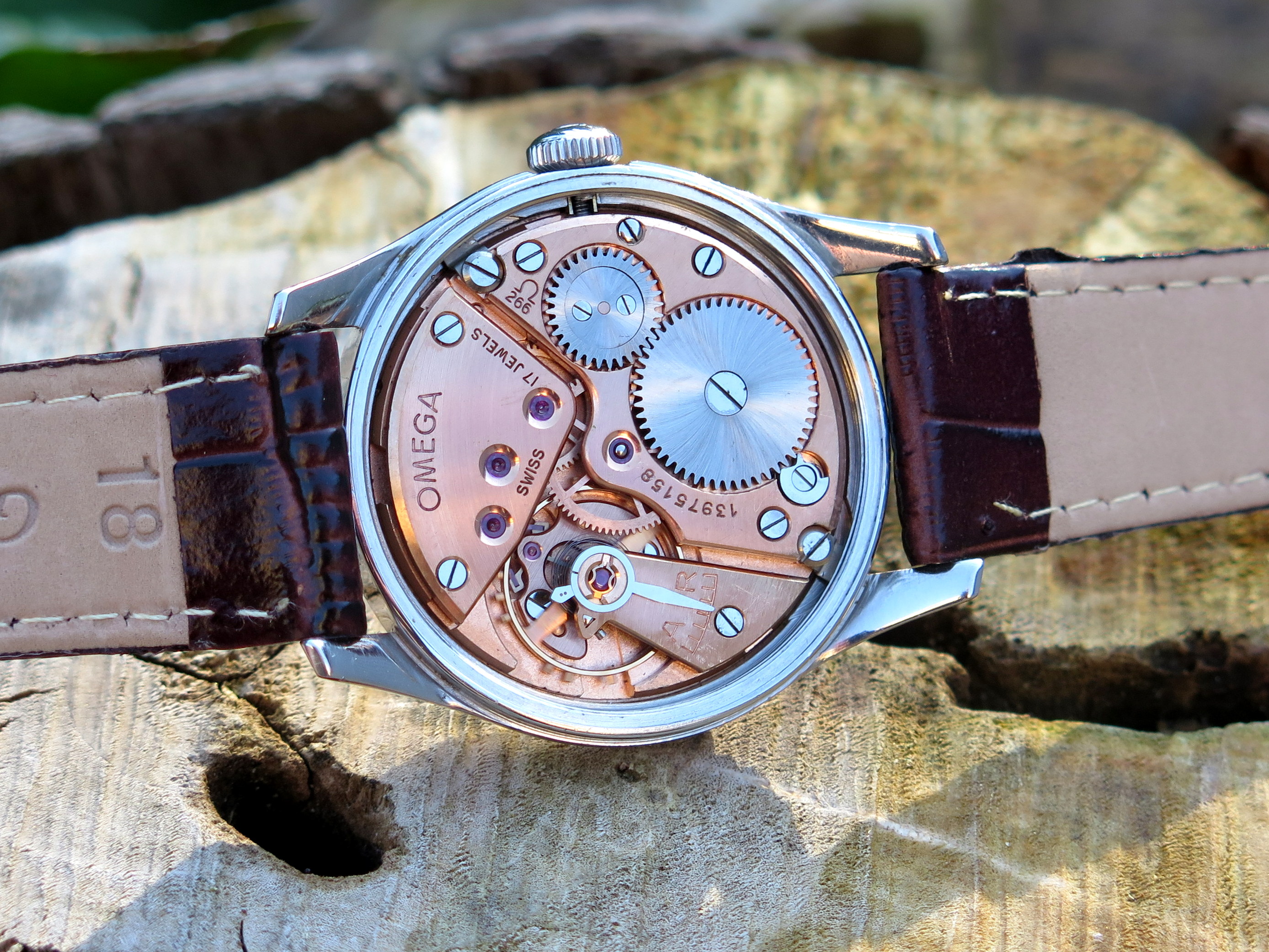

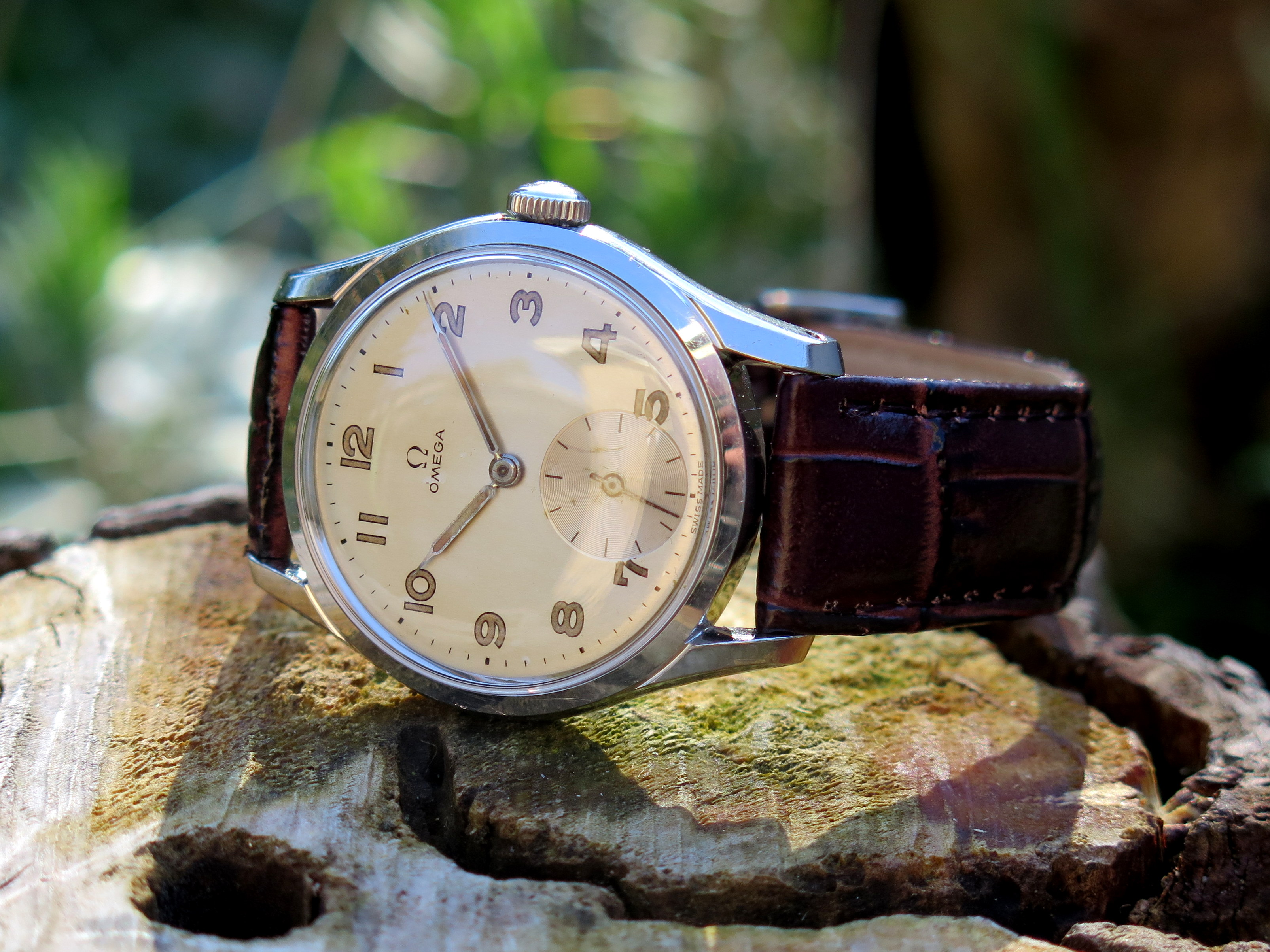

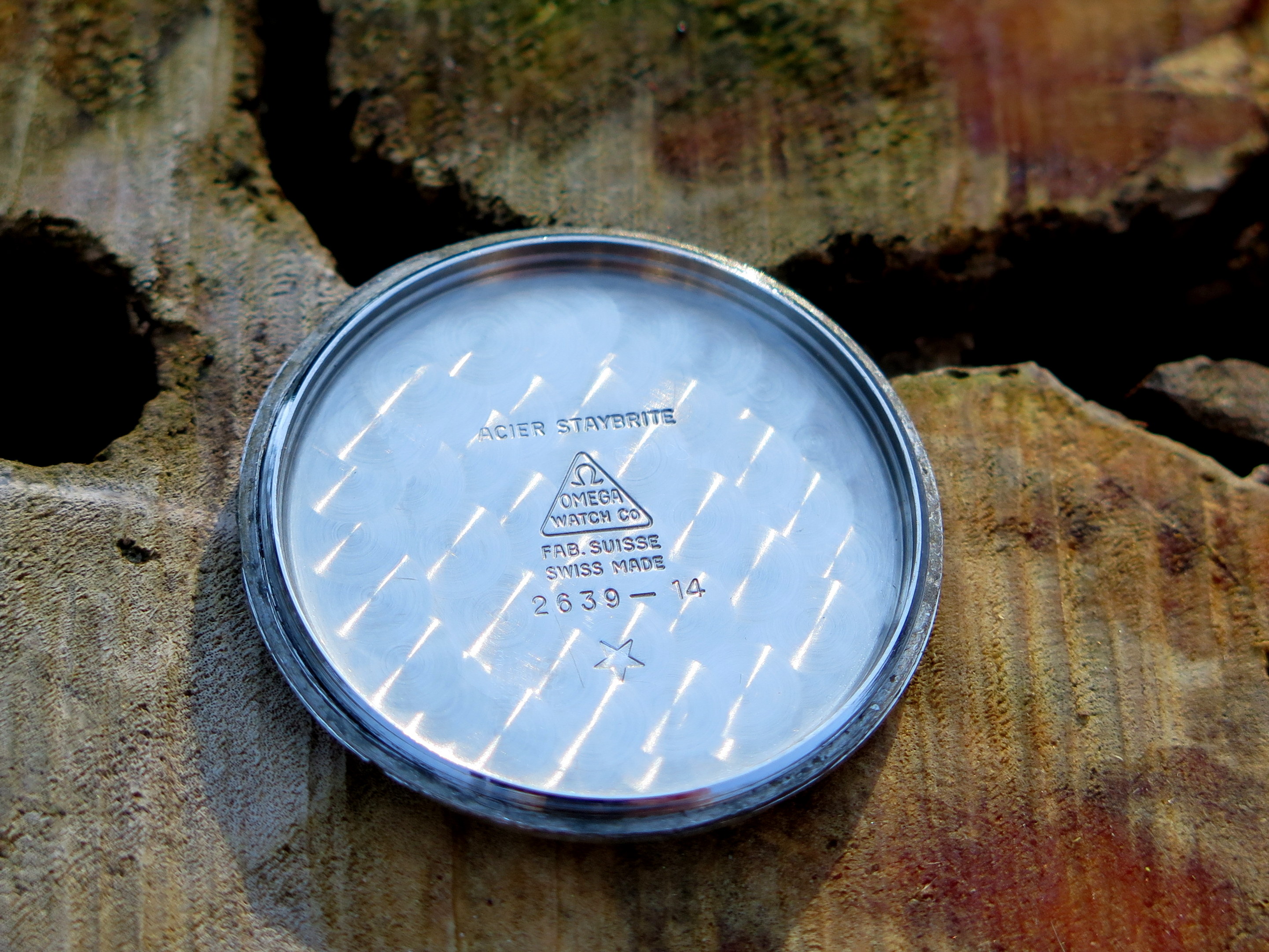

Omega ref. 2639 cal. 266

2639-14, cal. 266 from 1953/54 - In Stuttgart we say "Heiliger BIMBAM!!!"...

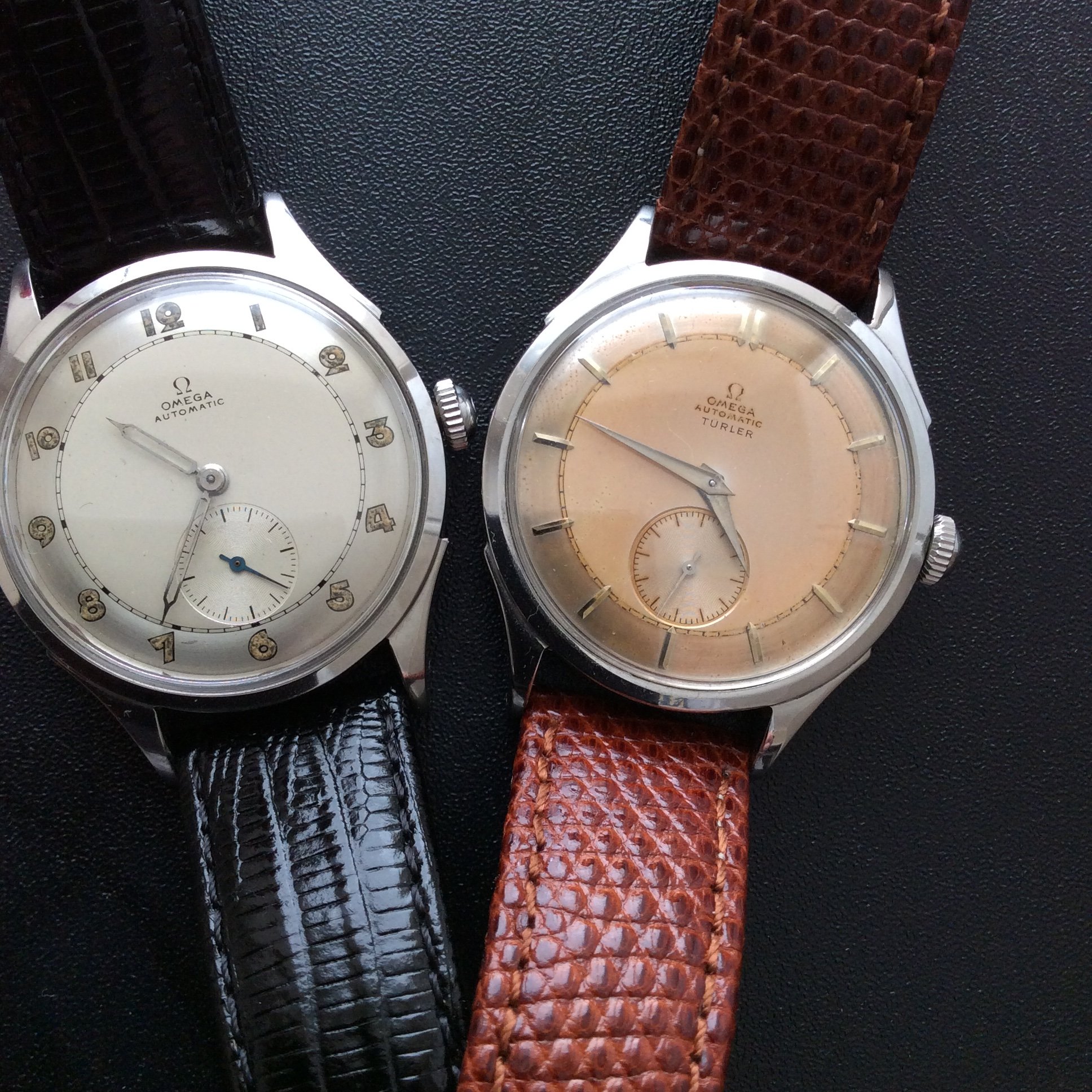

Couldn't dicided which one to post so I though what the hell post them both side by side .
