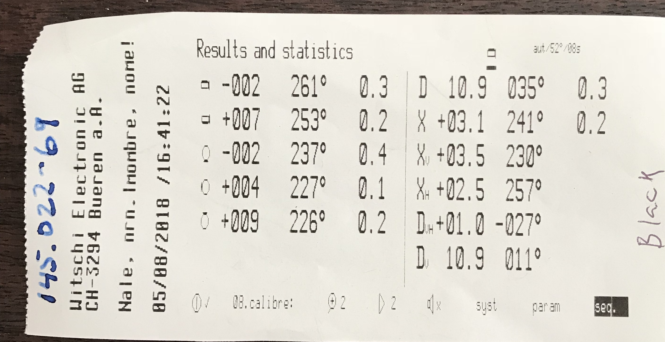

Well, what I see here is a little disturbing to be honest...
First, the timing machine is not set to the correct lift angle - it should be 50 degrees and not the 52 it's set for. This means that the amplitude numbers displayed appear higher than the actual amplitude, by about 12 degrees.
Second, if the numbers on the lower slip are after the service, and taken at full wind with the chronograph off as they should be, then I'm not sure the service was done well. The amplitude numbers should not be lower than before the service certainly so that is a big red flag for me given what I can see. If we look at the dial up amplitude, it was showing 283 before service, and is now 258. If you take into account the error of the lift angle, it's actually only 246, which is far too low for horizontal full wind amplitude on a freshly serviced watch.
Now to your point about the 5 position adjustment, again I have no idea what this brand required on this watch, so I can't say if that meets their standards or not. Having said that, the Delta reading (difference between the slowest and fastest position) is 10.3 seconds after service, and that is a good result, despite the amplitude issues. Omega requires that the 1861 family (1861, 1863, 1866) should have a Delta at full wind no more than 15 seconds, but measured over only 3 positions. So this being measured over 5 positions exceeds that standard easily.
But to put this into perspective, I just finished servicing a Cal. 863 and the Delta over 6 positions was just 6.6 seconds, so adding in one more position and still better than what you have here. So clearly these movements are capable of much better timing than the standards require, so the numbers you have for the Delta are good, but far from being something truly extraordinary.
Hopefully your watchmaker offers a warranty on his work.
Cheers, Al
Very clearly explained, Al. What did you think to the before amplitudes (first picture dated 28 March) where the verticals are higher than the horizontals?
Not stripping the coupling yoke is not going to help with the after amplitudes either... Only about 220-225 degrees in vertical, if it's at full wind, certainly looks like a problem.
To @airansun , did your watchmaker bill you for a new Omega mainspring? Could it be he used a weaker generic?
Cheers, Chris
Nope. This makes me very sad.
I am SO tired of questionable watchmaking. 🙁

@Archer :
What should the amplitudes be? 320’s? I know it’s a stupid question, but now I’m feeling stupid, so it’s appropriate.
The 145.022-69 he serviced returned no better results.
I guess I’m not using him anymore?
We'll, he doesn't have to use a new mainspring at all if the old one is in good condition. My instructors regularly didn't but, from the point of view of not getting watches returned because a mainspring breaks after a short time, I prefer to fit a new one. It just reduces the risk in my opinion (and I think Al also recommended that to me).
Your second watch doesn't look good either but I'll let Al comment. And it's not really not something you should feel stupid about as it takes time and training to understand all of this.
Good luck and let's hope these are not full wind/chrono off figures and all is well, Chris

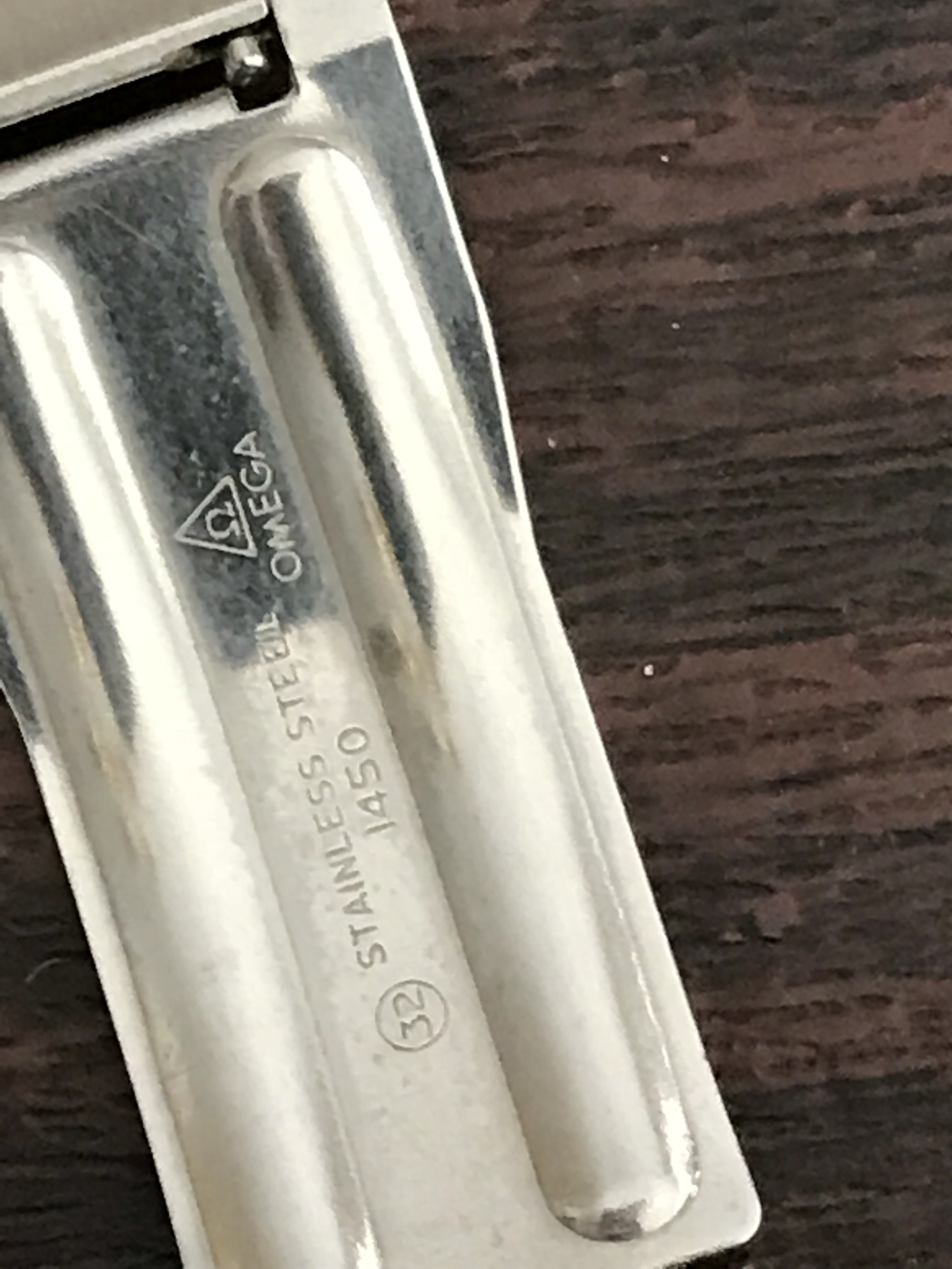

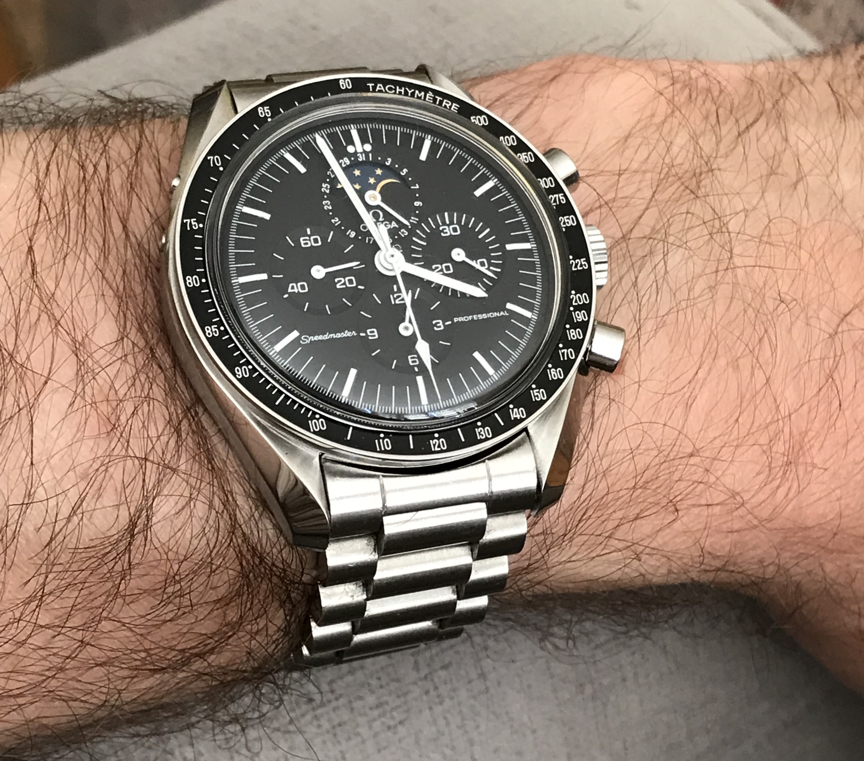

I put the 1450 bracelet on the Lemania-Omega Speedymoon that I sourced on eBay months ago. Had to file down the 808 end links a little. The link pins are cotter pins for goodness sake. Worse than pins in sleeves or those tiny screw caps. Anyway, looks nice I think.
Maybe it’ll all be okay after all.

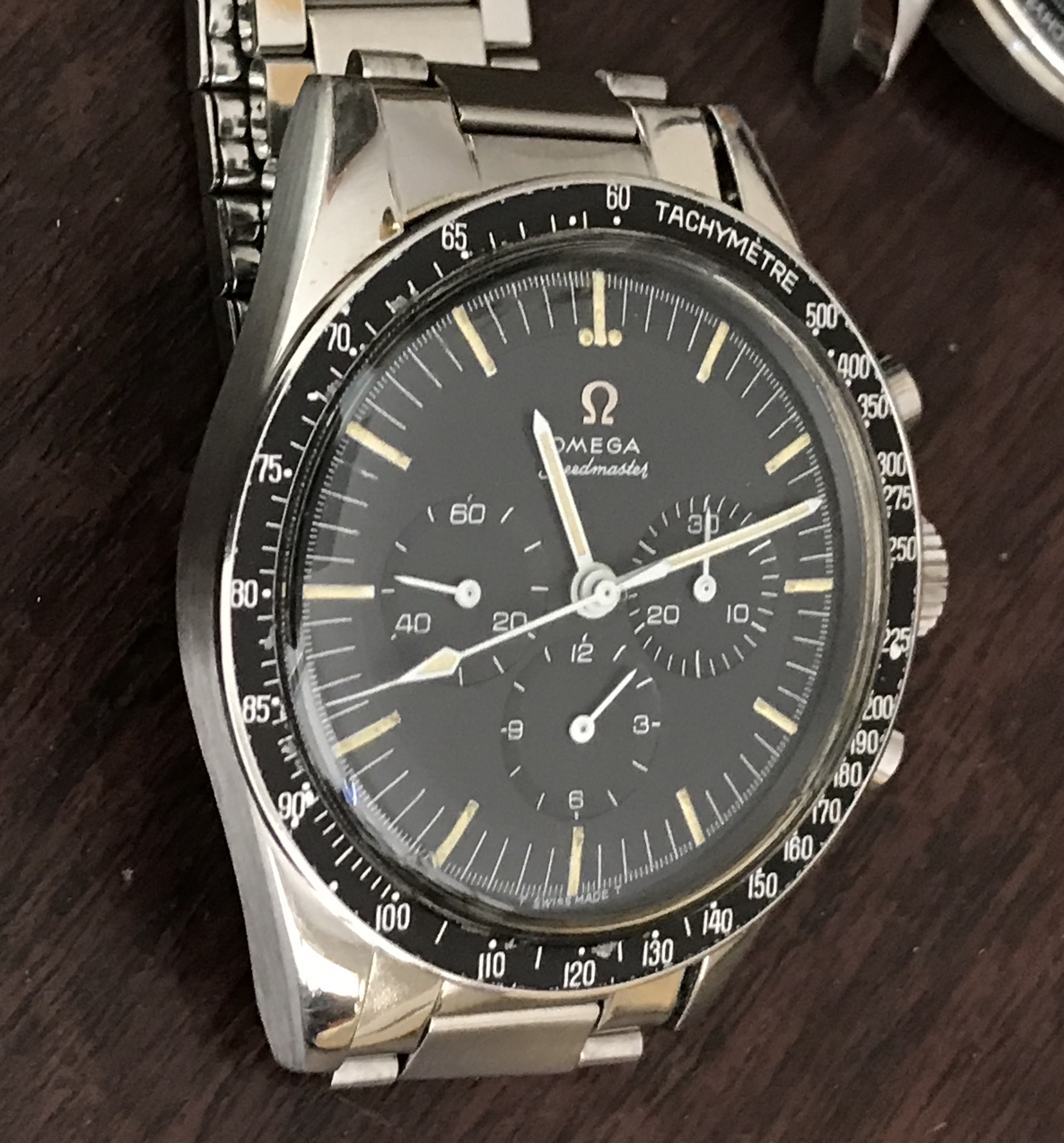

Oh yeah, what about the spade ended chrono hand! 🙄 Whole time, nobody pointed that out.
Definitely odd, but given the after results were so bad I didn't bother commenting on that aspect.
@Archer :
Just to be clear, there is no officially required amplitude at full wind - Omega only calls out for a minimum amplitude measurement 24 hours after full wind, and for the 1861 the amplitude must not drop below 190 degrees in any position - the lowest amplitudes are usually in the vertical positions.
But if you look at enough watches, you quickly see that full wind dial up amplitudes should be much higher than what these watches are getting.
320 would be a bit high and at risk of rebanking, but 290's or 300 would be fine. I would even say fully assembled that 280's is still plenty, but 240's is certainly not. I just went back and looked at the last dozen or so Speedmasters that I've serviced, and only one was below 290 full wind horizontal, and that was in the 280's.

This watchmaker was the two-month guy. At least he gives me these printouts and the photos of the watches in pieces. These were the first two watches I got back from him. Btw, the Lemania-Omega Speedymoon gained about four seconds in about 24 hours, worn on the wrist.

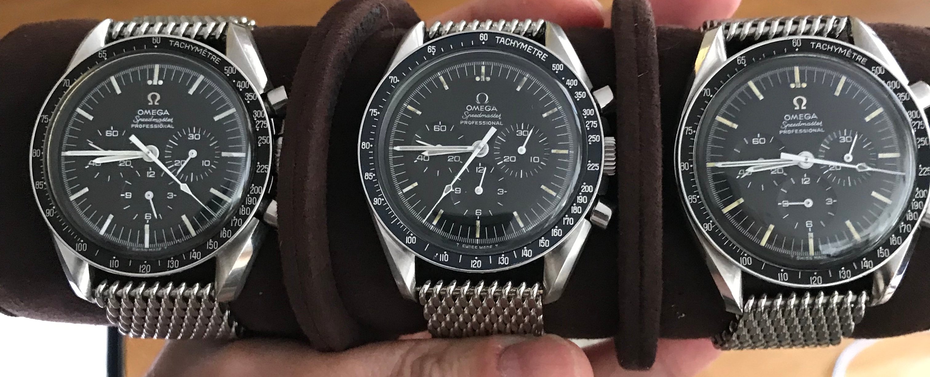

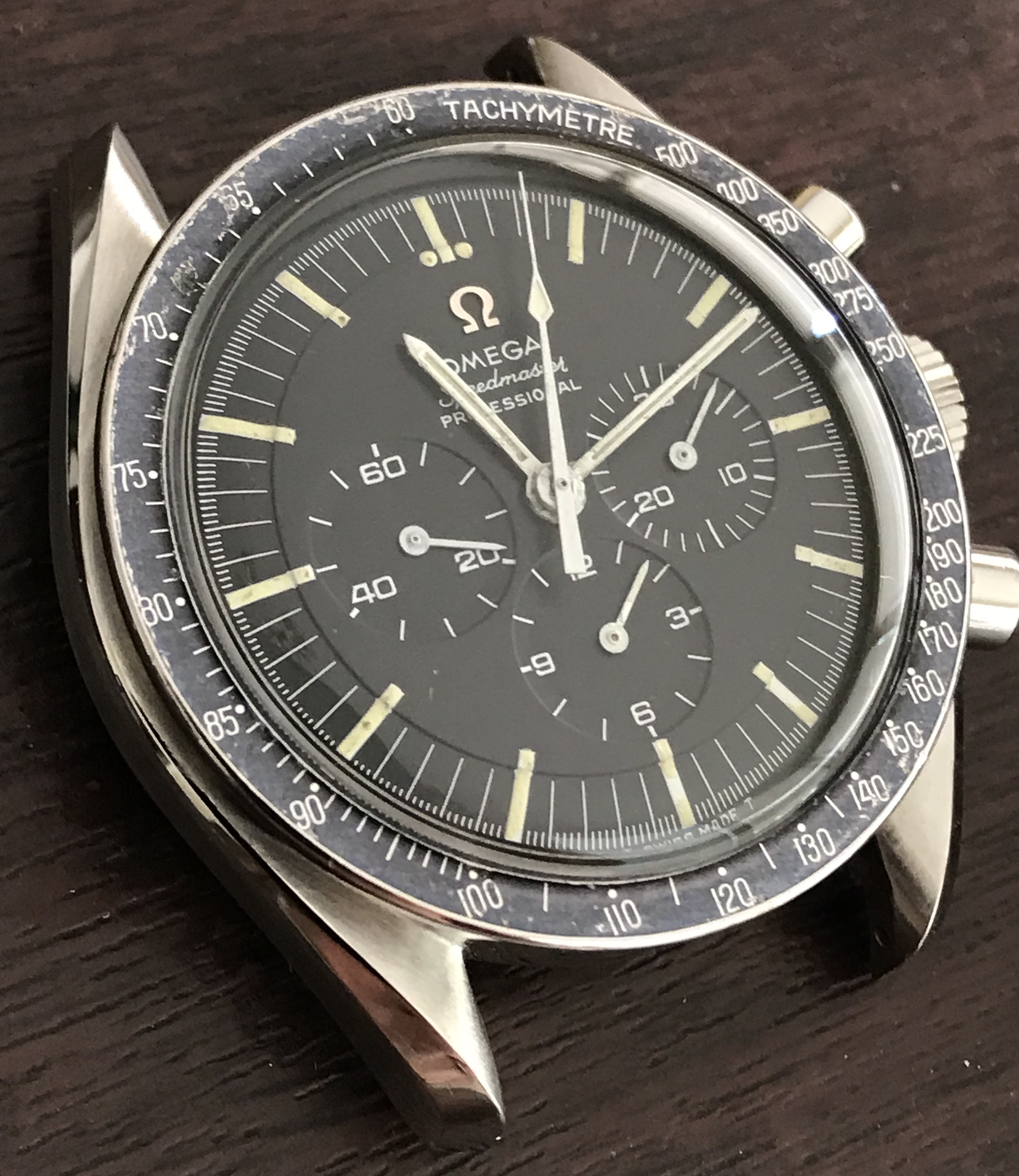

For the good of the order and because this threads needs another photo, here’s, from left to right, my -67, -69 and 145.012-68 this morning. Nobody stopped overnight. The -67 hasn’t been serviced yet. Both the -68 and -69 came back from service yesterday, the former from the older guy and the latter from the two-month guy.
Btw, notice that the -69’s dial is a little brown and the bezel is a little blue. This was the watch I was going to scavenge at one point. Silly me.

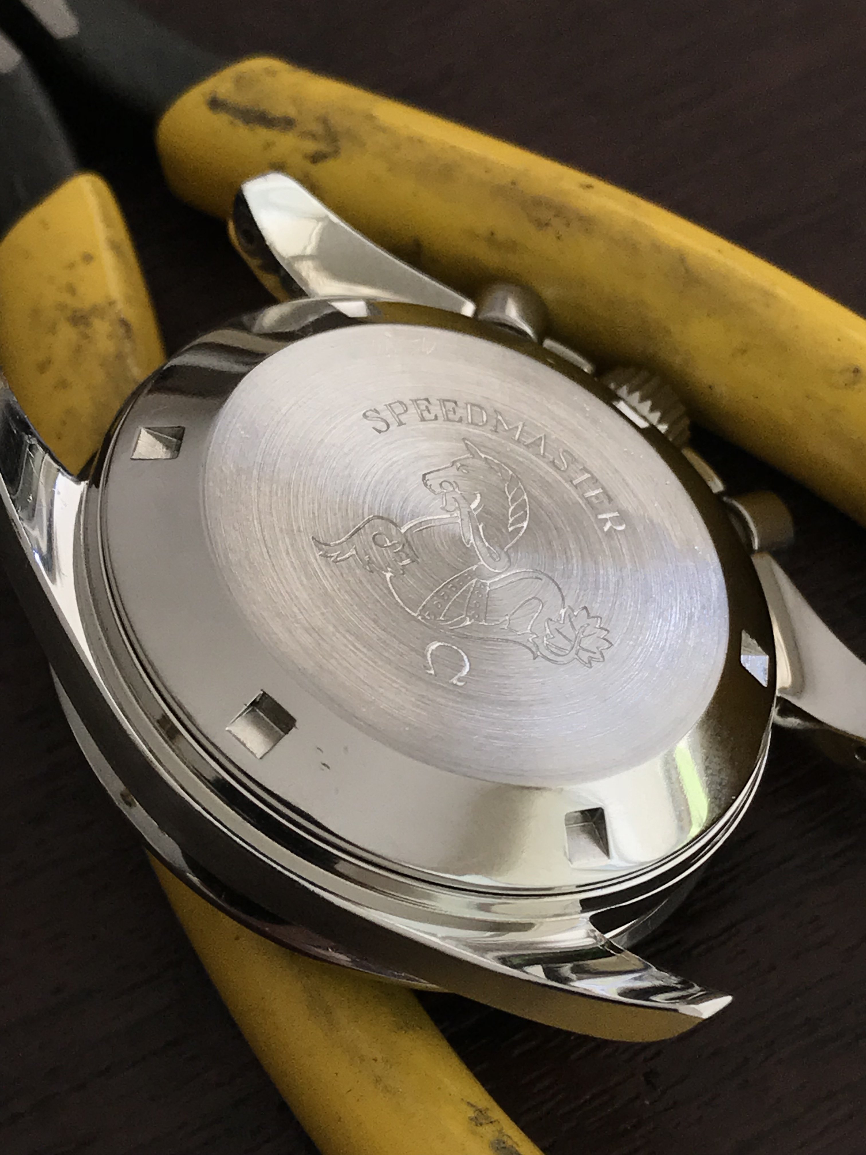

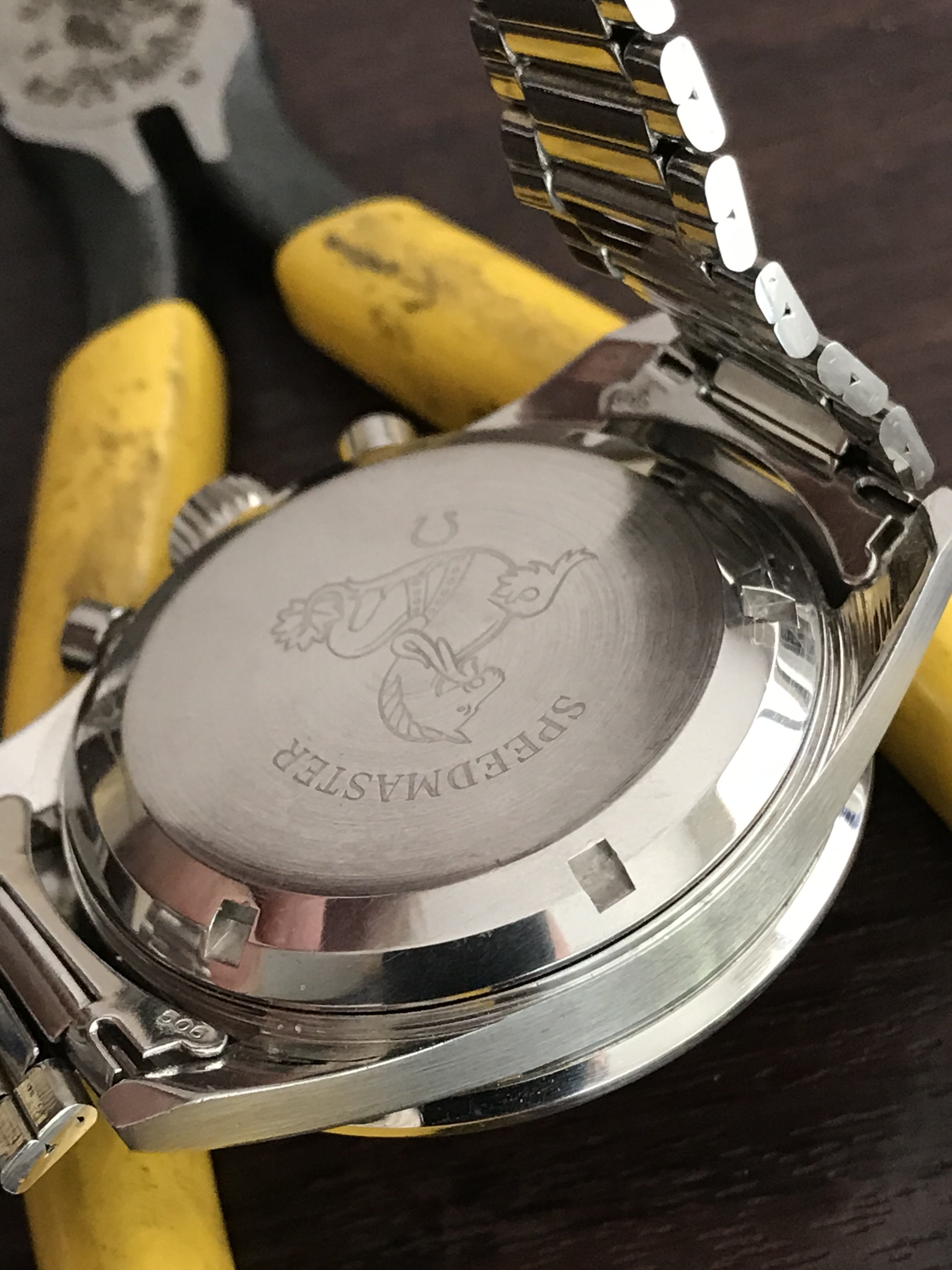

Gotta love those casebacks.
