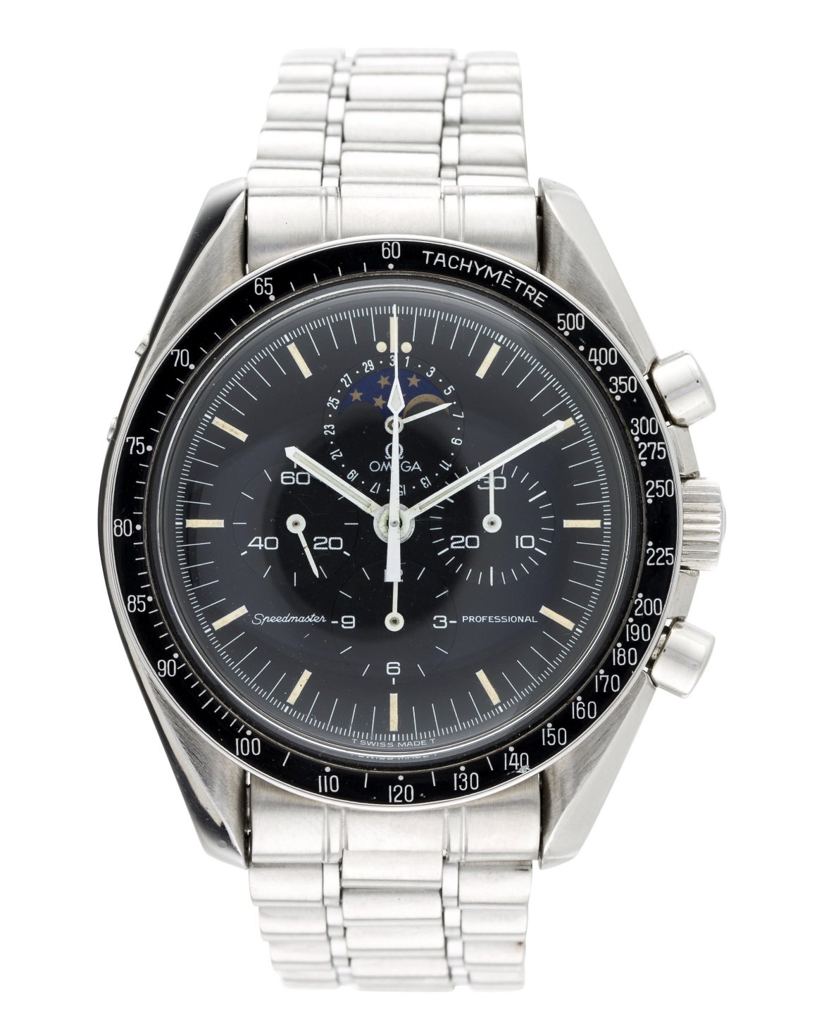

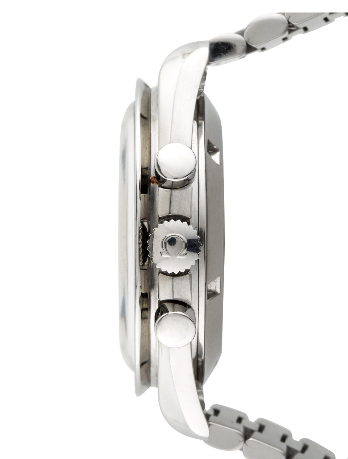

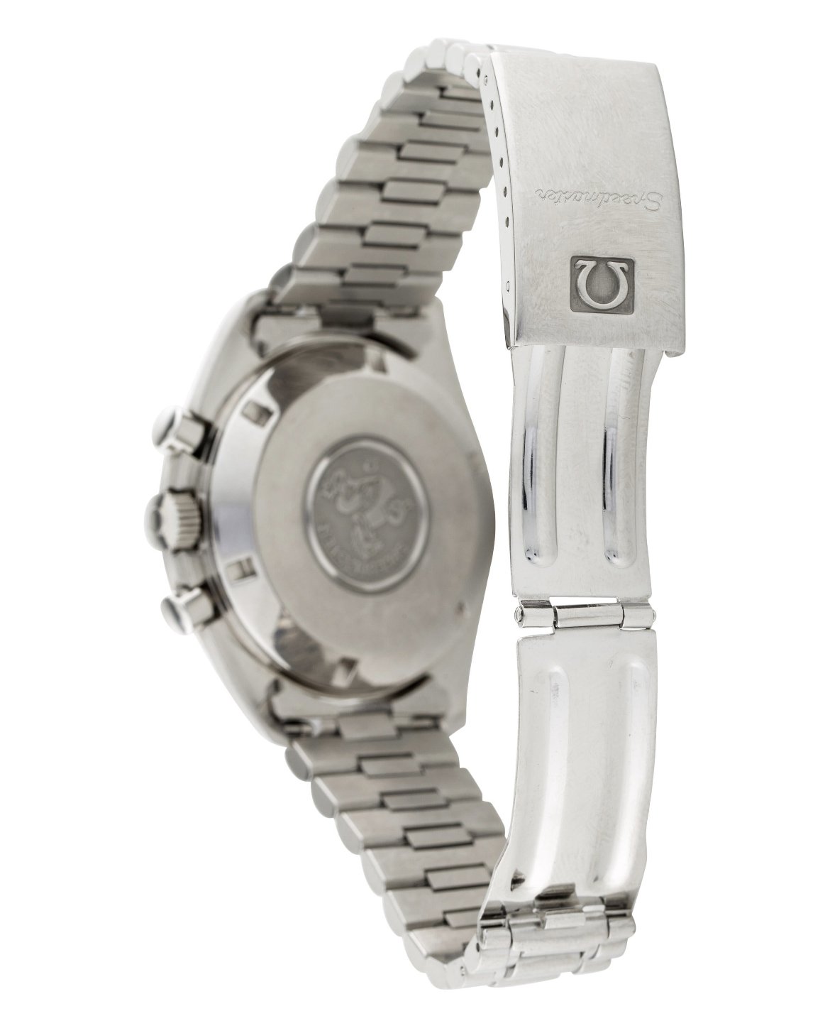

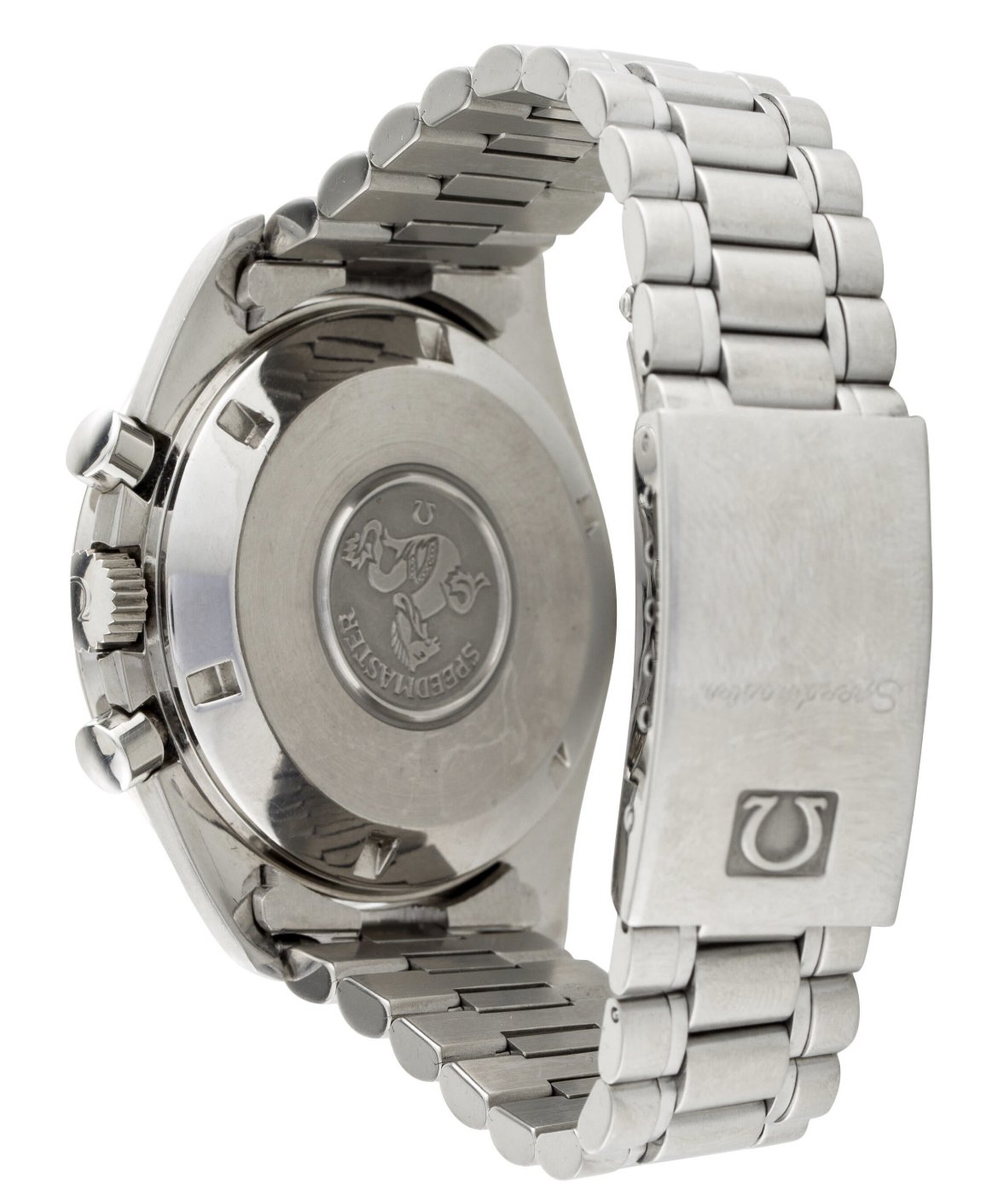

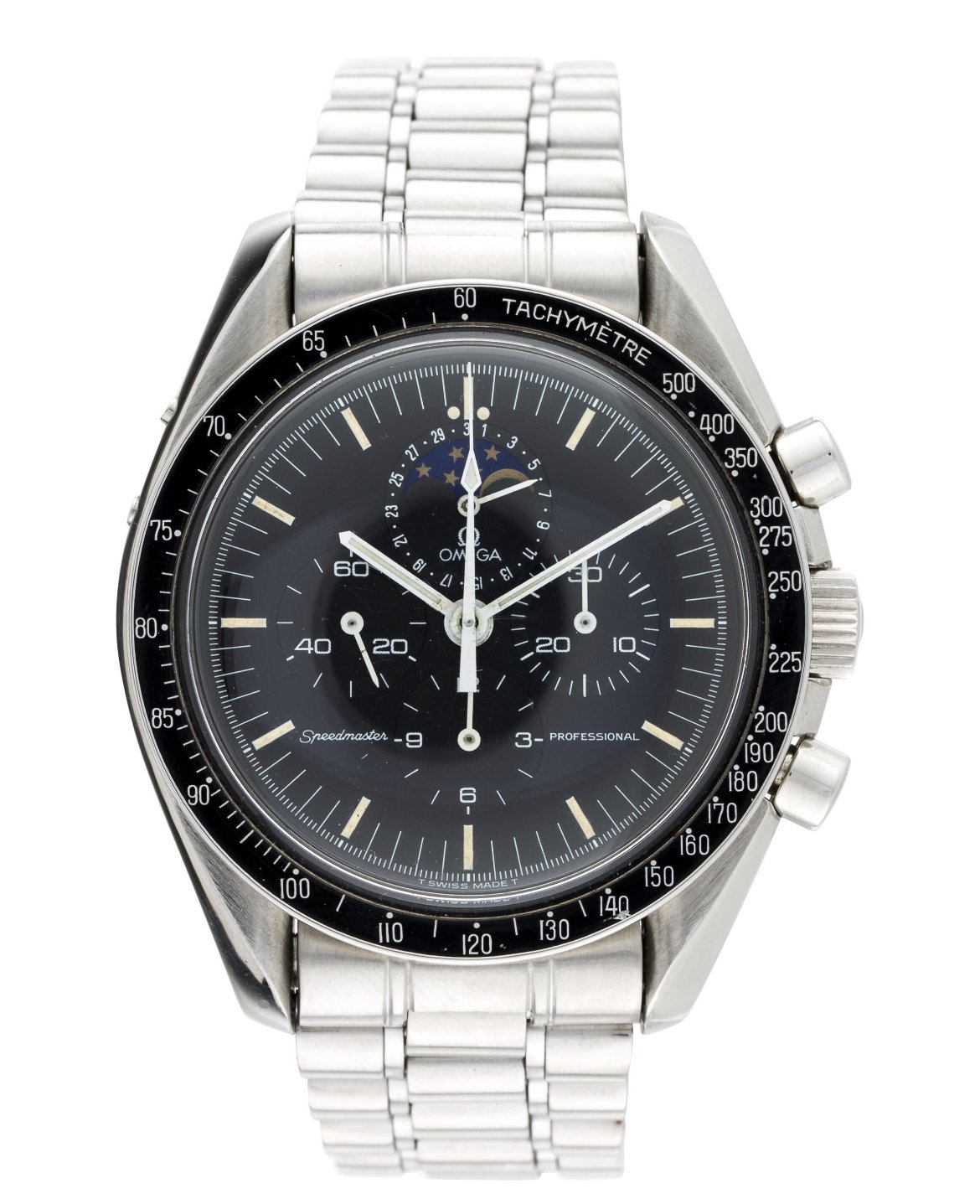

Hi all,
I was hoping to get this forum’s help on a Speedymoon 345.0809 that I’m looking at from an online seller. The serial number is 47*** and the bracelet is a 1479 which suggests it was a later (1988-1989) release. The bezel seems wrong with the accented E in Tachymetre. I’m guessing it’s a replacement with a later bezel. How much should this affect value?
Does anything else stand out as potentially incorrect / frankenwatch? (I know I should get pictures of the movement, inside caseback, etc. and I am asking for these.) Do these cost more to service than a standard 145.0022 from this era? I really appreciate the help!

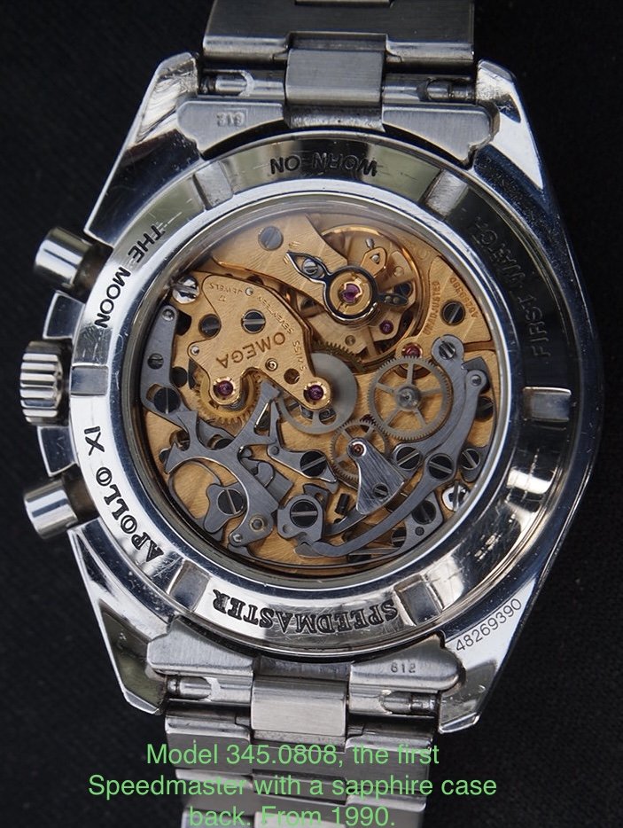

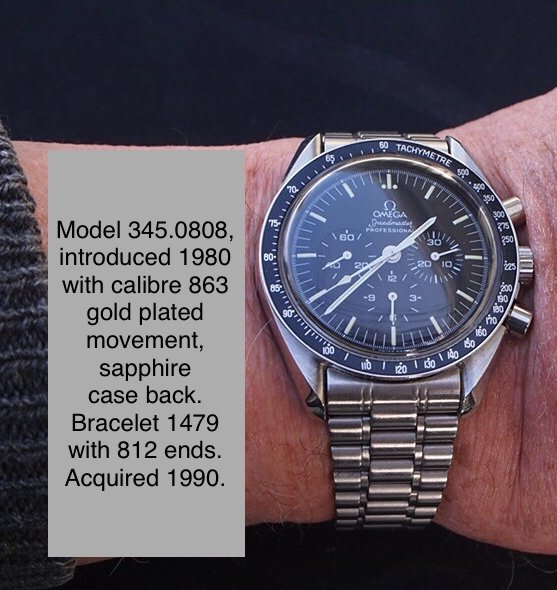

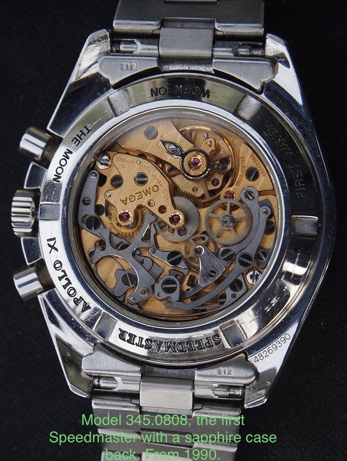

My Speedmaster 345.0808, one owner (me) since 1990. Only difference is that mine has the calibre 863 (gold plated) movement and sapphire case back, and no calendar or moon phase. Same bezel and bracelet as the subject watch. So, no problem with the subject watch.

Well, that bezel is indeed wrong for this model. That said, it’s not a later service bezel, but a vintage DON. Quite valuable (if not fake). At first glance, it looks good and could be worth a lot more than a matching DNN would.
Agree with your assessment, except for the bezel… 😉

Thanks @Canuck ! The difference I was noting is the accent mark over the first E in Tachymetre which yours does not seem to have.
4
Thank you! Any tips on how best to verify that it's a vintage DON? Interesting mod for someone to make on an already rare watch.

As they are a clothing consignment store, and this watch is under consignment, I'm curious if they will open it up for you. Take this with a grain of salt, but this listing is advertised as requiring a service as it keeps time poorly. They have other listings that are advertised as "keeps time within spec" but regardless, it's always wise to factor in the cost of a service when purchasing a vintage watch. From a quick search, the price on this one does seem significantly less than other readily available examples (as much as half in some instances). That could boil down to them clearly not doing any research or "due diligence" and possibly not knowing what this is... As they have beat up pieces with highly unrealistic prices, I would wager they just don't really know what they are doing.

Interesting! Do you mind saying more about how you can tell? They looked similar to me to what I’ve seen for instance here: https://www.fratellowatches.com/speedy-tuesday-the-first-speedmaster-professional-moonphase-1985/
Im no expert on these, but something does look off about the ends of the hour and minute hands. From others I’ve seen from a quick search the hands should be more pointed. Where as the ones from the Original Post look more like Speedmaster Professional Mark 4.5 hour and minute hands. But as I said I’m no expert so here’s a link to one of Chuck Maddox’s writing on the reference. His writings are a really great resource for anyone looking to learn more about Speedmasters.
http://chronomaddox.com/speedmaster_moonphase.html
Edit: Was researching something elder and saw this article on this reference that may be helpful to you researching.
https://themasterofspeed.com/2019/04/25/1986-speedymoon-345-08-09/
