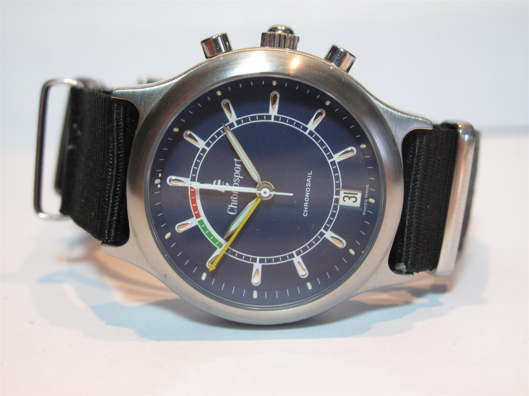

Yes, the 5270 present in the Chronosport Chronosail. 28800, Hand Winding, Sweep seconds and minutes, date (at 6) and (although not a movement complication) this watch also used a Doppelzeiger to give 10 minute countdown as well as a traditional chrono minute indication.

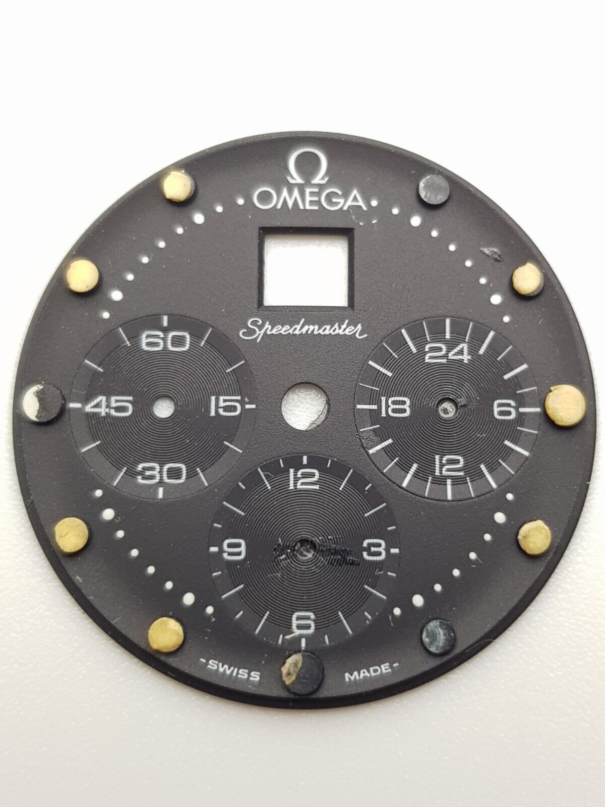

This thread lead me to buying an Eberhard chronograph as mentioned here earlier. I received it yesterday and I would like to revise it.
I'm still looking for a parts list, exploded view, repair manual, quartz test procedures... anything that could be of help with a revision. So if anybody could give me a tip where I could source any documentation ::psy::
In my search for any documentation I stumbled upon an interesting item on sale on eBay.(search for "Omega Speedmaster Prototyp Dial - Parts") It is an Omega dial that clearly is meant for Lemania cal. 181 and it has the word 'Speedmaster' on it. It makes the Omega prototype mystery even more exciting.
