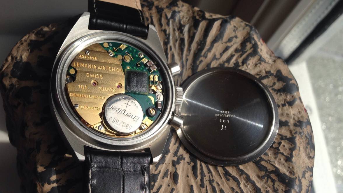

Omega is supposed to have a prototype watch on display in the museum that was designed to use this movement. A Speedmaster model. The caliber was designated 1660 and reference 386.0815,
This is Chuck's "Lemania" branded one:

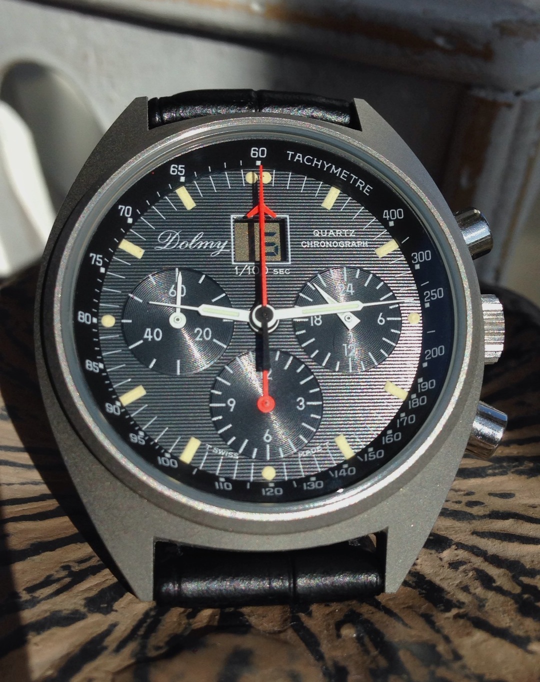

Unfortunately mine is not labelled as a Lemania, but it is the exact same model apart from that.
Dolmy was a Swiss watch trader that sold some Lemania 5100 and similar watches under their own brand.
All Dolmy badged Lemanias I have seen so far is even using Lemania dials, only with their own name inserted. This seems also to be the case with this one!

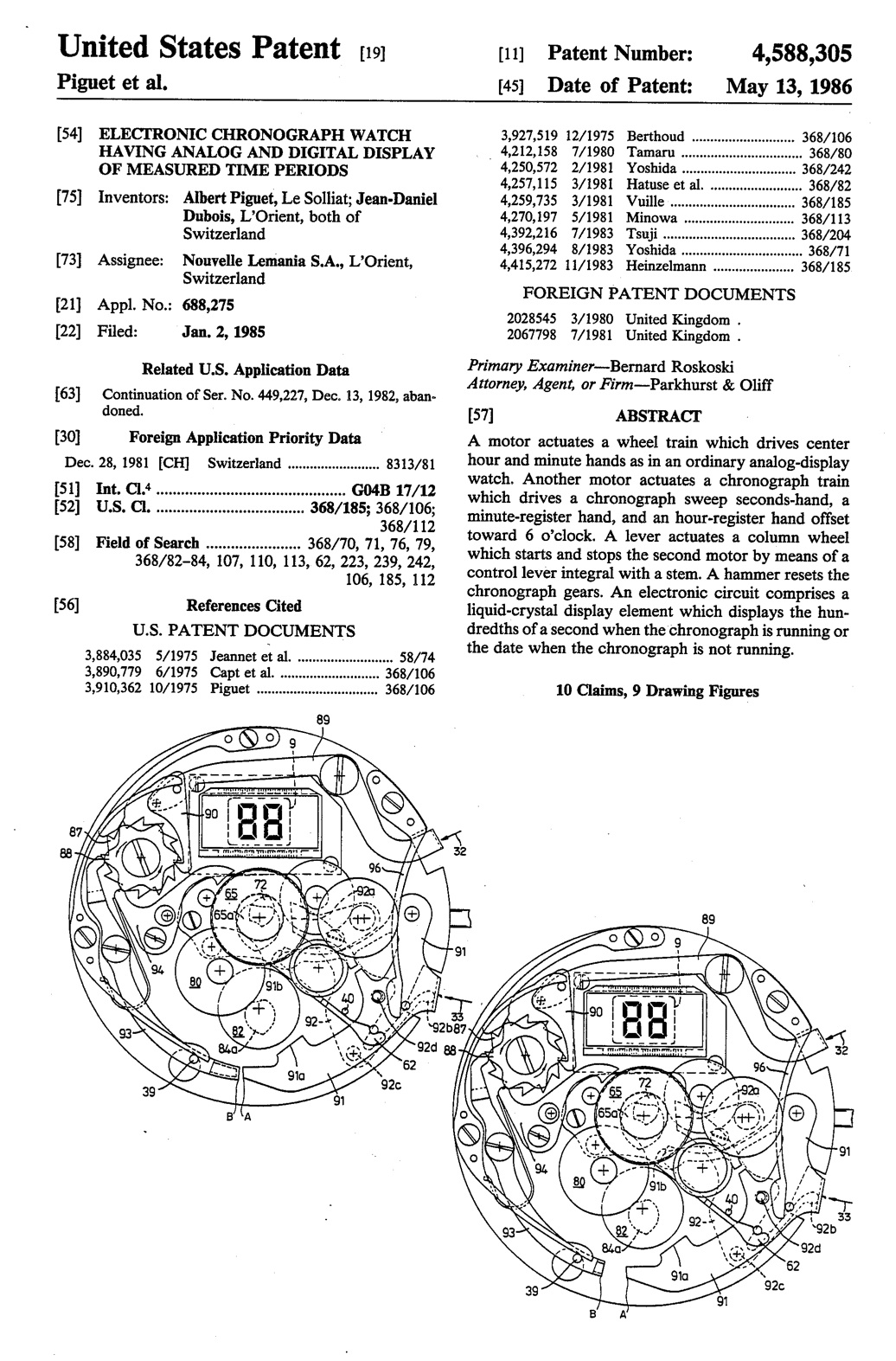

The design was duly patented. Drawings shows the traditional column wheel chronograph design merged together with a dual stepper motor drive system.

The quartz and electronic movement revolution in Switzerland did not leave Lémania unaffected. In the late 1970s, Nouvelle Lémania embarked on the development of an electronic chronograph. It would be more accurate to say it embarked on the development of an elecro-mechanical movement.
The first Swiss patent application for this movement was filed in December 1981. A U. S. patent was initially applied for in 1982 but was subsequently abandoned while further development went on, and the final patent application was filed on January 2, 1985, and granted on May 13, 1986, for an “Electronic Chronograph Watch Having Analog and Digital Display of Measured Time Periods.”
In this movement, a micromotor actuated a wheel train that drove the center hour and minute hands, while another motor actuated the chronograph train that operated the chronograph sweep seconds hand, a minute register hand and an hour register hand. The movement actually had a mechanical column wheel which started and stopped the second motor by a lever, and a hammer reset the chronograph gears. Finally, there was a liquid crystal display at 12 o’clock for the reading in hundredths of a second, up to 99/100ths. When the chronograph was not running, this display showed the date.

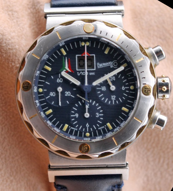

But it is not quite as rare as you may think, Eberhard also used the movement for a series of their Frecce Tricolori chronographs. And it was definitely sold to the public.

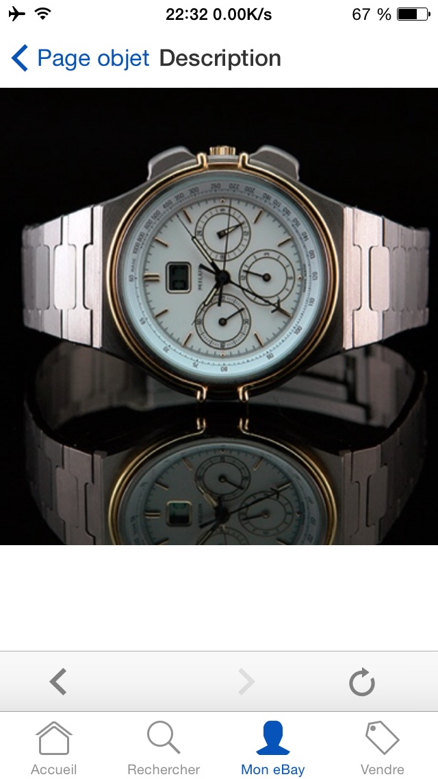

There is even a white-dialled one for sale on Chrono24 right now.
Eberhard certainly had a direct route into the heart of Lemania, because along with this hybrid movement, they also used some mechanical Lemania complications that no-one else did, such as their Diascope and Mareoscope versions of the 5100, the 5195 and 5150 respectively.

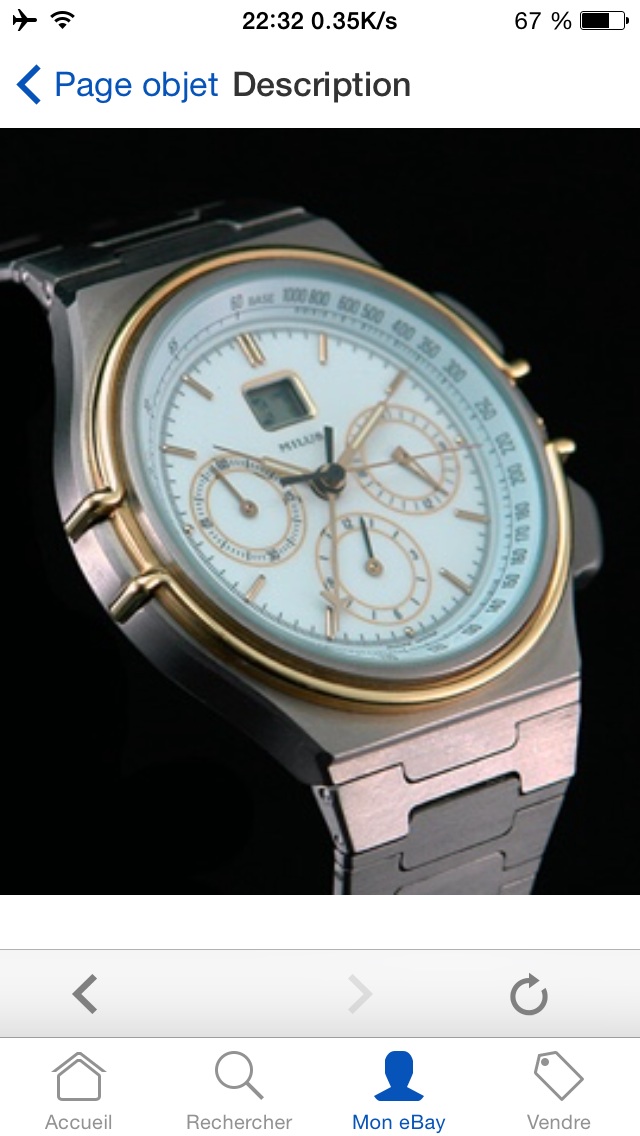

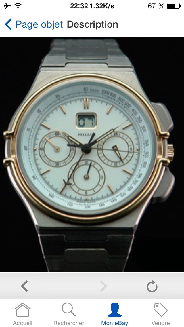

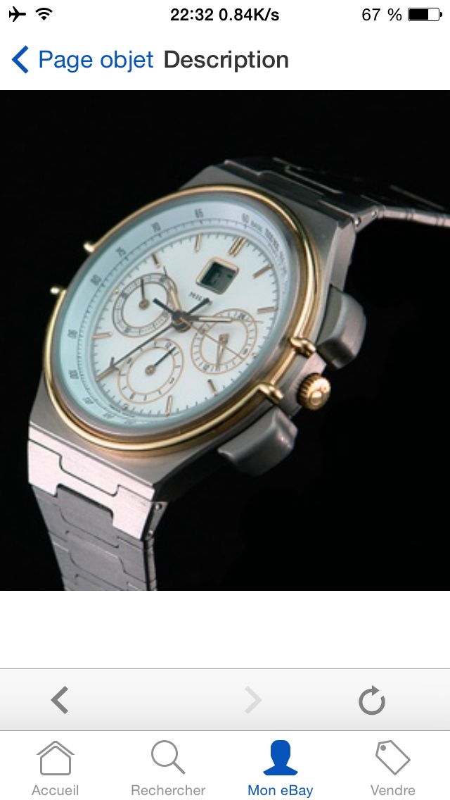

- Milus ?? (as listed by @fredmontaf above).

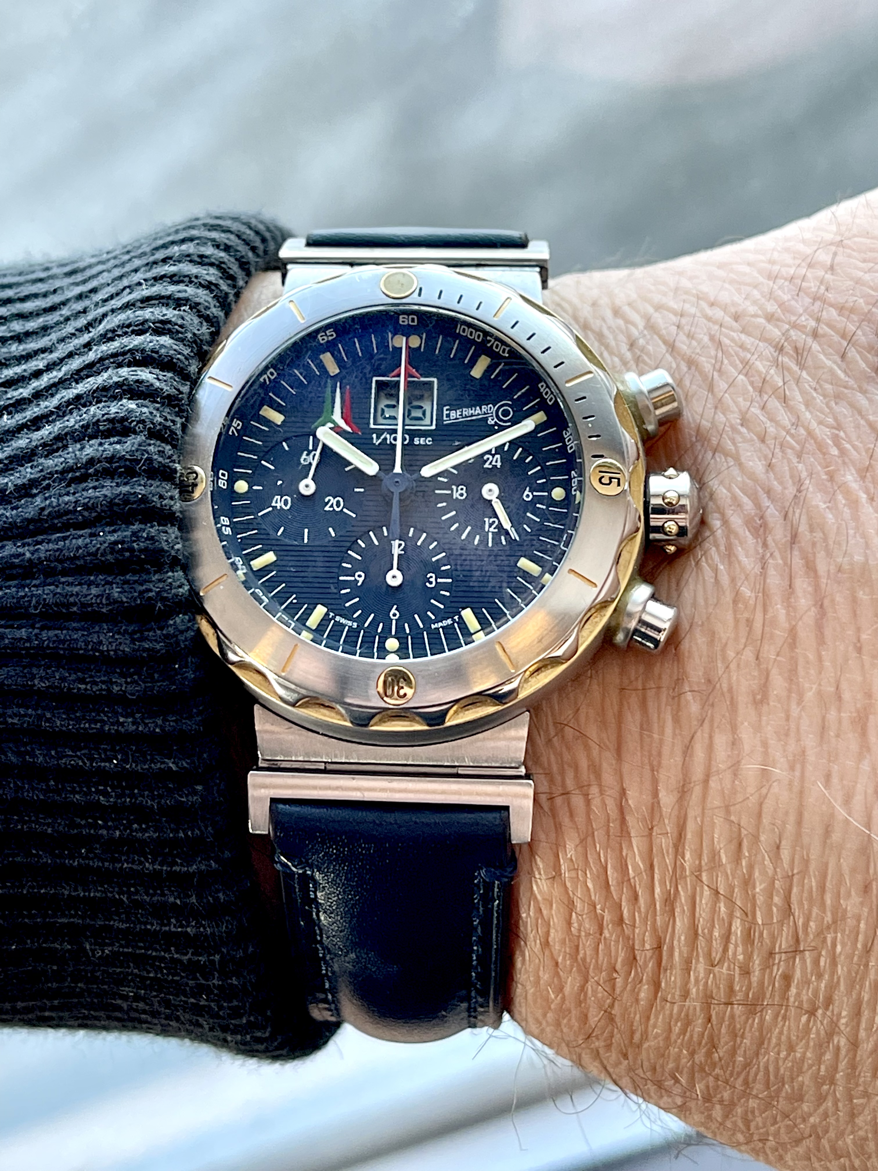

Eberhard cal 181 arrived last week.
Very happy with it. 37mm case with hinged lugs wearing exceptionally comfortable.

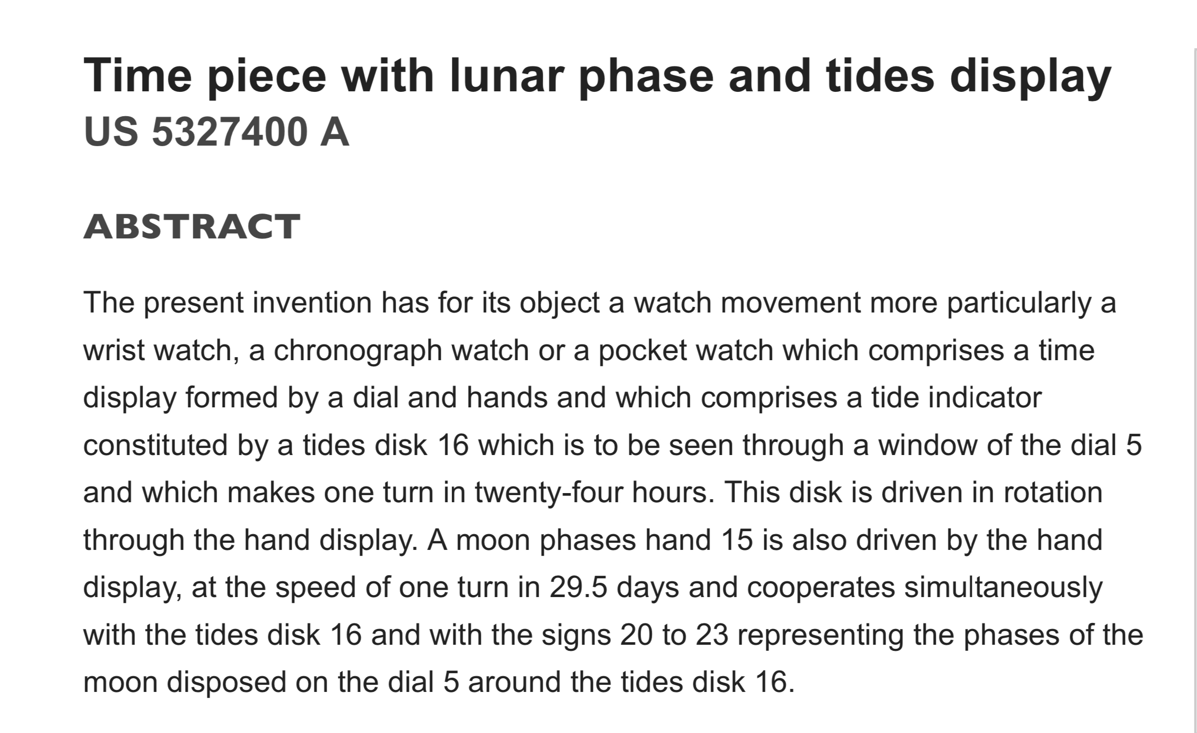

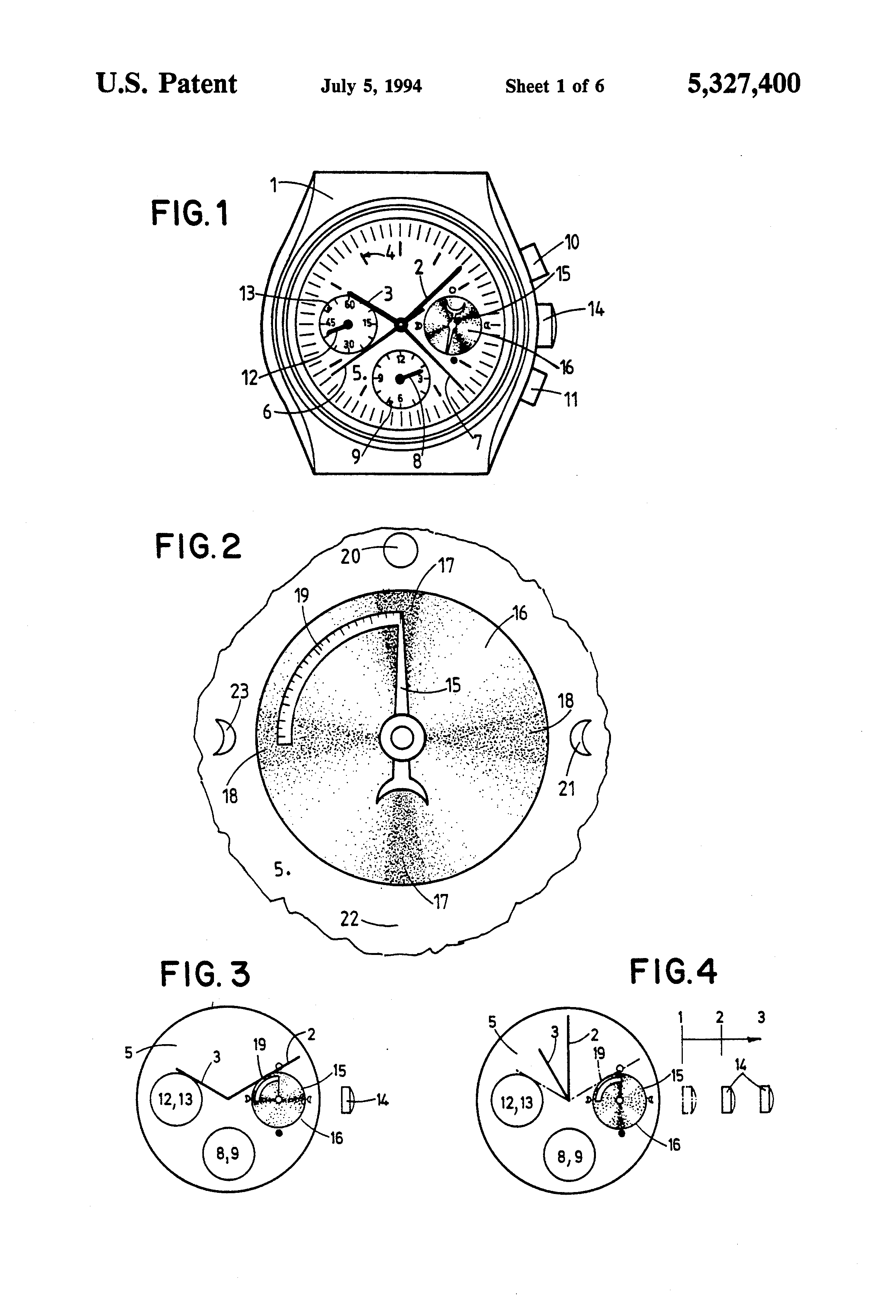

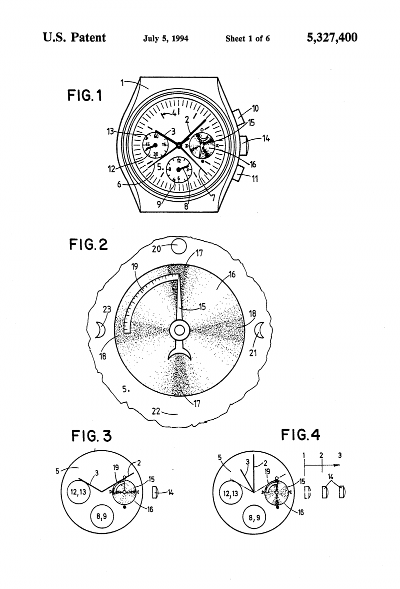

Just really wanted to share the US patent on the complication.
I was not aware of the Grande Croisière chronograph version. Cool alternative!
