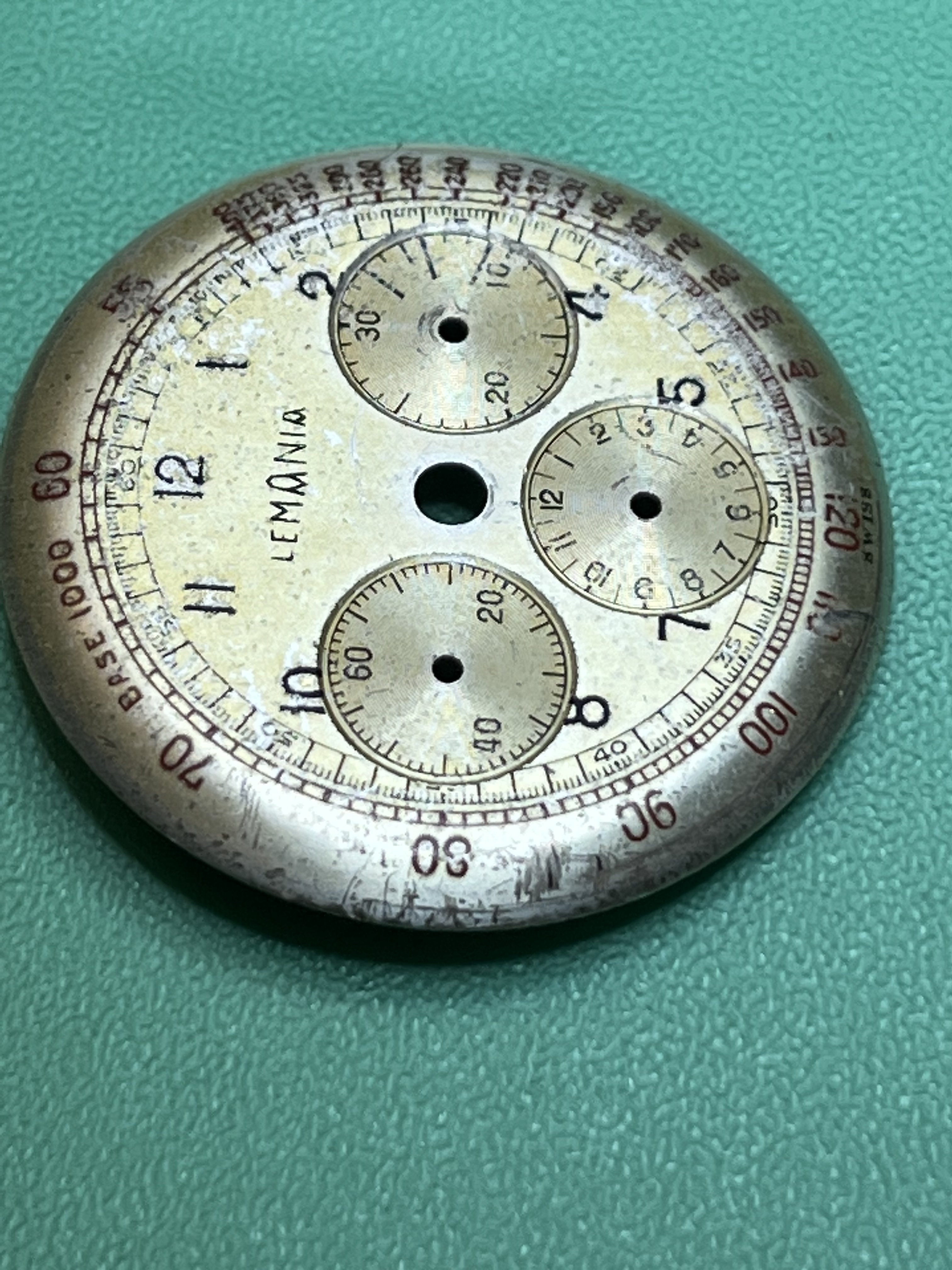

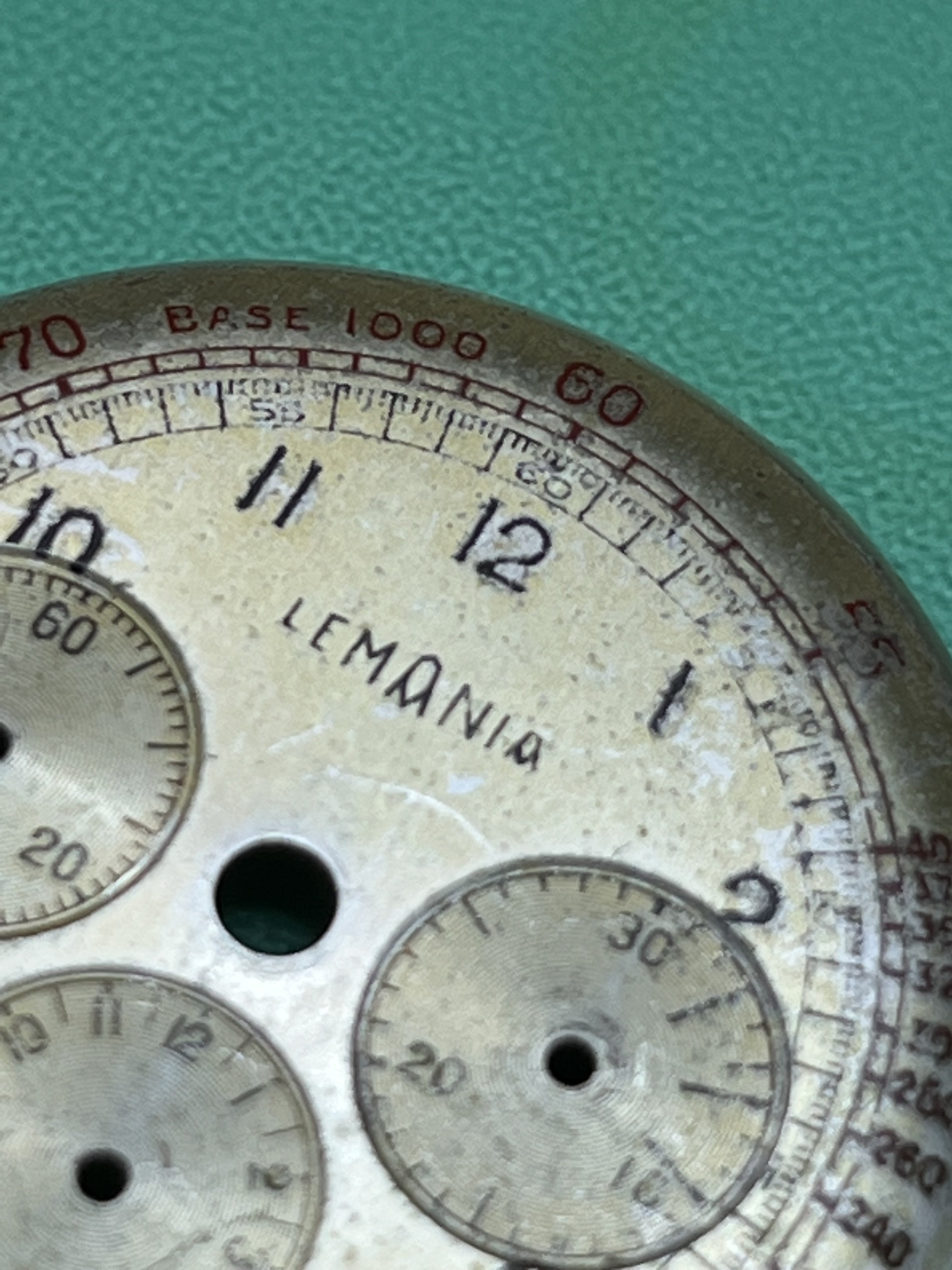

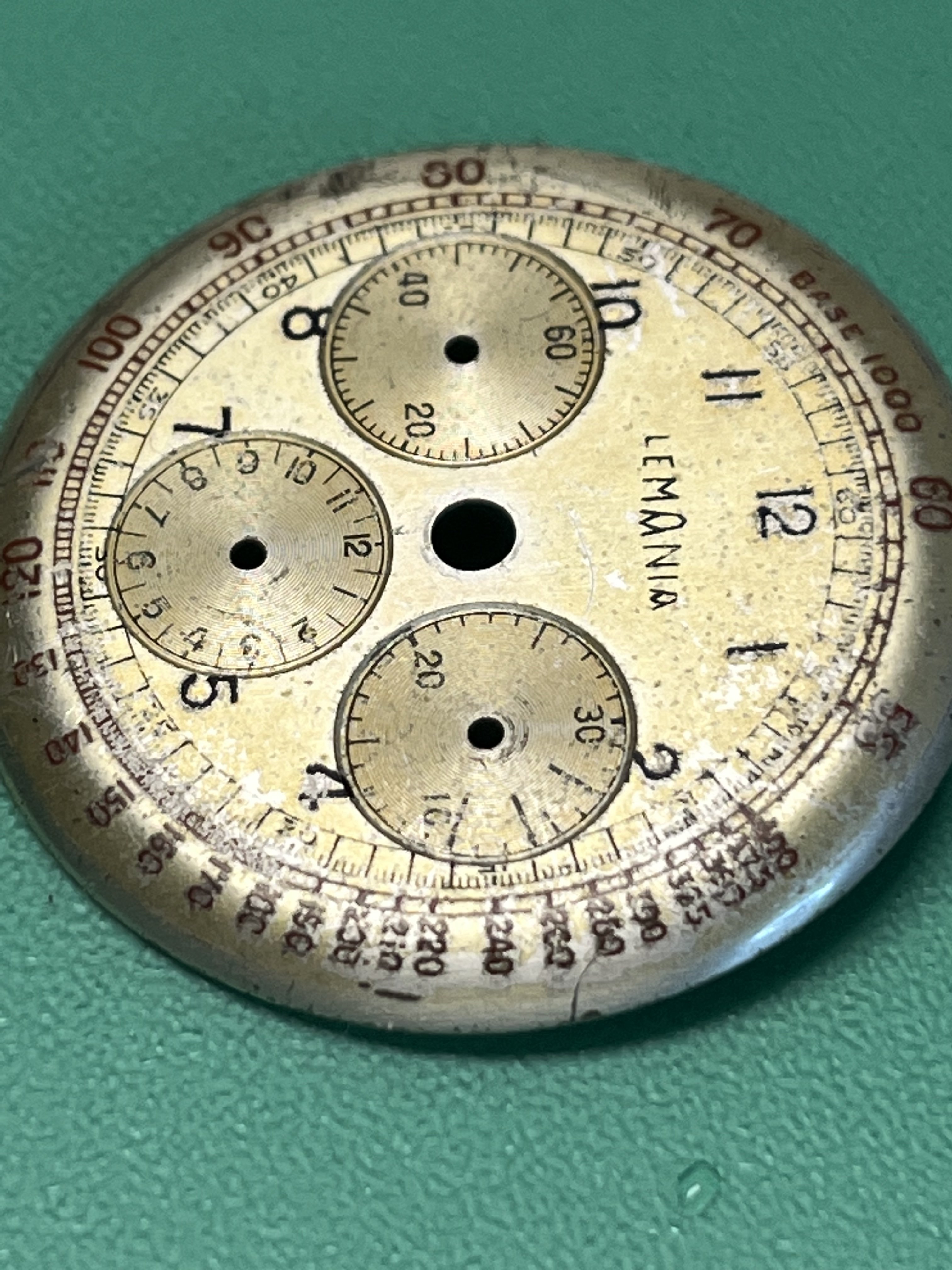

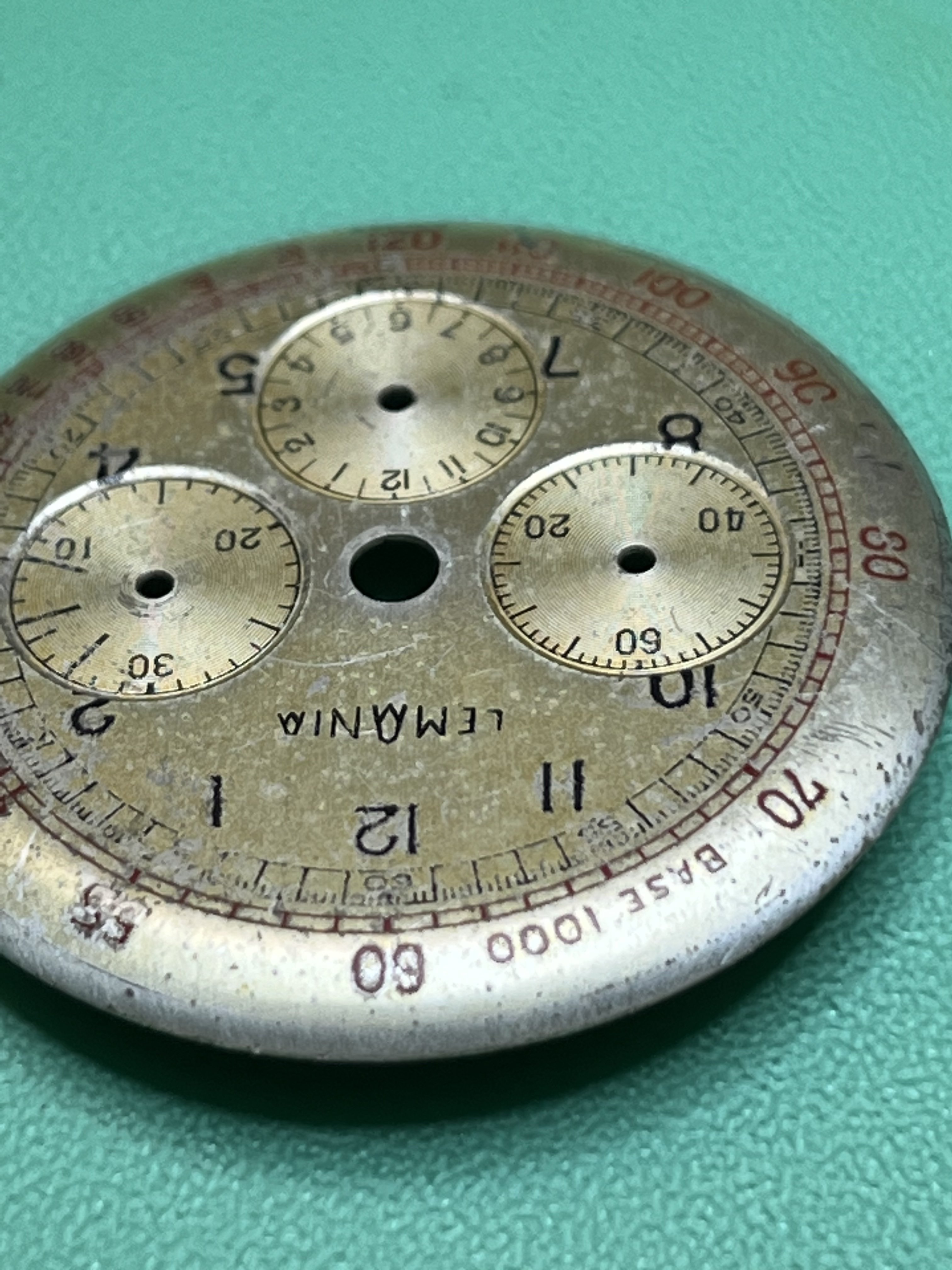

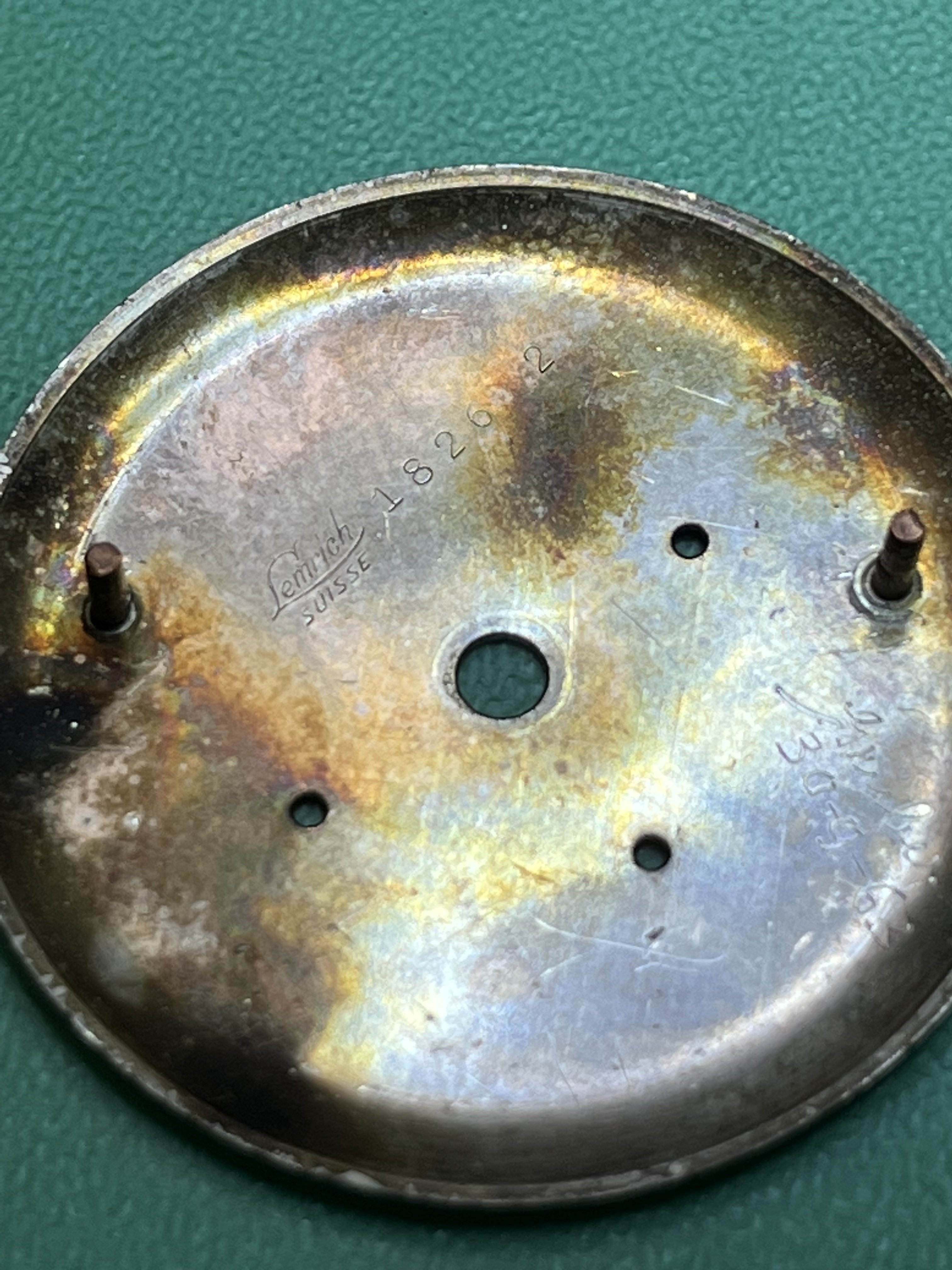

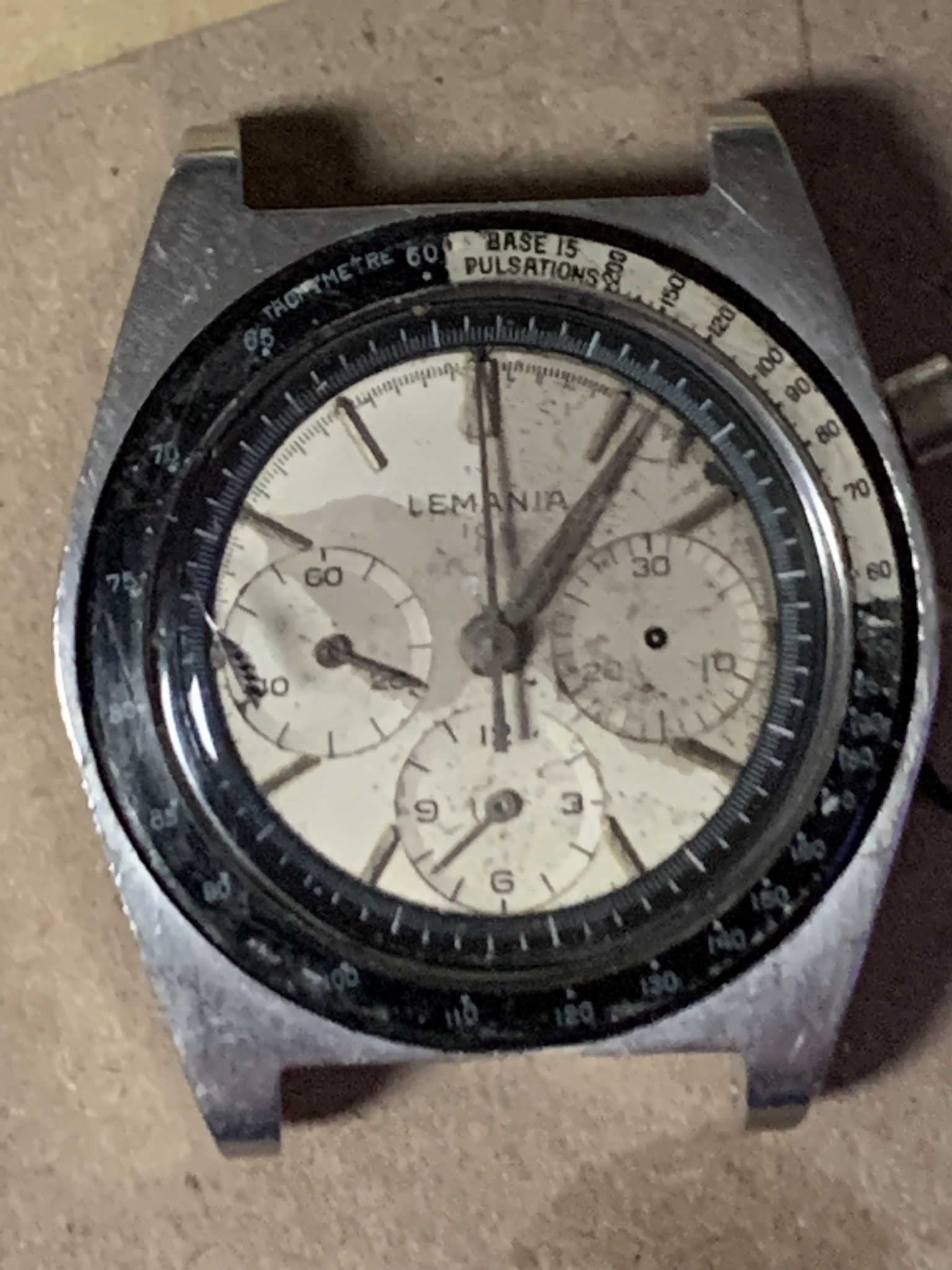

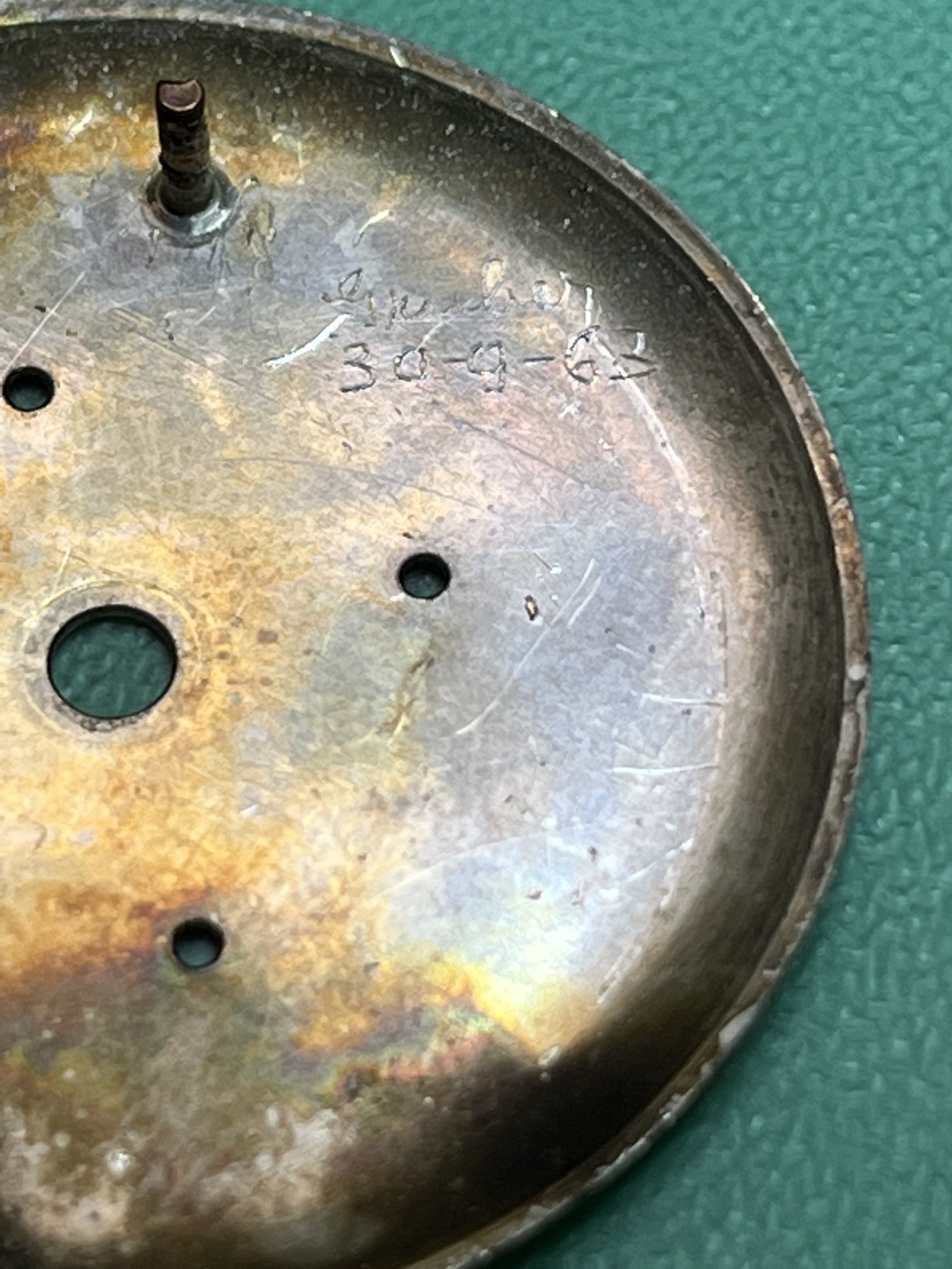

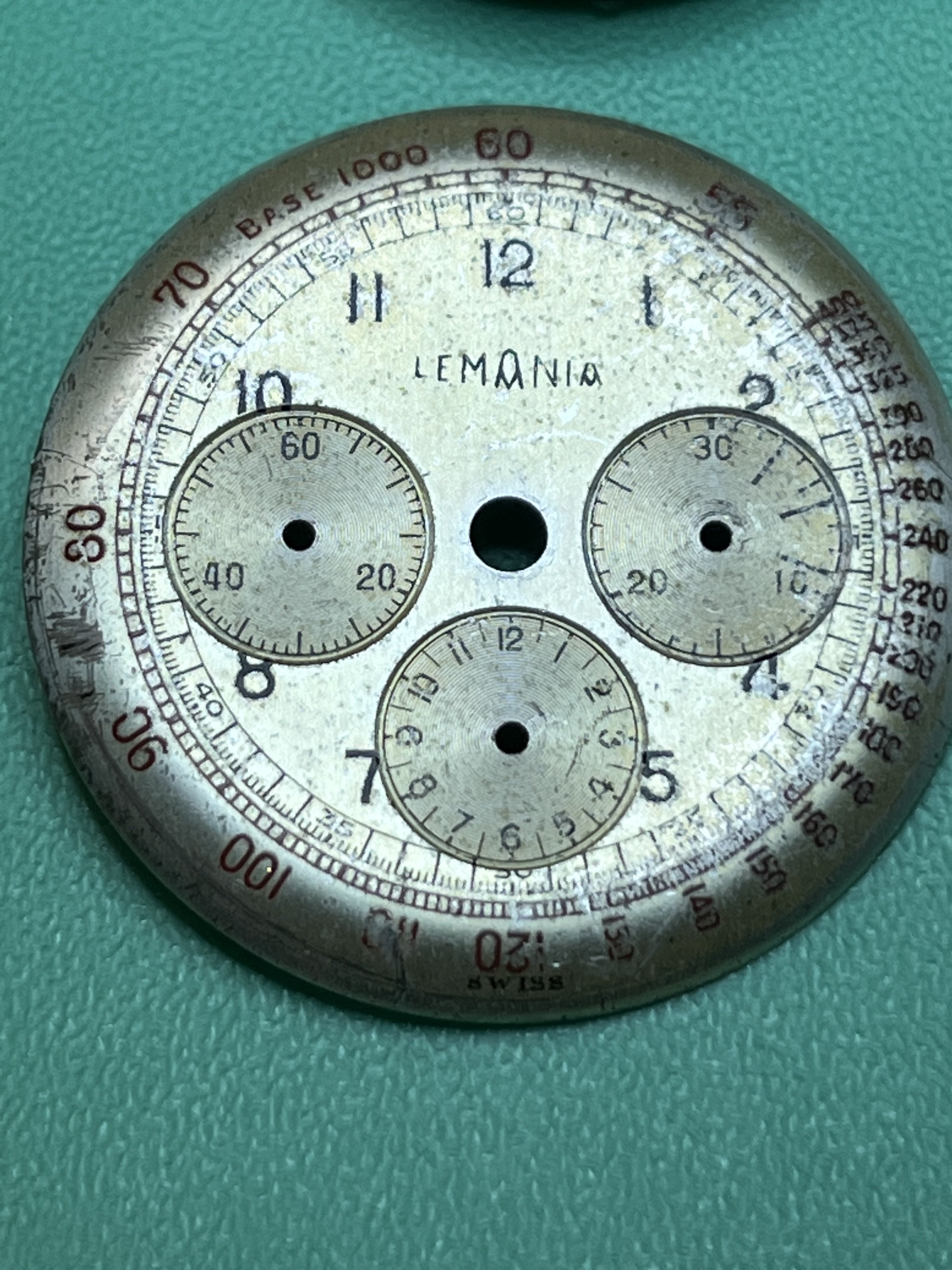

I’m in the process of restoring this and was questioning if the dial is a redial or just really a rough original. I noticed a service signature from 1963 on the rear of the dial after the start of disassembly and was curious what everyone thinks. I have seen several variations on the base 1000 scale from old chronograph catalogs but think this might not be worth the hassle if it’s not correct. Thanks for the help. -Scott
6,854
10,674
The 5 and 7 which fall over the edge suggests a redial

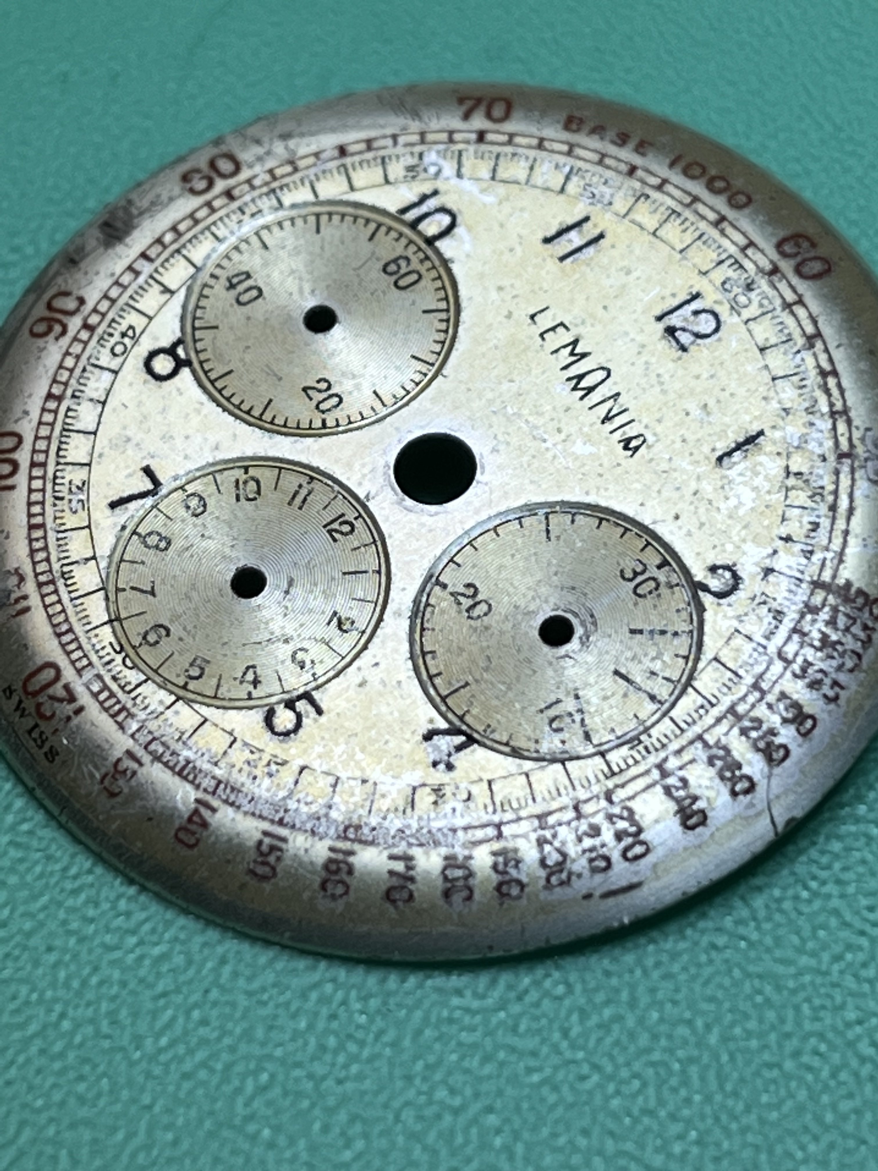

2,829
4,945
I am not well-versed in Lemania chronographs, but this dial looks consistent with other chronograph dials of the period, I think. Below is another example that has hour numerals overlapping with the sub-dials.
Source: https://omegaforums.net/threads/lemania-chronograph-ch27-purchase-guidance.120629/#post-1615025

The more important question is would this be acceptable or should I hold out for a replacement due to the condition of the red outer scale being so poor. This dial is hard to find in decent condition.
2,829
4,945
I think that it will be difficult to find an appropriate replacement dial. If the question is, should you pay for a service to get the watch complete and running, then it depends on how you anticipate using it and whether or not you plan on selling it in the near future. The dial is certainly worn, but since you already own the watch, I would probably consider it acceptable.

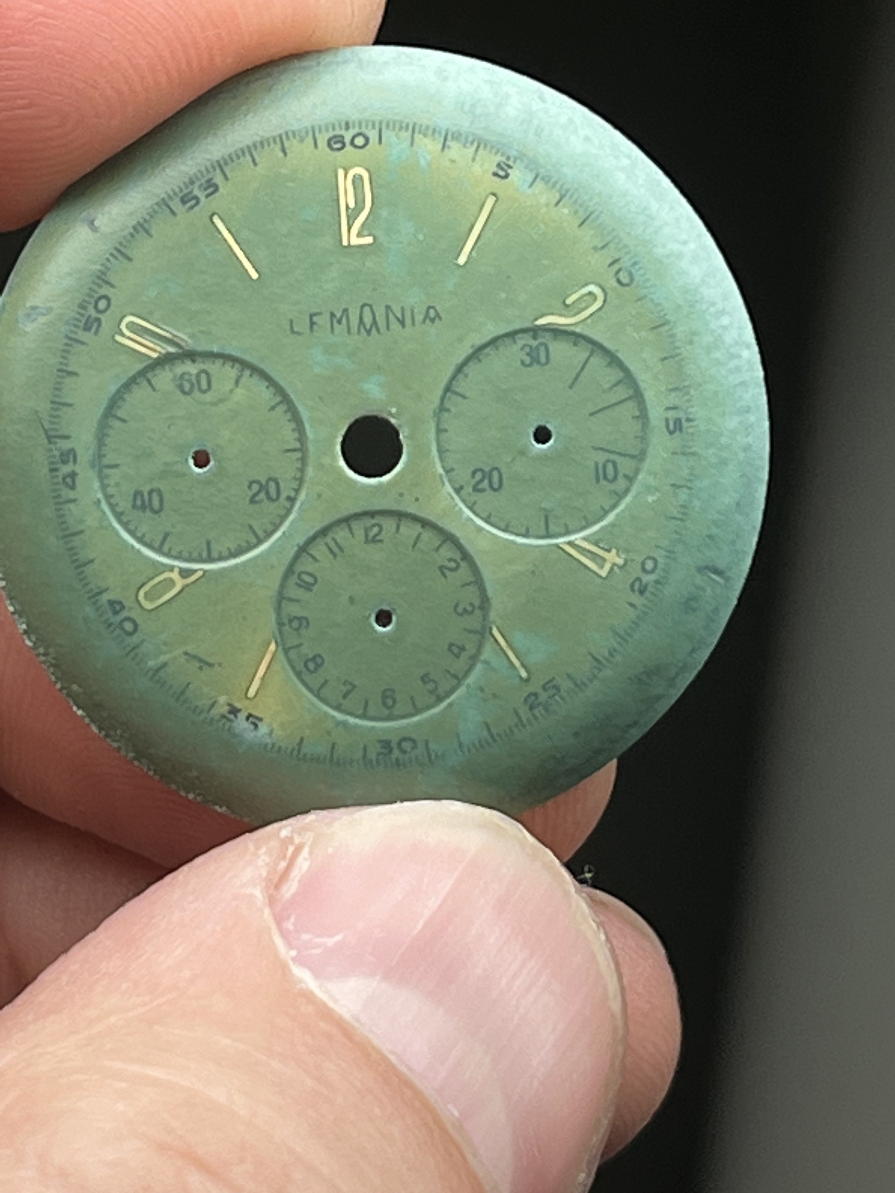

Thanks for the advice. I will be doing the service myself and sourced a far more damaged dial with the rose metal hour markers to possibly modify with translucent paint. Thinking about a clear case back to show off the beautiful movement as well. I fortunately already own a smaller gold version of this movement and got the 35mm this dial belonged to as an incomplete watch. So not really super collectible as it is.

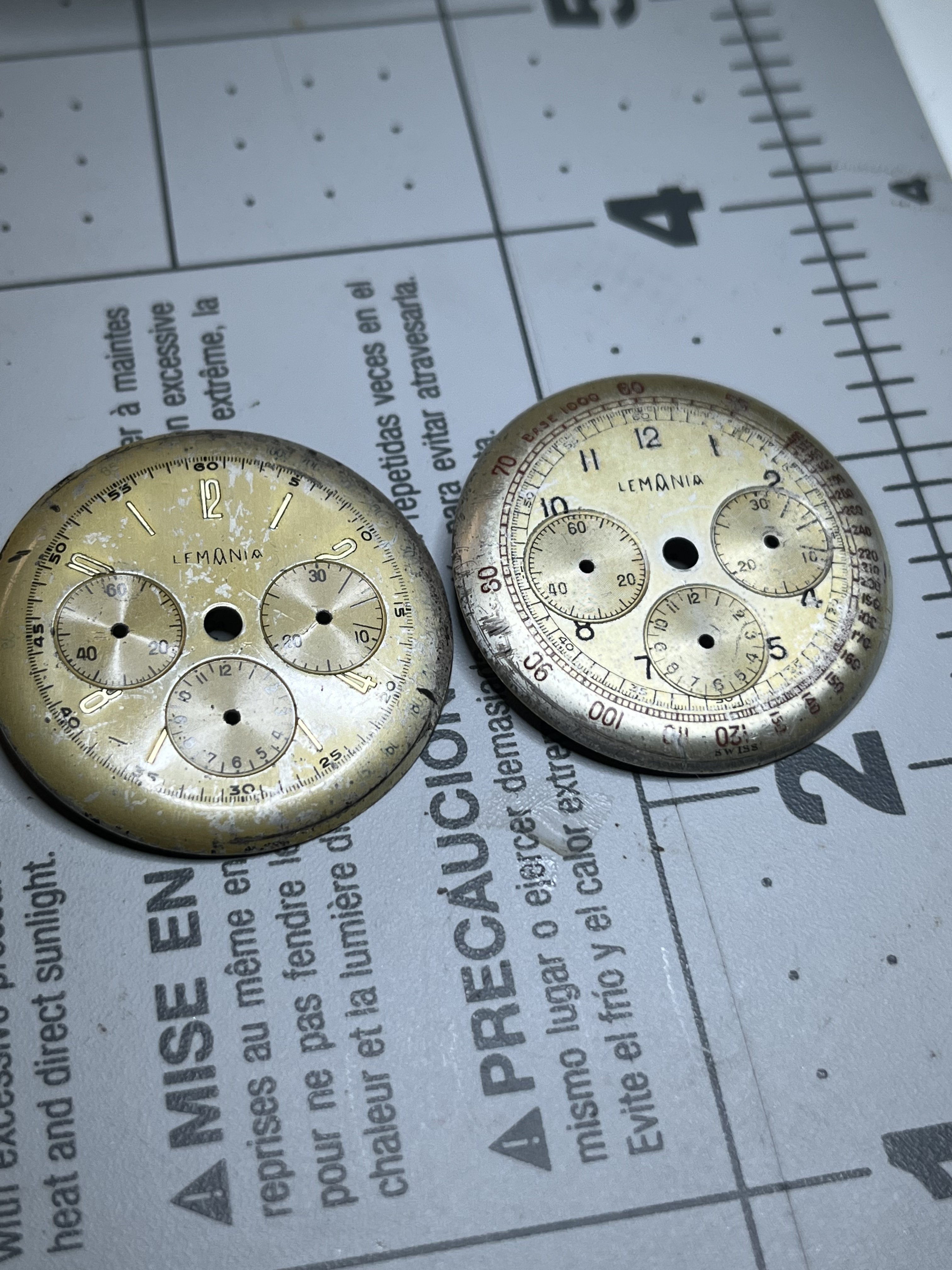

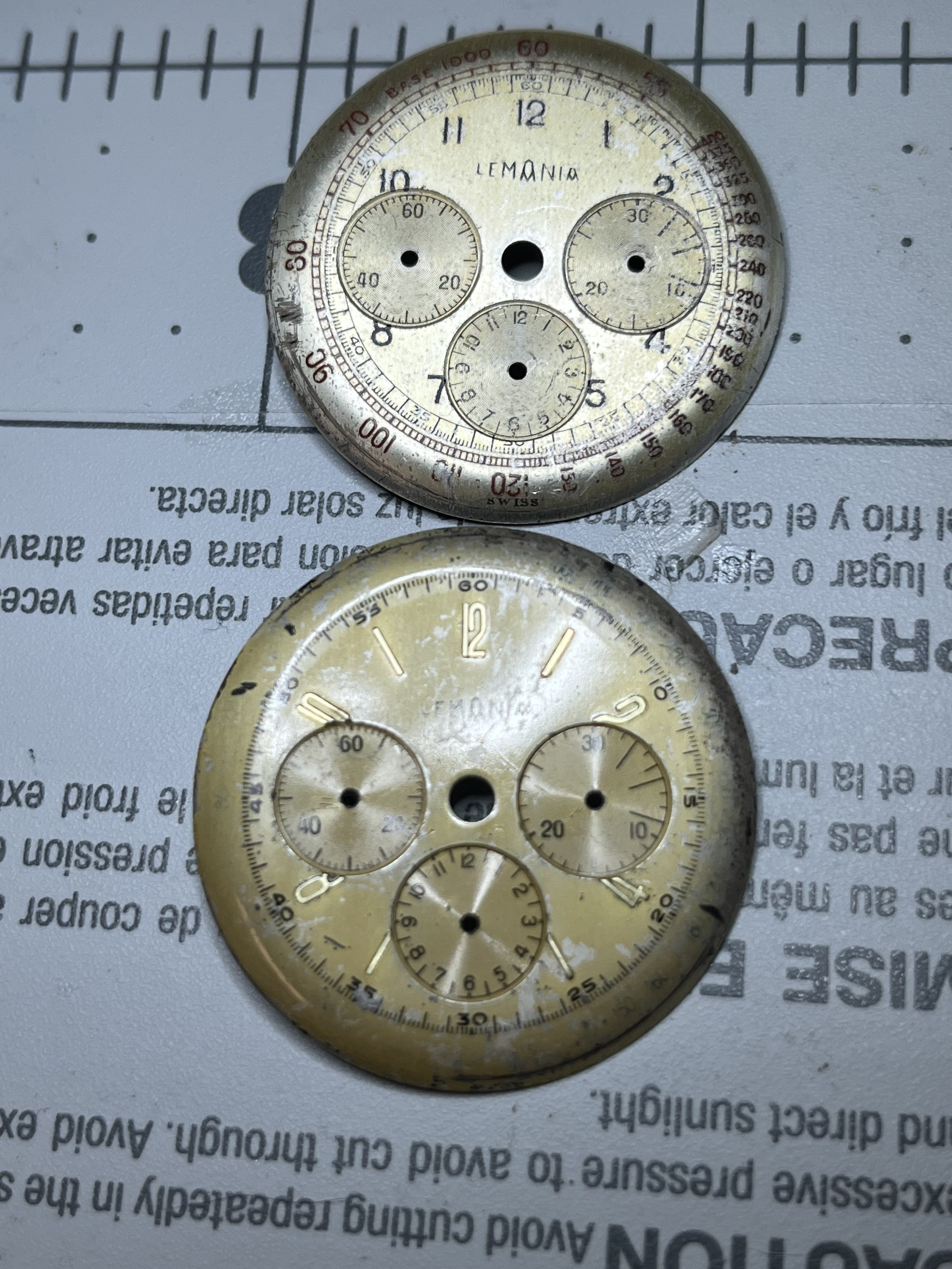

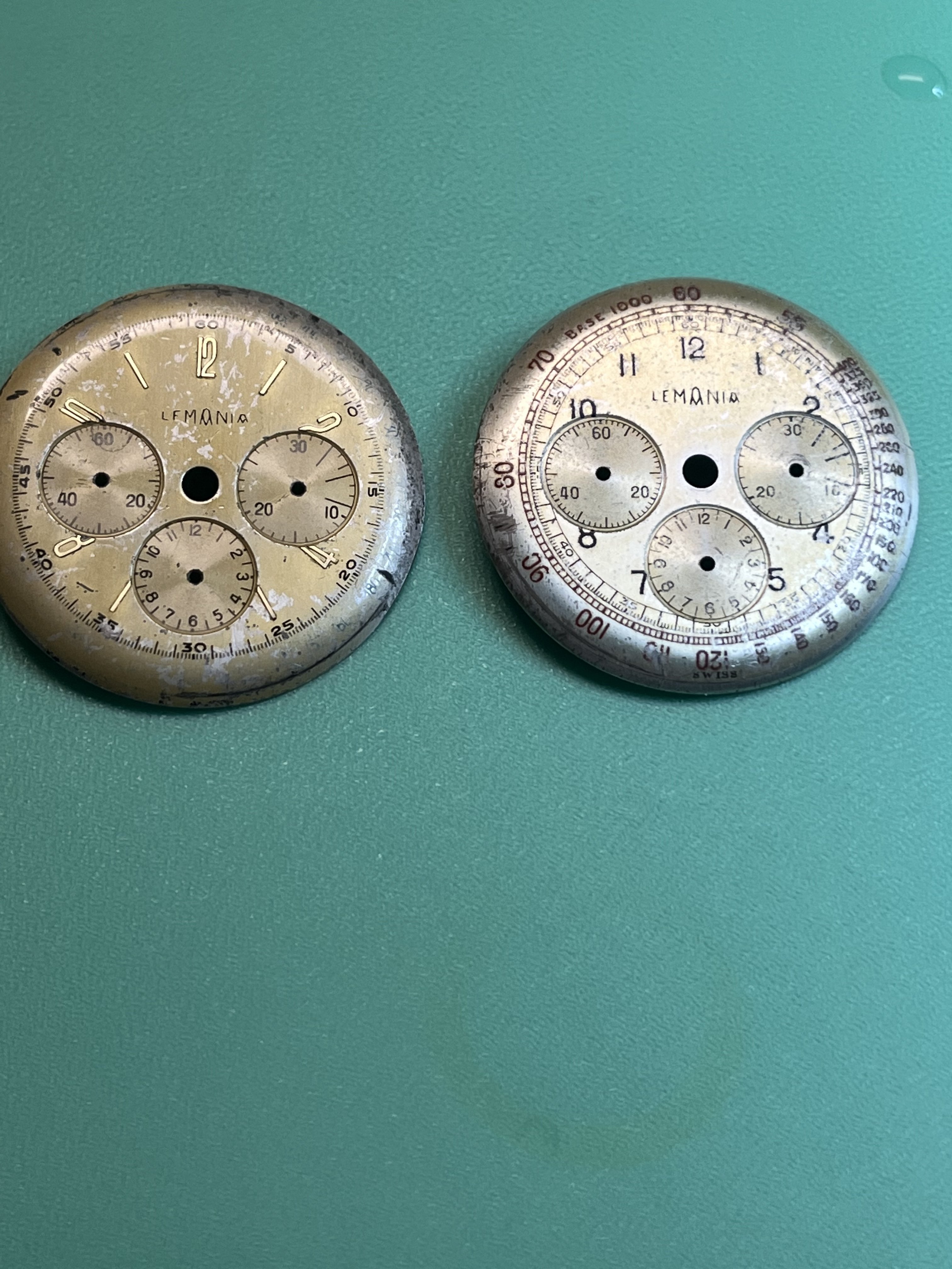

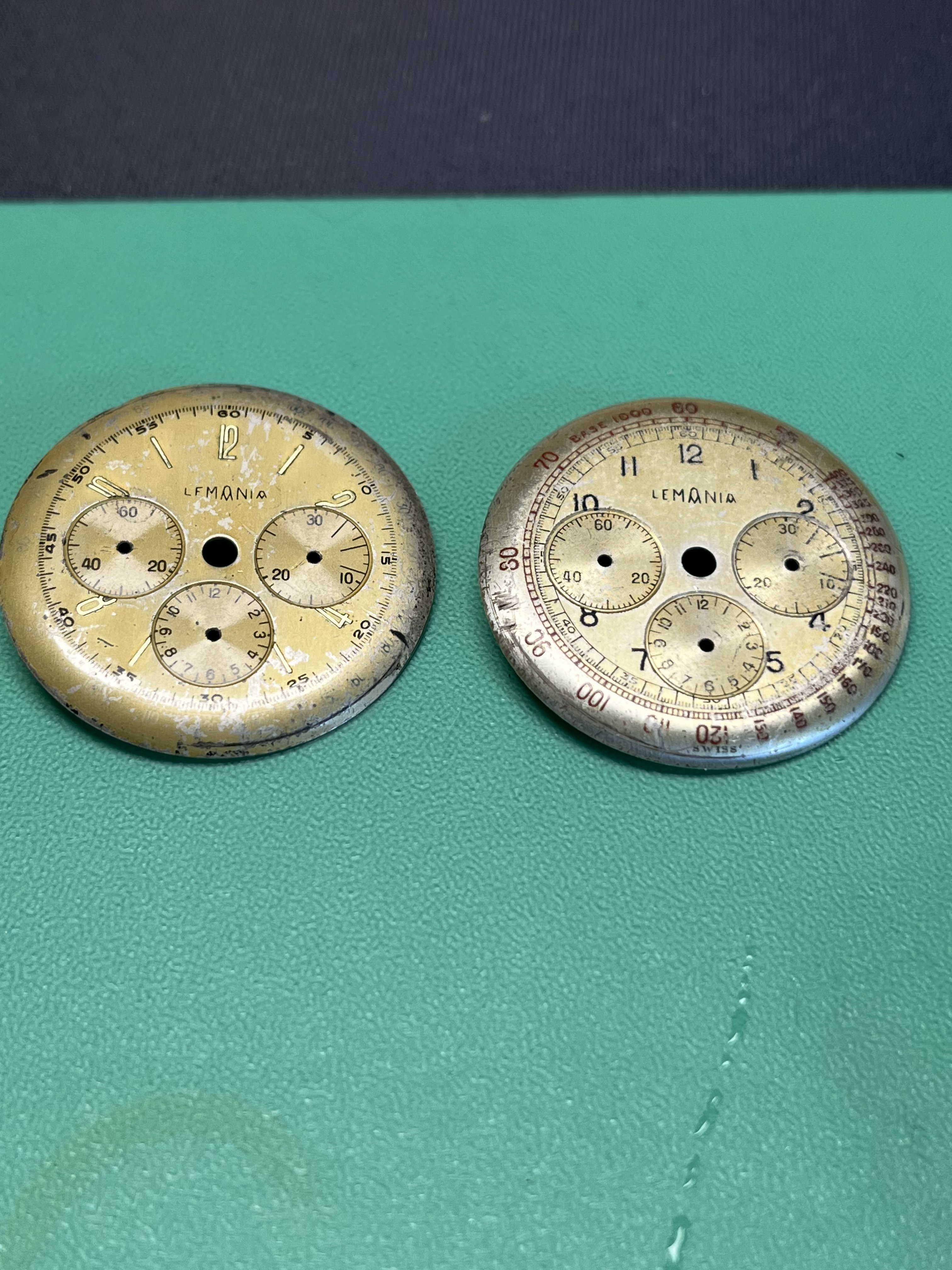

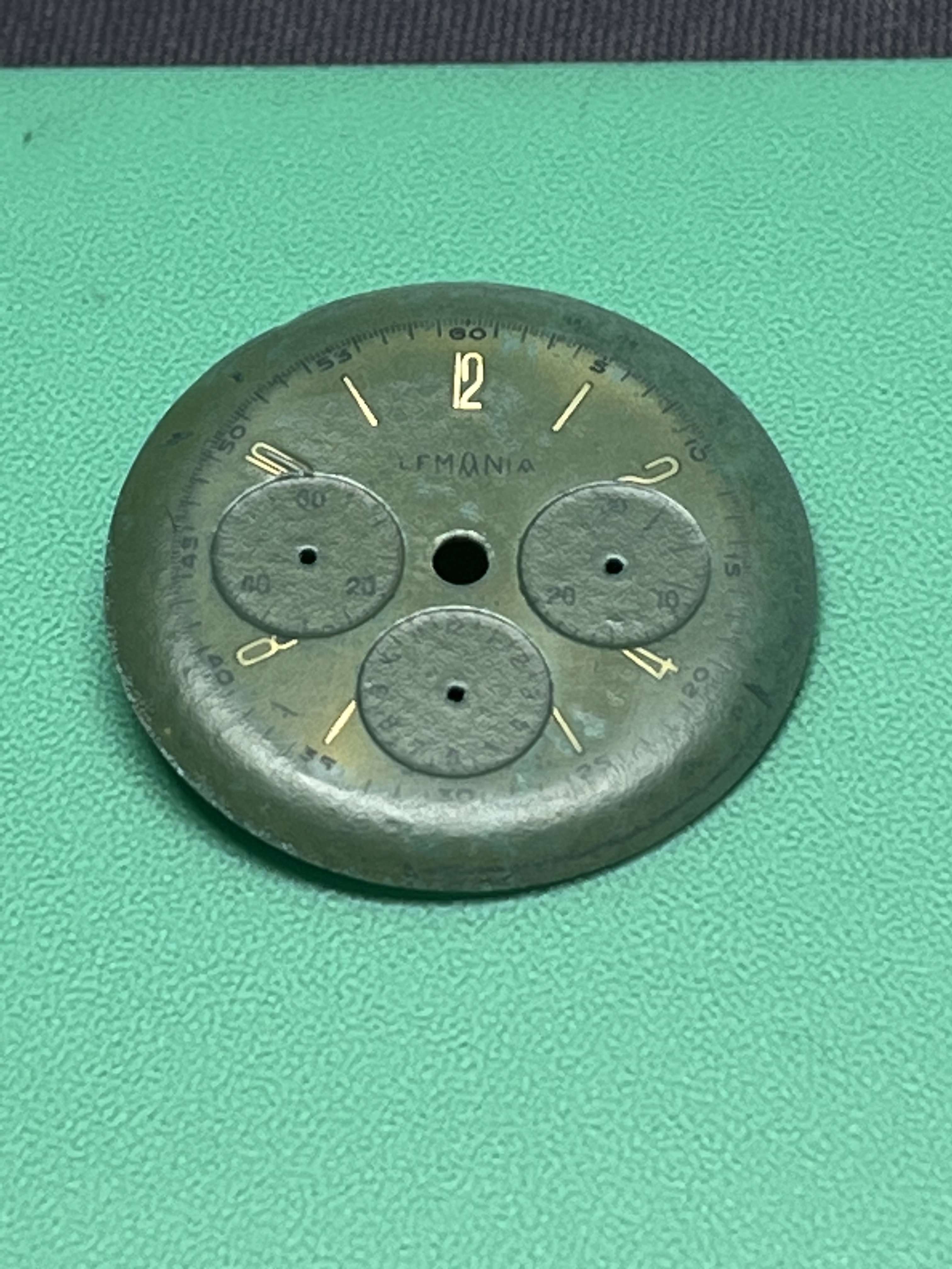

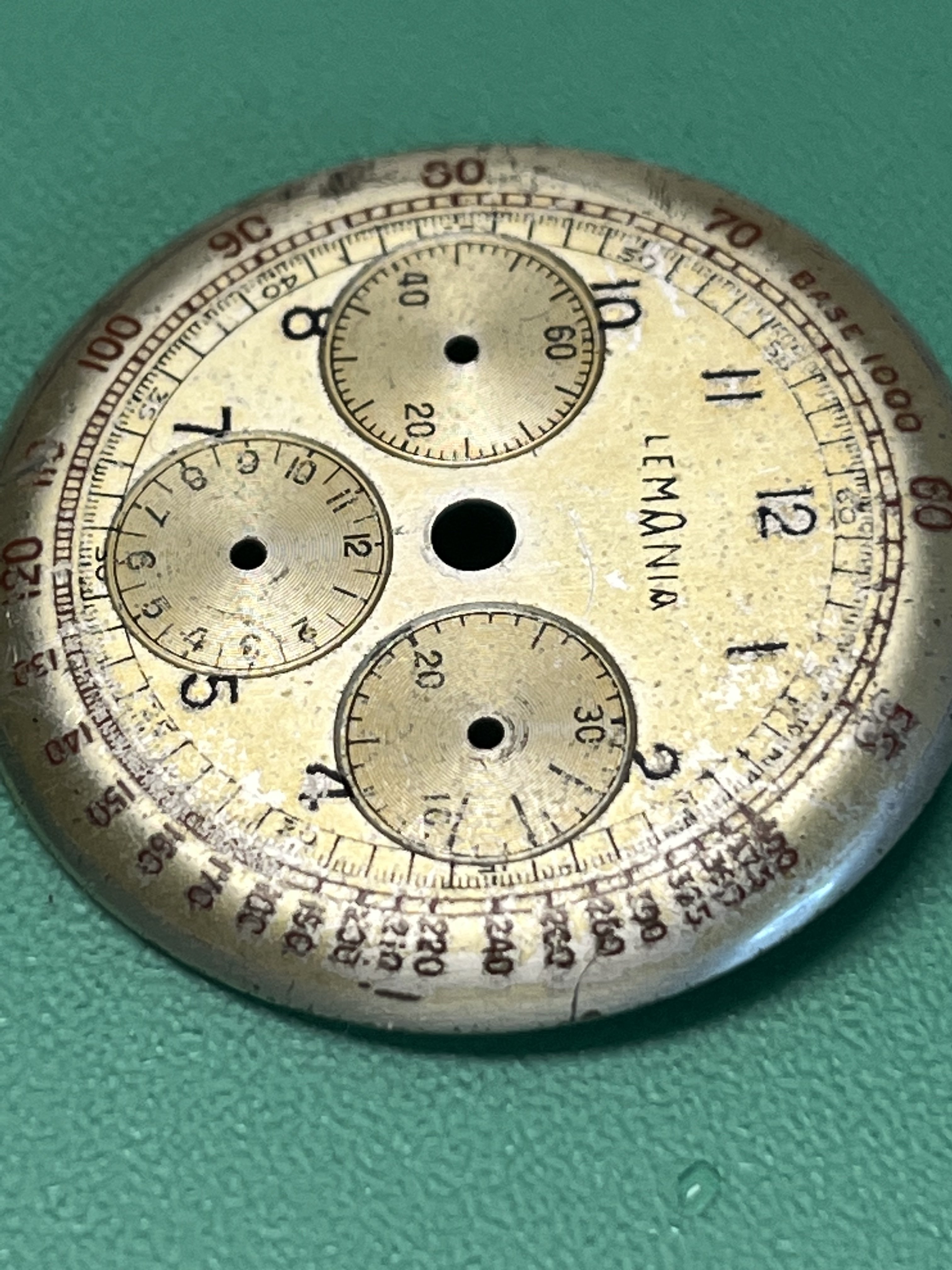

My dial options now. Would you keep the original or try something with the new more damaged dial with the more prominent numerals in metal? Still thinking if the translucent paint covers the clear coating that the black register numbers will show through and then I can just sand and polish the hour numerals back clean. Opinions are all welcome. It’s a project so I can enjoy wearing it instead of just sitting in a pile of parts -Scott
213
670
Thinking about green or gold tone paint as a possible color choice
2,999
4,755
I like the dial on the right.
Someday I would love to find a case for my 105. The dial certainly has character. more like an oil stain than a water stain.

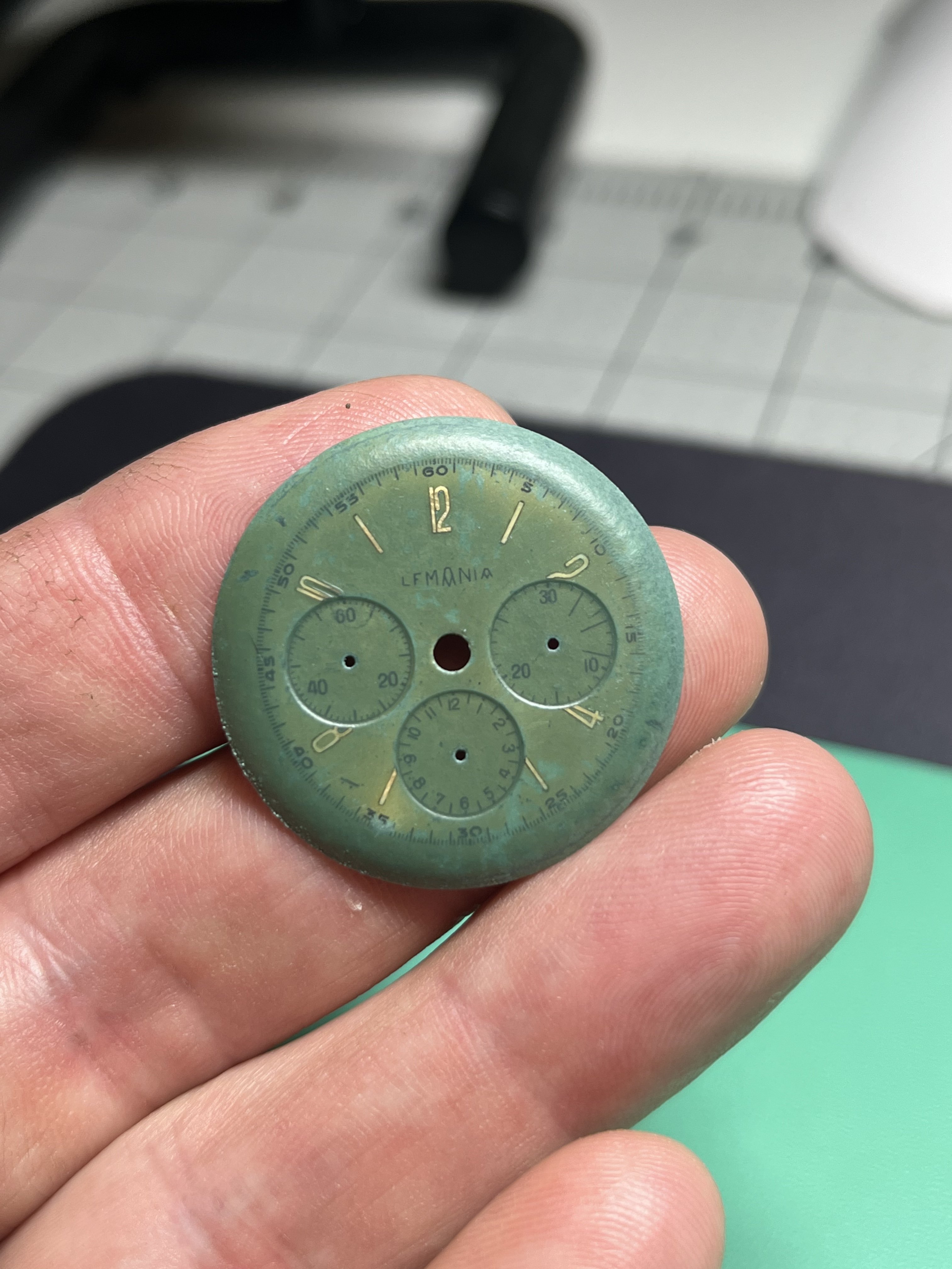

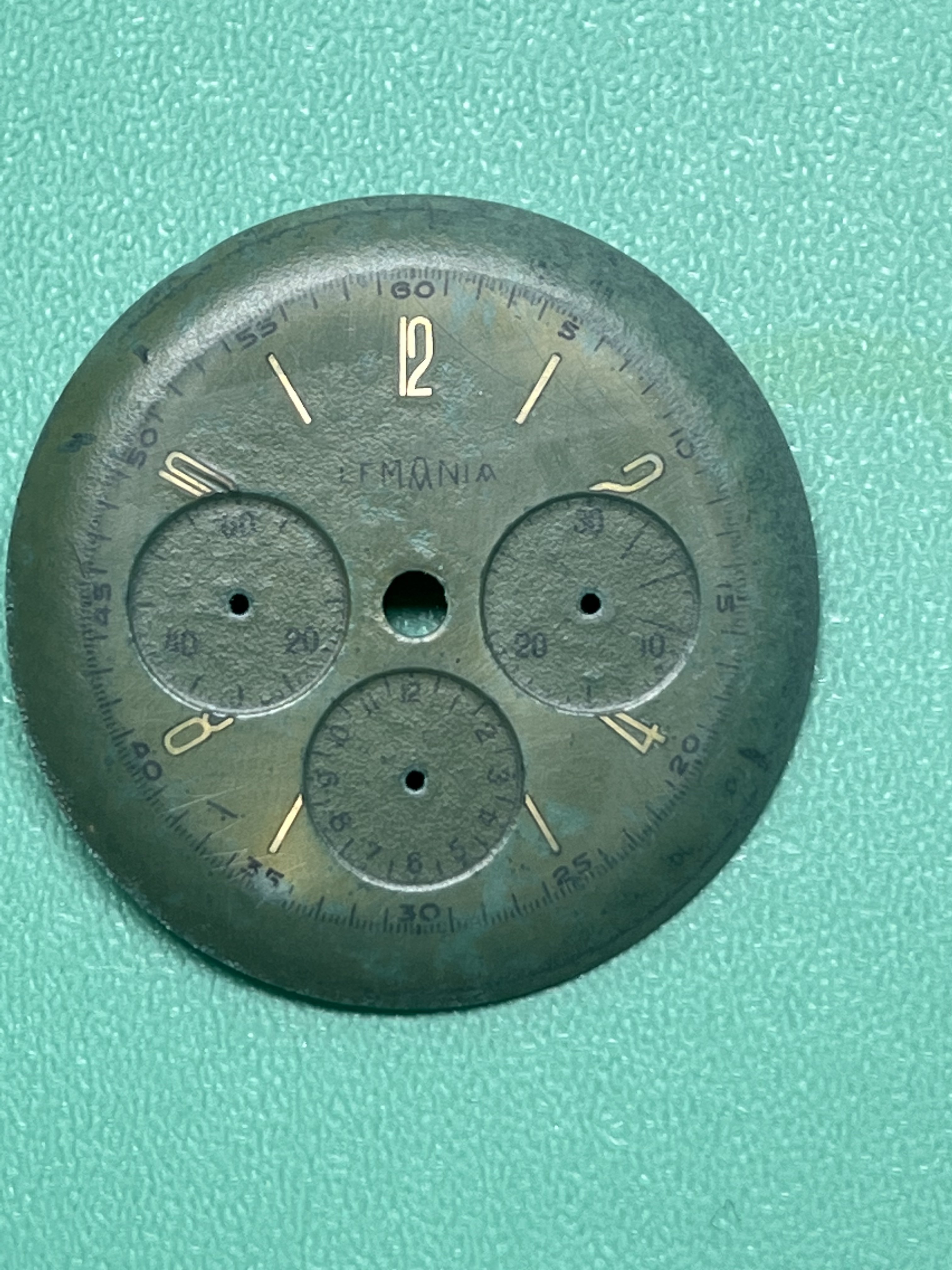

Current state of the dial mod……. It’s transparent sea glass and looks aged but not sure about the handset color. Gold or black? The case is steel. Any advice or opinions welcome.
I still have the original dial but wanted to try my hand at something different…….
4,440
18,267
Hand-set should normally match the dial markers, so gilt hands is my best advice.
Looking at some of my watches/catalogs I would say the style of the markers (straight) would dictate "dagger style"
or perhaps dauphine-style hands.
As the dial has not got lume-plots, non-lumed hands would be "correct".

Late to the thread I’m afraid, and I know little about Lemania, but to me the initial dial in the OP is an obvious original. I won’t say why publicly because I do not want to tip off the now very talented con artists who try to sell off excellently redone dials as originals.
