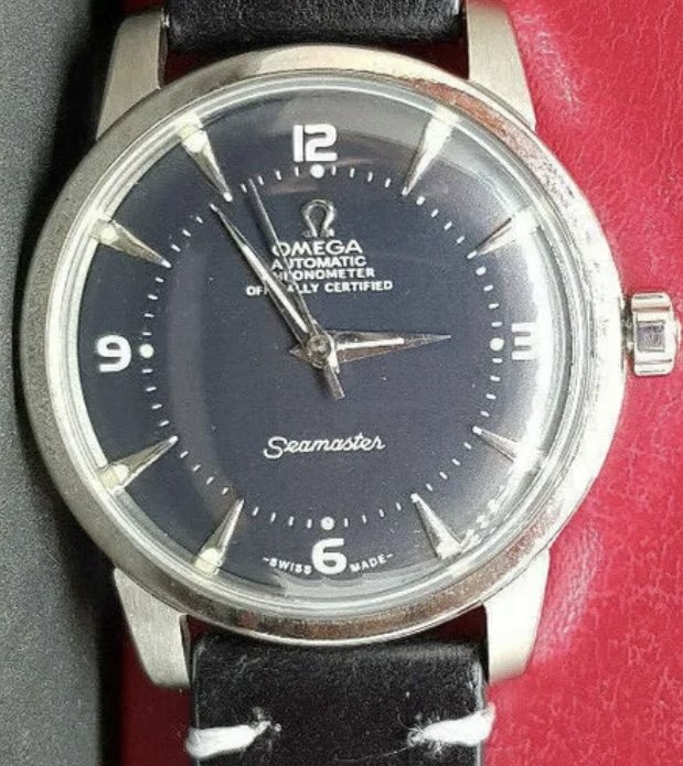

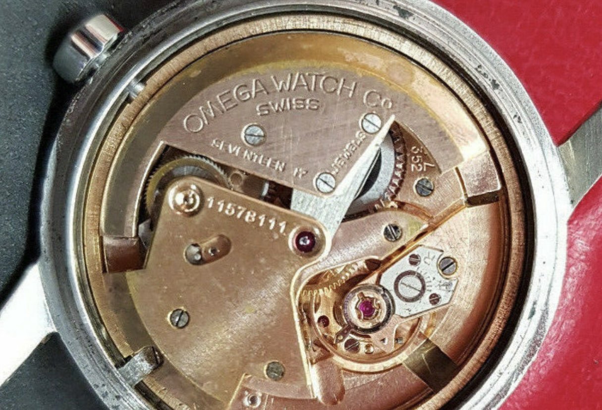

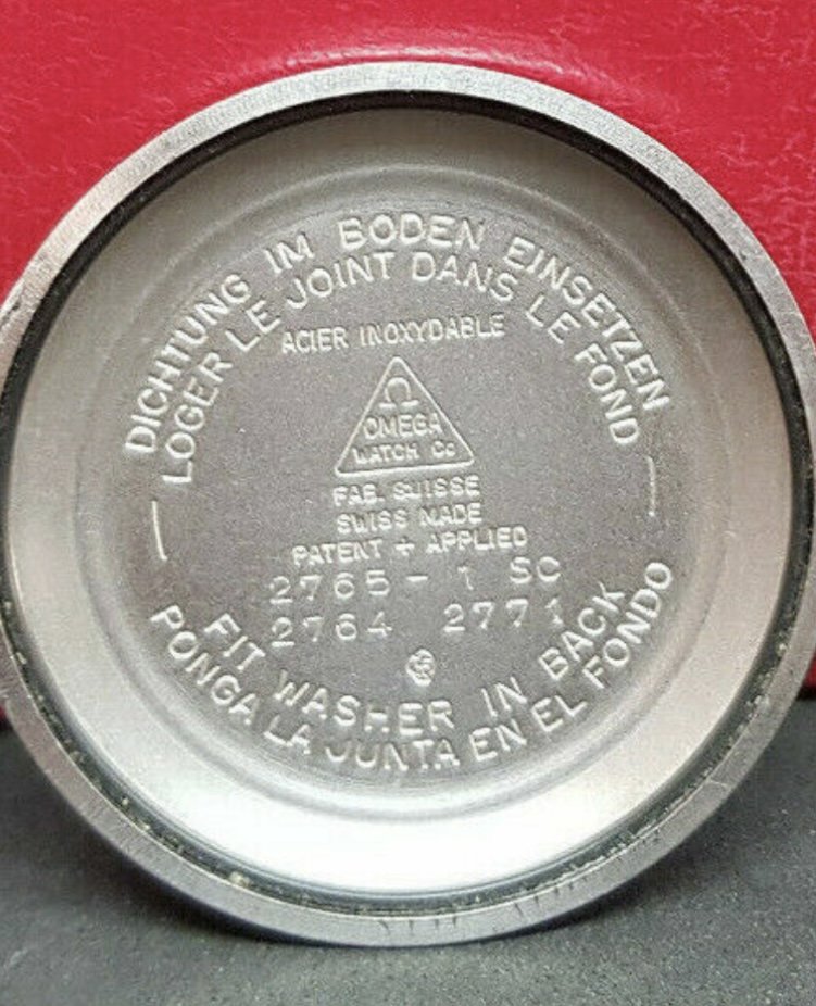

first post here: wanted to legit check this seamaster on ebay. 2Cal 352 with serial in 11 million range (47-48’?). But never seen a dial like this and multiple stamps on caseback.
Any help would be appreciated!

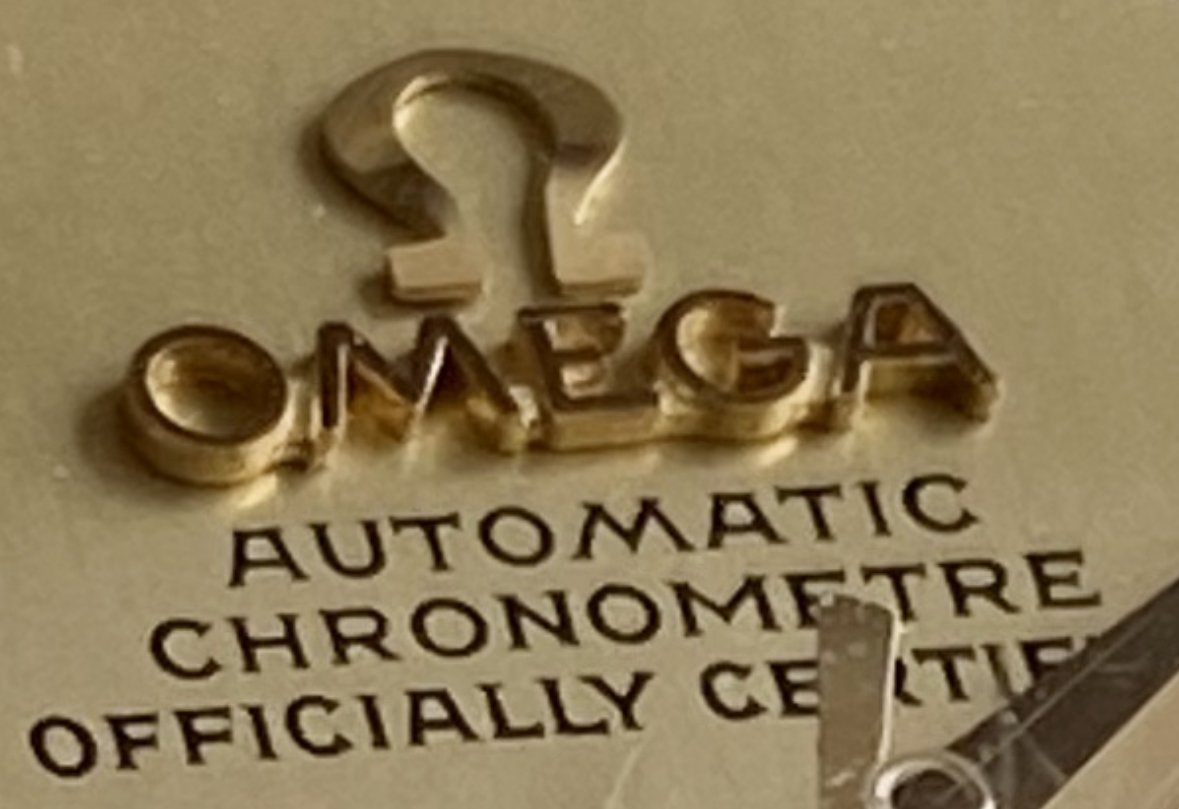

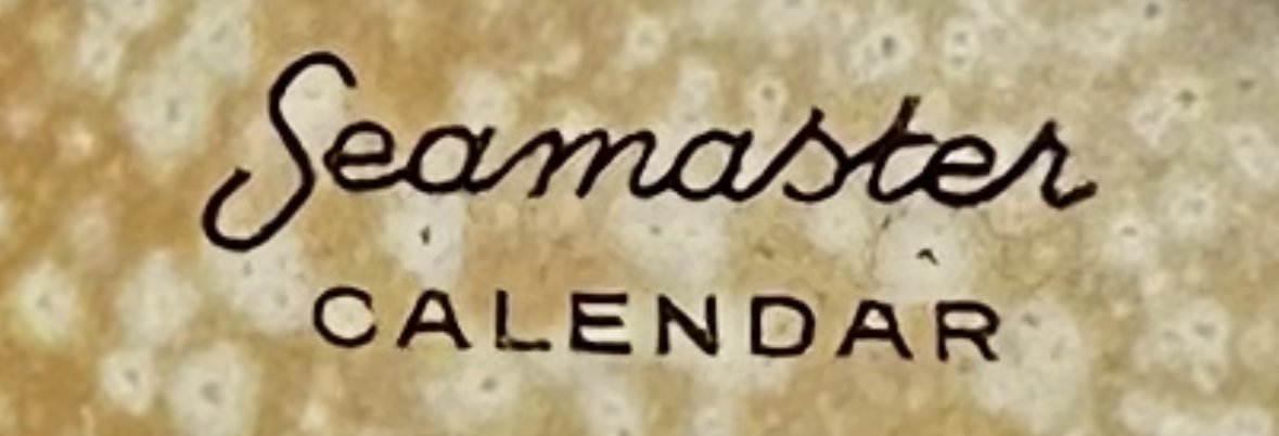

Here's a hint: Compare the "s" in Seamaster to other examples from the same time period, including early 1950's.

Another hint. Omega didn't spell Chronometer like that until 1956 at the earliest...

Like others have said, if you do a quick google image search of this forum you will find plenty of examples to compare to. It will become evident that the quoted specimen is a very poorly executed redial.
