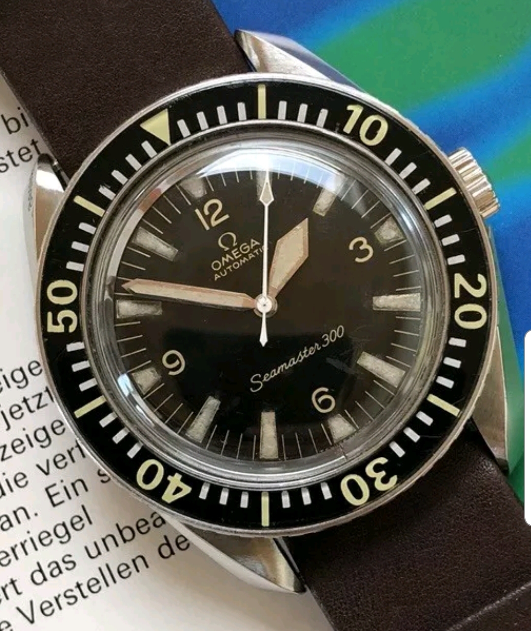

Legit bezel SM 300 165024?

Yeah i thought so but worth the try 😁 - it’s great looking and I’ve always wanted one!

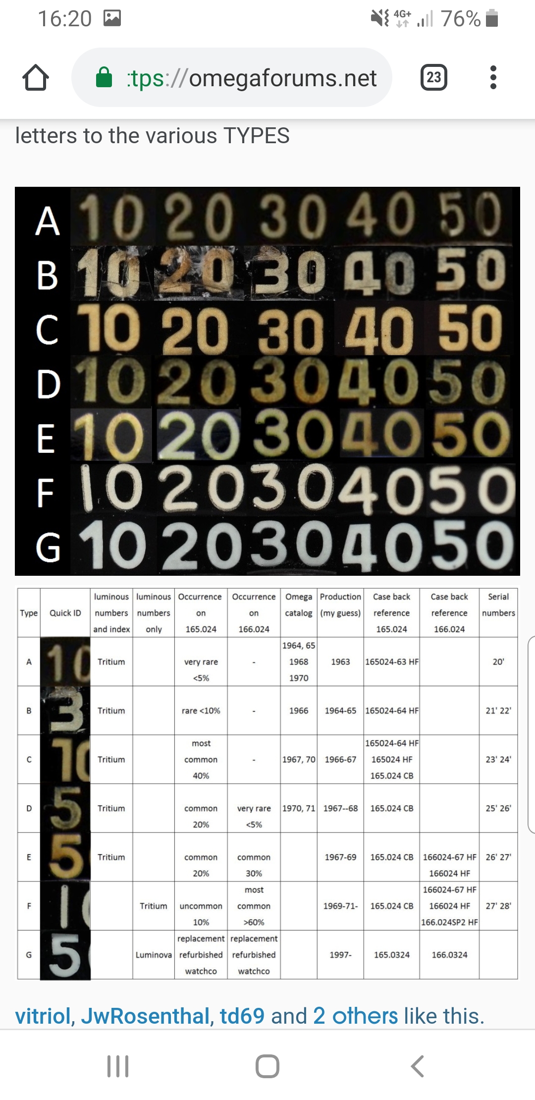

Sorry, depends whose chart you refer to..
According to these charts you are correct. Here it’s labeled a type A but I have seen this “type” on both 63 and 64 references., one of each shown above. Perhaps when @Dash1 and @kox finish their upcoming book, we will have all the answers😀. They can also have the honor of assigning THE letters to the various TYPES
How accurate should these charts be taken? I have seen some SM300s with a serial that does not match the dates of the bezel according to these charts, ie, a 25xxx serial with a Type F insert. How far "off" would be cause for concern, would one say?

Now looking at this one but this bezel is 100% not genuine right. Look at the 5! Should be a type E according to serialnumber... Getting quite paranoid with these 300's...

That bezel definitely does not look legit, but I am not sure how accurate the bezel chart above is with regard to matching it to serial numbers. I wish someone would comment on that, if anyone knows....

@timoss: What watch/bezel are u talking about now? I mean that from the first picture in this thread... and that one shows a legit SM300 bezel

Sorry for the confusion... I am asking a general question: how far off is acceptable in the case of the bezel chart? If the bezel chart here suggests a 27xxx or 28xxx serial for a certain bezel, but a watch with that certain bezel has a serial of, e.g., 25xxx, is that a potential issue? Or is the bezel chart quite loose and still somewhat unverified itself?
